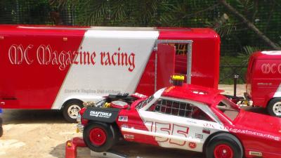

batmanreturns Posted October 16, 2014 Share Posted October 16, 2014 been building for years, just got started again at 50.... I have never done foiling simply had a steady hand and could paint it...show me.. the photo is my second place finish ,galaxie trailer contest. Quote Link to comment Share on other sites More sharing options...
