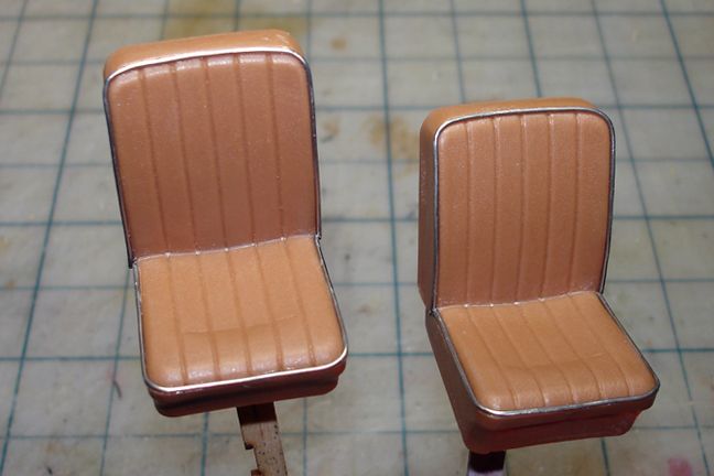

Moving on to the seats... I added the missing seat piping detail by using suoer glue to glue thin solder all along the seat cushion edges. I used solder instead of wire because solder is so much softer and easy to shape.
Now I can go ahead and paint the seats and add the chrome side legs/tilt mechanisms (parts that are included in the kit).

Got the seats painted...

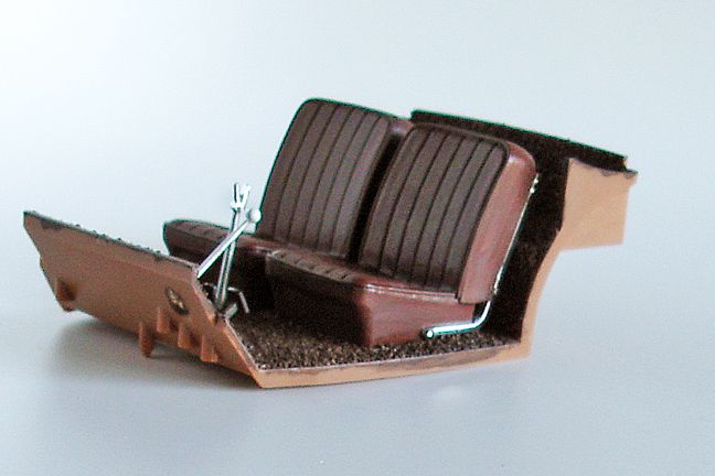

My "carpeting" might be a hair too big, scale-wise (it's fine model RR ballast). Or maybe it just seems that way because it's so obvious here without the interior being enclosed and the door panels and dash and steering wheel in place. I think once everything is in place and the floor is basically "in the shadows," it'll look passable. If I could do it over I might go with something a bit less "grainy," but oh well.

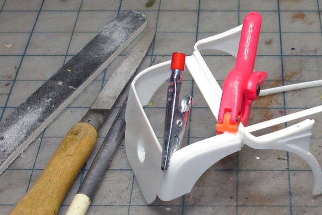

On to the body. First step is to open up the trunk lid by scribing it open, and then adding the inner "lip" or flange with thin strip styrene where the weatherstripping would be and the trunk lid seals against.
Here's embossing powder from Michaels. It's actually that brown-I didn't paint it but you can:

Yeah, I like that better. I went with what I had on hand. I'm hoping the carpet will sort of visually "disappear" once the interior is done.
I would never have considered opening the trunk, because I have no idea what you would see inside. Rolls kits open to show tool kits, but this is beyond beyond. I'll just scribe deeper into the panel.
