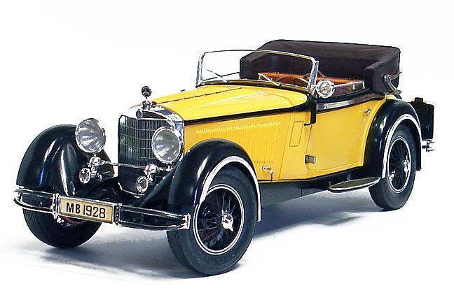

Interesting to note that most of the finished versions I've seen -- even box art photos -- show the hood misalignment on the left side instead of the right.

Regarding hood fit, based on what I've seen on this and other builds of the kit, I'm wondering if the upper parts of the hood are set up to be too close to the upper middle hinge.

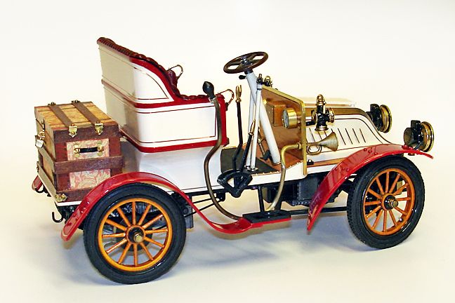

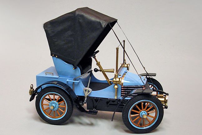

Really, really nice - by the way Harry, how many of the classics do you have on your shelves ? .... any pics ? :rolleyes:
I've posted them all here in the past. Don't know how many, exactly... maybe 15-20 or so.
Here are just a couple... too many to post them all here.

I owe Skip Jordan one last photo before this one fades away...
Thanks to him, I can now say this one is finished. He sent me the driver's side spotlight/rearview mirror (the chrome on my piece was messed up) so that I could finish this model.
This kit doesn't get better than this one.
How did you finally resolve the hood fit issue (with photo)?
Edited by sjordan2
On the left side, I drilled a hole into the lower rear corner of the hood's side panel and inserted a short styrene rod "pin." Then I drilled a corresponding but slightly larger hole in the flange on top of the fender that the bottom edge of the hood side panel butts up against when the hood is closed. When I close the hood, all I have to do is grab that rear hood handle with tweezers and slightly pull the hood side panel away from the flange... when I let it go, the springiness of the hood hinges moves the hood side panel back snug against the flange, and that small pin in the lower corner of the hood panel pops into the hole in the flange and holds the hood side down tight (and perfectly aligned). I still have to do the exact same thing on the other side of the hood, haven't done it yet but I will. Then I will have both hood side panels fitting perfectly.
