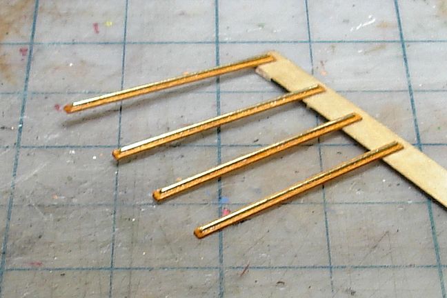

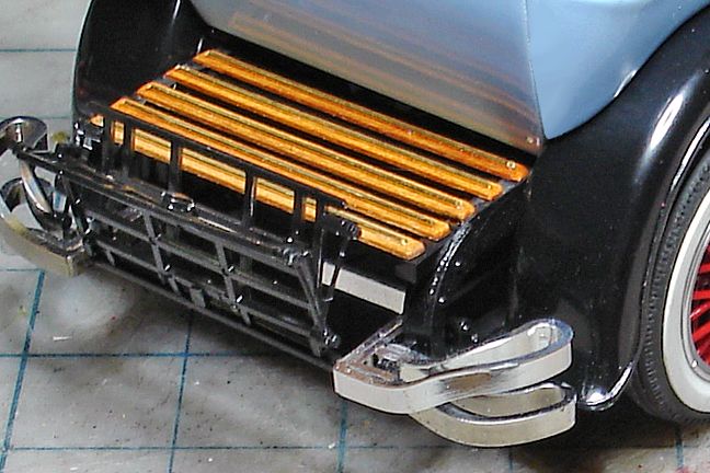

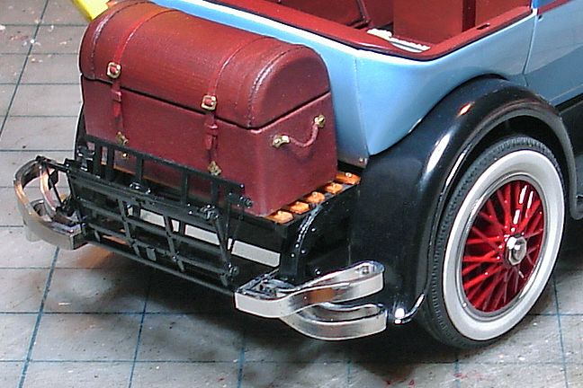

Again going by reference photos, I made the wooden slats that the trunk will sit on. They are made of strips of basswood, stained and varnished, and the brass scuff plates are brass wire. You'll see where these pieces go in an upcoming post...

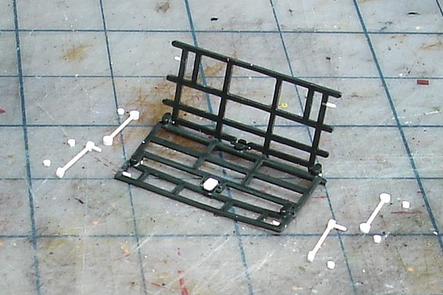

I'm modifying the rear luggage rack so that it will actually operate (fold open and closed). The white parts are styrene that I have added... hinge pins, hinge arms, etc. The "nuts" that will hold the hinge arms in place are sliced off of hex-shaped styrene rod and part-way drilled through to fit over the new styrene rod pins I added to the rack:
OK-now you're just showing off!!!!!!!! :angry:
No turning wheels but an operating trunk rack????????? :lol:

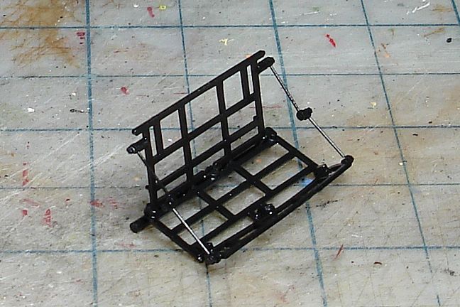

Here's the finished folding luggage rack:

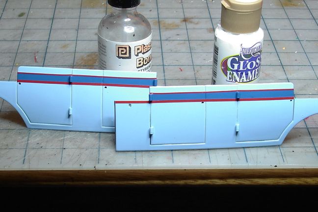

Not much else coming until I get the pinstripe tape, which won't be for several days at least. I got an email today telling me they shipped it today... six days after I ordered it!
I know you're waiting on the tape.
But any thought to try the twin #11 blade trick to make your own? Maybe on painted BMF?
Jus' sayin'...
Jus' sayin'...
I have different rolls of Line O Tape in varying sizes of chrome, aluminum and brushed silver. They have hard finishes that don't wrinkle, and the advantage is that the different sizes (down to super teeny 1/64") are perfectly machine-cut, and the sharpness of the edges can't be beat. Available in a variety of colors and sizes. But curves can be a problem.
