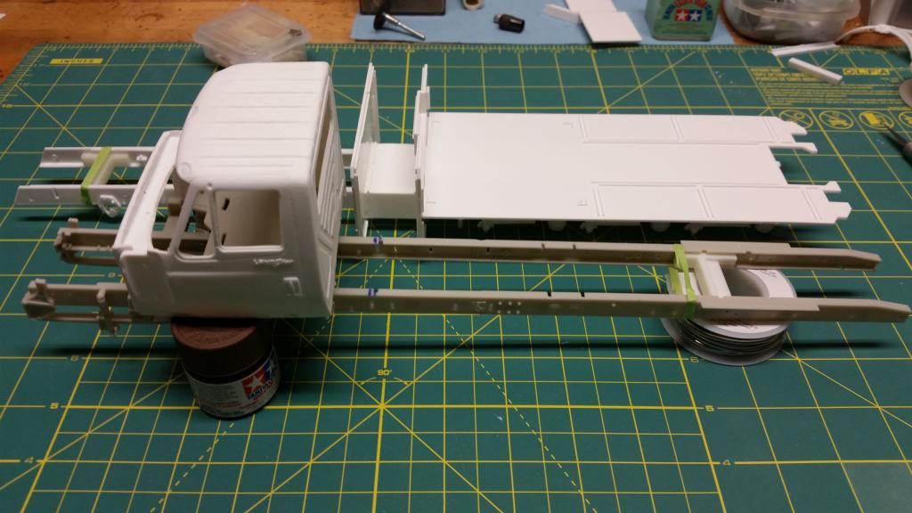

The holidays were fantastic this year. I must've been good, cause under the tree was the Mobius Lonestar, and the Revell Pete tri axle wrecker !!! I already had the day cab from cargostar in the stash...time to get building !The Lonestar wrecker I envisioned looked better as a daycab, and Dave (cargostar) had the grille.
I planned to utilize the front clip from the Lonestar to maintain the cab and hood mounts, and also the front driveline. The Pete frame would provide the frame under the wrecker bed..just the look I was after !
Special thanks to Chuck Most for the advice for the new cab mounts, and a fellow modeler offered a set of 32 Ford headlights .Thanks Steve!
Happy modeling!
The cab is just sitting on the modified kit floor , working out whether to use the Pete tanks..or the corn binder set without the fairings. All the chrome will be stripped and replaced w Alclad. The kit slam locks are being replaced for a set from Don Mills which look more detailed.
Jeff

Thanks! Tough cutting up 2 good kits to make this build,but everything will be used .
Oh...and the paint scheme? Black, silver, and orange...and new for me...TONS of chrome!!

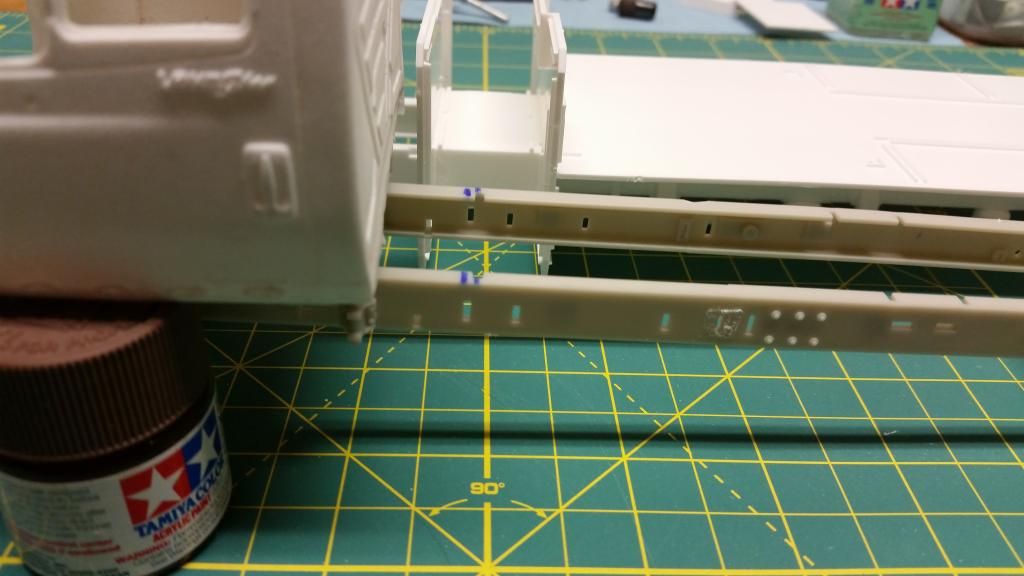

Could you elaberate more on the tip from Chuck on the cab mounts ?
No problem. .chucks tip was use the existing front mounts , then just bring the rear cab mounts to the new shorter floor! Remove the kit tabs and glue .
I used his lonestar day cab post to modify the kit floor pan
We have a rolling chassis!!! A cool video showed the Harley Edition engine, so a quick mix of testors enamels..we have color! The tranny still needs paint, and the engine detailed. Also the revised cab mounts are clearly seen , and the Pete tank waiting to be mounted.
