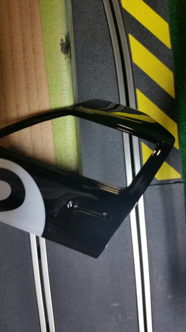

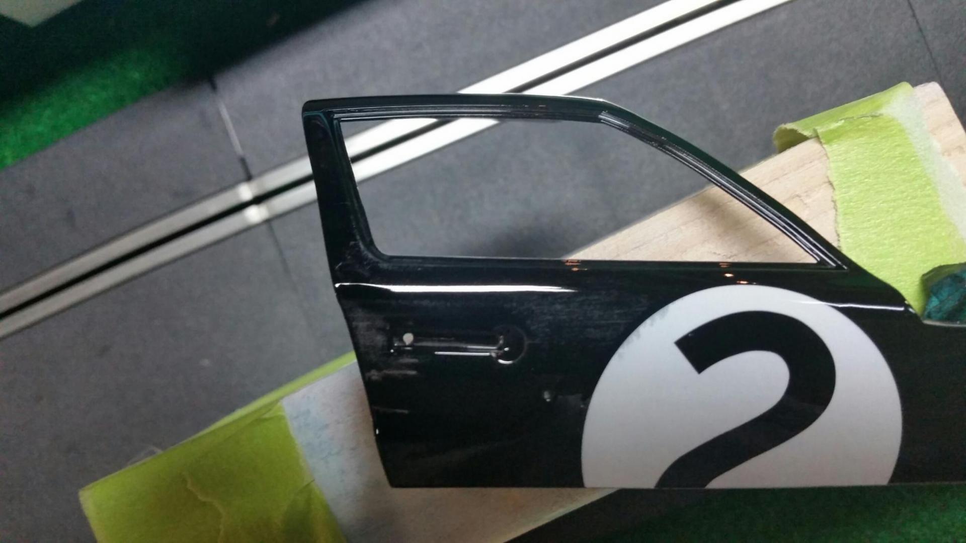

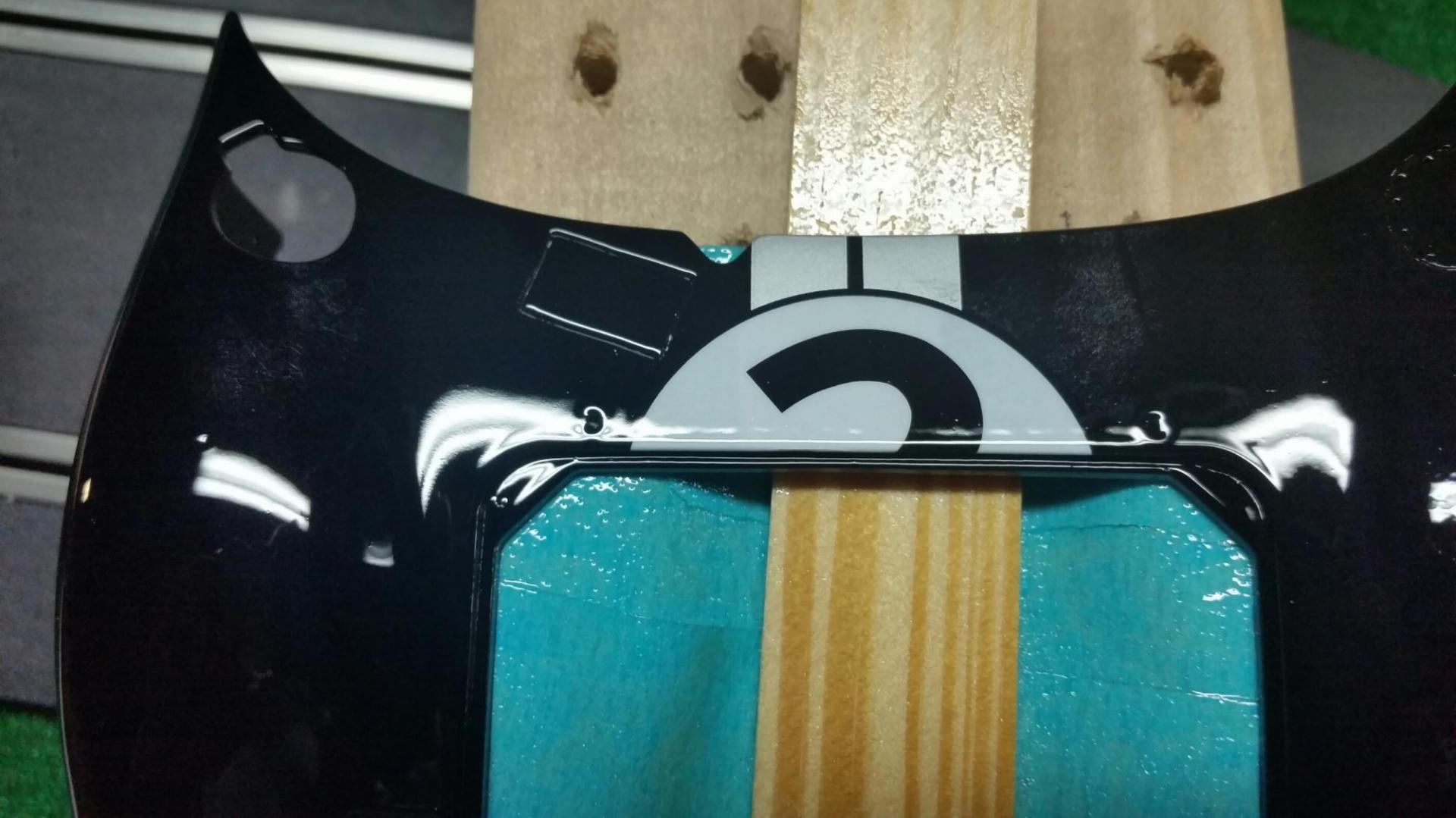

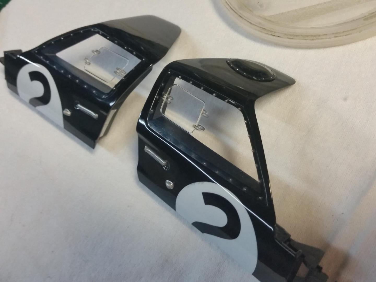

Timonator Posted January 31, 2016 Author Posted January 31, 2016 (edited) Oh, ok. Thanks. My modeling skills aren't where I would like them to be. So I'm always looking for suggestions. I clearcoated all of the parts separately this afternoon. Most of them turned out pretty well except for the nose and the doors had some areas where the black was kind of transparent to the white primer and plastic. Edited January 31, 2016 by Timonator
LaughingIndian Posted February 1, 2016 Posted February 1, 2016 Tim, is that the clearcoat hazing or did you miss seeing that in the color coat? What type of clearcoat did you use?It's sort of a neat effect for weathering (without the gloss) ... but if you want to fix it, and it's an acrylic, you can use diluted ammonia to take some off and repaint if needed ... but I wouldn't go near those decals!Hopefully someone here who's expert at this stuff can help you more ... I'm not close to being a paint guruGood luck!
Timonator Posted February 2, 2016 Author Posted February 2, 2016 I think something happened to the basecoat but that was the last batch of parts and my clear was mixed over an hour before that. Im using automotive urethane clear over tamiya acrylic basecoat. What I'm going to do is sand the peices flst with 2000 grit, mask of the decals and spot in the bad areas and clear again.

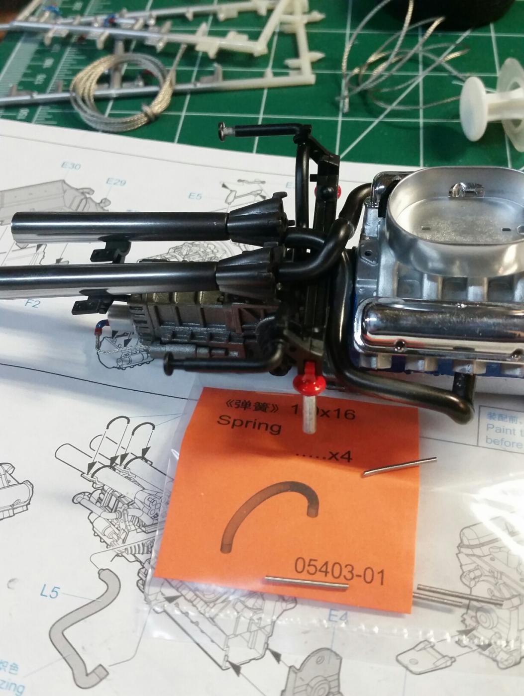

Timonator Posted February 26, 2016 Author Posted February 26, 2016 (edited) Does anyone that has built this kit have any advice on how to attach the exhaust pipe springs ? Edited February 26, 2016 by Timonator
Cato Posted February 26, 2016 Posted February 26, 2016 Open one loop at each spring end and hook it over the plastic flange that supports the pipes.
Cato Posted February 26, 2016 Posted February 26, 2016 Open one loop at each spring end and hook it over the plastic flange that supports the pipes.Bill said the same thing in your other thread..............

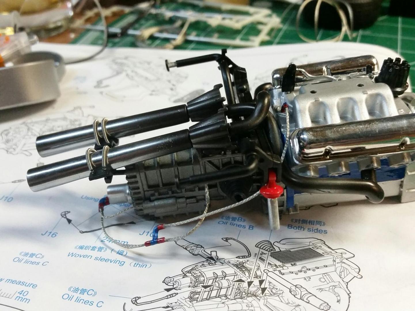

Timonator Posted February 26, 2016 Author Posted February 26, 2016 Ok, I got them on. Thanks for the advice .
Cato Posted February 26, 2016 Posted February 26, 2016 The dash 10 braided line used on the oil vents and supply was ~1" in diameter. Which is .083 in 1/12. The line you used looks like dash 6 or 8 fuel supply line.
Timonator Posted February 26, 2016 Author Posted February 26, 2016 I agree, but the next size larger braid looks too big for the fittings.
Cato Posted February 26, 2016 Posted February 26, 2016 I agree, but the next size larger braid looks too big for the fittings.There are aftermarket 1/12 AN fittings out there...
