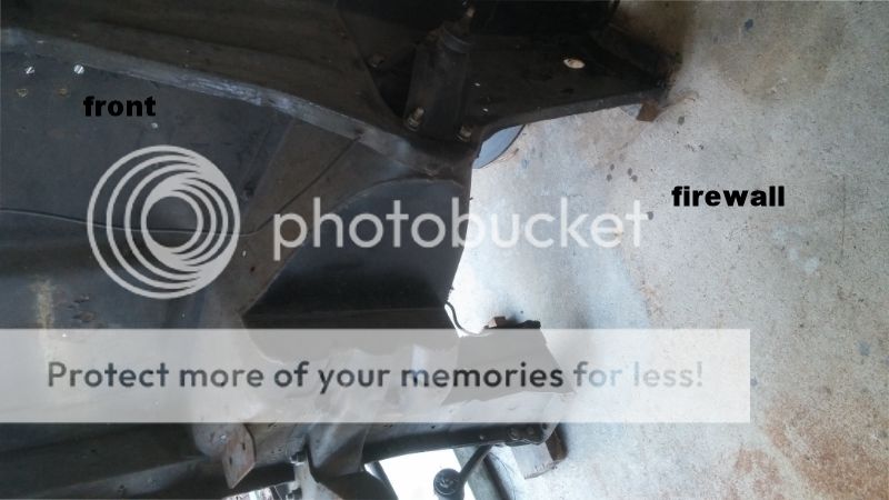

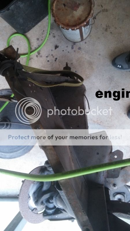

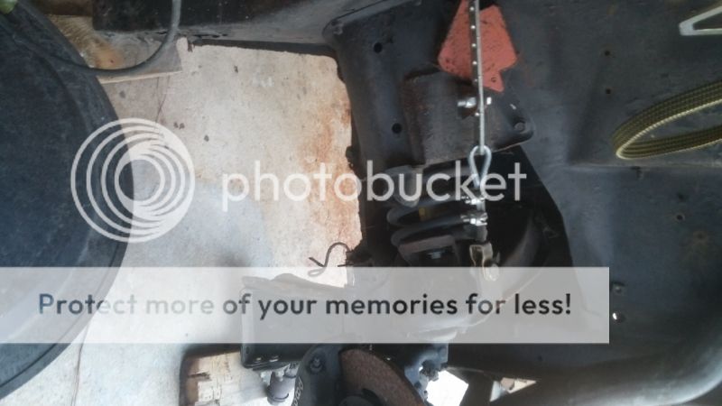

they dont need to be moved but notched, the top of the tower is the same but yo cut the inner side out that faces the engine and re-plate it further outboard, the cut/plate goes from the top of the tower to the bottom directly above the upper control arm mount. The engine will fit without this being done but you wont get a real set of headers on the car and changing plugs is harder than winning the powerball. Its also common to cut out the vertical rear inner panels between the firewall and the shock tower for headers to exit, It is darn near i,possible to fit a good BB header between the frame rails on a first gen nova as the rails are narrow the steering box is right in the way. I still have one of the front ends that is modified as described I may could get pictures of if you want, Ive built a few and still race a 64 nova.

42810ae9-23ef-4165-8a78-1dbf330476cd_zps
as you can see in this one, there is a ton of wasted space between the spring and the inner tower
220e6db6-3352-4bbe-8832-a8b29151963f_zps
this is a front view to give ya an idea on how deep the cut was on this front
d4d78c10-1871-4912-941b-9f33fee65c02_zps
Thank you so much!!!! Those pics are a HUGE help. Like they say a picture is worth 1000 words.
I've got a really good idea of the clearance I need to make now.
