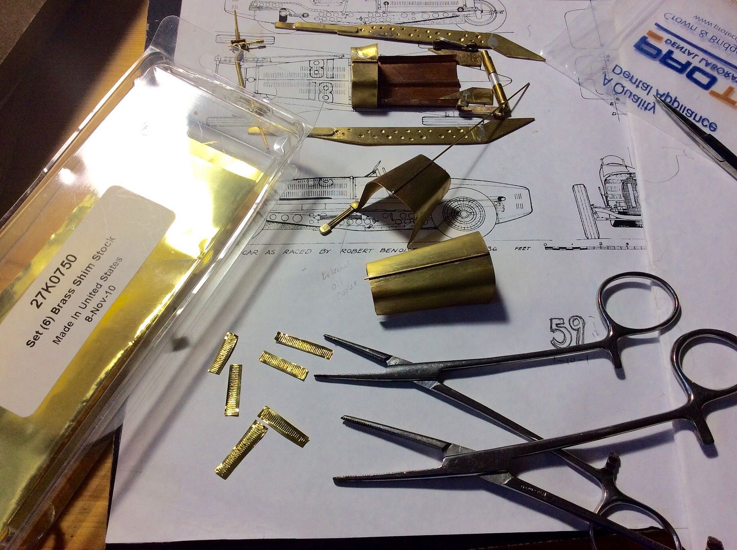

Twokidsnosleep Posted August 24, 2015 Author Posted August 24, 2015 (edited) After a month away, have finally got back to this project. Spent some time researching a prominent feature of the Bugattis...louvred body panels To cut to the chase the options for making them are: you could make plastic ones and glue them on, get PE ones, cut slits and press shape them right into the body panel. I am going to try a mix of these methods. I have pressed the louvre into brass and copper shim stock and will either solder or CA glue them on here are a couple pics of using two haemostats to press in the indentations, then cut out the strips Edited August 24, 2015 by Twokidsnosleep
Twokidsnosleep Posted August 24, 2015 Author Posted August 24, 2015 (edited) Uhooooooh, copper shim failure with both Ca and solder.....gotta try that againI cannot get the fins even by the haemostat method ; since the jaws taper, I get a tapered shaped strip of louvers. May have to work up a jig and try pressing the shape in. Edited September 2, 2015 by Twokidsnosleep
