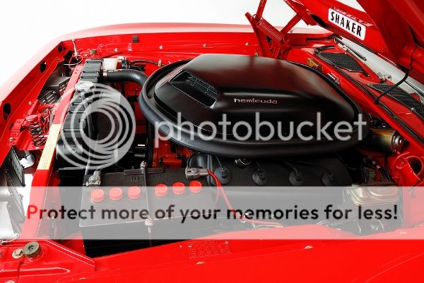

taaron76 Posted February 23, 2015 Author Posted February 23, 2015 Mopar guys - Can you tell me where the dipstick is located on a 426? I can't find it on any of the references pics I've looked at. Thanks! Tim
Belugawrx Posted February 23, 2015 Posted February 23, 2015 Nice job so far Tim.... This shows dipstick location,...driver's side, right behind the Pos. Batt. cable,...this one looks polished Cheers
taaron76 Posted February 23, 2015 Author Posted February 23, 2015 Nice job so far Tim.... This shows dipstick location,...driver's side, right behind the Pos. Batt. cable,...this one looks polished Cheers Thanks! I was able to find a few good references... It always happens when you're not looking. lol Tim

microwheel Posted February 24, 2015 Posted February 24, 2015 Nice detail work Tim. I agree I love doing detail. It seems each model I work on, wants it's own level of detail. Your engine work is really turning out nice. As for the lines coming off the valve covers, usually the one on the drivers side is a PVC line that goes to the back of the intake manifold just behind the carbs. The ones on the drivers side comes off the cap, (and usually there is two lines on the valve cover cap) the smaller one goes to the side of the rear carb, usually where the choke area is, and the other larger one goes up under and connects to the bottom of the shaker air breather as a crank case vent. One some cars there is even a 3rd line coming off the passenger side breather cap that goes to the fuel tank vent return line. Here's a reference pic for ya in case ya want it. Wish it were a little bigger. Keep in mind this is a 70 so it might be just a little different for a 71, but If memory serves me, there wasnt that much difference in the engine vaccum systems between those two years.

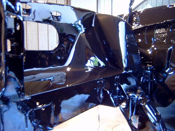

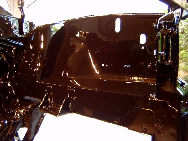

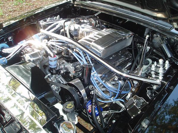

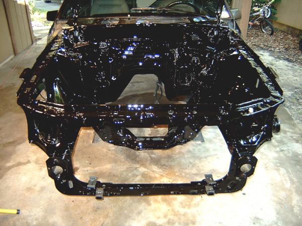

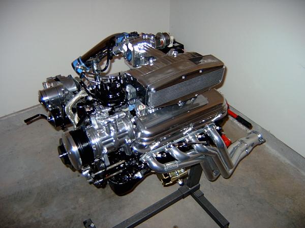

taaron76 Posted February 24, 2015 Author Posted February 24, 2015 Thanks, Jim! Every pic I looked at was different, but as long as I throw a couple in there, it will help with the detail. I actually despise clutter in an engine bay! So much that I took a year with my real life Mustang in order to clean up the engine bay. My goal was to not have any wires along the inner fenderwells under the hood, so I pulled the motor (rebuilt it and polished everything), welded up all of the holes, painted it and rerouted all of the wires to hide them. It took a year, but was well worth it in the end. This is probably one of the reasons that most of my builds will only have the essentials underneath the hood. To me, its like walking into a mansion and noticing laundry and trash all over the place. There is a little method behind my madness... I probably won't build any original models either, and I probably will never paint an engine bay anything but what the body color is. Just personal preference. Tim
microwheel Posted February 24, 2015 Posted February 24, 2015 Hi Tim. Love the clean look of your mustang. I totally understand about clutter. You should see how much BLAH_BLAH_BLAH_BLAH that Morris Garages out of GB found a way to stuff into the engine bay of my little 76 MG Midget. I kept it all original just due to the fact that it only had 18,000 miles on it when I got it a few years ago, though I did DO a freshen up rebuild and dressed it up a little. One of these days I'll take and post some pics on here of it. But it's just tooooooo Coooooold out right now to go taking pics out in the storage garage of it. As for the info I posted earlier of the cuda, I was just trying to help ya out with what and where those dog gone vaccum lines went lol. But believe me when I say, your detail work on this build is top notch and very cleanly done.
