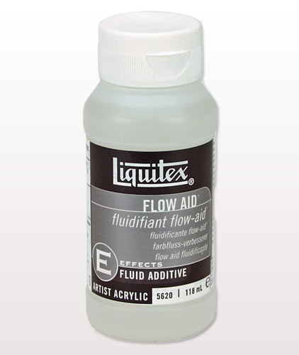

A few drops of this to jar. I think Micheal's or Hobby Lobby has it.
Make sure you only use a few drops. Most tips I've read that suggest Flow Aid only call for about 1 to 2 ml in a 100 ml mixture of thinner.
Well, I was using a drop or 2 of dish washing soap in a 23ML Tamiya bottle. That didn't seem to make any diff.
I do have Tamiya acrylic thinner but haven't used it yet as I'm unsure about ratios and weather its ok to mix in the paint bottle from fear of pigment breakdown.
I used alcohol but simply by dipping the brush and then mixing with a few drops of paint in a palette.
I suppose the Tamiya thinner is best but where should I mix it and what ratio?

While I'm still waiting for Liquitex, I've been employing jwrass and Matts suggestions and using Tamiyas thinner (X20A fromage). Finally painting is no longer a friggen nightmare OMG.
