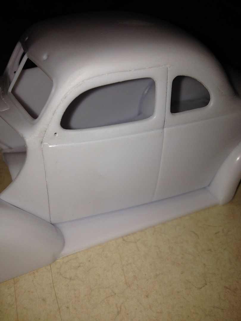

Darren B Posted May 25, 2015 Share Posted May 25, 2015 (edited) I just started a brand new project and messed up the body line over the top of the drivers door. I made the mistake of not making the door gap deeper before sanding off the drip rail and as I tried to make the door gap more pronounced and it got off track, its actually higher at the front of the door than the back of the door. My question is , is there a way to fix this by maybe filling in the gap and re scribing over it? It is not that big of deal but when I look at it I can see it and its annoying me that I did not scribe the door line deeper before sanding off the drip rail. Edited May 25, 2015 by Darren B Quote Link to comment Share on other sites More sharing options...
