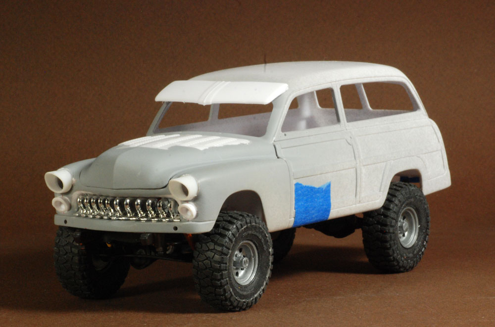

Foxer Posted November 16, 2014 Author Share Posted November 16, 2014 (edited) Put 3" lift blocks on the springs .. maybe not the most authentic lift but it did the job. Now I see I do have to shorten the wheelbase about a quarter inch. Got some measuring to do to get it more exact. It looks like it will be easy to take a piece out just behind the transmission end and will be easy to reinforce there. The guides are on fenders for the flare piece to be welded and I removed the side chrome on front fenders as they interfered with the flare putty when I blend in. Still to be decided if I add chrome back or leave plain .. or just drill mounting holes where it USED to be. This is going to be a bit worn out and rusty. I did notice the wheels shown from Chief Joseph have holes for mounting air nozzles! .. amazing. And, speaking of the Chief, here's the carb from him I'm using ... another amazing piece! I detached it from the casting block and added a mounting pin under it. Traced the bottom to make a adapter for the truck manifold. If you like this carb there's more photos in a thread I resurrected about how bad carburetors were cast ... I had to take that back after seeing these! Edited July 7, 2017 by Foxer Quote Link to comment Share on other sites More sharing options...

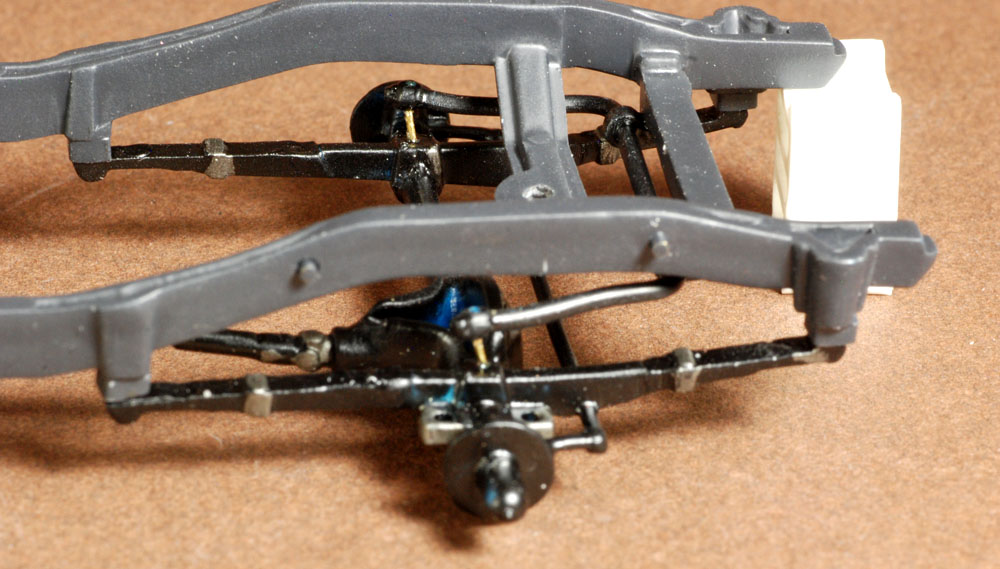

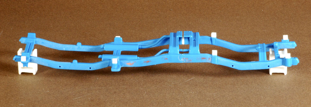

Foxer Posted November 19, 2014 Author Share Posted November 19, 2014 (edited) I got the frame shortened and somehow got an offset cut on one side .. by quite a lot! I've chopped and sectioned bodies wit no problem many times ... don't know how I managed to be so far off! ehheeh, that's what they all say, I know. Anyway, it's all together and solid. It was nice of Monogram to provide rails with groves to slip a brass pin in. The white slice shows how far off I was in the cut .. it WAS marked with tape. Edited July 7, 2017 by Foxer Quote Link to comment Share on other sites More sharing options...

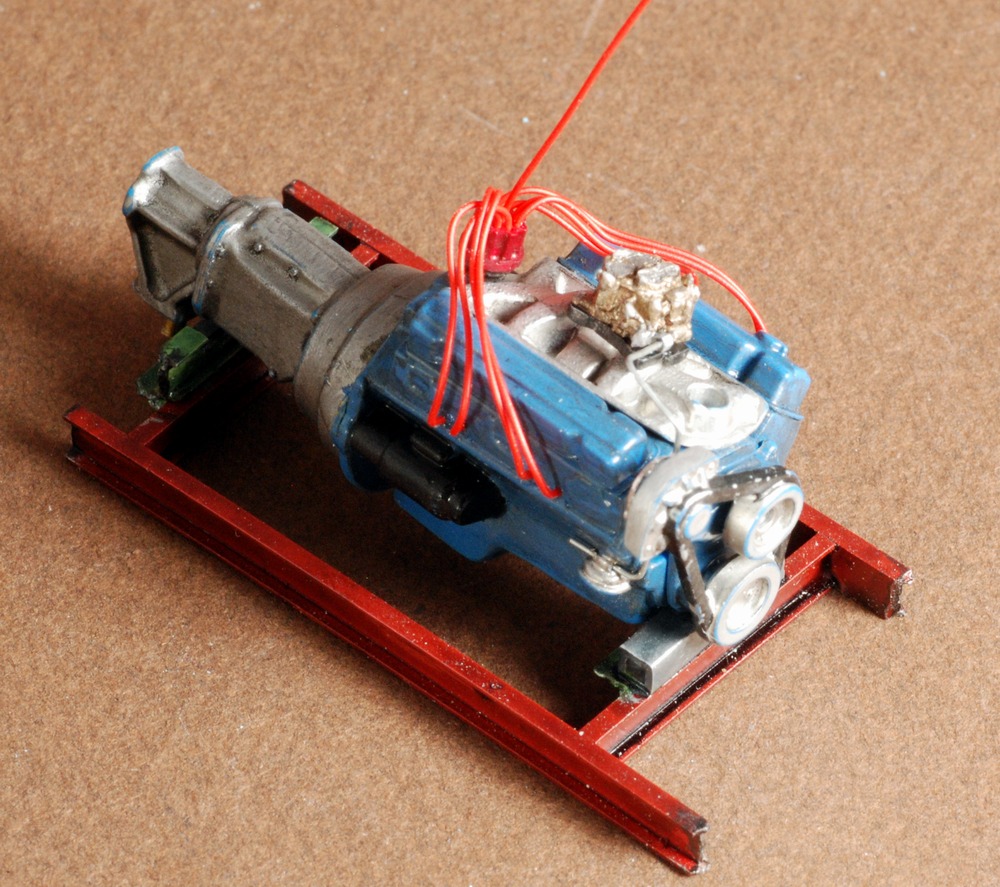

Foxer Posted December 19, 2014 Author Share Posted December 19, 2014 (edited) Been working on the engine and adapting the blocked axles with extended driveshaft. Thi swas a test fit and looks good fit-wise. I see paint touchup is needed for all the handling the engine has endured. That one plugwire hole thats off will get hidden and burried once wire is on and it's in the engine bay. I made a carb adaptor to fit the truck kit intake manifold. This is the Monogram truck engine going in. I thought I'd be able to just extend the shocks easily but will need to fabricate 8 new ones .. an easy job, just tedious. Edited July 7, 2017 by Foxer Quote Link to comment Share on other sites More sharing options...

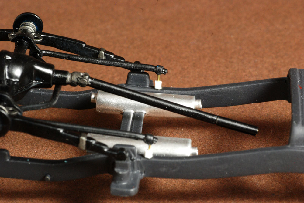

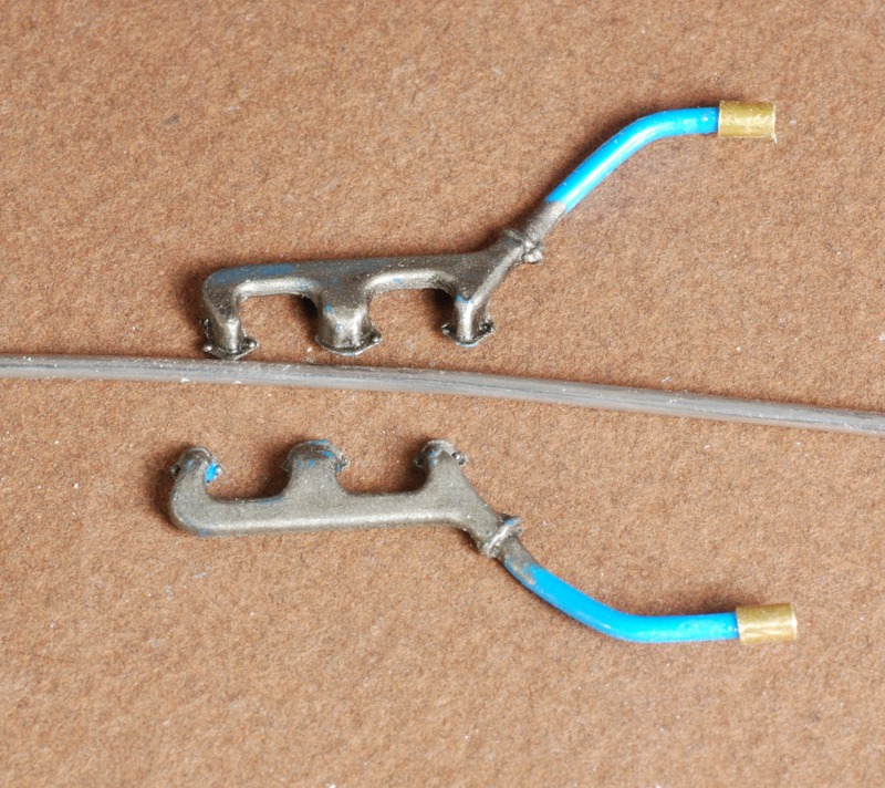

Foxer Posted December 26, 2014 Author Share Posted December 26, 2014 (edited) Just a small one .. seems like I've been cutting an eighth inch long small brass tubes forever! The shock mounting pins on frame are in, the muffler got the receiver tubes for the .062" solder tailpipes, sleeves to join the tailpipe to the plastic header pipes and aluminum tailpipe ends done. Looks like the Mercury radiator is a save and probably most of the Mercury engine compartment will be used. Edited July 7, 2017 by Foxer Quote Link to comment Share on other sites More sharing options...
Foxer Posted January 1, 2015 Author Share Posted January 1, 2015 (edited) New Years Day and the internet was down so I removed myself to the basement body shop. The frame got painted .. last of my Floquil Grimy Black (!) .. hope Testors has released this color again. The engine is wired with plugs and fuel line. I may put some linkage on for that beautiful carb. The exhaust pipes off the manifold are the only plastic parts remaining. I cut the pipes shorter and added a sleeve to take the solder pipes. I've been working for days on all the pieces for the 8 new longer shocks and finally ready to paint. Just have to bend the smallest diameter piece to match the curve of the originals. Here's a pic of the process. Edited July 7, 2017 by Foxer Quote Link to comment Share on other sites More sharing options...

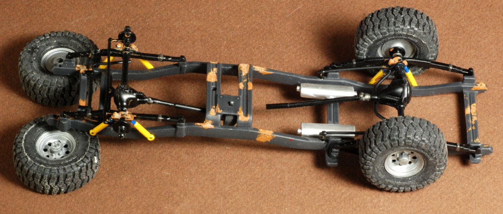

Foxer Posted April 9, 2015 Author Share Posted April 9, 2015 (edited) Work has been ongoing on this .. lots of painting for the chassis and it's coming together. The engine and transfer case are just placed for these shots but everything else is glued. The shocks I made came out wonderful and were easy to make. I started to rust and weather so all those tiny white specs are baking soda I dropped in the wet rust paint for texture. I just glued the headers on and they have an aluminum pipe at ends to receive the solder tail pipes I have to make when engine is glued in place. The wheels also got painted but still need a black wash. The drag links I made after asking a question about the sway bar attachment here in the forum and the help I got vastly improved the look of this chassis! Next two are shots of front and rear drag links which are still in brass. I have been contemplating the body. I'd like to use the louvered hood from the '49 Merc sedan but it will take some cutting and fitting to adapt it. This is a really custom hood. Haven't decided yet, but it will look good on this. Edited July 7, 2017 by Foxer Quote Link to comment Share on other sites More sharing options...

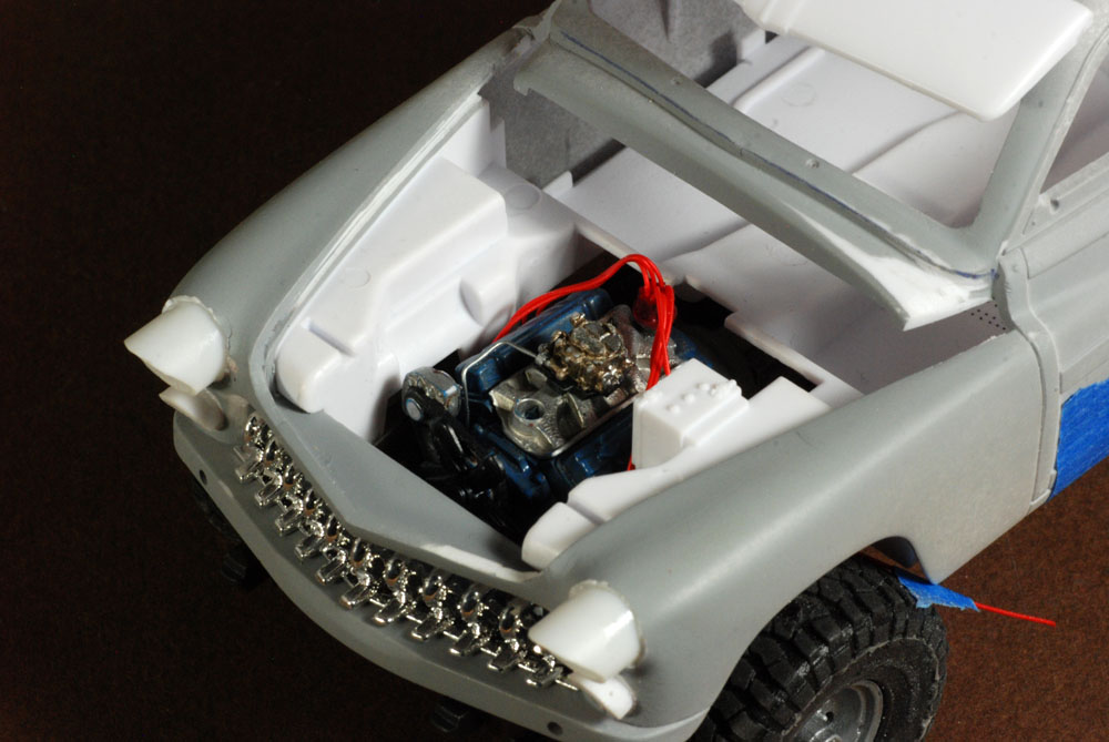

Foxer Posted April 16, 2015 Author Share Posted April 16, 2015 (edited) More hood fitting .. it's very close. I glued some short .02" strips into the front hood radius and clamped the hood in place to shape the strips. Then I puttied up the space left. Here's a few photos just before a primer check coat and after more sanding, filing and adding some thin gap-filling strips to raise .01" and close the side gaps. Also under the front edge between the radius pieces. After primer .. not too much to tune up here .. )) Edited July 7, 2017 by Foxer Quote Link to comment Share on other sites More sharing options...

Foxer Posted April 24, 2015 Author Share Posted April 24, 2015 (edited) Great job fitting the hood to the body. I think when I made a remark before about the hood to cowl fit, what I didn't realize was the wood door trim on the door and not the cowl. Yeah .. the door wood trim is a bit wider than the hood but it should look natural . or at least acceptable. Been looking at the body for some mild custom updates and the front is in glue and something I like. I inserted some tube into drilled out headlight holes and drilled out the turn signals to accept the custom tail lights from the Revell Sedan. These have a similar pointed shape to the headlights. I will shape the leading edges and may file the headlights back. Then some putty to mold them all in. I have a winch coming to mount in front .. maybe no front bumper ... some suggestions would be appreciated. The K10 truck frame fits very well ... the engine tucks up nicely into the Merc engine bay! Now to start distressing the wood! I have some ideas that will need testing on some scrap body ... Edited July 7, 2017 by Foxer Quote Link to comment Share on other sites More sharing options...
