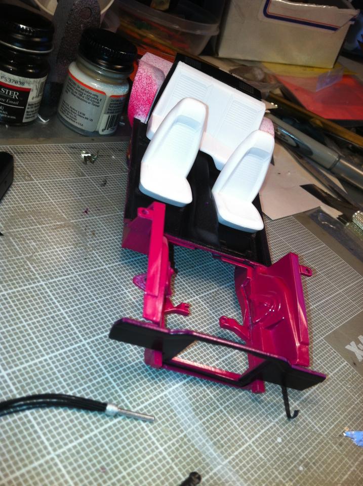

FASTBACK340 Posted January 12, 2014 Author Share Posted January 12, 2014 OK… not much to see because I'm starting the fender-lip mod now. Then the roof comes off. I'm making some concessions here: I'm probably not going to modify the rear interior panels to convertible-spec. Someone will do that in the aftermarket and that will make it easier in the future. But for now, I need a high body count. Here's some shots of the basics going together. Engine block is shot. Now to mask the bell housing & transmission. The floor & dash are painted, the chassis is primered. The engine compartment is badly twisted on mine so I'll have to clamp it and epoxy the joints. I don't want it being an issue later. Once the body is cleaned up it should roll together nicely. After seeing Randy's 2 builds I can't wait to see if mine looks as good! Great inspiration those builds were! ? Quote Link to comment Share on other sites More sharing options...

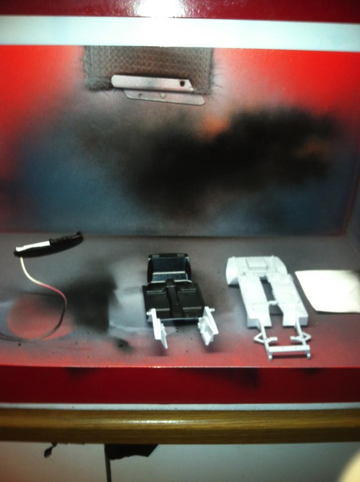

FASTBACK340 Posted January 17, 2014 Author Share Posted January 17, 2014 (edited) Sorry for the long time between updates, but I haven't had the time recently….. Being I'm off today I got some time at the bench this morning. An empty, quiet house works wonders! Engine is painted, now to detail. The chassis is painted too. We're getting there! After I run a few errands I'm going to finish foiling the `68. --------------------------------------------------------------------------------------------------- WOW! What ^%$#$%^ pictures! I'll try & do better next update! Edited January 17, 2014 by FASTBACK340 Quote Link to comment Share on other sites More sharing options...

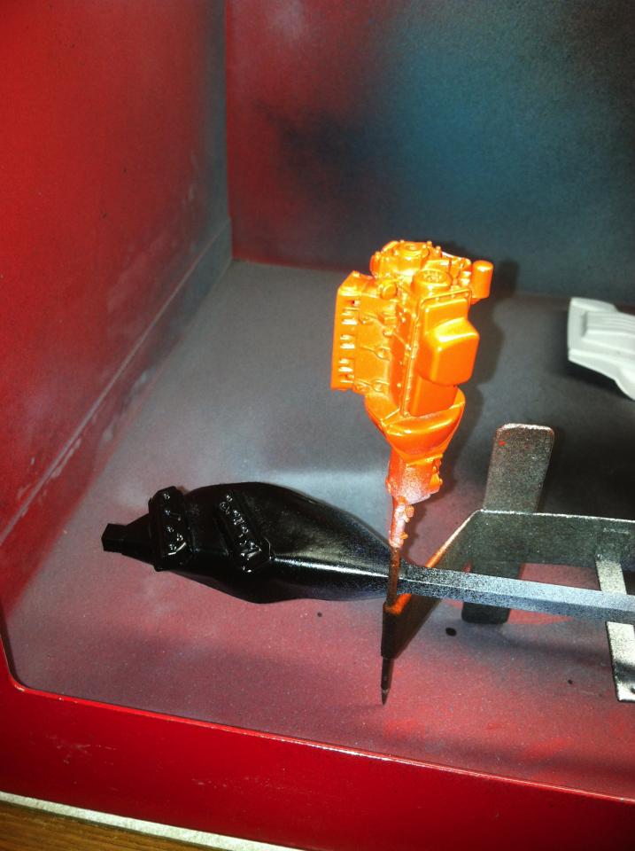

FASTBACK340 Posted January 18, 2014 Author Share Posted January 18, 2014 OK…. another update, but on the `70 this time. I have all the engine pieces painted. I just have to detail and assemble, the fun part for me. Aside from the obvious missing pieces, I plan on adding ignition, fuel, alternator, engine harness wiring, clutch & transmission linkage. Stealing more ideas by not painting the interior panels white. Here you can see the engine compartment painted that subtle shade….. Aside from the already mentioned shortcomings, this is still a NICE kit. Most of the issues can be remedied. As soon as I finish this one I'll be looking for reference material for the S&M car. When does that come out? Thats it for now. Nap time, I'm headed into Manhattan tonight with the boys for dinner & a concert. Quote Link to comment Share on other sites More sharing options...

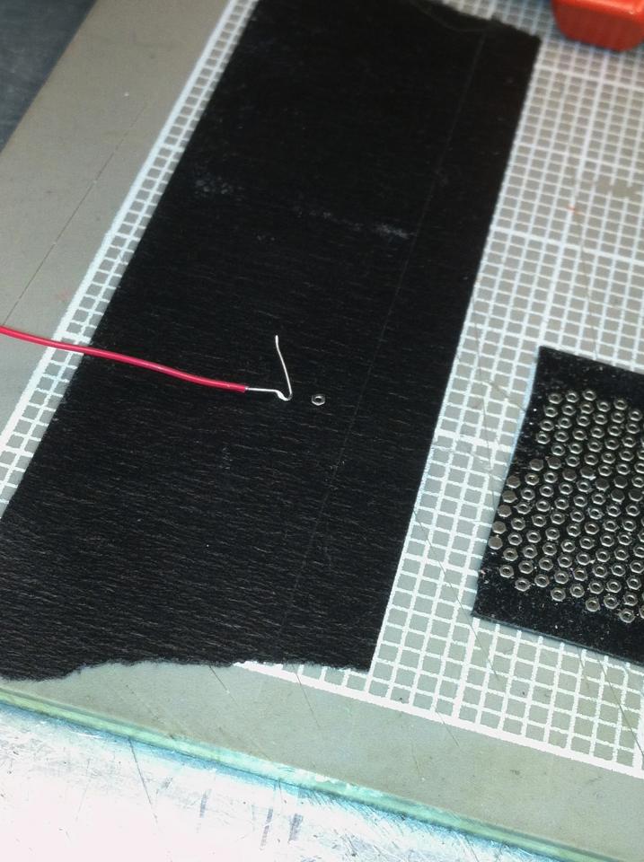

FASTBACK340 Posted January 19, 2014 Author Share Posted January 19, 2014 I will be watching this closely so I can learn, it would be great if you could post some pics of the those processes. Looks sweet so far. OK Rob, here you go! This is how I make a dip stick. Take a length of Radio Shack wire wrap and pull off a short section of insulation. Now slip on a small photo etched ring or nut over the wire end to simulate the stopper. It's so small no one will see the hex head if you use a PE nut (and if they do notice, ask they to go away….) Now we make the finger-loop with the smallest, pointiest tweezers you can find. Now we test-fit it into the correct location for the dipstick in the block for proper length Then is we forget, like your author did, you paint it block color (Hemi orange) and mount it. Or do the first three steps BEFORE you paint the engine…..like Chrysler did back on the assembly line. OK, enough for now. I'm headed out for the evening, but let me leave you with the next task: adding shift linkage, and fabricating a clutch Z bar for the clutch linkage. Can you imagine…. Revell didn't include a Z bar!?!?! Quote Link to comment Share on other sites More sharing options...

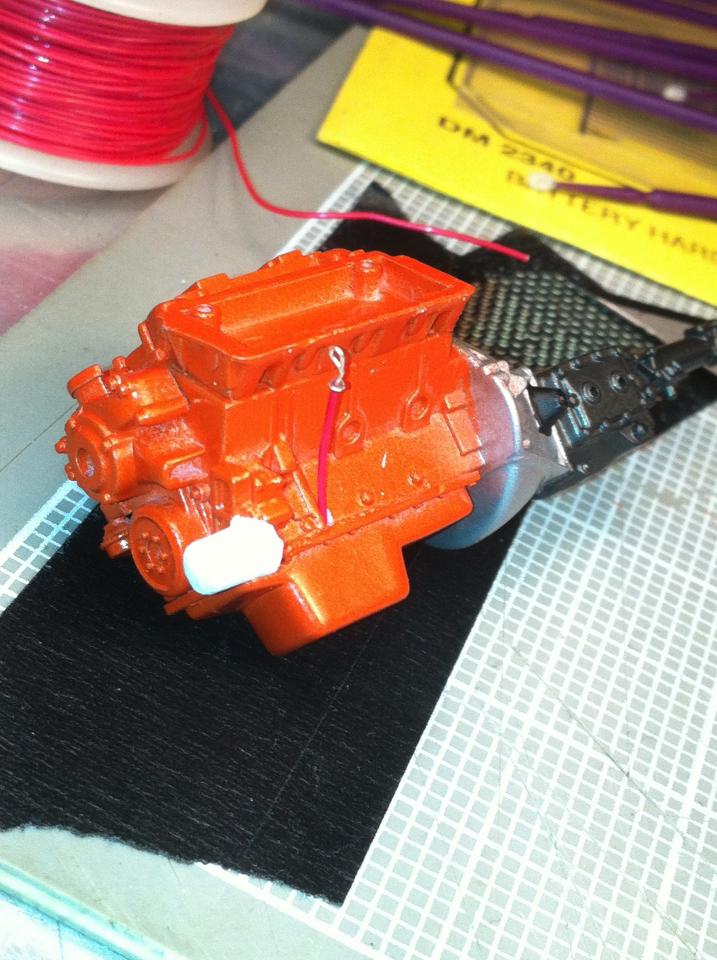

FASTBACK340 Posted January 22, 2014 Author Share Posted January 22, 2014 OK gang, small update that took a while to complete. This afternoon I installed the starter w/wiring and did the ignition cables & distributor. Wiring a Hemi has always been a thrill as I've always wished I owned one. If I hit the lotto, the small block will be yanked out of my car faster than you can say 572 Crate Hemi. The first items I needed were wire looms. The photo etched pieces I had I didn't like, so I made what I needed. I start by scribing a line on some .010 sheet and use the scratch-line as a guide for drilling the holes in a row. Then nothing more exotic than a black Sharpie to make the piece of plastic look like the real piece of plastic…. Now we test fit the loom onto the wires…. Now I cut some short lengths of spark plug boot to add to the end. Now we start threading the boots on and using a DOT of ZapGap to secure them in the valve covers. And hopefully it will look semi-convincing as plug wires. After the ends are good & dry I'll use tweezers and gently tweak the wires so they have a realistic droop. Spark plug wires NEVER look like they're starched! I think I'm going to paint some suspension pieces for the `70 and go finish my `68 Barracuda. I figure if I'm in the right frame of mind, I "could" have the `68 done by the weekend. I hope….. Thanks for following along and for the builders whom requested some step-by-step procedures, I hope this is helpful. Quote Link to comment Share on other sites More sharing options...

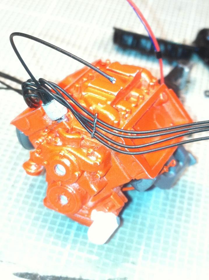

FASTBACK340 Posted January 23, 2014 Author Share Posted January 23, 2014 OK, I am now officially shot-to-Hell…. I'm cross-eyed, tired, and I want a cup of Hot Chocolate. Tonight I made an engine harness. If your worried about your alternator not "floating" and it's anchored down, it may as well do it's job. While we're in there we'll power up the coil and add the coolant temperature sensor wire. Stuff is getting real. I start with a small diameter piece of tubing (same size as the spark plug boots) and an assortment of detail wire. Some of these are thinner than a hair. No joke…. Also pictured is a resistor I found that looks like a fuel line with a filter. The next step is to take a straight pin and pierce the side of the tubing where I want the coil wires to exit. Once I penetrated the skin, I removed the pin and inserted the two wires. As the tubing collapses it grabs the wires. Nice, clean, neat. I added a second hole behind this for the temp. sensor. In the end are the three wires for the alternator. Since those three wires are too thick, I stripped the insulation off and inserted the bare wires. Again, nice, clean, neat. And no adhesives. That's the trick with super detailing. Engineer as much as possible that will clip, snap, or bind in place. Adhesives make the mess…. Here's a better shot of the "fuel line". Before I install this, I'll hit it with a rag with some lacquer thinner to knock the gloss off the tubing. If not, I'll dull-coat it. I still have to add the alternator adjustment bracket and clean up some of the wash I applied to the block to bring out some details. And install the fuel line. That's it for tonight. I never touched my `68 Barracuda because "it's so close to being done why rush it…" slacker mind-set I must do something about tomorrow. I. Must. Finish. That. Car. G`nite……... Quote Link to comment Share on other sites More sharing options...
