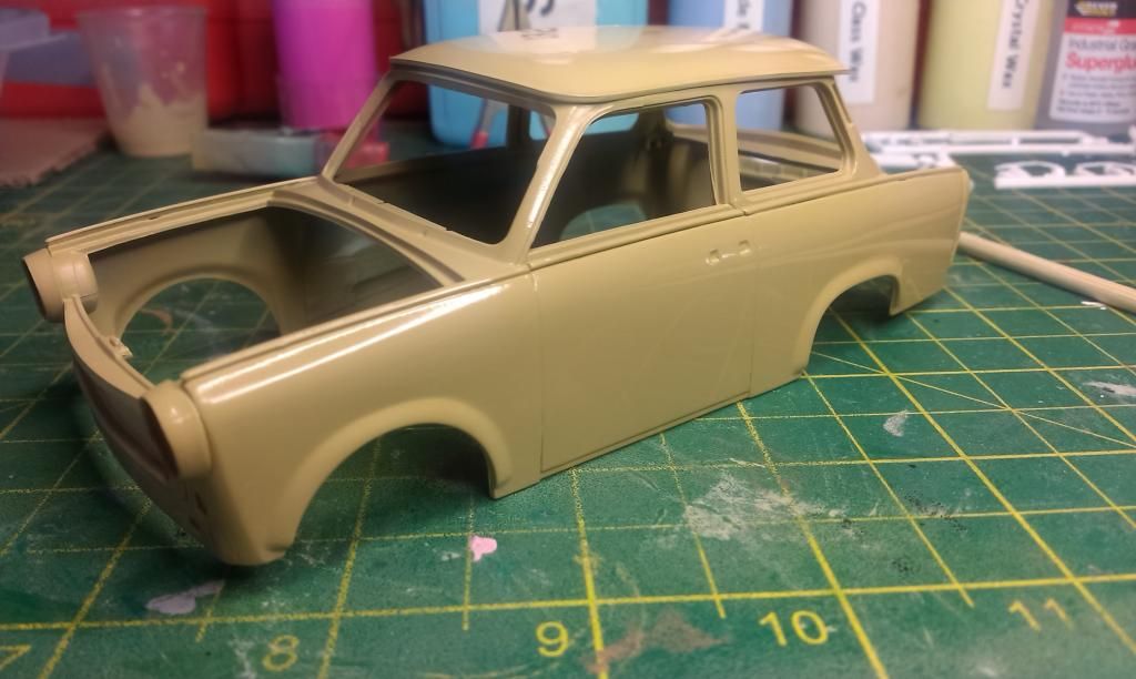

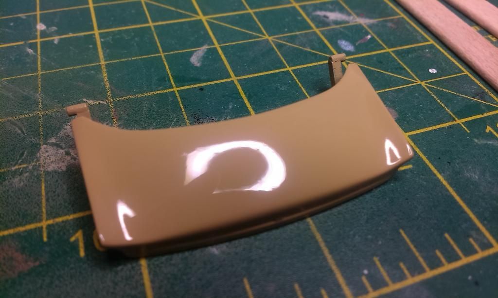

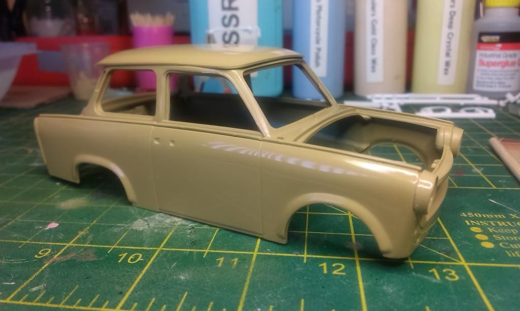

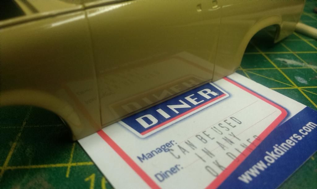

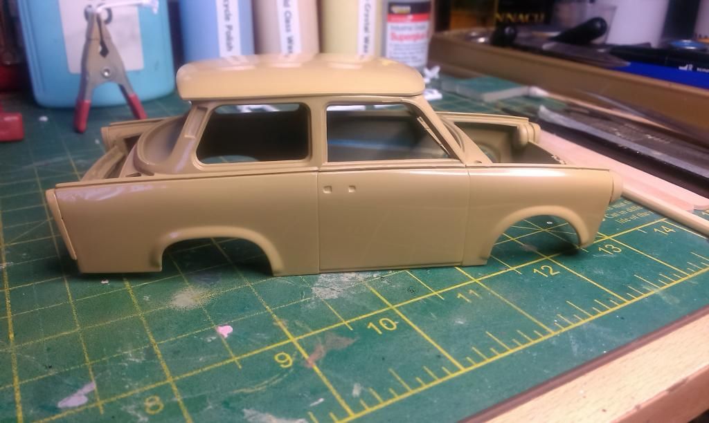

GeeBee Posted December 9, 2014 Author Share Posted December 9, 2014 (edited) Well after having to sand the bootlid back to bare plastic, and repaint the lower body, I finally have the body and body panels finished, wet sanded and polished, the body was wet sanded with 4200, 6000, 8000 and 12000 sanding pads, and polished using various grade of polishing compounds# Edited December 9, 2014 by GeeBee Quote Link to comment Share on other sites More sharing options...

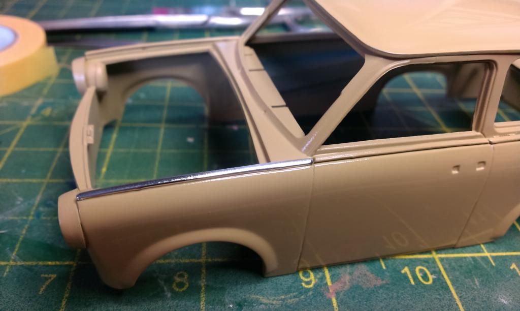

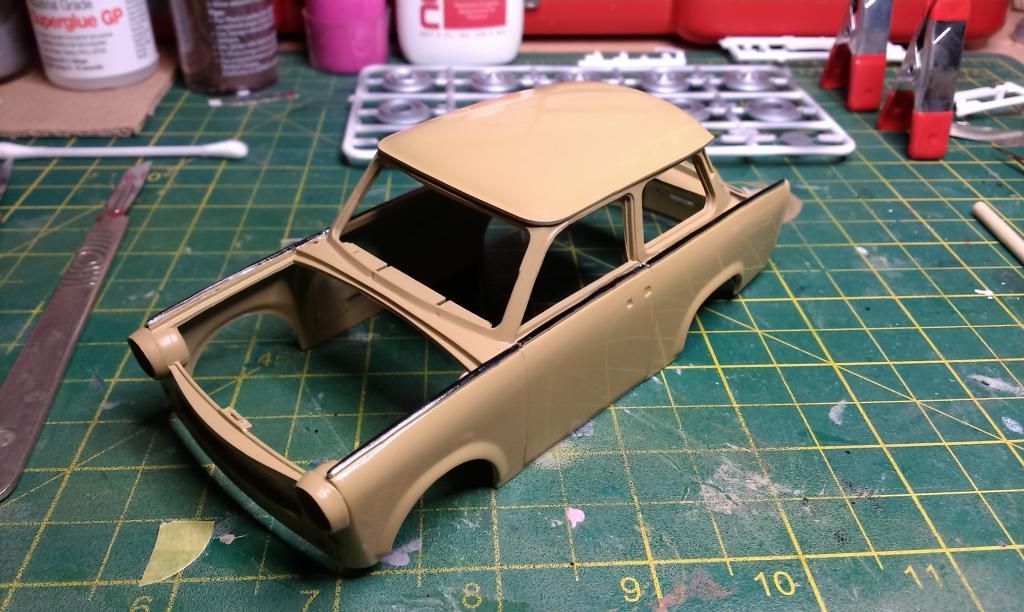

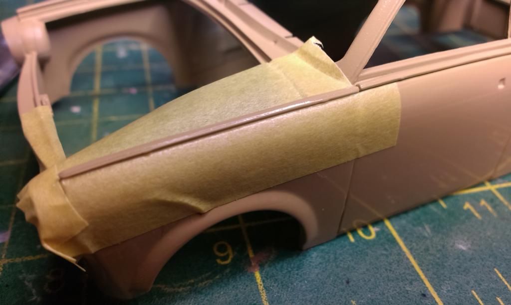

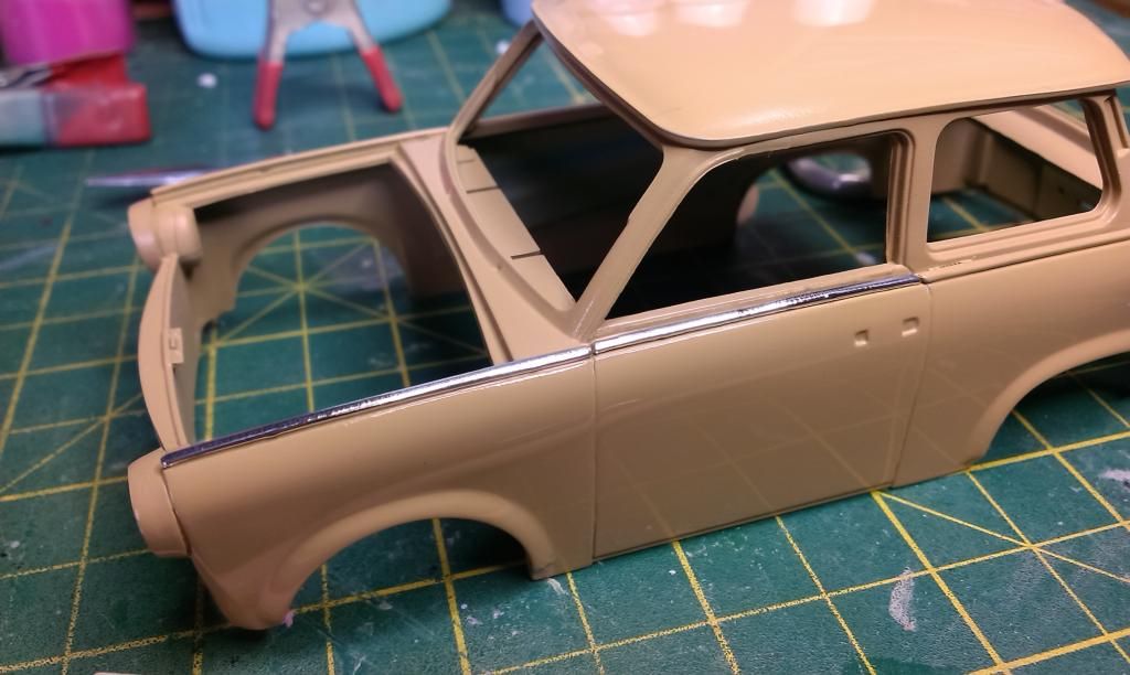

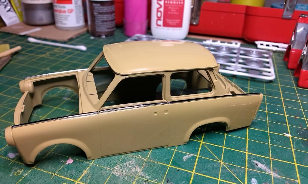

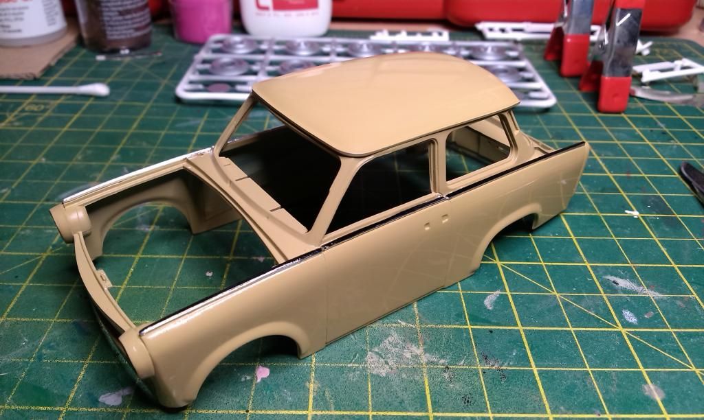

GeeBee Posted December 10, 2014 Author Share Posted December 10, 2014 Today I started on the trim at the top of the wings and doors, in real life this is a aluminium channel with a rubber strip inserted in the middle, I'm doing the trim using BMF aluminium foil, when it's finished, I'm going to mask off and touch in the rubber trim using a black art marker .... Quote Link to comment Share on other sites More sharing options...

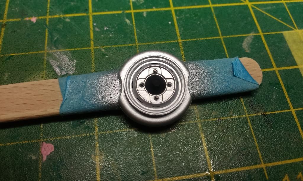

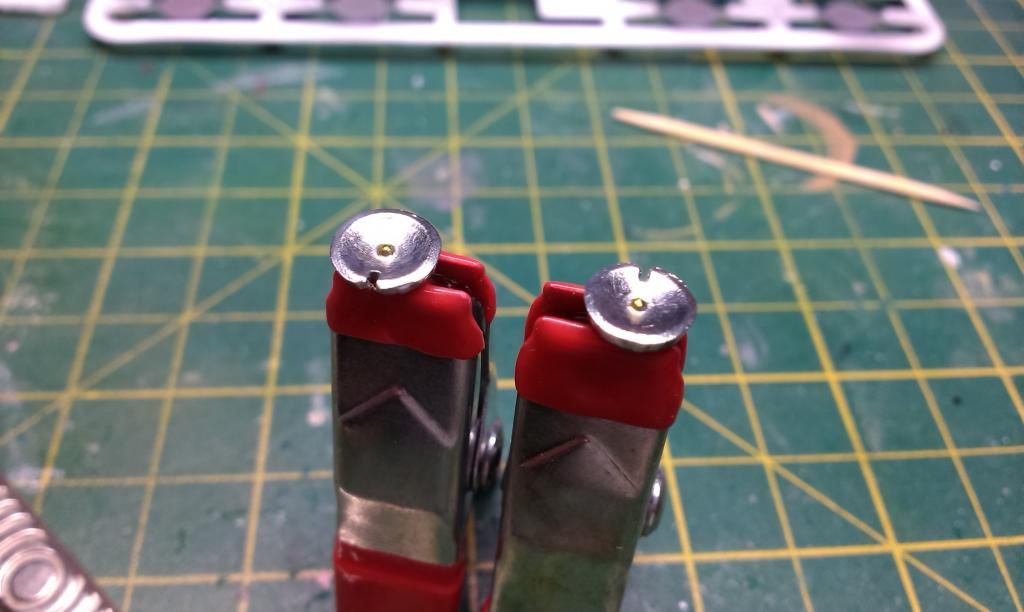

GeeBee Posted December 15, 2014 Author Share Posted December 15, 2014 (edited) After putting on the aluminium BMF on the trim above the wings and doors, I left it sitting on the side while carrying on with other jobs, I kept looking at it, and I knew I couldn't just leave it with the aluminium trim without any further work, it just looked wrong .... So with a deep breath and a lot of trepidation, I came up with an idea, but still wasn't sure if it would work, luckily it did, I masked off the body either side of the bmf and ran a broad tipped art pen, it took a few coats but it did the job, with the reflections going on, it didn't photograph very well .... Also got a few of the smaller parts sorted, as there are no chrome parts supplied in the kit, although to be honest there isn't any chrome parts on a Trabbi, but the headlamp reflectors needed a little more that the call out for silver paint in the instructions, so they were primed, (so the BMF had something to bite on to) and then covered in chrome BMF, then the bulbs were picked out using Tamiya clear yellow to replicate the bulbs, a black wash was added to the engine cylinders and ventilation grills that go onto the C pillars, Edited December 15, 2014 by GeeBee Quote Link to comment Share on other sites More sharing options...

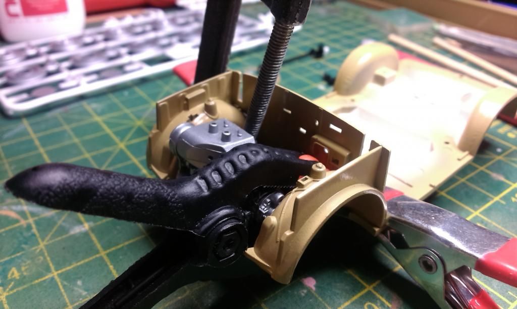

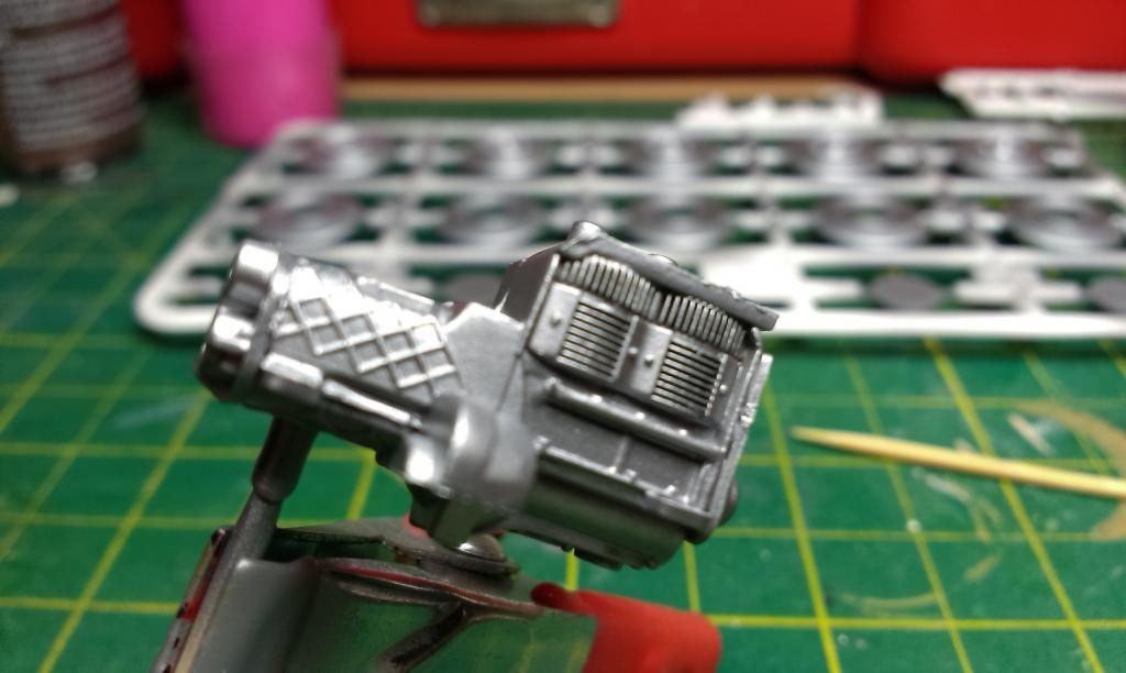

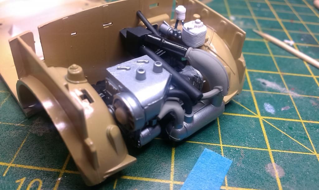

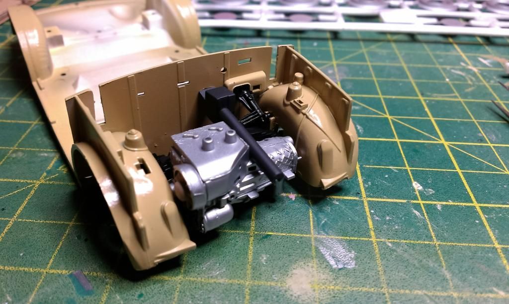

GeeBee Posted December 20, 2014 Author Share Posted December 20, 2014 Been cracking on with the little Trabbi, it's now got an engine ..... Quote Link to comment Share on other sites More sharing options...

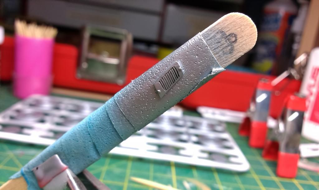

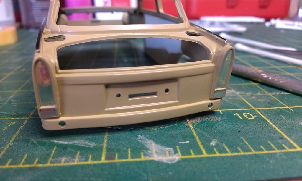

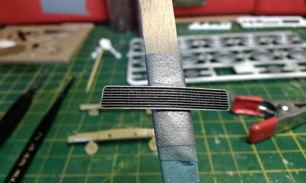

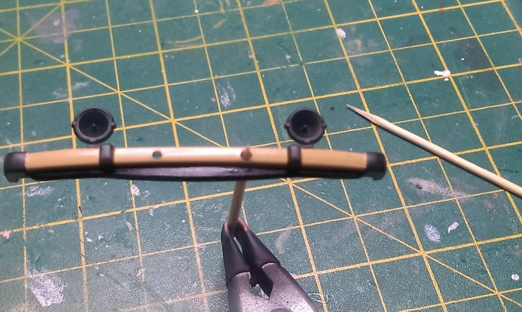

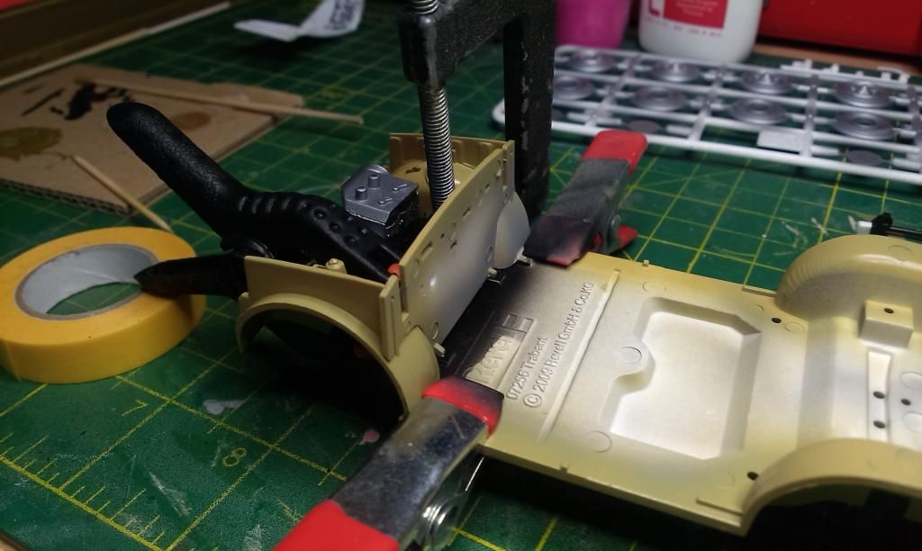

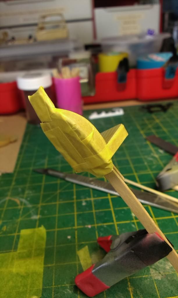

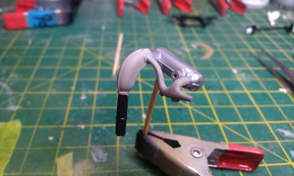

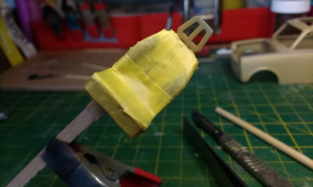

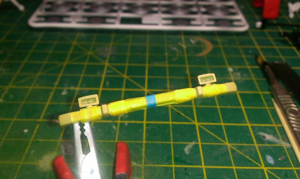

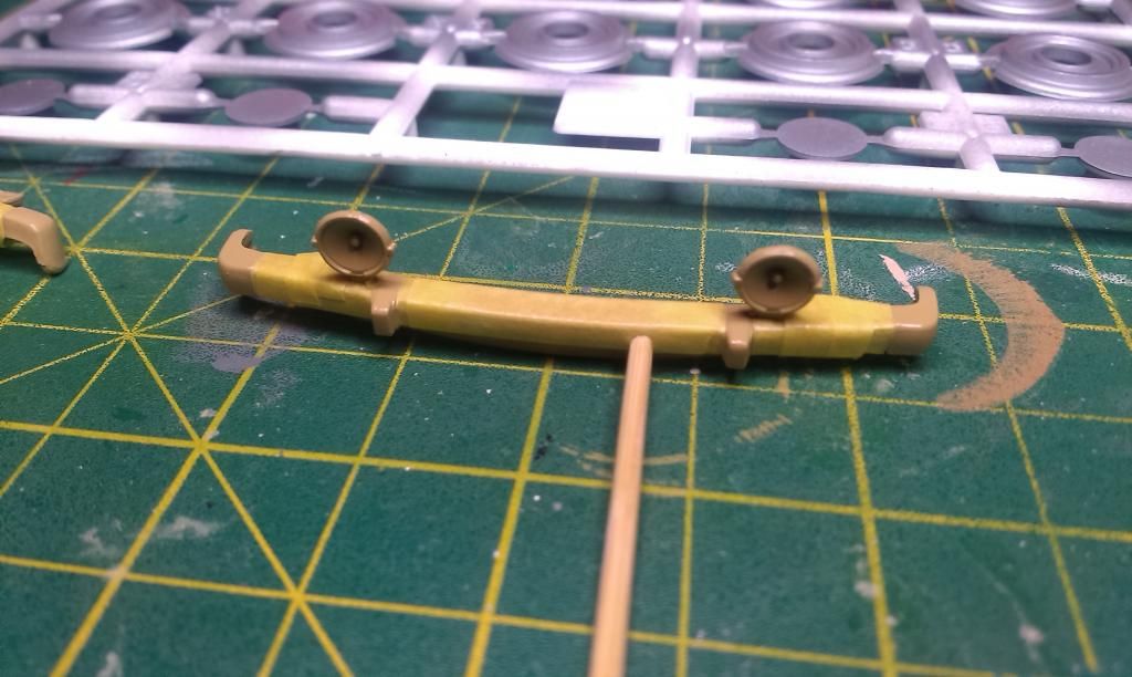

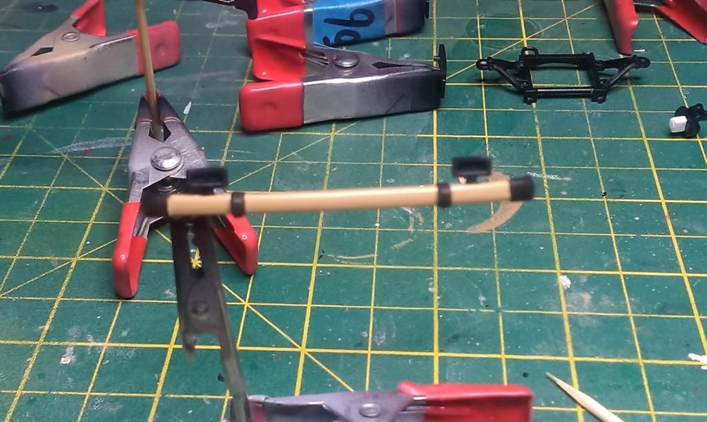

GeeBee Posted December 30, 2014 Author Share Posted December 30, 2014 (edited) Managed to spend a little time in the hobby room yesterday, Both the front & rear bumpers need a bit of masking after they had been painted body colour, as the fog lamps are molded as part of the bumper, plus the end caps and overiders needed to be painted in satin black Once they had been airbrushed and the masking tape removed, they looked like this Heat exchanger painted, I really should have painted the parts first before glueing them together, as masking was a complete PITA ... Engine bay is looking a little more complete Front grill finished Edited December 30, 2014 by GeeBee Quote Link to comment Share on other sites More sharing options...

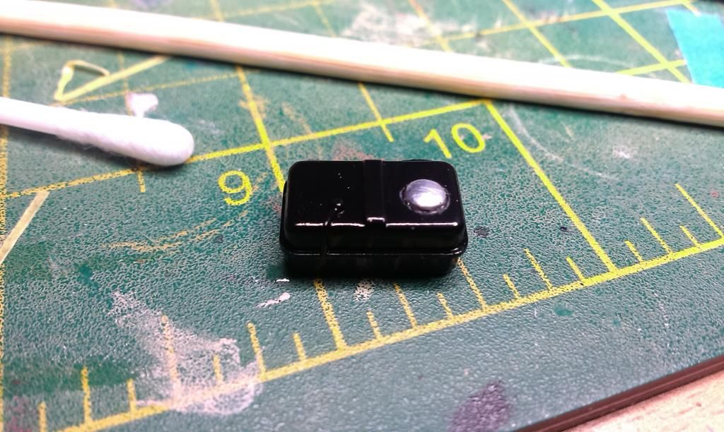

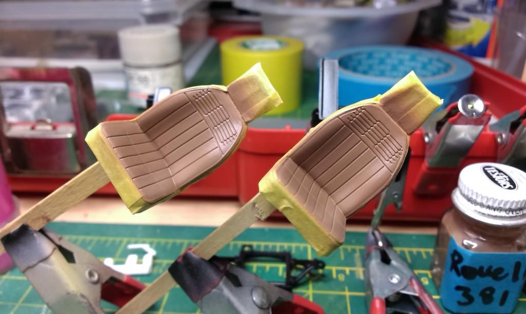

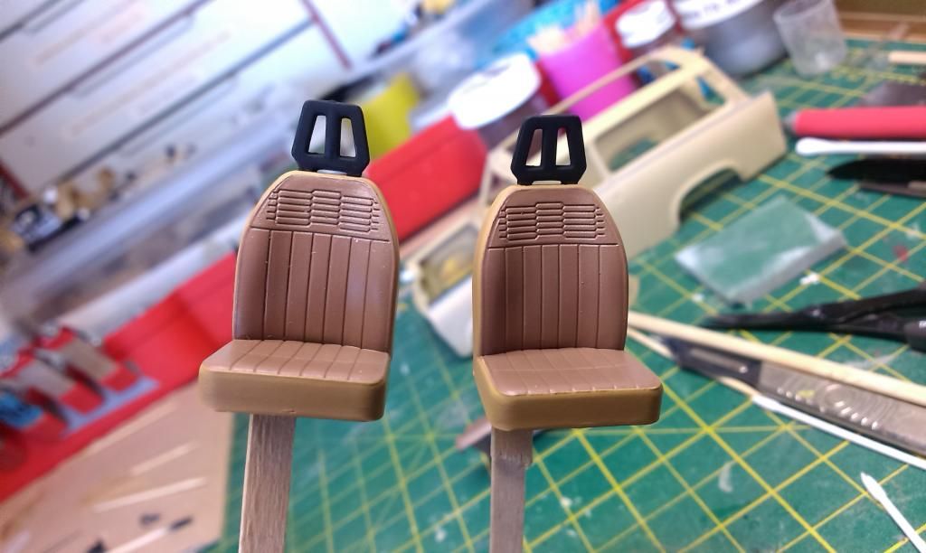

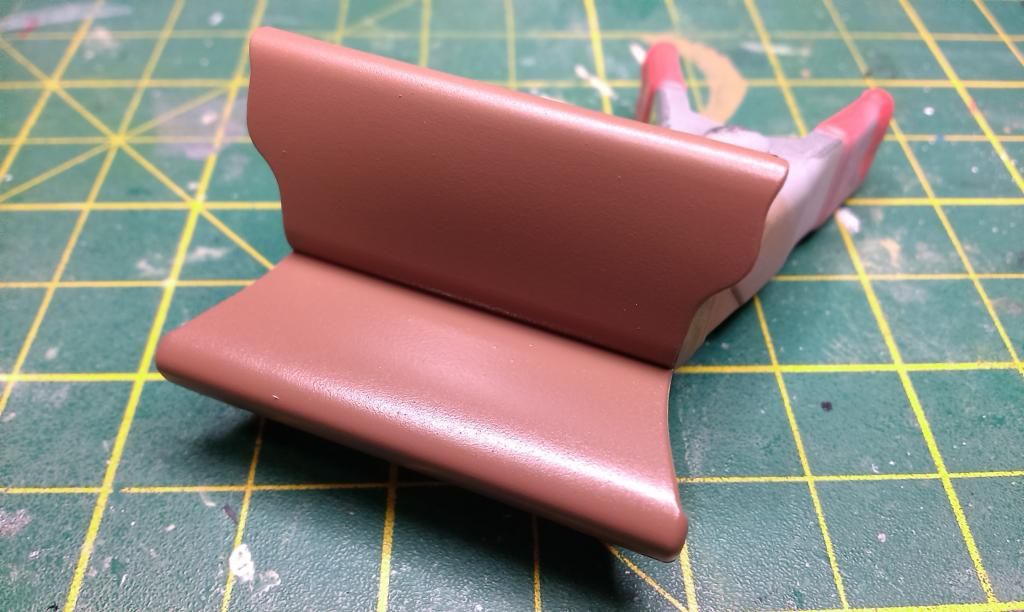

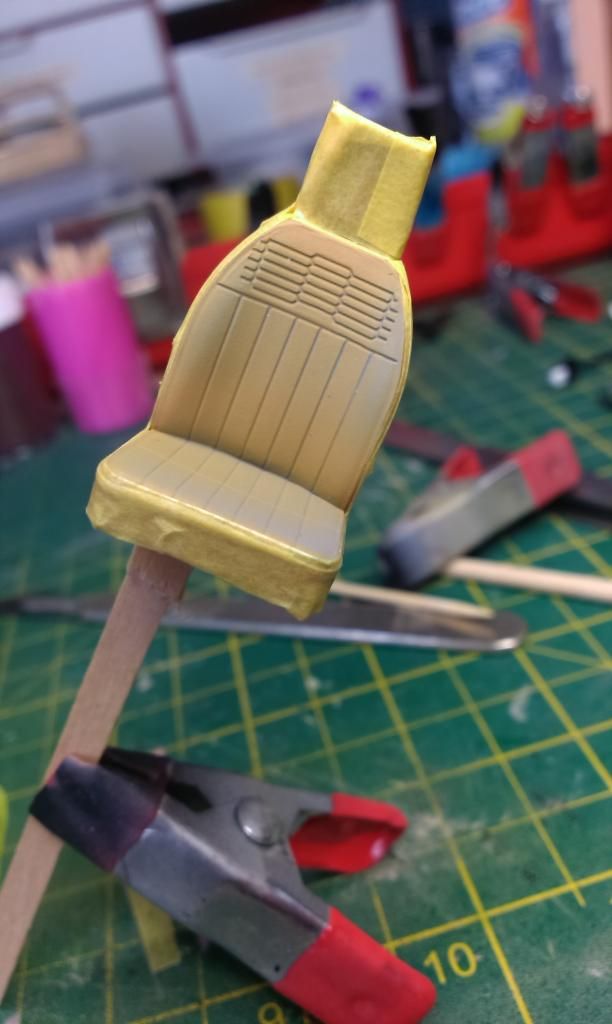

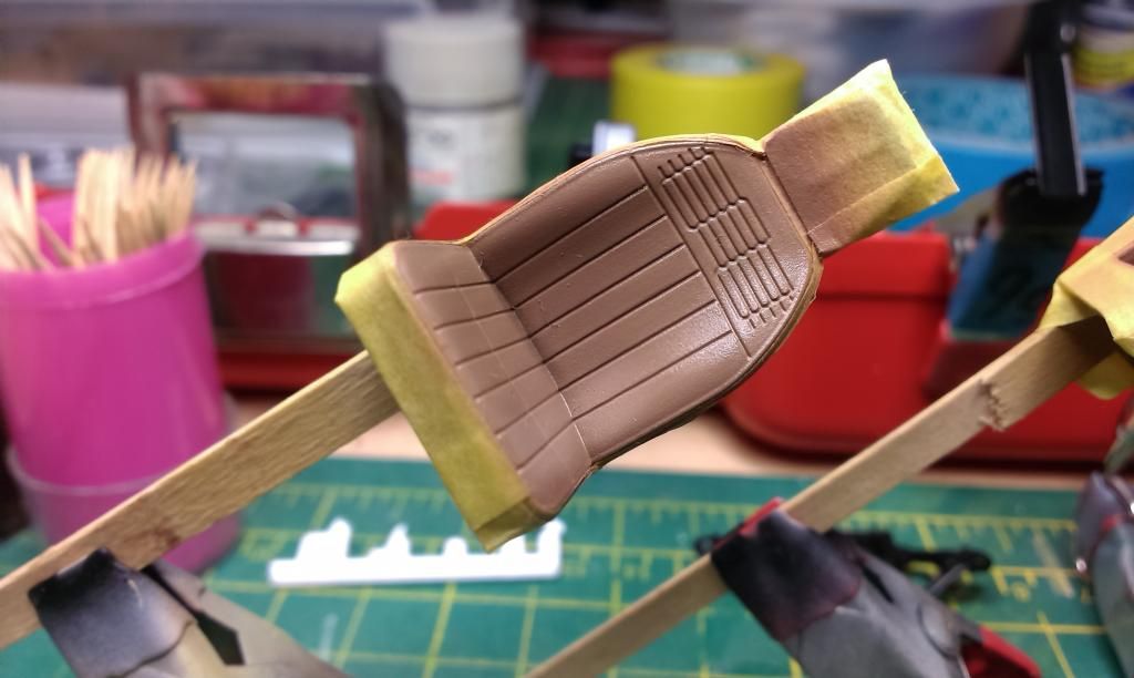

GeeBee Posted January 1, 2015 Author Share Posted January 1, 2015 I'll send you over that Boss 429 engine for it tomorrow Geoff! LOL Looking good young fella. Cheer's Shay ..... Been doing a little bit of the Trabbi over the last few days, a lot of time goes into masking, good ole Tamiya tape to the rescue, the seats will need masking again once the paint has dried so the head restraint can be painted matt black ... The front & rear seats are actually the same colour, the camera doesn't want to record them as such, the colour is more like the front seats .... The fuel tank was airbrushed in gloss black lacquer and the fuel caps was picked out using aluminium BMF Quote Link to comment Share on other sites More sharing options...

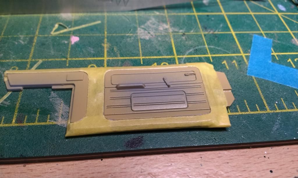

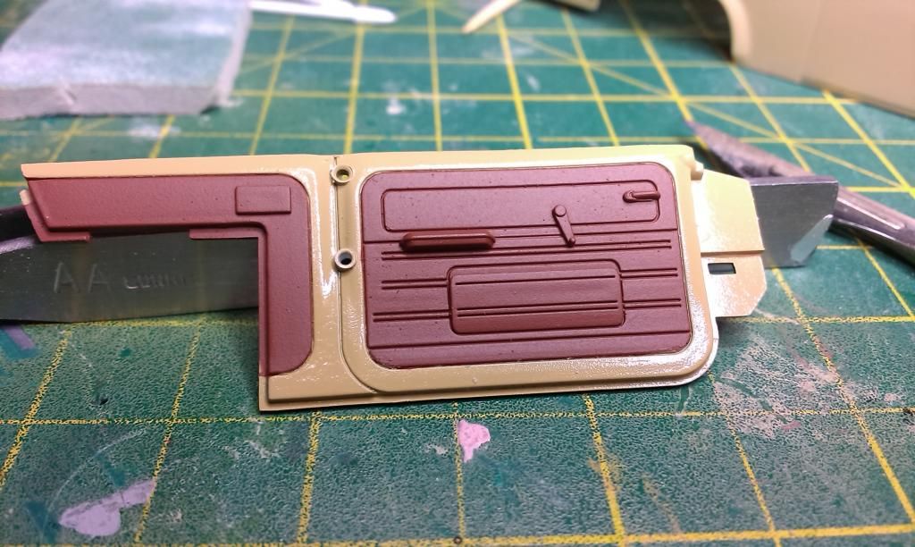

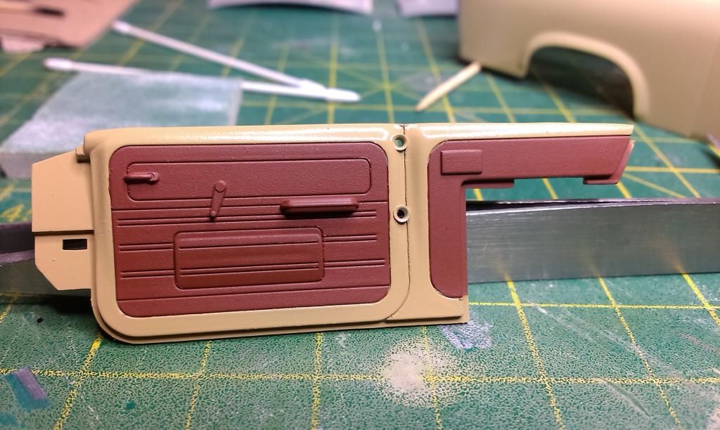

GeeBee Posted January 2, 2015 Author Share Posted January 2, 2015 Spent a good few hours in the hobby room today, got the seats finished, the side door panels were airbrushed using Testors leather, still needs masking to paint the door handles etc ... I was pretty happy with the masking on the side panels. Quote Link to comment Share on other sites More sharing options...

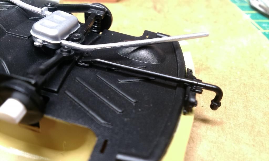

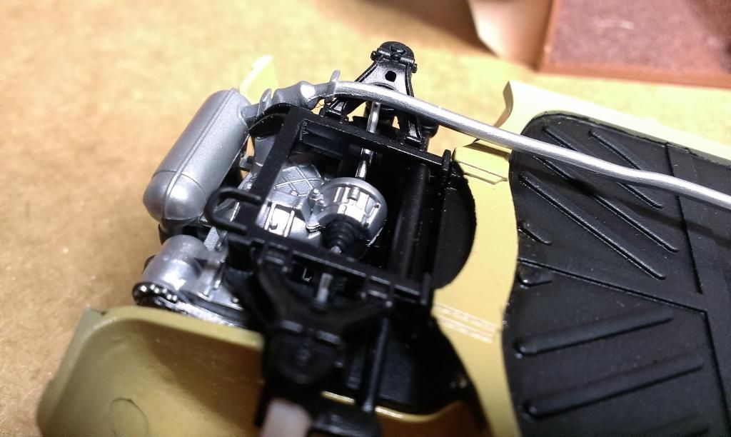

GeeBee Posted January 3, 2015 Author Share Posted January 3, 2015 Towbar and exhaust fitted, started to do the flocking on the interior, also got the wheels detailed, I was thinking of masking them up and airbrushing the centre black trim, but in the end I picked them out using a fine brush and Tamiya flat black acrylic Quote Link to comment Share on other sites More sharing options...
