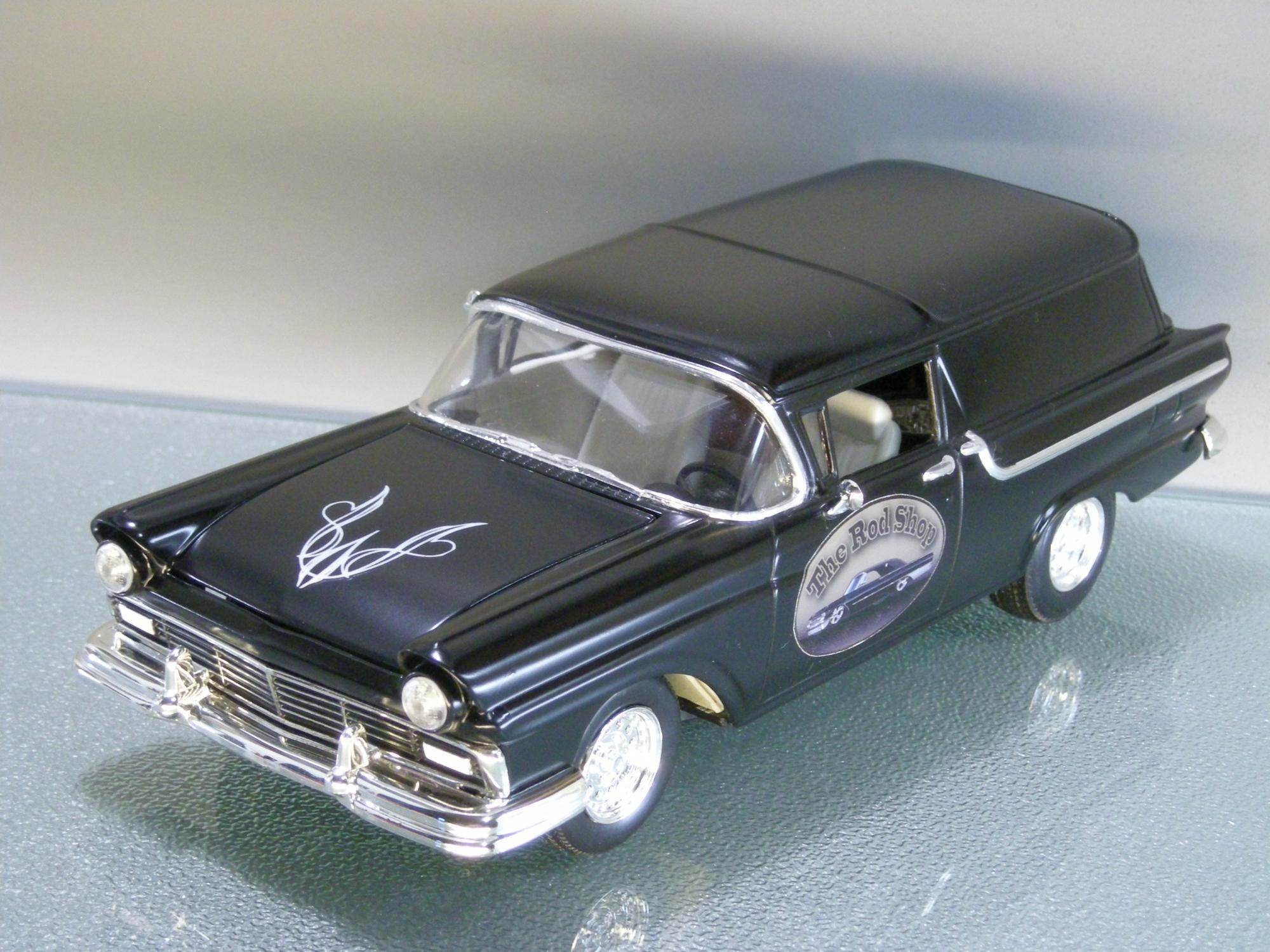

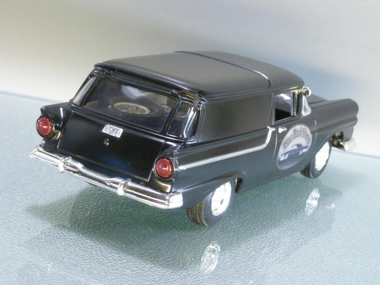

Here's one I built a couple years back, can't wait to see where you go with this.
Share this post
Link to post
