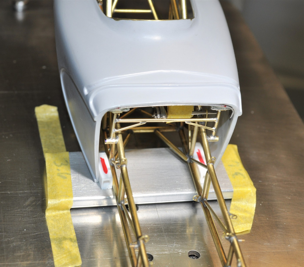

Codi Posted May 30, 2018 Author Posted May 30, 2018 Fantastic pic of your car Dave, please tell me you left 2 very long black streaks on the way out.......... Hey Art, been a while and I know you're busy but hope you find some time to post some updates on what you've been building of late. Always enjoy your work too. Scott & Dave, yeah, wish it was mine and what's really amazing is all of the custom fabrication that Dave did on his car from the engine and throughout. The man has some serious skills. For the record, I hate body brackets, interior tins etc. I was expecting to have all of this done a week or so ago. I've still got several days yet to wrap it up and finally onto paint. The first pics are of an aluminum tin for the underside that is form fitting to the body. When the other brackets/tabs are installed it should be a pretty clean look and functional. The next few pics are of the front body support and how it rests on the chassis. Cheers fellas!

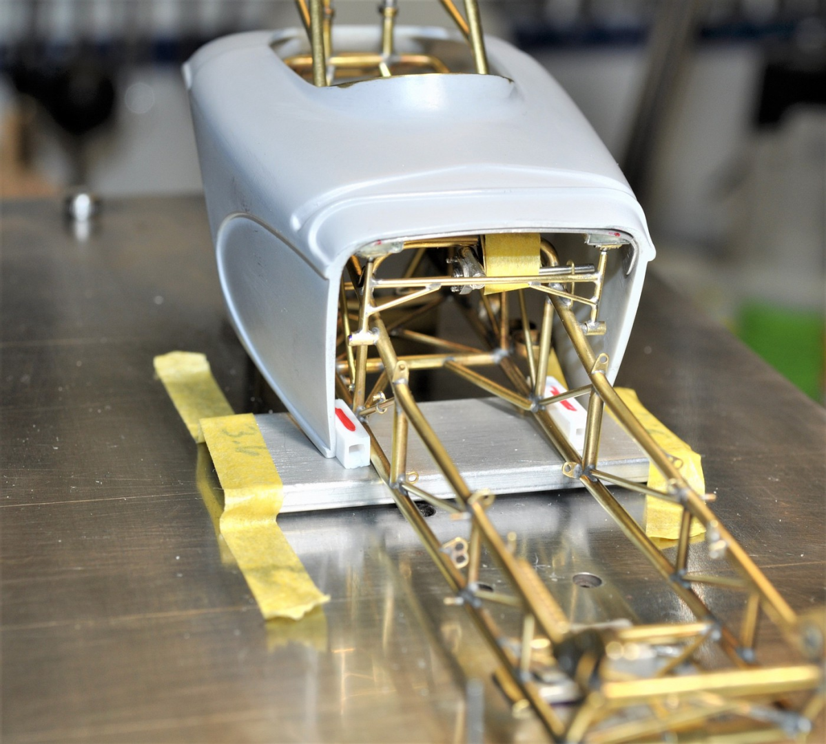

Codi Posted May 31, 2018 Author Posted May 31, 2018 Hey John, thanks for the comment. All is well just slow to get this done. It's hard to tell by looking at my pics but the tolerances are down to 1/64" in too many instances but I'm confident that final assembly will be okay by and large. 1/25th is a challenge that way as you know. I couldn't imagine building like those that do 1/32 or even 1/43rd. Brad, not at this time, I've thrown the calendar out on this one and I'm just slogging through it to get it done without compromising at this point. Today I made some additional supports / brackets for inside the body and a quick mock-up put a smile on my face as I think it'll look pretty sharp upon final assembly. Appreciate your interest still in the car. I've been spending too much time researching and pondering the pro mod which helps to motivate when I need a mental break from the bantam. What have you been working on as of late btw? cheers!

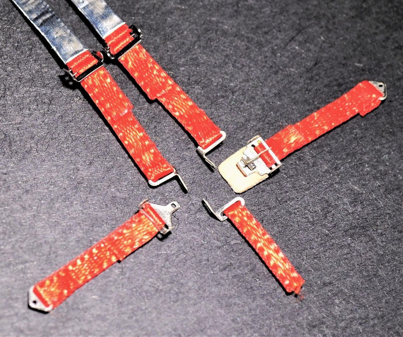

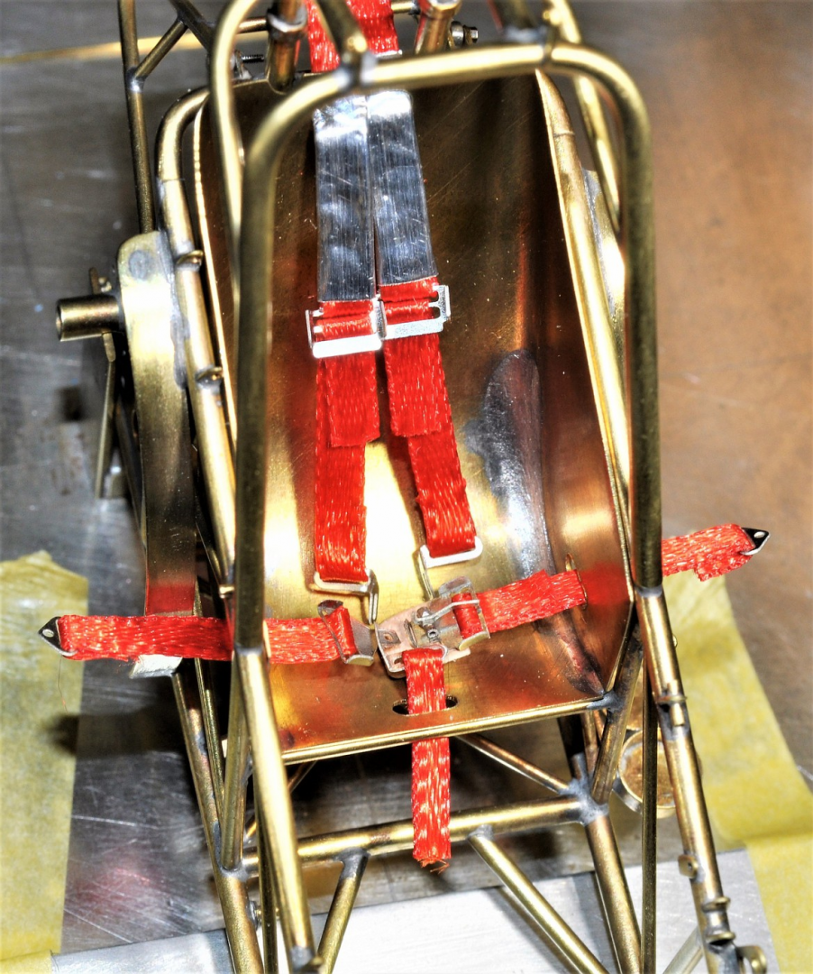

Codi Posted June 17, 2018 Author Posted June 17, 2018 Thank you fellas...........and for all of you that celebrate the day........HAPPY FATHER'S DAY! I spent part of mine on the bench today finishing up the belts. Earlier last week I experimented some more with the Caswell copy chrome plating and found a way that will work for the axle and other teeny brass parts. I took an earlier spare axle and wrapped it with copper wire and dipped it. Few minutes later I called it done and was pleased with it. Should work out well on all the upcoming plating that I'll do for the car. Along the way I did decanted some Tamiya primer and shot it through my airbrush. Couldn't be happier in that there was ZERO bleed through of my earlier bondo/body work. this time. It's ready for final primer and paint top side. I'll primer the under body and paint it flat black before doing so. Lastly, as noted I wrapped up the 5 point belts. They're a bright red that didn't show too well in my photos. I'm going to try to nickel plate the seat and if it turns out then they should contrast really well. Next up is cleaning upu the chassis and then primer and paint. btw, the PE belt hardware was from Futurattraction. Cheers everyone! Tim My Caswell Chrome experiment Primered body Finally, the belts..........these took me an entire week to complete as an fyi.........Teresi would have started AND finished an entire car in that amount of time.... Just have to add the Simpson decals. I did find a piece of leather at Hobby Lobby that I skived to get it suitably thin for the waist belt also.

Codi Posted June 18, 2018 Author Posted June 18, 2018 Thanks so much Dave & Chris............btw Chris, I pulled a bonehead on the belts and I'm re-doing them. I just didn't like how unrealistic they looked on the seat, they just wouldn't lay down properly because of the material I chose...............soooooo, I looked at YOUR belts on YOUR Vega funny and saw you used medical tape to get the right look and drape. I pulled out my medical tape and "colored" it with a red sharpie and presto-change-o, a properly looking belt. Yes, I'm re-doing them as we speak. Should have checked your thread in the first place or at least given ya' a call. Gotta go, those belts aren't going to re-do themselves. cheers

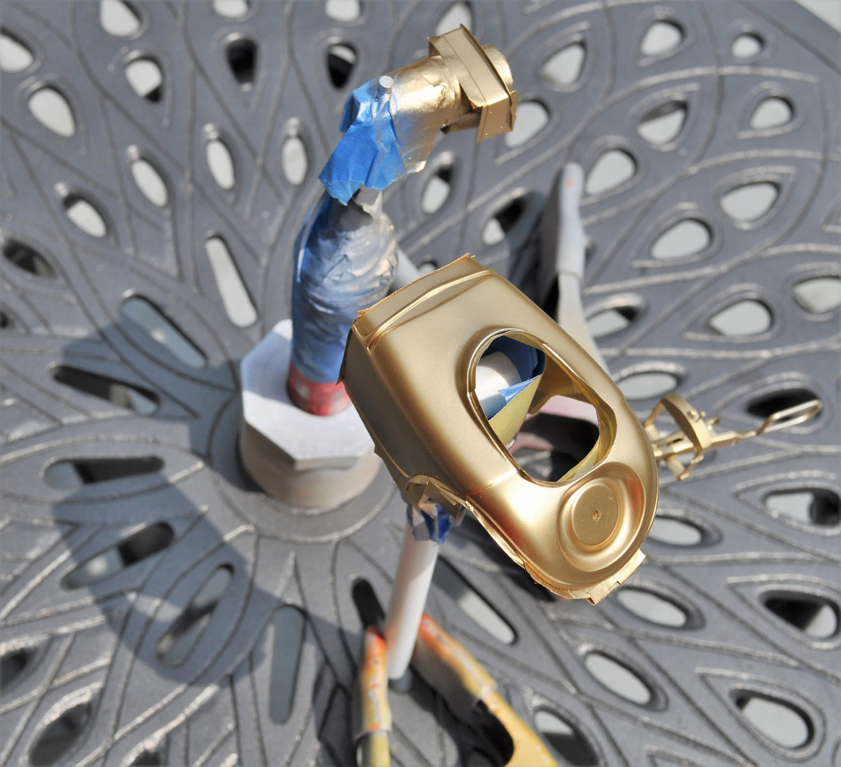

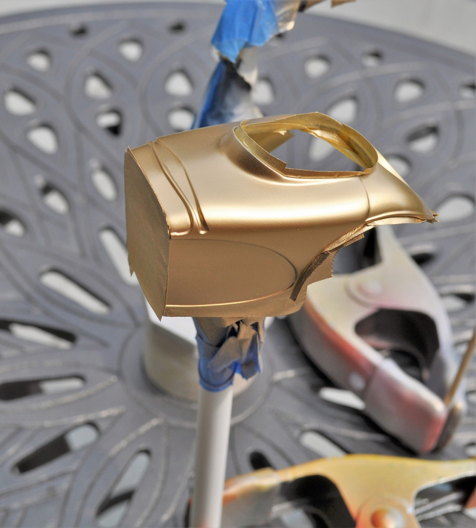

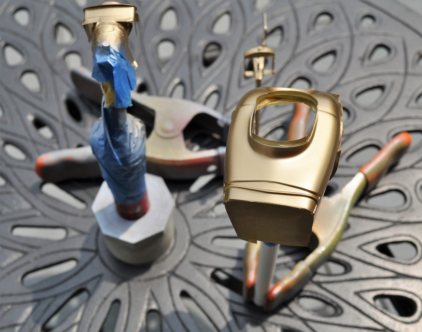

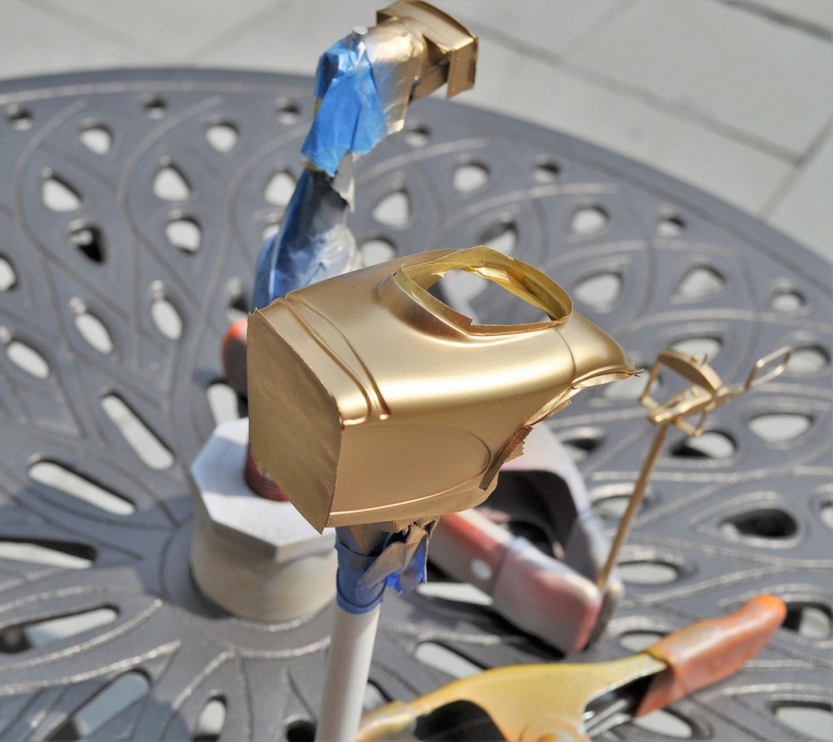

Codi Posted August 10, 2018 Author Posted August 10, 2018 Gold base is done. I'll get the chassis done this week, just a few more tabs to add, then finish body itself in Kandy Red. I want to take a second and thank John Teresi for his insights on how he lays down such beautiful paint jobs. His tips have proven helpful and I'm sure they'll help me to get a decent final product. cheers
