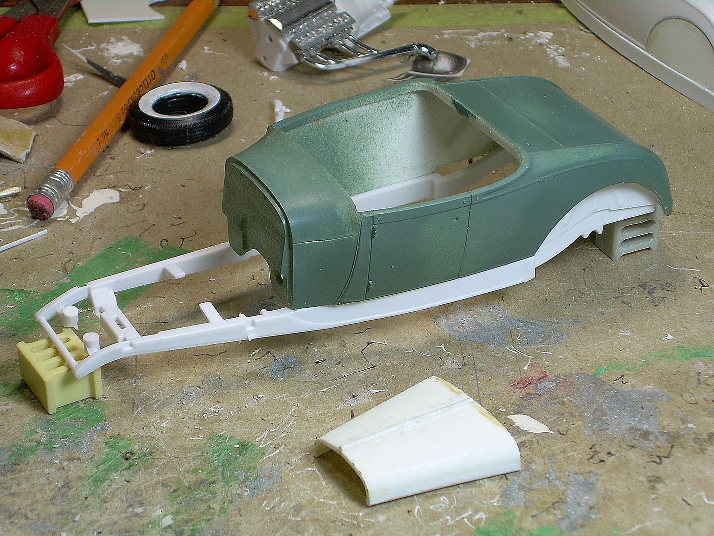

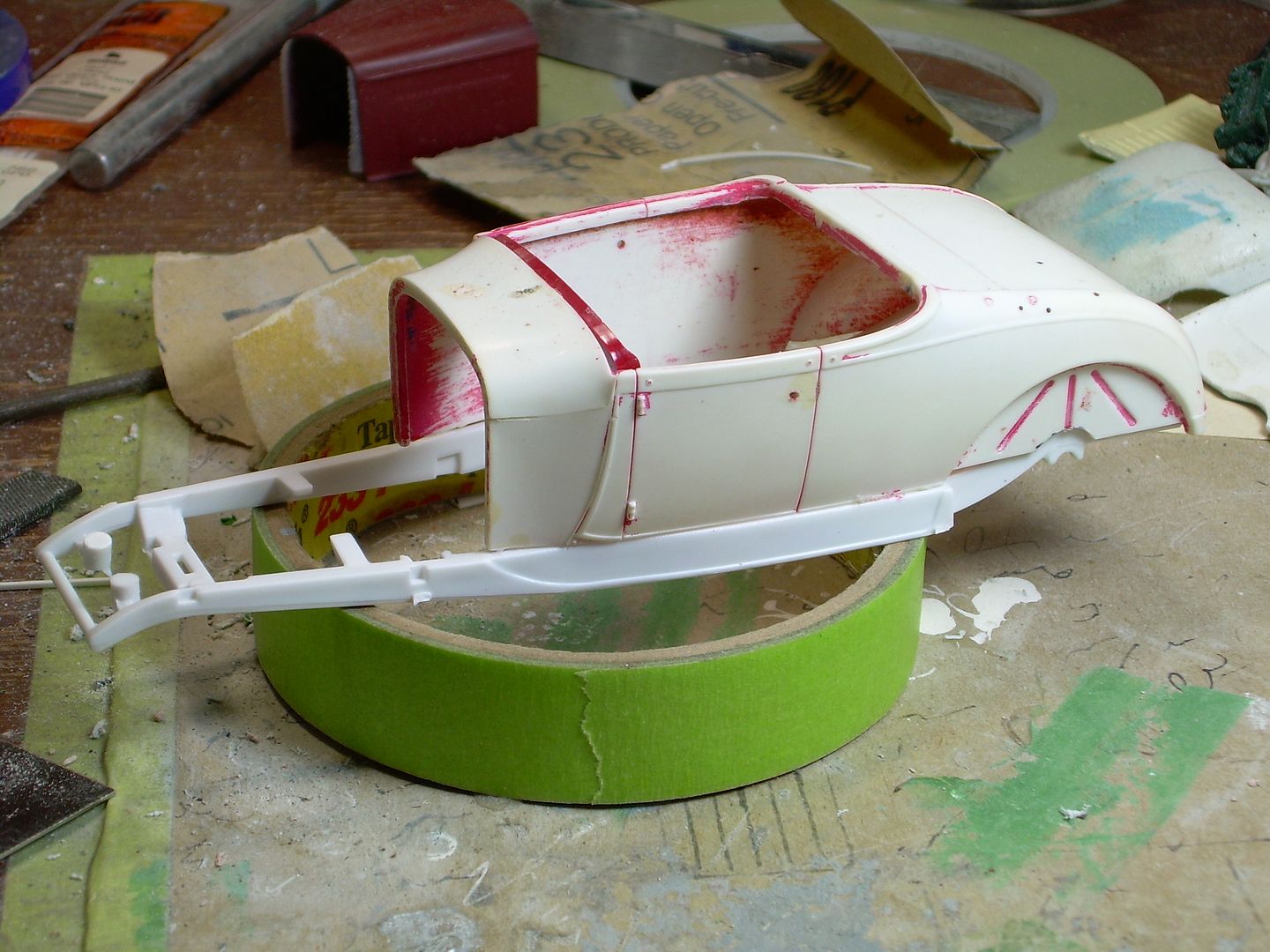

Ace-Garageguy Posted June 6, 2016 Posted June 6, 2016 (edited) A '29 Ford body, roadster or pickup, is significantly narrower than the stock '32 frame rails. However, '29 fords in every description imaginable have been built on '32 rails. You just have to narrow the rails a suitable amount...in 1:1 and in the model world. The Revell rails you refer to are too wide to look right under the old AMT '29 Ford body too. Here, they've been narrowed. by removing meat from the ends of the crossmembers and re-gluing. You'll have to narrow them even more of you want to channel the body. Edited June 6, 2016 by Ace-Garageguy
