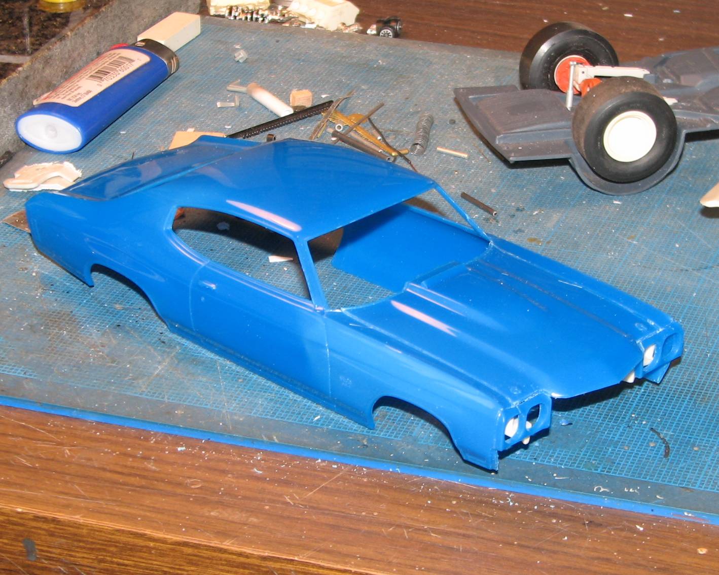

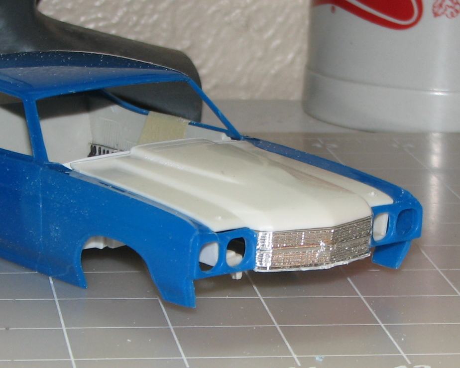

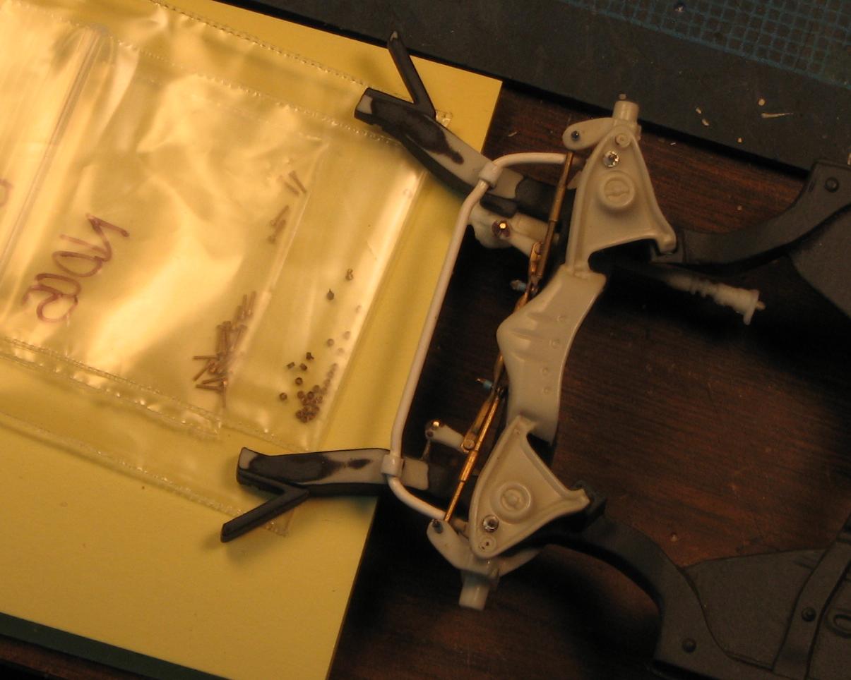

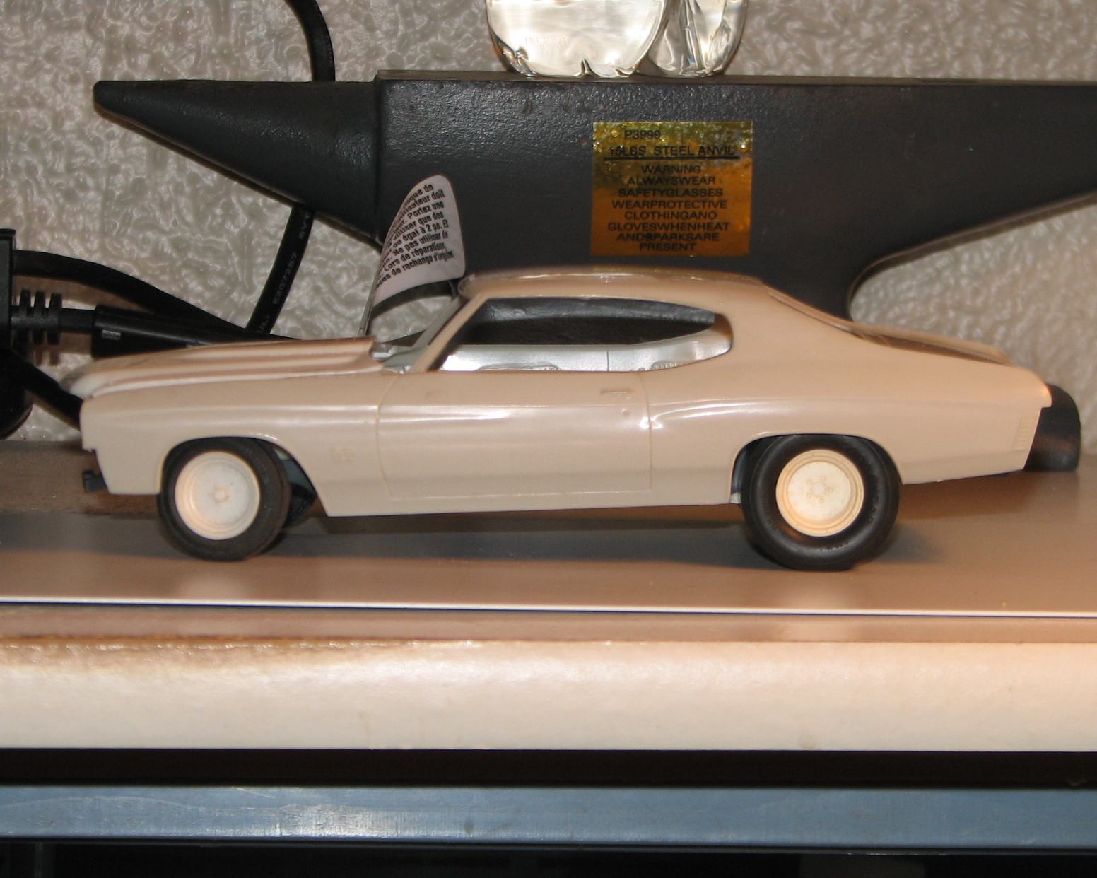

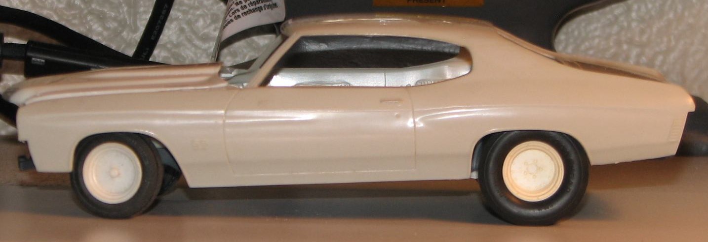

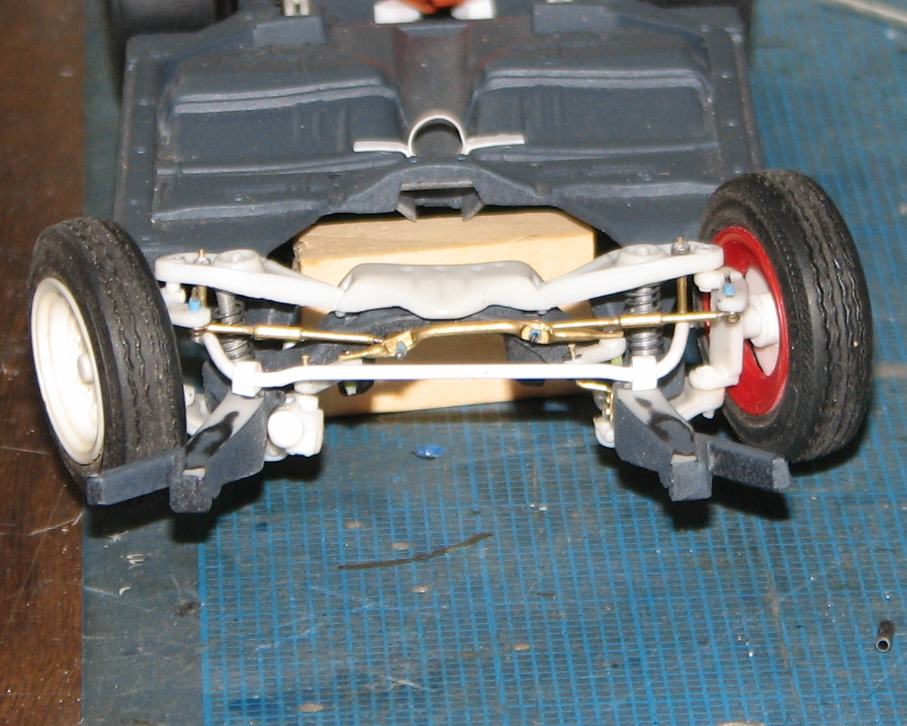

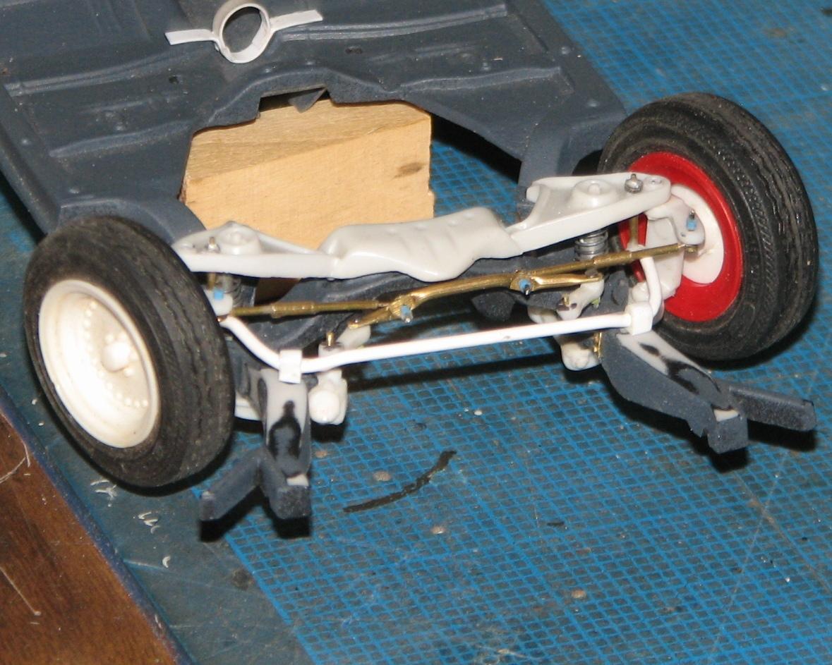

Straightliner59 Posted July 4, 2017 Author Share Posted July 4, 2017 (edited) How's the Revell body? I picked up one of their snap kits, today, and that body doesn't have the side issue, at all. Looks great, in fact, in that regard. The character lines just fade down into the fenders. If I am going to go through all this work on the front suspension, then, it's pretty important for the body to be right. Ordered these nuts and bolts, online. I think I am going to use them to do the final assembly on this suspension. Yeah, they're tiny! Edited July 4, 2017 by Straightliner59 Quote Link to comment Share on other sites More sharing options...

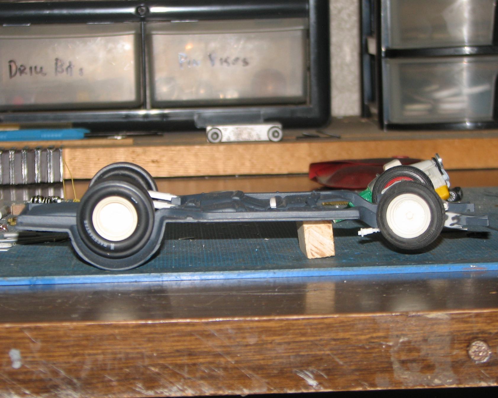

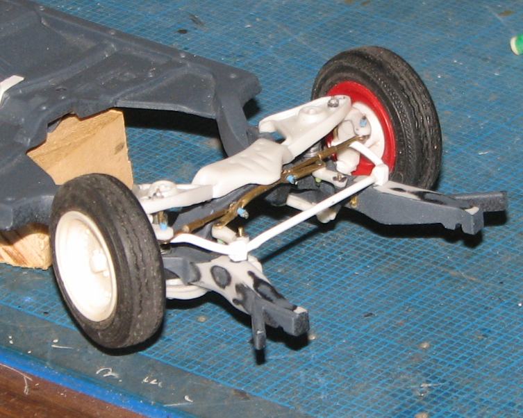

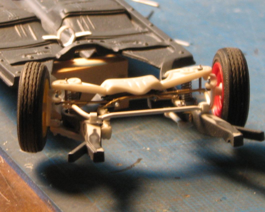

Straightliner59 Posted July 6, 2017 Author Share Posted July 6, 2017 For the first time, I have all the wheels on the chassis. I'd say the chassis was on the wheels, but I forgot to tacky glue the lower A-arm assembly to the chassis, so this will have to do, for now. Next up, I will turn the front rotors, and get the front brakes set up. I haven't yet decided on discs or drums, for the rear. Quote Link to comment Share on other sites More sharing options...

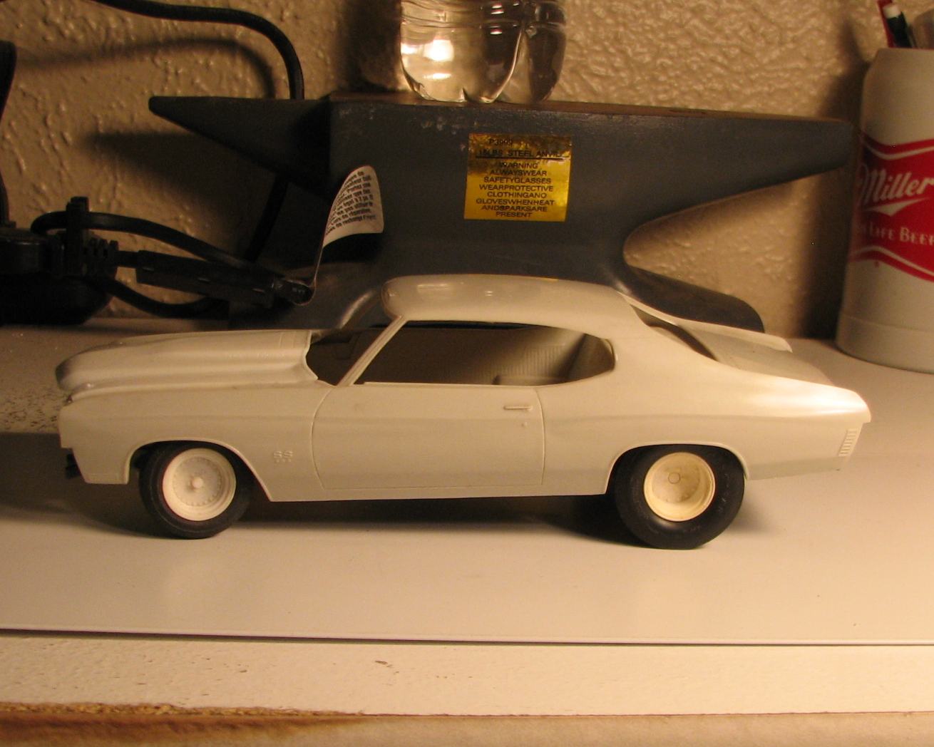

bisc63 Posted July 7, 2017 Share Posted July 7, 2017 That front suspension is beautiful work, and will paint up nicely! That Revell SnapTite Chevelle is a really nice kit, and is arguably the most accurate '70 Chevelle body we have to work with. It wouldn't take alot to open up the hood and use over a full detail chassis. It gets points in my book for being in God's Favorite Scale ; 1/25. Still, there's something satisfying about beating the old AMT body into shape. Will be watching... Quote Link to comment Share on other sites More sharing options...
Straightliner59 Posted July 7, 2017 Author Share Posted July 7, 2017 That front suspension is beautiful work, and will paint up nicely! That Revell SnapTite Chevelle is a really nice kit, and is arguably the most accurate '70 Chevelle body we have to work with. It wouldn't take alot to open up the hood and use over a full detail chassis. It gets points in my book for being in God's Favorite Scale ; 1/25. Still, there's something satisfying about beating the old AMT body into shape. Will be watching... Thanks for the kind words, re: the suspension. I think I have about 30 hours in it, and that might be conservative! I am still interested in seeing your rear window treatment. I started working on mine, but am not sure I'm going about it correctly. The body sides don't look to be too difficult to correct. That said, I am giving the Revell body some consideration. Here's the car finally on the wheels... Quote Link to comment Share on other sites More sharing options...

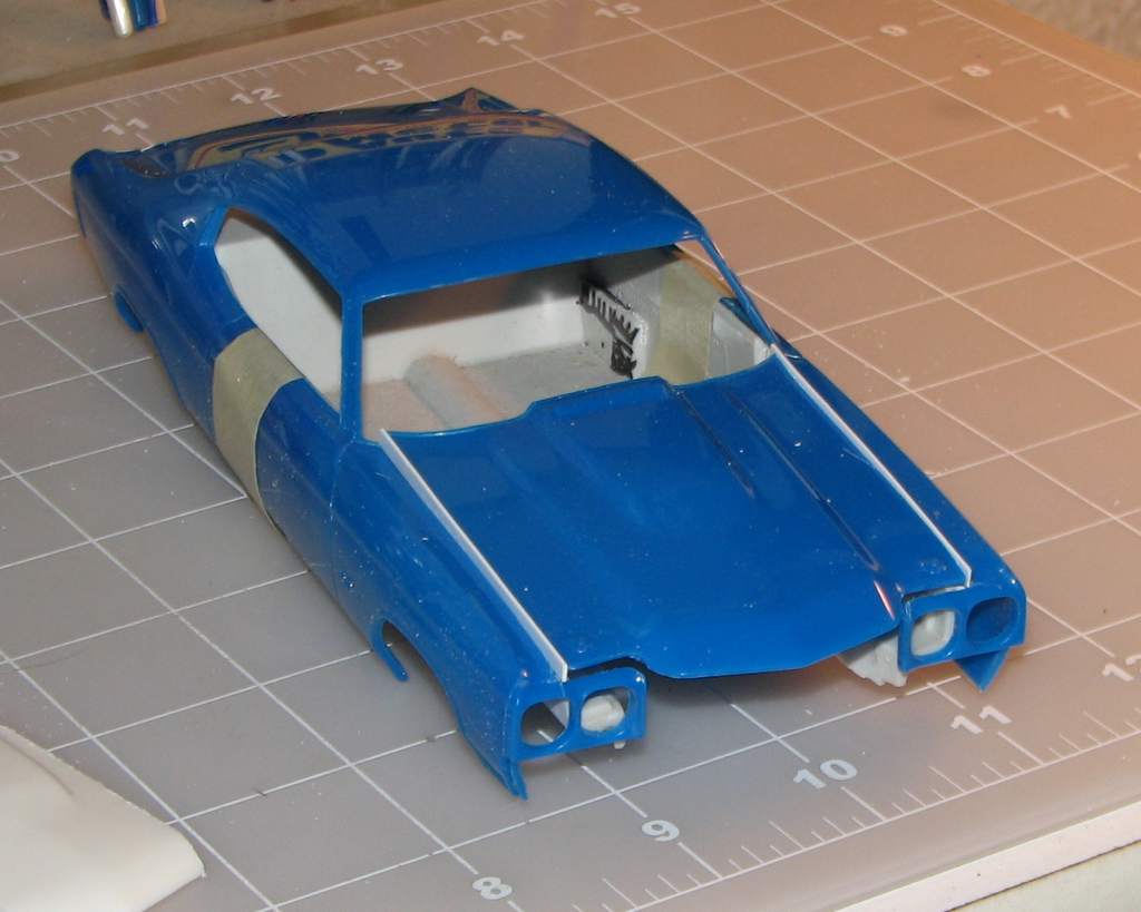

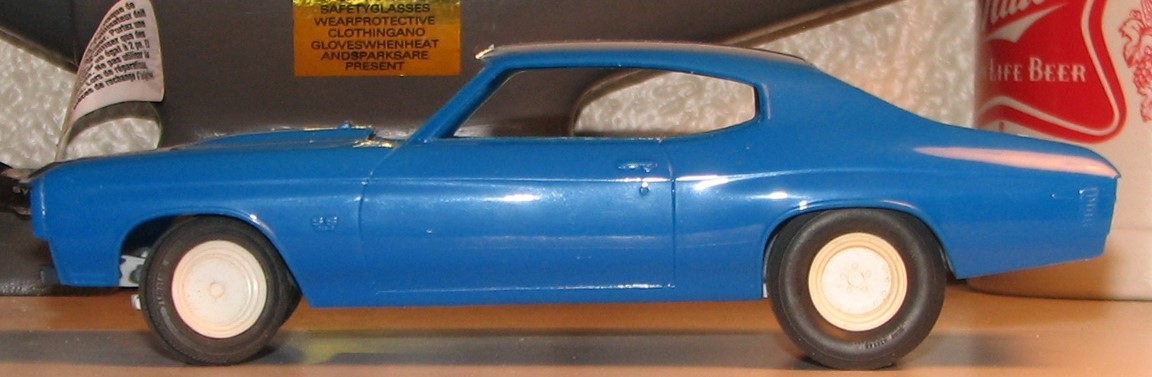

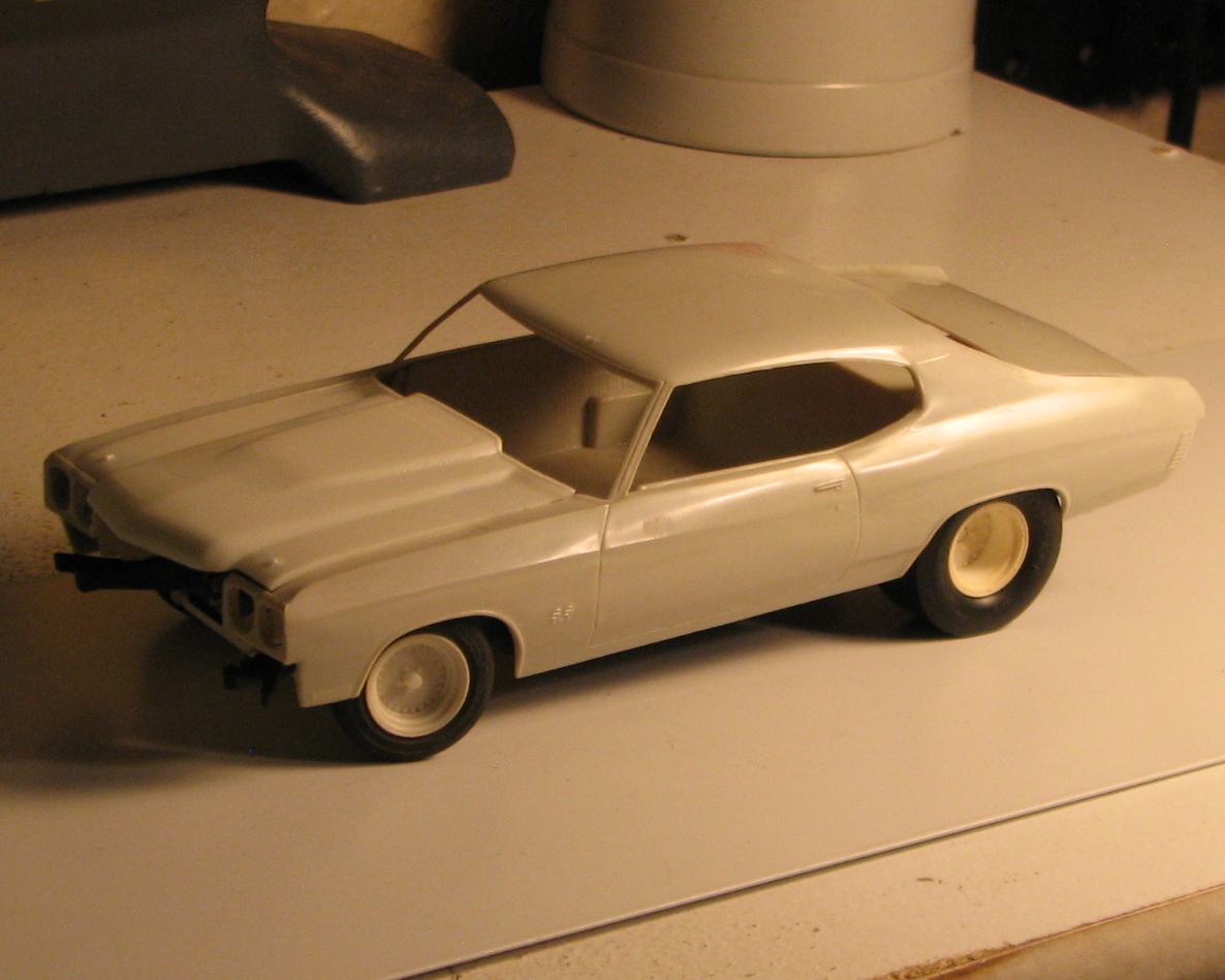

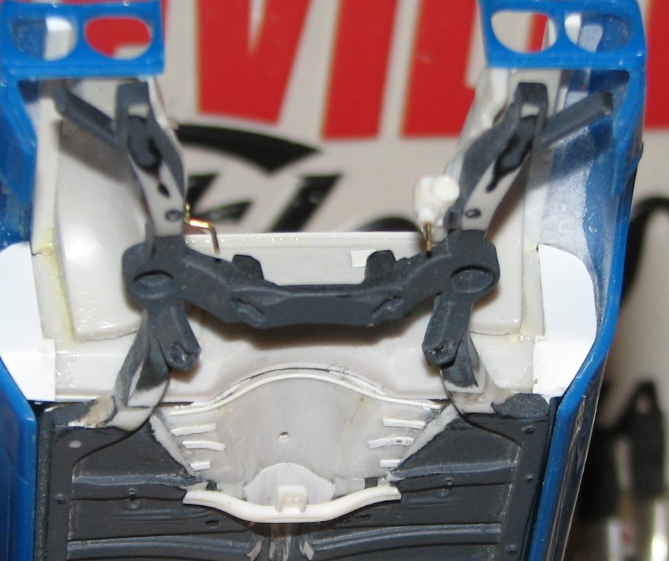

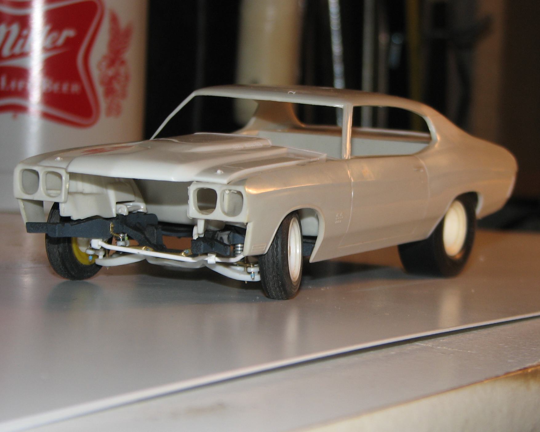

Straightliner59 Posted July 8, 2017 Author Share Posted July 8, 2017 I've decided to go with the Revell SnapTite body. It's much nicer, and actually fits the AMT chassis better than the AMT body does--check the alignment of the tires/wheels in the wheelwells. It will work with the AMT interior tub (I favor it, because it doesn't have the rear seat, which is legal for MP, so long as the area's "finished"), which I will fit with the side panels from the snapper. I got two photos taken before the tacky glue bond came apart, and the front suspension collapsed--again! Can't wait until THAT assembly is finally assembled and mounted. Alas, that's going to be a while, yet... Quote Link to comment Share on other sites More sharing options...
Straightliner59 Posted July 8, 2017 Author Share Posted July 8, 2017 I'd like to thank Mr. Gribble...er, Shackleford for his input and interest in this project. Without it, I'd never have noticed/learned of the shortcomings of the AMT body. Quote Link to comment Share on other sites More sharing options...
Draggon Posted July 8, 2017 Share Posted July 8, 2017 There's a surprising amount of difference in the rear wheelwells, the slicks sure do fit the snap body better. That's got to be the most detailed and accurate front suspension work I've seen on a Chevelle. Good work! Quote Link to comment Share on other sites More sharing options...
Straightliner59 Posted July 8, 2017 Author Share Posted July 8, 2017 There's a surprising amount of difference in the rear wheelwells, the slicks sure do fit the snap body better. That's got to be the most detailed and accurate front suspension work I've seen on a Chevelle. Good work!Thanks, Glenn! It's definitely the most effort I've ever put into a front suspension. Your words are much appreciated! That snap body is really nice. Wish they'd use it as the basis for a full detail kit! Quote Link to comment Share on other sites More sharing options...

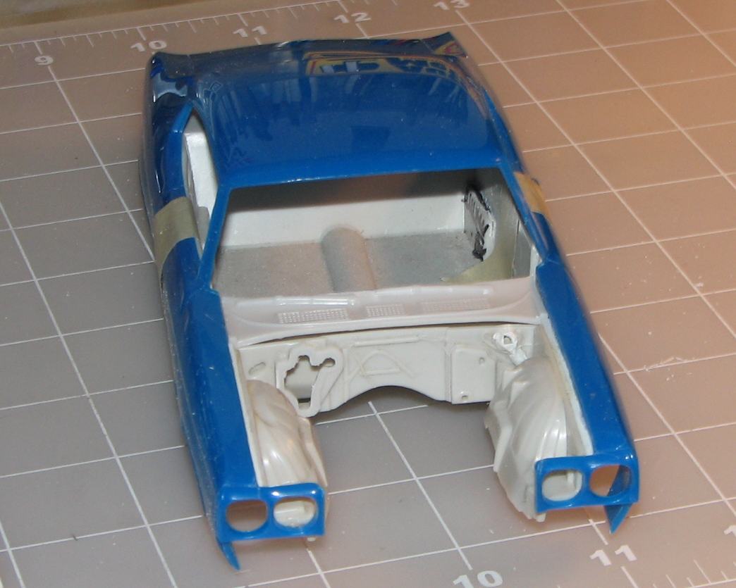

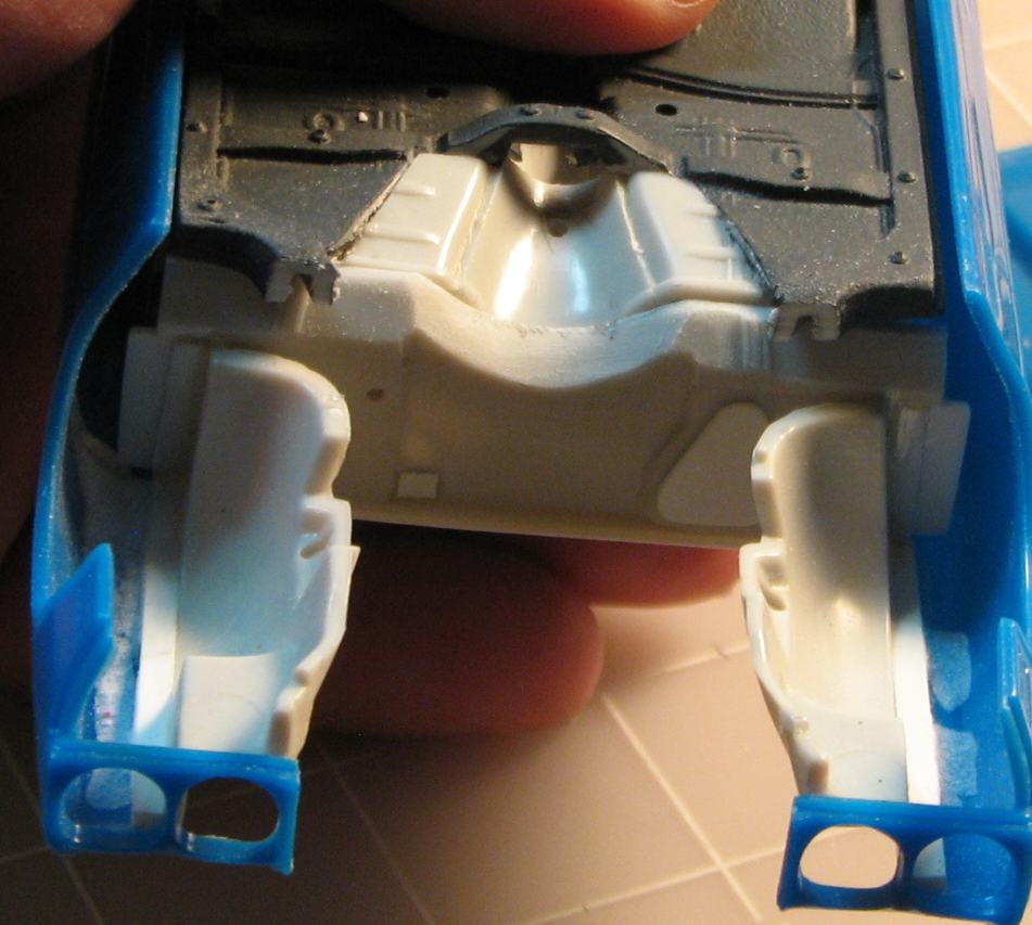

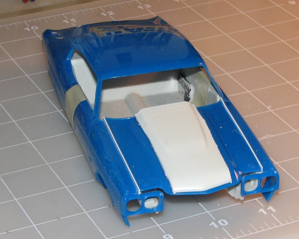

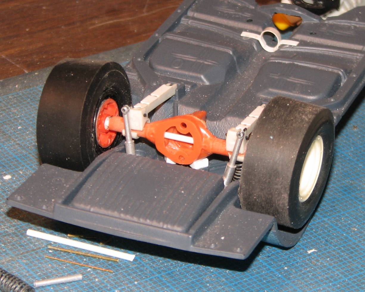

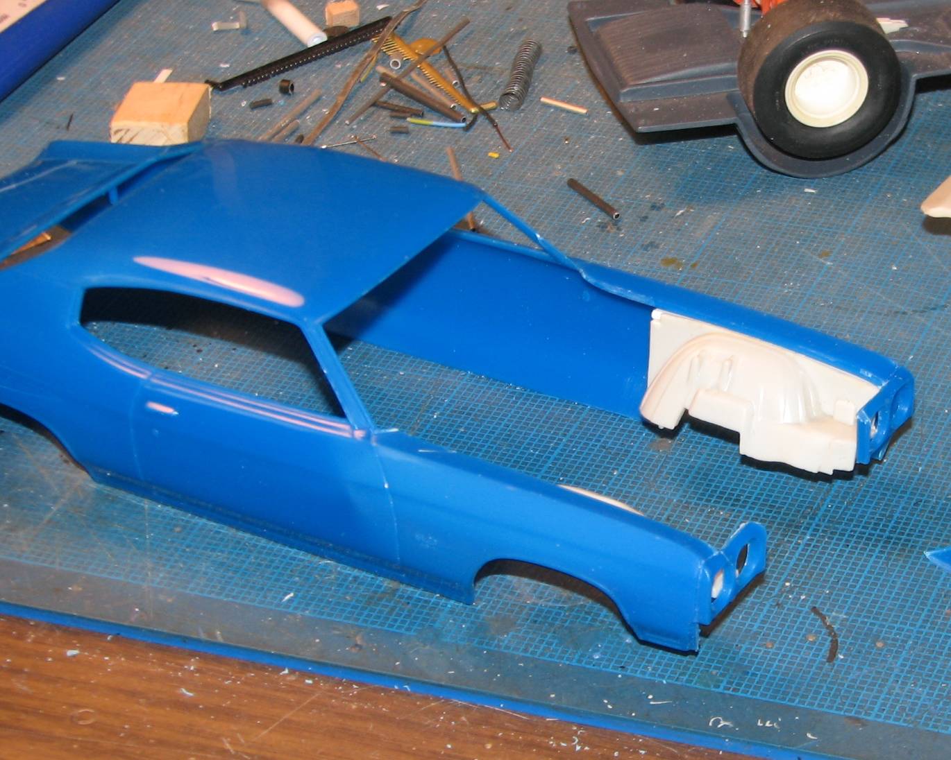

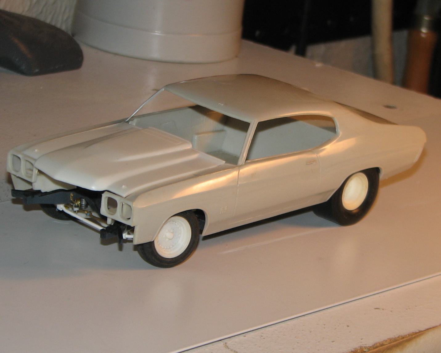

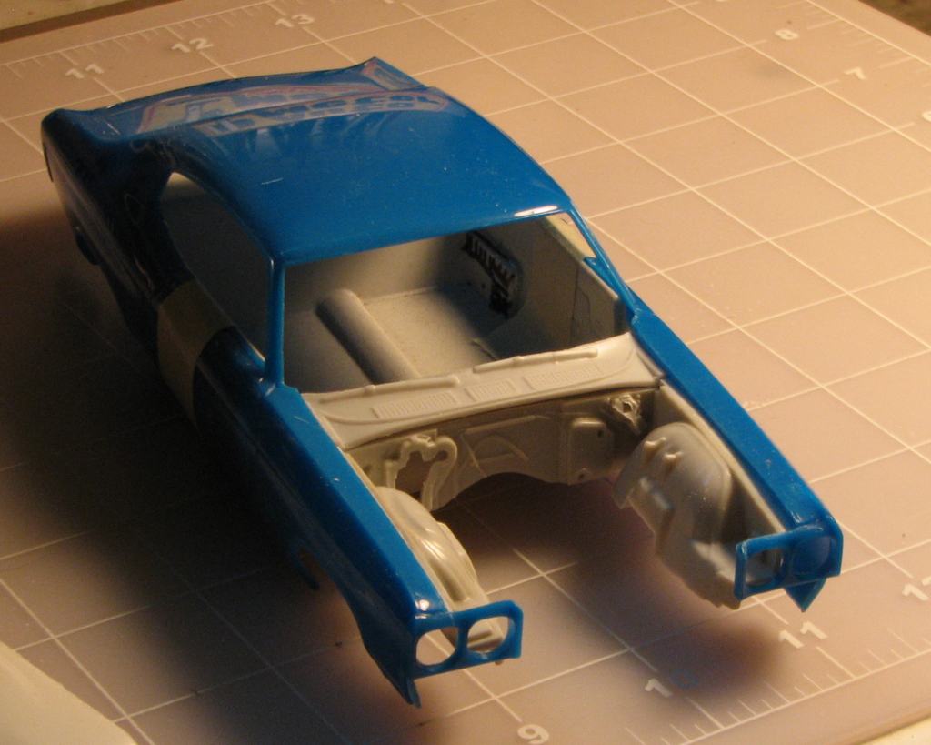

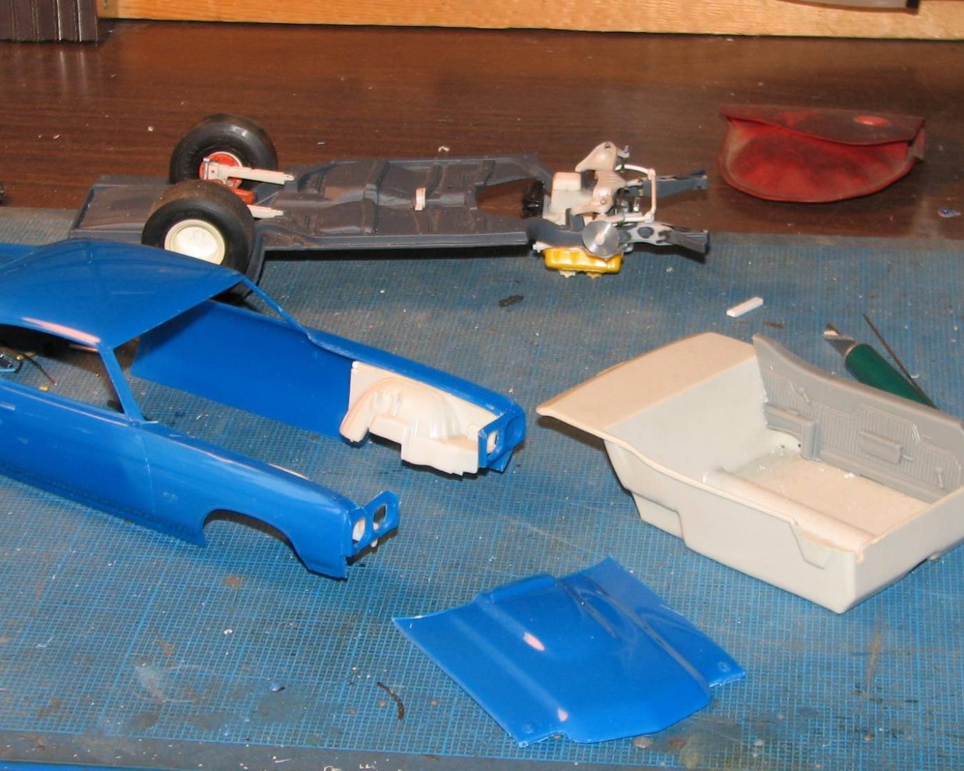

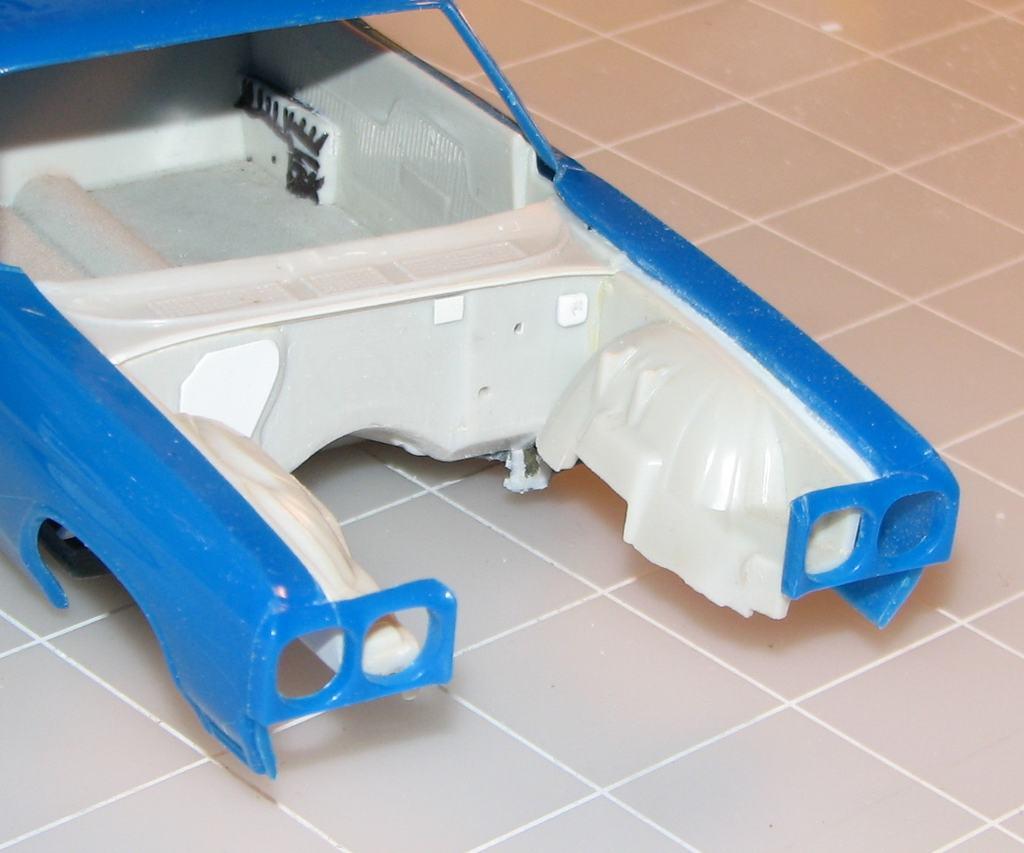

Straightliner59 Posted July 12, 2017 Author Share Posted July 12, 2017 Update: I got the hood cut out of the SnapTite body, and installed the inner fender wells. Rear shocks are built from aluminum tubing. The "eyes" are glued to the shocks with JB Weld. There's a small amount of material that needs to be removed from the back seat area of the AMT tub, so that the Revell side panels will fit in the interior properly. Next up, I am going to begin working on the cowl/firewall assembly. Quote Link to comment Share on other sites More sharing options...

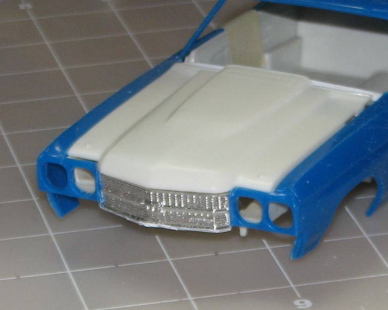

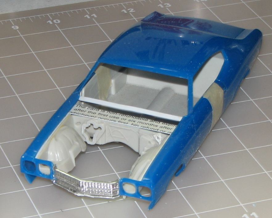

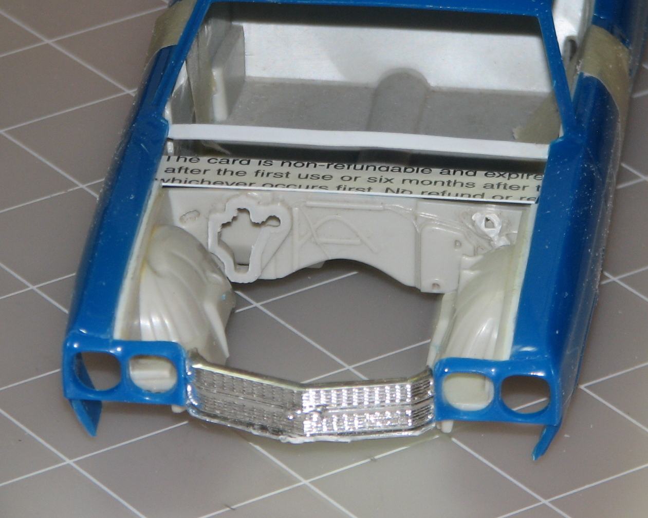

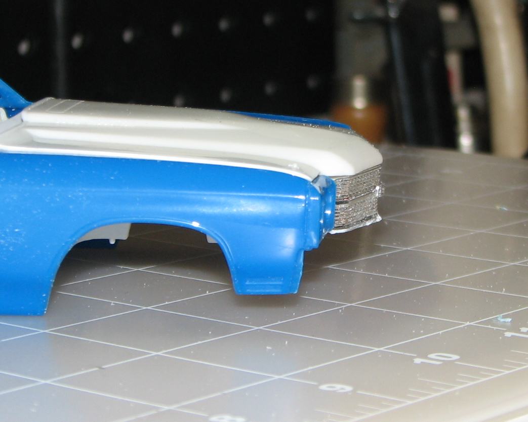

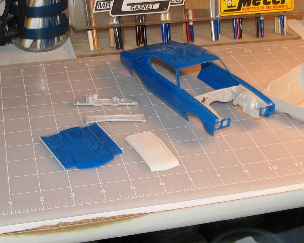

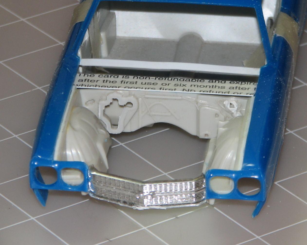

Straightliner59 Posted August 13, 2017 Author Share Posted August 13, 2017 (edited) Been a while since I updated this thread. That's mainly because I was struggling with how I was going to do the cowl; In the meantime, I finished up a couple of projects that were close to complete. Those are now posted on the Drag Racing Models thread/board. I digress. A friend suggested the cowl from AMT's '68 El Camino. Bingo! It's now cut to size. I think I am going to clean it all up (no need for wipers on a MP racer!), open the grilles and install some sheet to replicate the duct/plenum, beneath. I've also cemented strip to the edges of the hood, to replace the kerf from removing it from the body. I'll remove the heater and wiper motor from the firewall, as well--again, no need for that stuff on a race car! I'll also install the Cowl Induction scoop from AMT's '70 Chevelle (thanks, Rusty Shackleford! Good call!). Not a ton of physical progress, but, progress nonetheless. The Revell hood will need to be thinned considerably, but, it appears that the hood will nestle beautifully between the fenders, once it's cleaned up. Edited August 13, 2017 by Straightliner59 Quote Link to comment Share on other sites More sharing options...

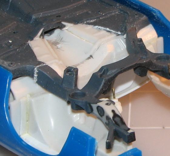

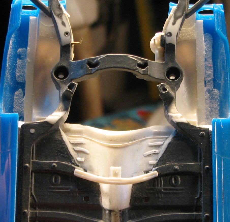

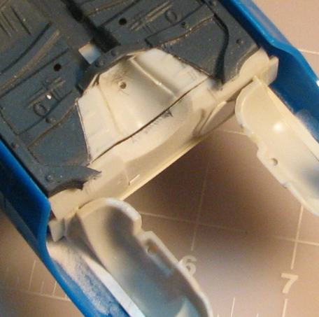

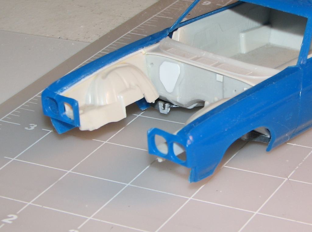

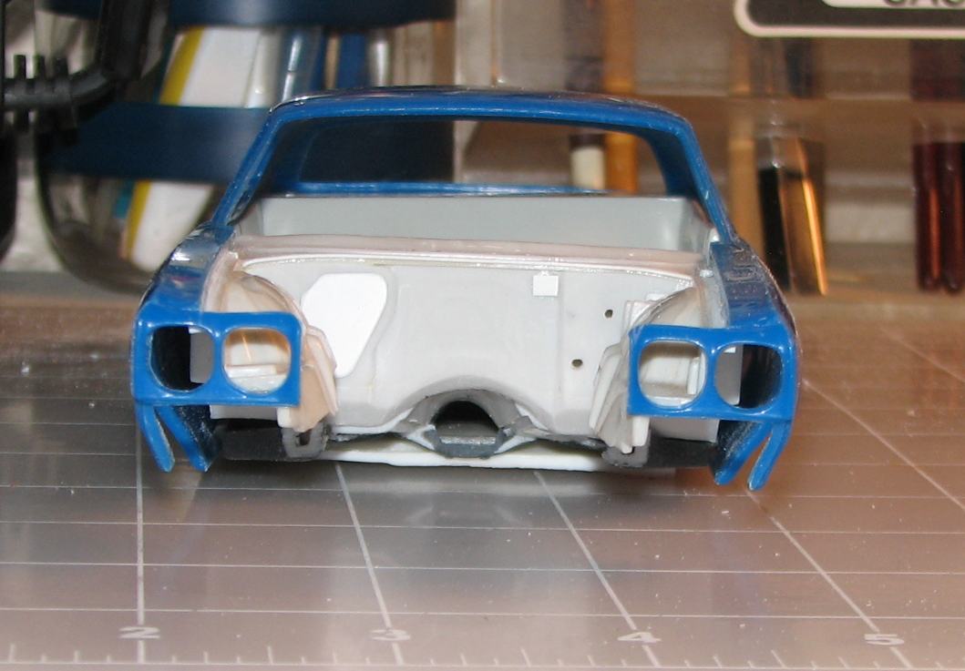

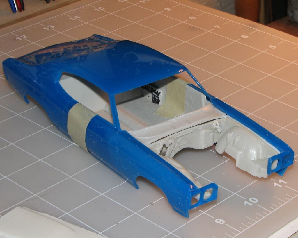

Straightliner59 Posted September 28, 2017 Author Share Posted September 28, 2017 It's been a while since I've updated this. That's because it's been a while since I made any kind of progress on it. That's a long story...suffice to say, this project has been on life support. Everything that's led to this point has been a part of that story. Those white pieces at the front of the floorpan are from AMT's '68 El Camino, as are the firewall and the cowl. The El Camino's firewall didn't align with the older AMT chassis, partly because the area filled by those white pieces was empty, before. Fixing that led to a lot of judicious (and some not so judicious) cutting and sanding and fitting and repeating. Cutting the front clip loose was also a big help. It's finally close enough that I figured I could share it. I added a thin strip of styrene at the cowl/firewall joint. Also visible are the smoothed firewall and the heater block-off plate. I chickened out at the idea of opening the cowl vents and covering them with screen, although, you never know! Quote Link to comment Share on other sites More sharing options...

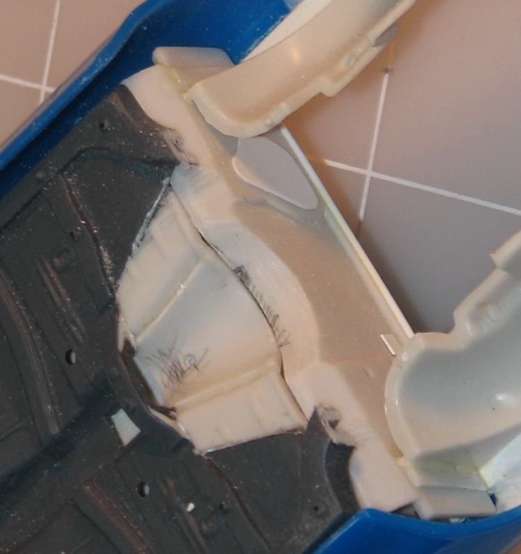

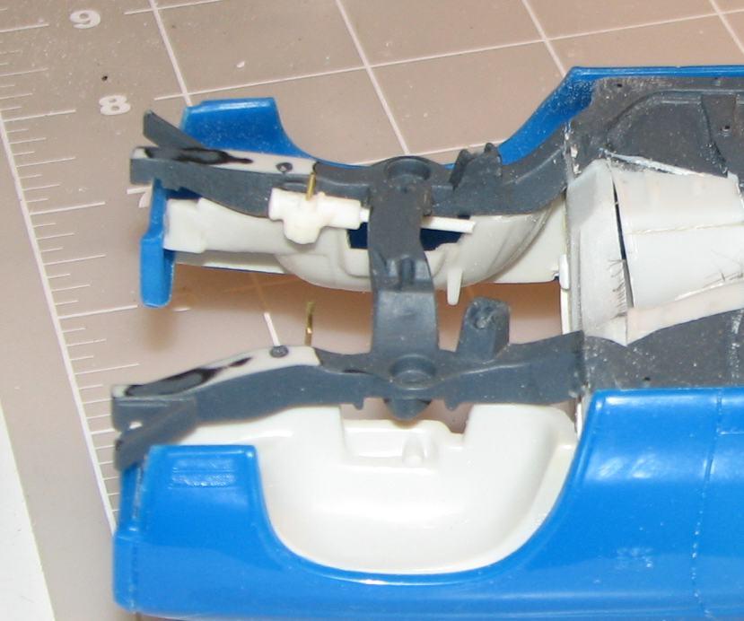

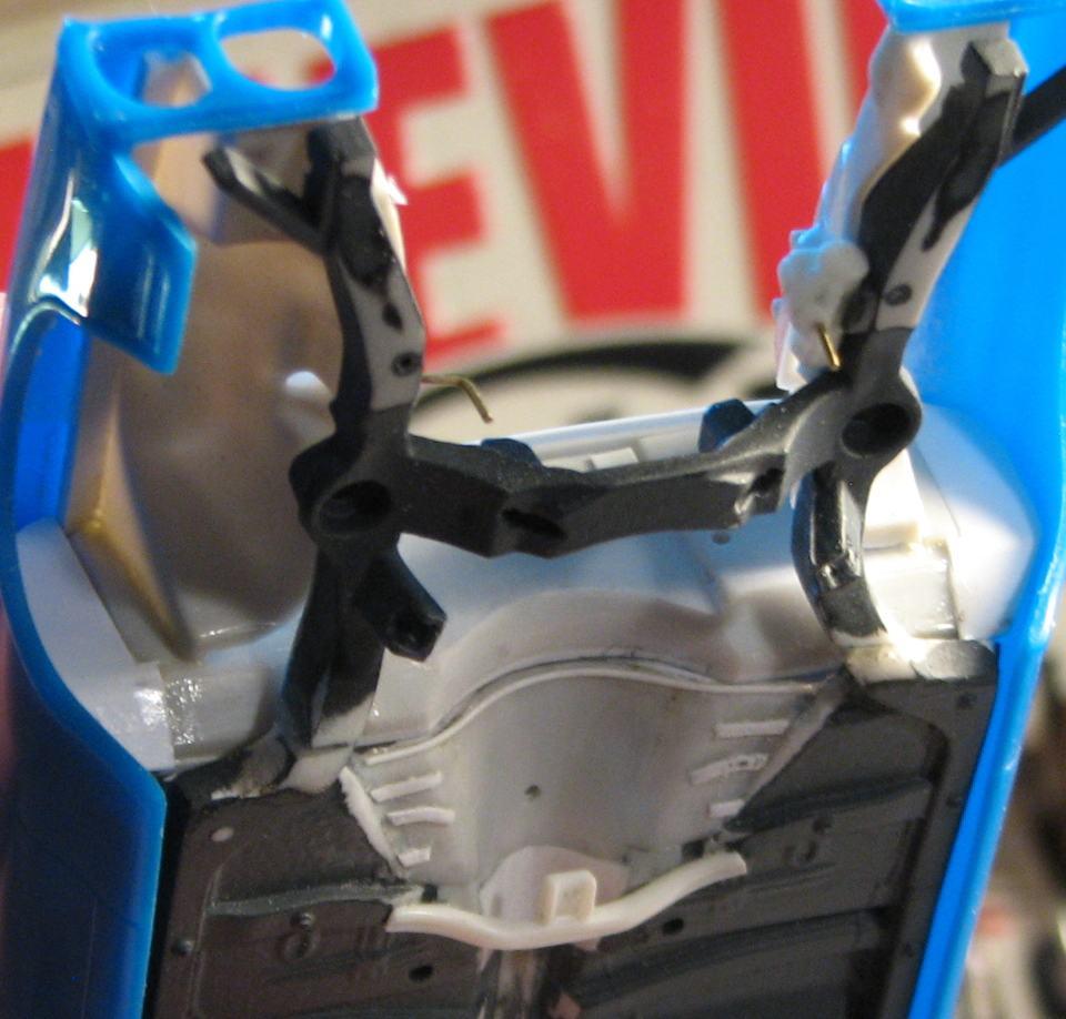

Straightliner59 Posted October 11, 2017 Author Share Posted October 11, 2017 I added some detail to the area around the trans hump. I replaced the center of the AMT Chevelle's chassis trans mount with the center section of one from the Monte Carlo. I also made the ends of the firewall. I just about have this area all worked out, now. I've begun to rework the interior door panels of the Revell kit to fit the interior tub of the AMT kit, because the Revell's interior assembly is too deep to fit and have this chassis sit up under the body. I am going to attempt working hood hinges from brass. We'll see how that goes! Quote Link to comment Share on other sites More sharing options...

bisc63 Posted October 11, 2017 Share Posted October 11, 2017 Alan, what you are seeing in the photos is just the highlight at the top of a convex form, not a separate shape ( i.e; the outward "bulge" of the fenders) The cats at AMT (or MPC, whoever first tooled this) saw those outlines (Very much mistakenly) as another convex (Inward cut) area. If you get a chance to hold the AMT body up to the real car, or even the Revell snapper, you'll see exactly what we're going on about with regards to the body's "over-sculpting"; there is a trench created that just should not be there. Revell got it right, even the old Monogram 1/24 got that right.Daniel; so glad to see you back on this; you really are going above and beyond here, and are creating a very accurate model. Well done, sir! Quote Link to comment Share on other sites More sharing options...

Straightliner59 Posted October 11, 2017 Author Share Posted October 11, 2017 Alan, what you are seeing in the photos is just the highlight at the top of a convex form, not a separate shape ( i.e; the outward "bulge" of the fenders) The cats at AMT (or MPC, whoever first tooled this) saw those outlines (Very much mistakenly) as another convex (Inward cut) area. If you get a chance to hold the AMT body up to the real car, or even the Revell snapper, you'll see exactly what we're going on about with regards to the body's "over-sculpting"; there is a trench created that just should not be there. Revell got it right, even the old Monogram 1/24 got that right. Daniel; so glad to see you back on this; you really are going above and beyond here, and are creating a very accurate model. Well done, sir! Thanks, Rusty! It's not perfect, but, it's better than it was! If I had it to do over? I'm having fun with it. This primered Chevelle really removes the illusion that led to the AMT body's warts. It's a lot of work to use the Revell snapper's body, but I am happy I chose it. Quote Link to comment Share on other sites More sharing options...
Alan Posted October 11, 2017 Share Posted October 11, 2017 I promise not to threadjack again, but I want our fellow modelers to understand! I see what you are ref. to now, I pulled out my AMT body and saw what you described ..... sorry for butting in ...... lol Alan Quote Link to comment Share on other sites More sharing options...
