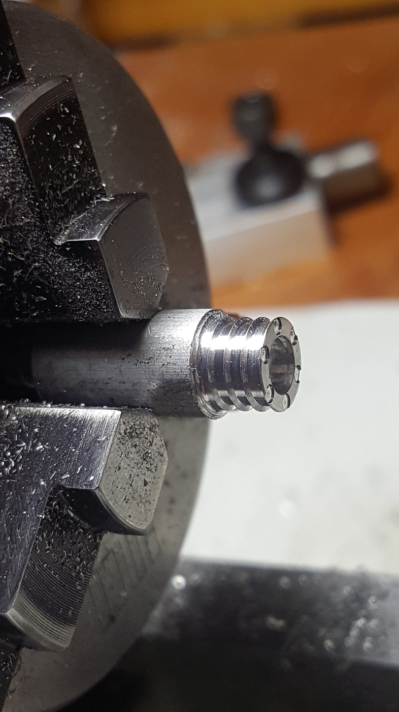

Cleaned up the block half faces and got them glued together. Got a look at the belts and said OH HELL NO! lol. Luckily I did bring the Unimat lathe/mill and it's tooling with me lol. Decided to turn the pulleys from aluminum. Got most of the first steps done but still need the center hole for the crank bolt. Probably no one will see it but I know it's there so I suppose that's all that matters.

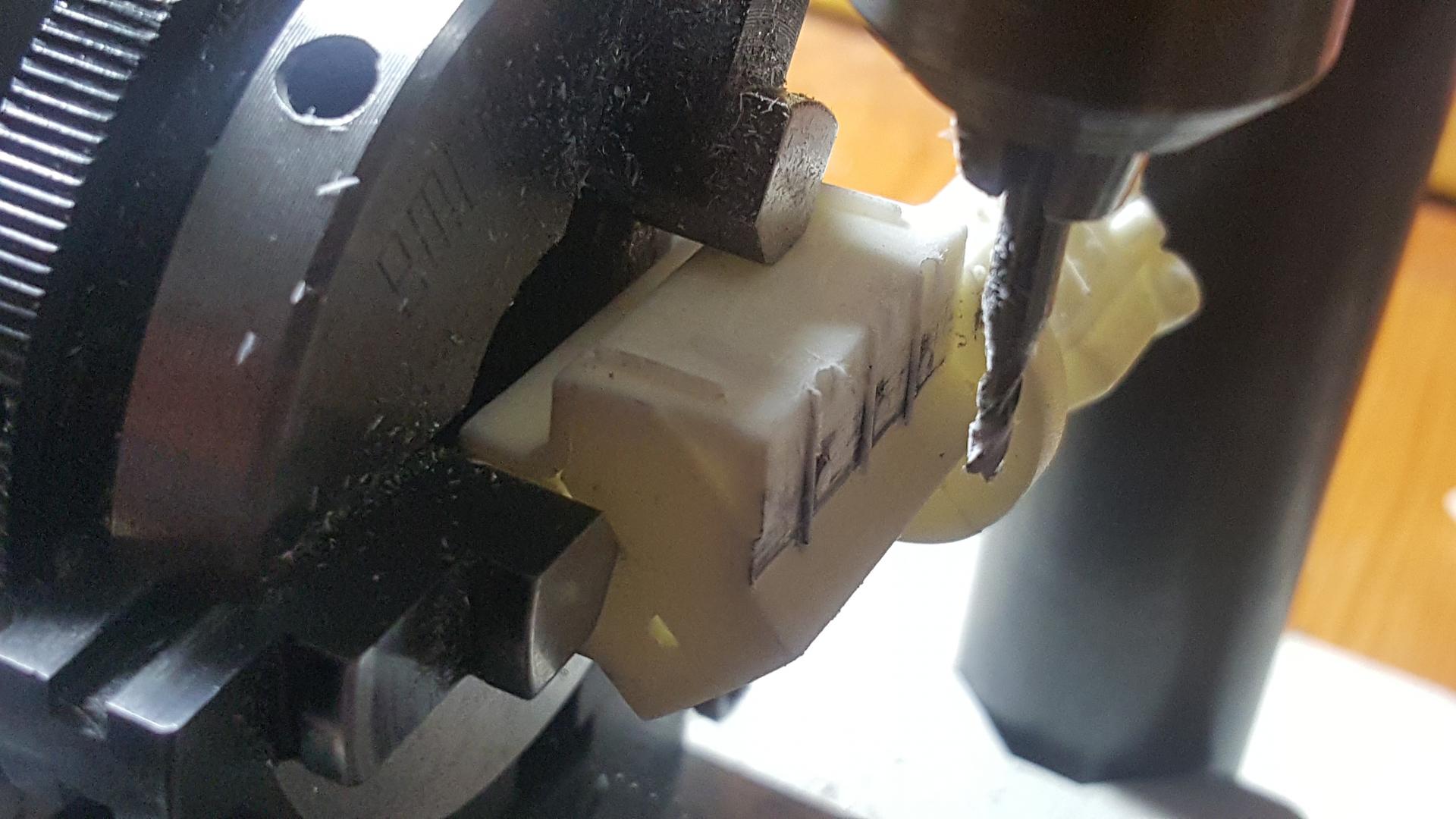

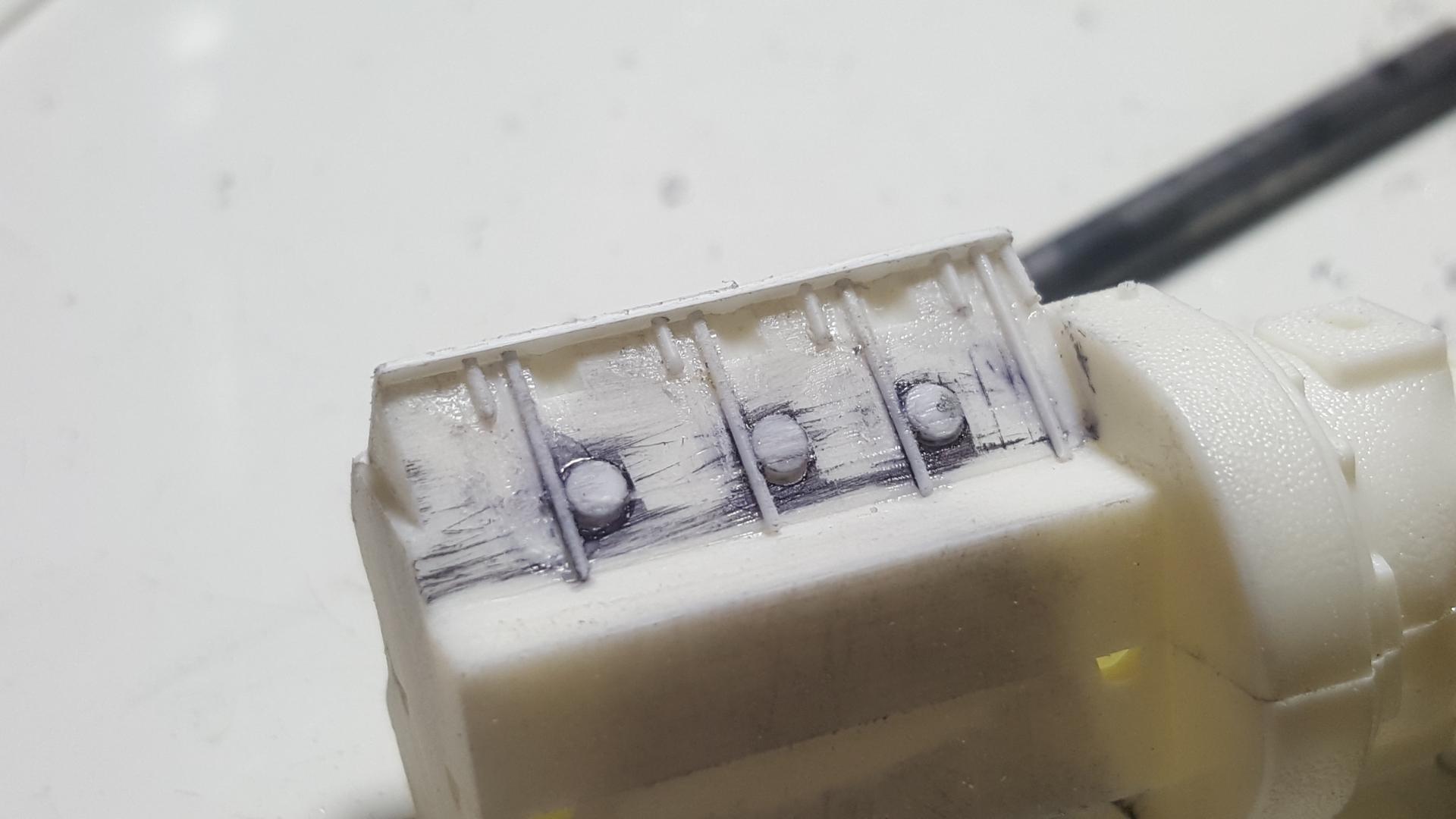

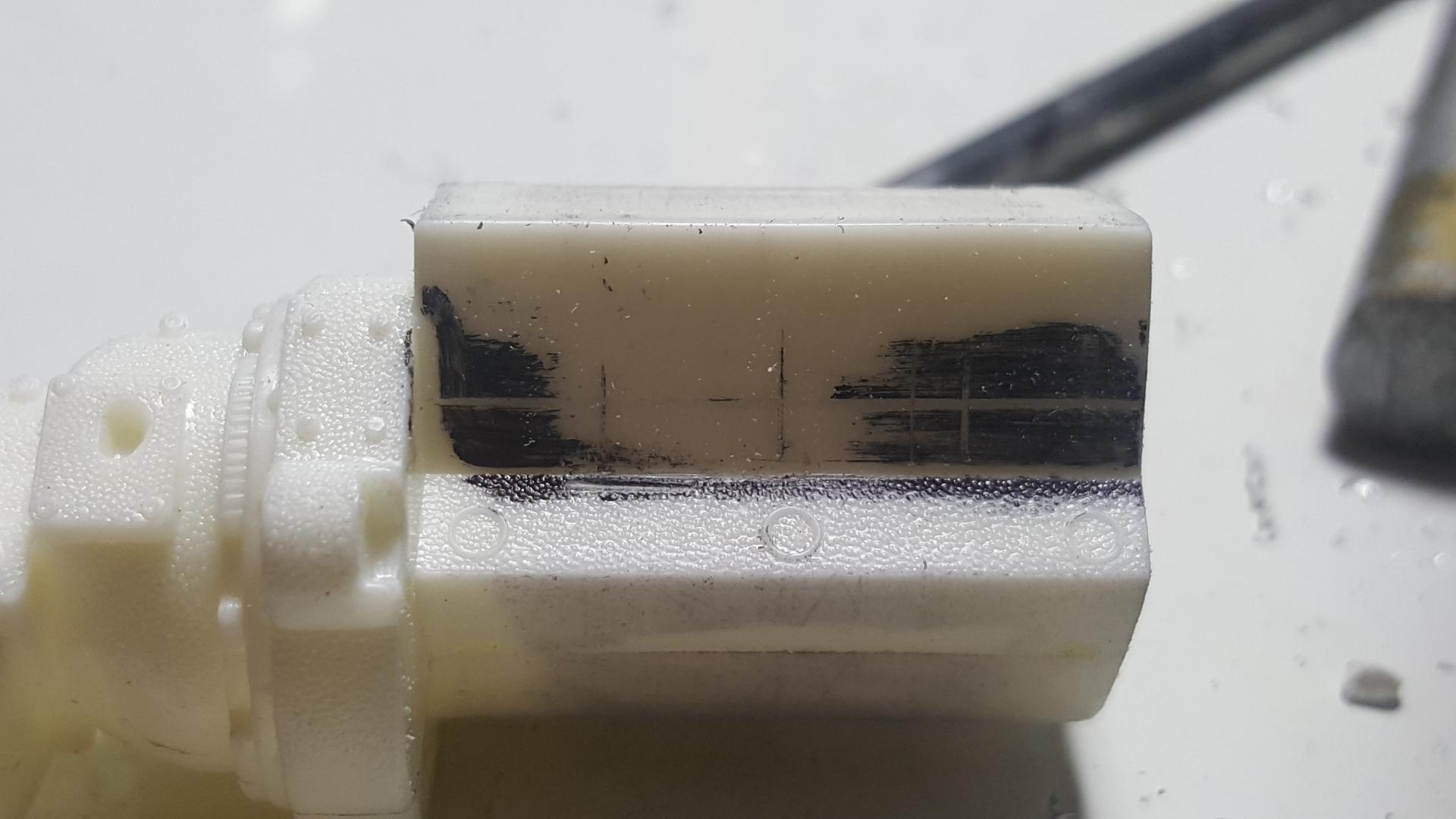

So I devised a scheme  to be able to add the reliefs to the top of the block side but mounting it in the 3 jaw chuck and milling them into the side with an end mill. Actually worked pretty darned good too! One side shows what I started with as far as the block goes. You can see my layout lines for the freeze plug locations. I may plunge the freeze plug "cups" in with an appropriate sized end mill just to simulate the freeze plugs. Last picture is the finished drivers side block. I do still need to add a boss to it for what ever is on that side mounted to the block...filters maybe? Not too familiar with these engines so I am working on assumptions and what little pics I can find on the web.

Redid a new pulley for the crank as there was some issues with the other one I machined and started machining the 6 bolts that hold it onto the balancer. One down 5 to go....lol

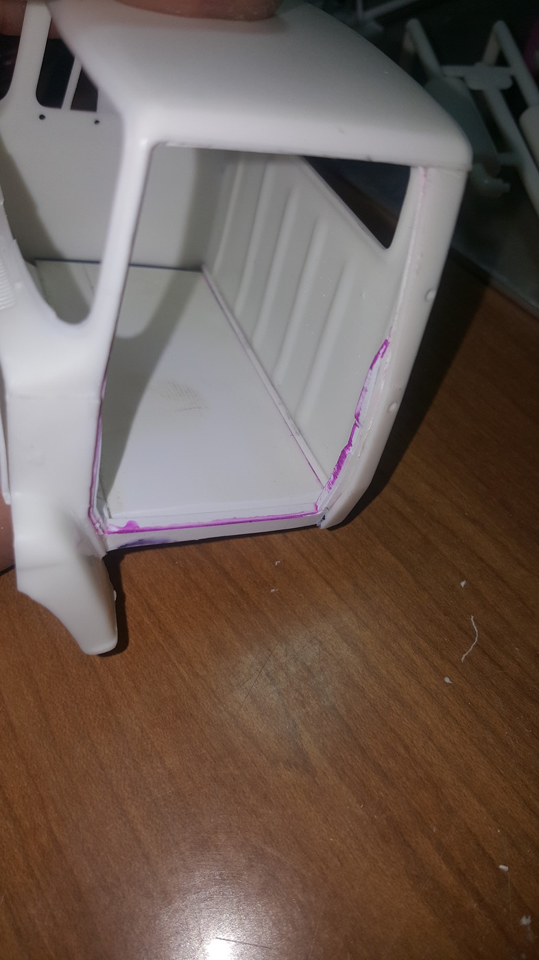

Taking a break from Solidworks and the Chevelle for a while I've turned my attention to this thing again. I received the cd with the service manual  (which includes all 1970 mode year trucks!) and there is some information I can use but I have to go through all of the disk to find it. Owell. There's another book I will be buying soon to help with the details on the engine so I will pause on that and I've started on the firewall. While a decent example of one it needs a bit of help. There are too many gaps in it to the body and quite frankly loks like poop. One side down and one more to go! I am contemplating opening the doors, (the other reason for the firewall work) so having a completed firewall will help with that if I decide to open them. I will also be correcting the interior tub as the door panels do not angle inward at the bottom which mean all new tub lol.

Little bit of an update. I've spent the last few hours building a door jam for the drivers side. I decided to go ahead and cut out the door last night. Kinda nice to be back on the bench. What little bit of it I have as we have completely moved out of our home in the mountains to put up for sale. I am doing what I can with what I have to work with. I still need to do the passenger side, mirroring what I have done on this one. It has taken a while to find enough reference for what I needed to make the door jams. I may go ahead and make the door frame also at this time, later today. I also need to add the ribbing to the floor pan. I did add the framework to the underside of it to try and tie it all into the firewall. I want to cut the hump off the firewall and make it like it is removable. (won't actually be removable but there is a lip missing and it also needs to go into the floor some.)

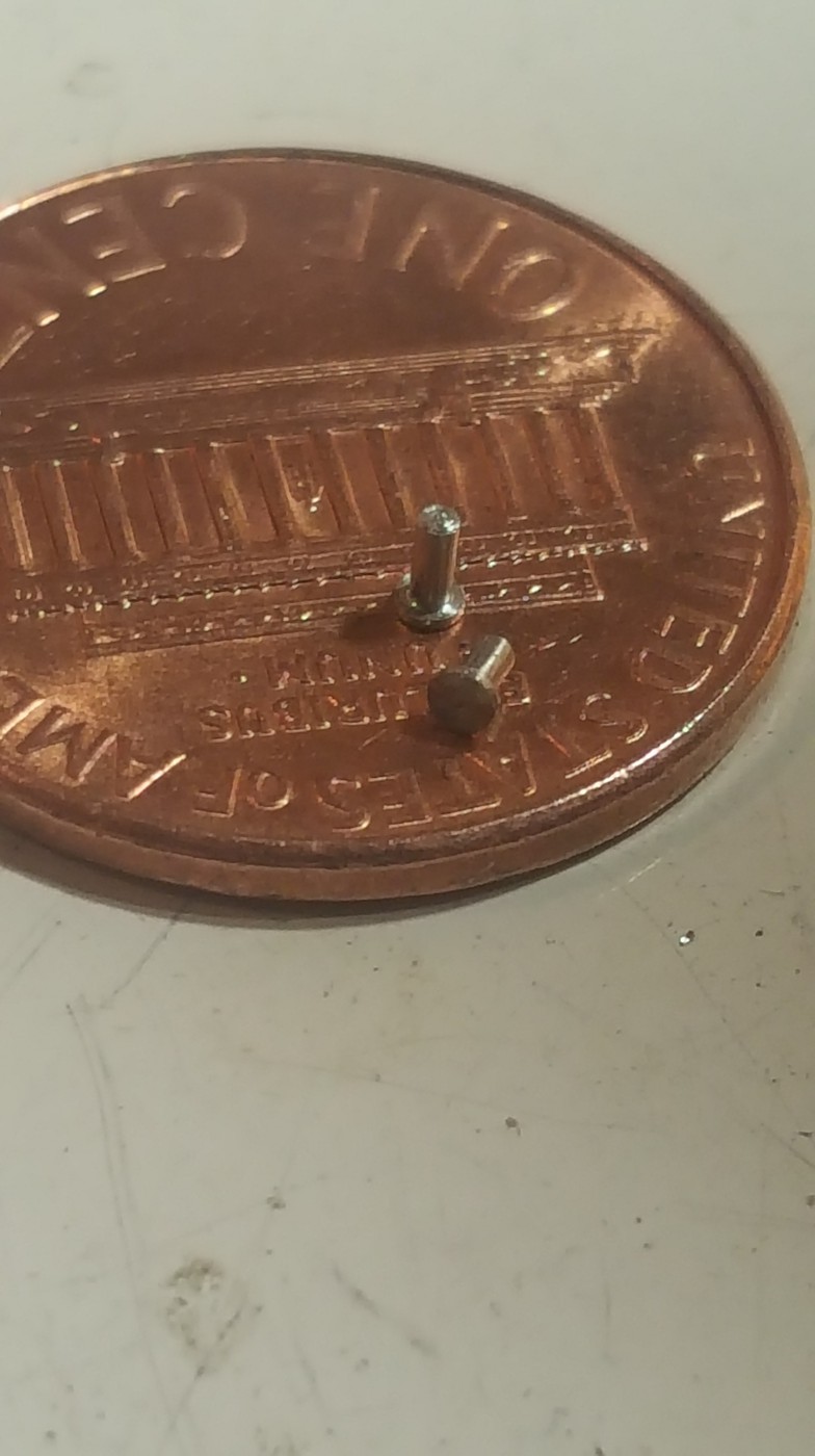

Breaking out the supersized penny to show the door striker bolts that I managed to machine finally. Had to part them off the bar by hand with a razor saw while being mounted in the lathe then turn them around in the chuck, grabbing them by the post and machining the other side. They are simply too small to do any other way. I literally machined them with my 10x Optivisor on lol! What to do now.... hmmm.... Maybe try my hand at a latch of some sort to coincide with the bolt. I will probably epoxy magnets into the doors and behind the post to keep it closed provided I can find some small enough to make it happen. At this scale I am not even going to attempt working handles. I am going to make the hinges from brass however as I can get better strength from the brass.
