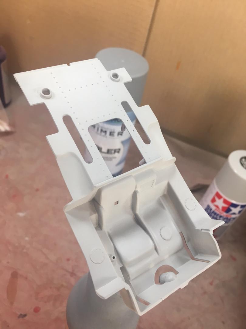

It's stripped and this time I used Tamiya Fine Surface Primer were as before it ws Duplicolor Primer/Sealer.  It's very very smooth or at least feels that way.
Figured I'd try something different to avoid the definition of insanity.
Although Duplicolor was used on my tub which turned out great.
Waiting an hour before applying Alclad II ACL-101.

Hi,
Well I'm at a loss.  I was doing my spray in light coats as per Alclads video tutorial, 15PSI, ~4 away.
But then I ran out of paint, so I filled the cup and began to spray when it spattered so hard and orange peeled again.  Prior to this it was actually coming out well.
And my AB was actually clogged fairly well.
The part has such intricate detail that wet sanding is not a a good idea so I've stripped and primed again.
It's 80+ and very dry here in SoCal so I'll mix some Mr. Leveler as it ain't coolin down any time soon.
To be continued tomorrow.
Whats the detriment in using a higher PSI?
PS  I think the reason for my woes is low humidity+high temps.  When I sprayed the tub which tuned out great, it was a lot cooler.

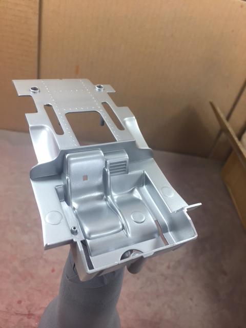

Success!... for me anyways.
Finally something that doesn't look like a$$.
A few things I did differently;
1) The primer coat was very smooth.  Previous coats, while feeling smooth, were porous under my magnified visor tool.  Also I used Duplicolor filler and NOT Duplicolor sealer this time.  I thought one can sand any paint but there sealer is not really sandable as it looks kinda funny when sanded.  Sort of orange peeled.
2) Used 20PSI and 1/3 thinner, 2/3 Alclad Aluminum ALC-101.
3) Followed brush strokes and distance exactly as shown in the Alclad how-to video.  That guy is cool!
