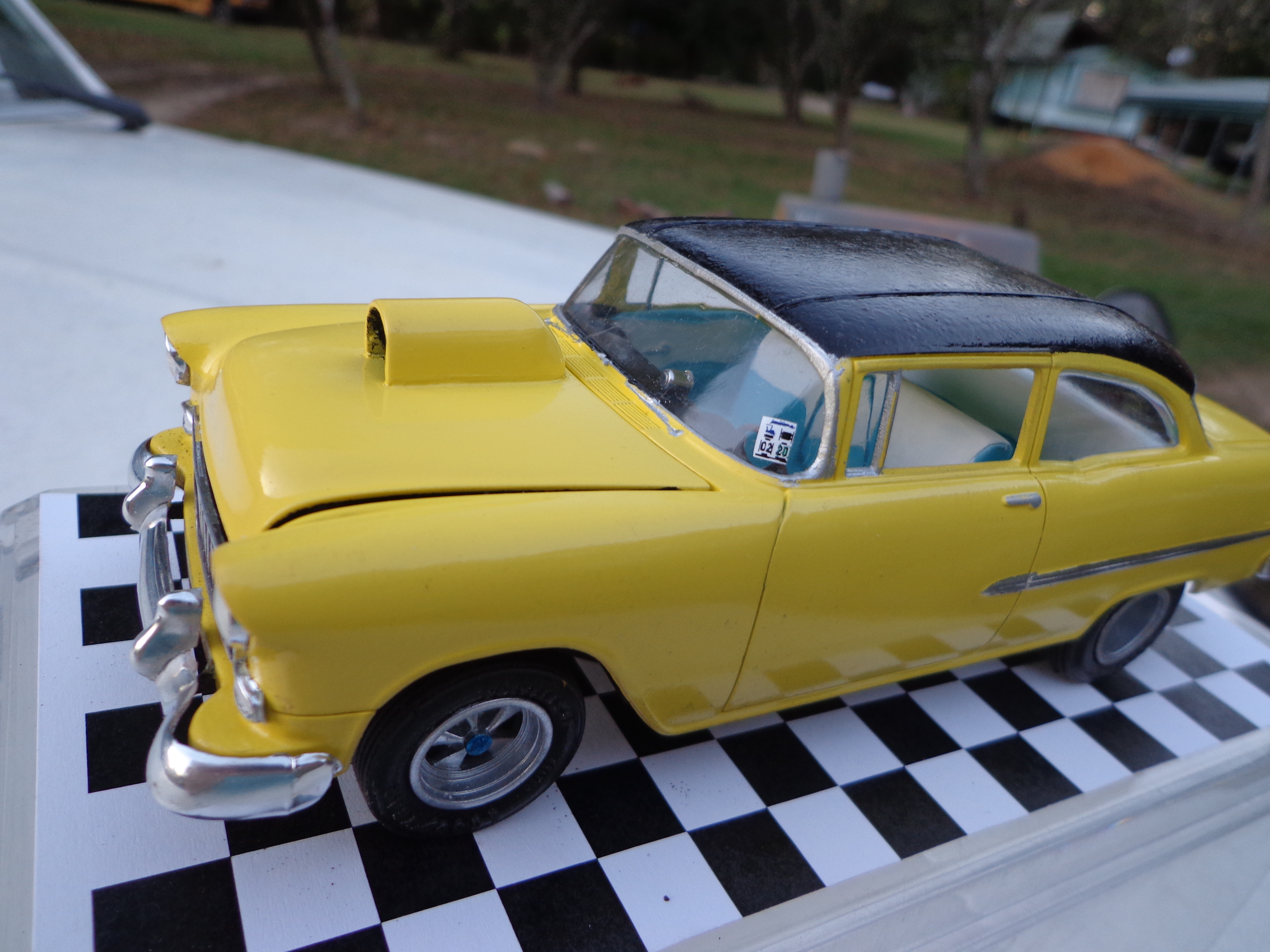

yh70 Posted December 31, 2017 Posted December 31, 2017 2 hours ago, Cien1986 said: Dear mcm members.... Currently iam building 1/12 camaro..... Thinking to replicate the vinyl top on the kit..... Any suggestion on material, how to do it... And the chrome list around the vinyl.... Any suggeation will really help Many thanks for sharing ...... Model Masters makes vinyl top spray paint..i found this out after i did one myself..what i did was cut me 2 small thin strips of plastruct sheeting and glued them down to look like the seams..next i got a make up brush thats about the size of a dime and i pored out some black paint from a testors bottle (do not thin its got to be thick to work ). then i started dabbing it in the pant then to the car top..(try this on scrap plastic first)..it will give u the texture look of a vinyl roof as u build up the paint..the picture below u can see what it looks like if u decide to do it that way..
