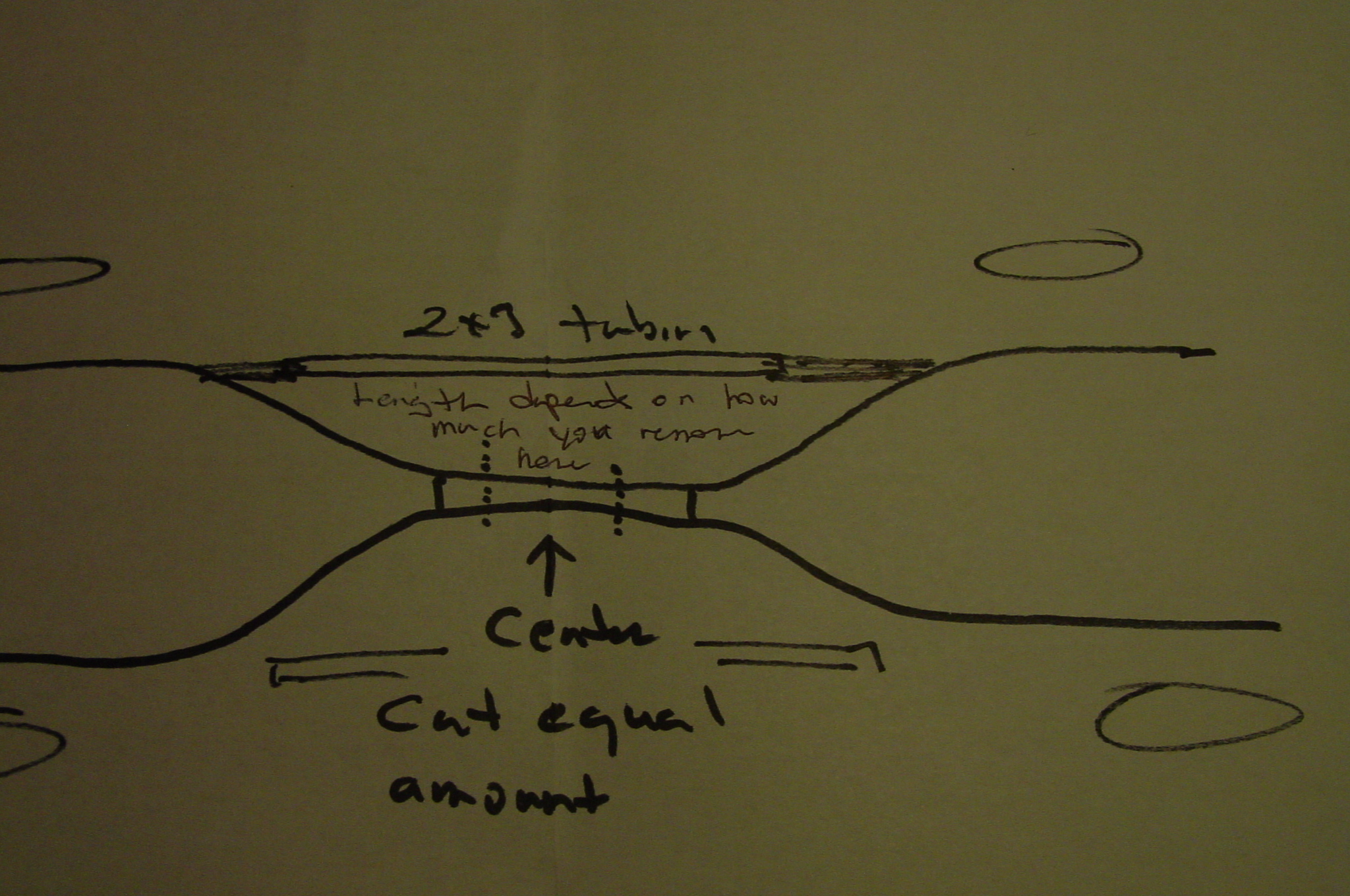

TarheelRick Posted February 17, 2018 Posted February 17, 2018 Definitely looks doable, and as been mentioned someone, somewhere in a backyard garage probably did one. As for the X-frame you could bolster the stock frame by running "2X3 inch steel tubing" from the front to back just inside the body panels. You will also need to shorten the frame, my suggestion would be cutting the center of the X evenly front to rear to assist in realigning the frame members. Now dig out your X-Acto saw and start cutting.
06daytona Posted February 17, 2018 Author Posted February 17, 2018 Yes, the "2x3 tubing" would definitely work here. Not sure I see what you mean by cutting the center of the X, because then the members will be offset when I try to put them back together. I do agree that something would have to be done to the frame, but having a bit of an issue picturing just what. Thanks for the input.
TarheelRick Posted February 17, 2018 Posted February 17, 2018 (edited) What I am suggesting is to find the center and cut an equal amount from front of center and rear of center, the X should then line up. Even if you have to remove the complete middle section you can you should still be able to shave from the front chassis section and back section to get the frame pieces to align. Here is a rough drawing of what I am suggesting. Now that I looked at your concept picture I am wondering how my suggestion will work with the front suspension being moved forward. Of course you could always clean off the IFS and replace it with a tube axle. Hope this helps. Edited February 17, 2018 by TarheelRick
06daytona Posted February 20, 2018 Author Posted February 20, 2018 Ah, I see now. For some reason I was thinking you meant cutting it from front to rear, couldn't see how that would work. Yes, this might work, but there is a lot of molded-in stuff on the chassis pan to be removed first. Then, space has to be made for the 2x3s. Agreed about the IFS, it likely will have to be removed. Of course, a tube axle will only make it look better, right?
