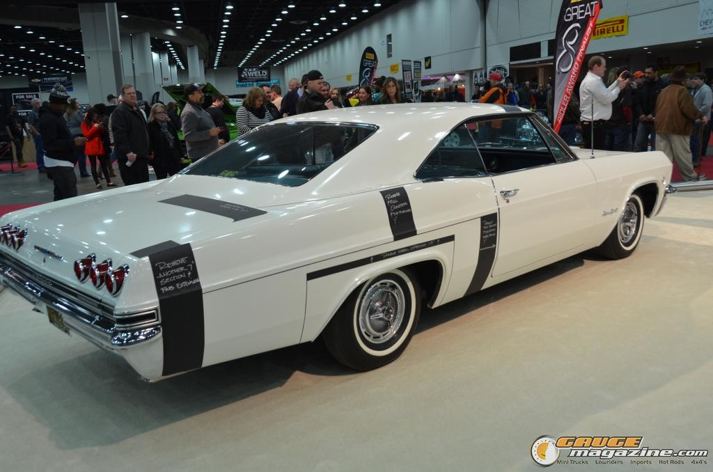

Casey Posted July 23, 2018 Posted July 23, 2018 (edited) 2 hours ago, Jantrix said: If you are going to build this, you have your work cut out for you. The Imposter has a laundry list of mods, some so subtle, they are hard to put your finger on. And to think we could've gotten this straight from Revell, instead of that frumpy Cadillac. Edited July 23, 2018 by Casey
Muncie Posted July 24, 2018 Posted July 24, 2018 Casey, that's the photo I was thinking of. great reference. More good detail photos of the 2015 Detroit Autorama are posted here on the forum. Credit and Thank You to Howard Cohen and Tim Boyd for my annual Autorama fix. (I wish the show people would crank up the lights on set up day.)
