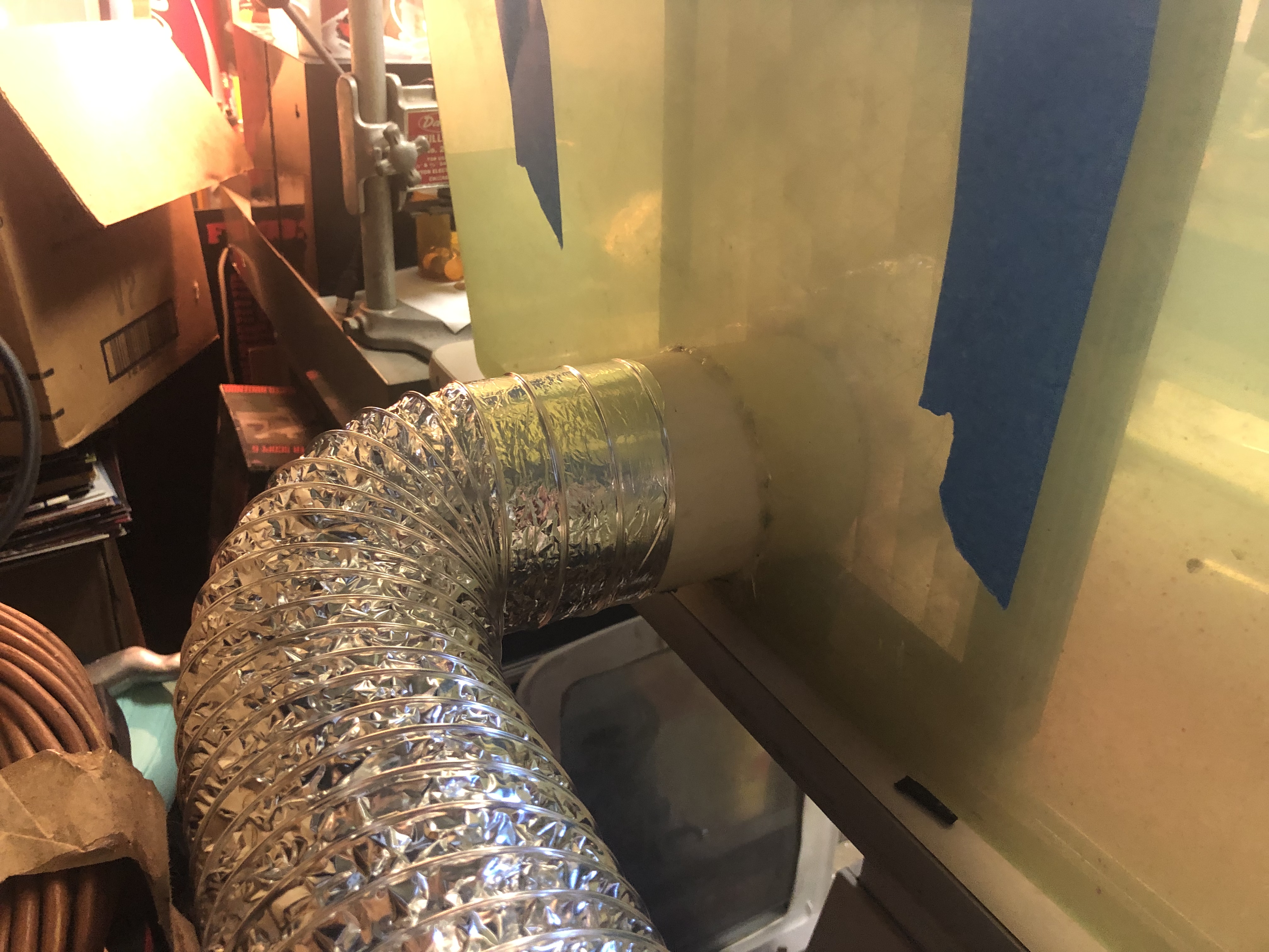

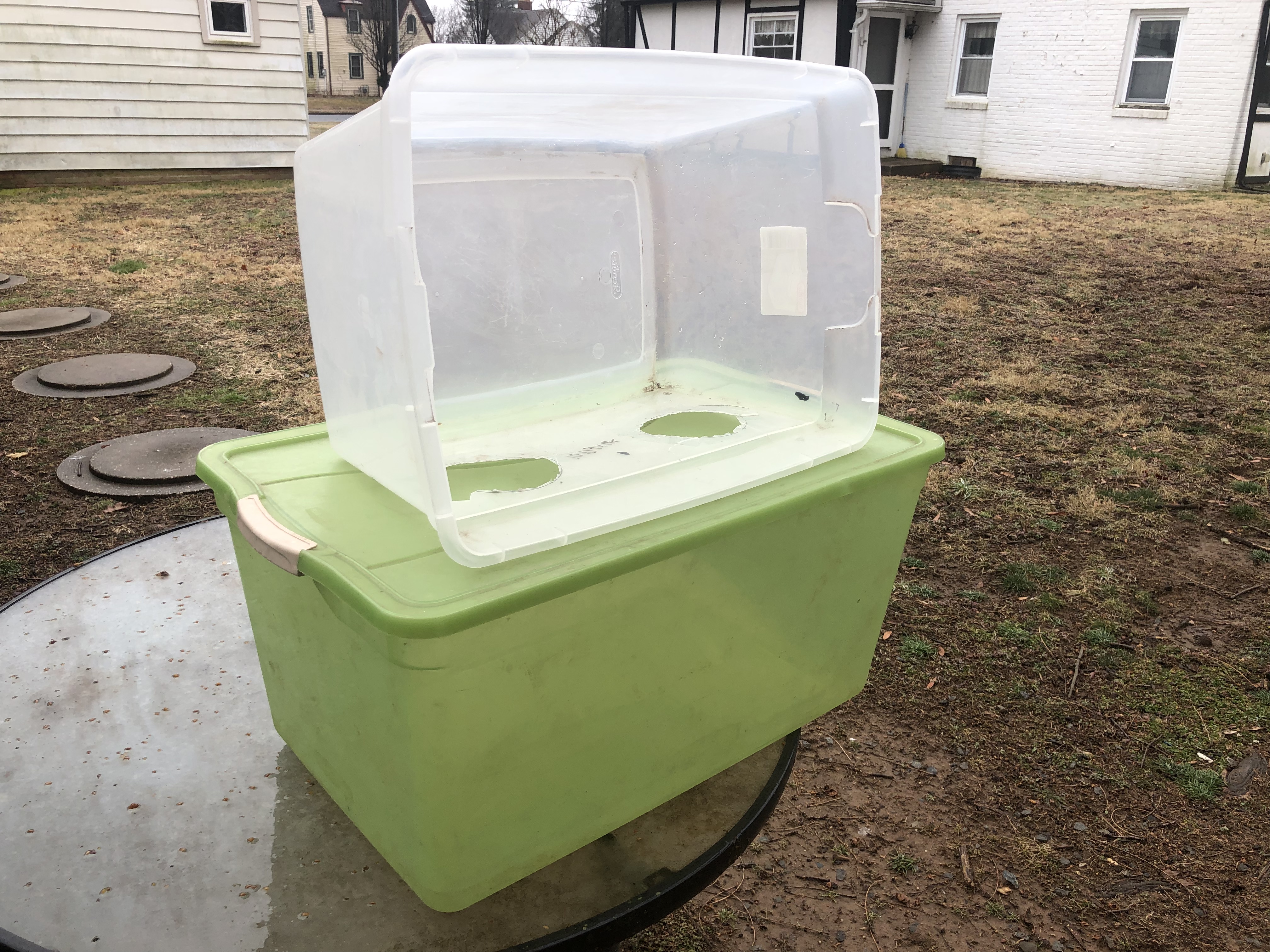

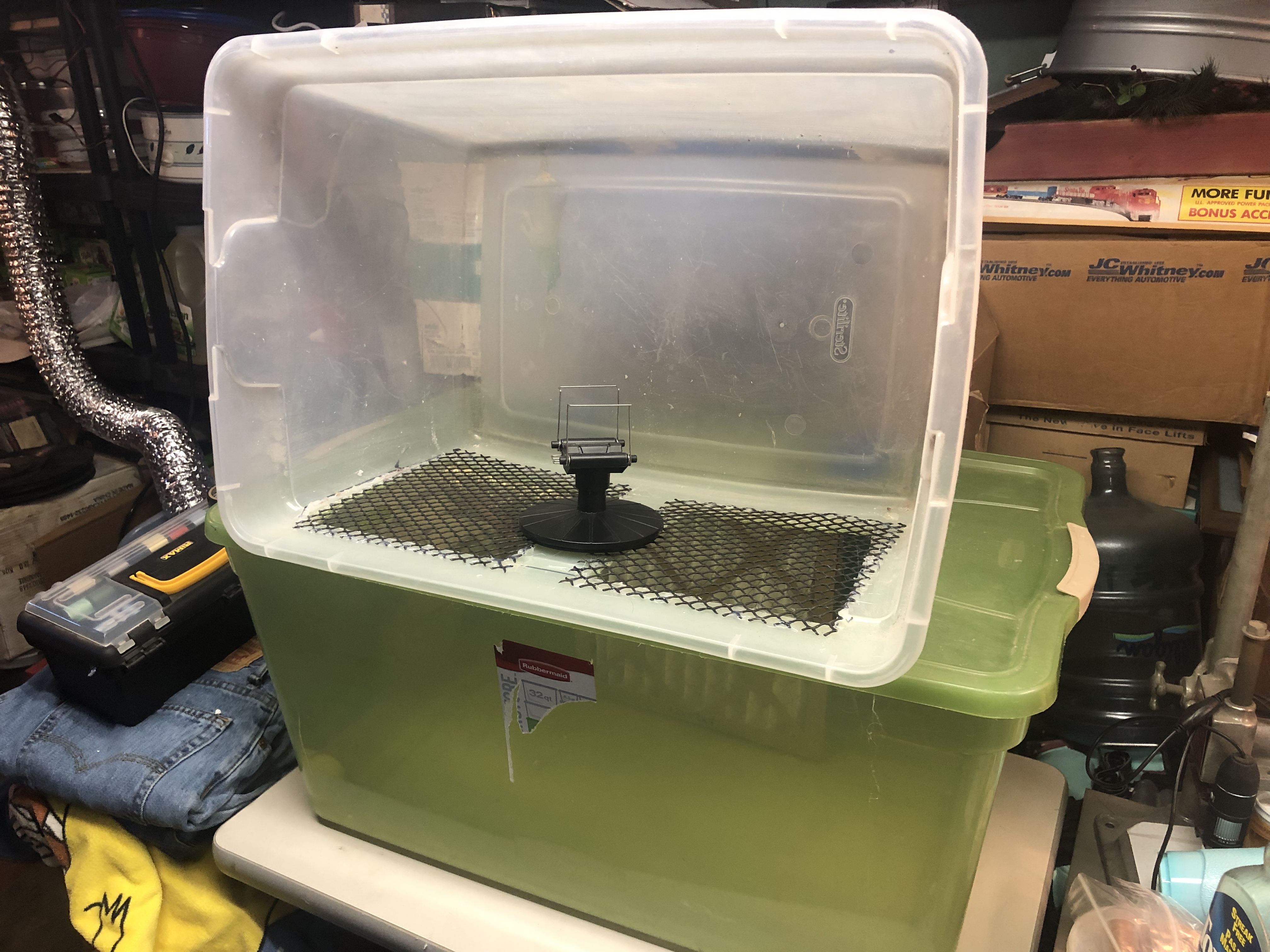

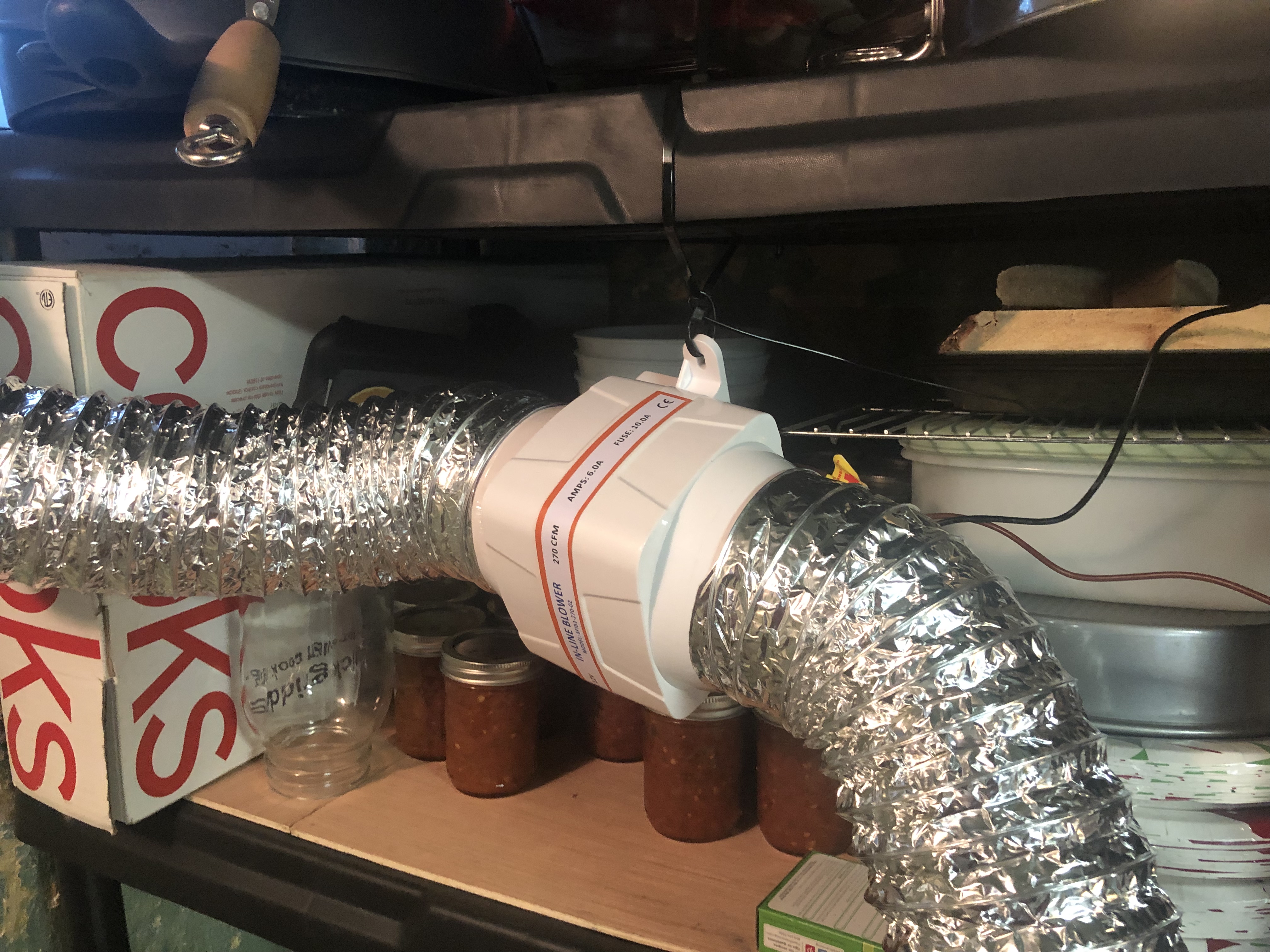

I started my booth, I'm going to attach these 2 totes, use the lower one to put the filter in and the fan in the side and mount the power supply on the outside of it and use a 4" dryer vent to go out the window.
I'm looking at bilge fans now to decide which one to get, I'm leaning to a 4" 240 cfm one I saw....

The 240 cfm may be a little too much for a small enclosure like yours. My booth is probably twice that size and I use a 170 cfm.

I thought that may be the case and I had planned to put the fan right in the box but I think I may put it at the discharge end to help combat that....

First paint job in the booth is done!!! Booth works great may do a few tweaks like some kind of light but pretty satisfied with the out come. Caution!!! please excuse the mess the other half of my basement is storage......

That's pretty cool. I never considered a bottom exit system but from the looks of your setup, it would work better than the old rear exit systems. My version has a rear/upward exit through a small AC filter and a paint safe exhaust motor. My motor needs a clean up perhaps from paint clogging. I can't find that motor at Grainger's where I bought it originally. It all works great but it takes my motor a few seconds to start, which I take as a bad sign.

Thank you, years ago when I painted cars down draft booths were the way to go so it kind of stuck with me, works really well with the filter in the bottom like that I'm getting almost no over spray in the hose just fumes. The fan I ended up getting is a 270 CFM so the fan is 10 foot away from the box and still has good suction, I think I may move it a little closer though I think I want just a little more than I'm getting.
It was cheap the fan was 30 and I had most everything else already but totes are cheap...
