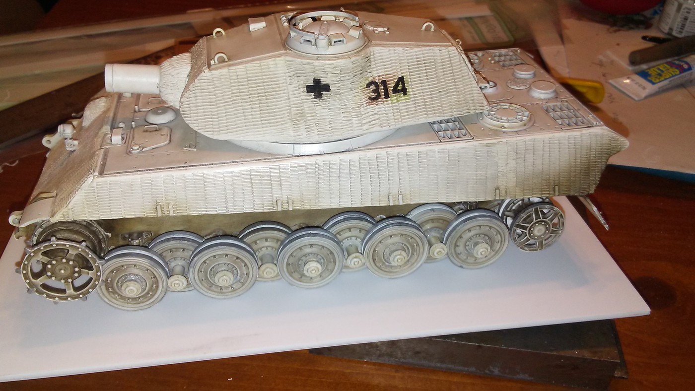

LDO Posted June 14, 2019 Posted June 14, 2019 I am a huge fan of Milliput Superfine White putty. It dries hard, but can be sanded. It can also be worked with wet tools/fingertips. Just use water, no need for solvents. To make it stick better, get it slightly wet and then press it on to the plastic. It is very versatile. I have rolled it into thin sheets and applied to to a model tank, for simulating Zimmerit; an anti-magnetic coating applied to some German vehicles in WWII. I scratched the surface with the back edge of an X-acto to give it more to hold on to, then rolled the texture into it with the lid of a paint jar. Again, I am a huge fan of this stuff. King Tiger tank in winter white Camo. Markings painted on by hand. With a test piece for practicing the Zimmerit and painting markings by hand.

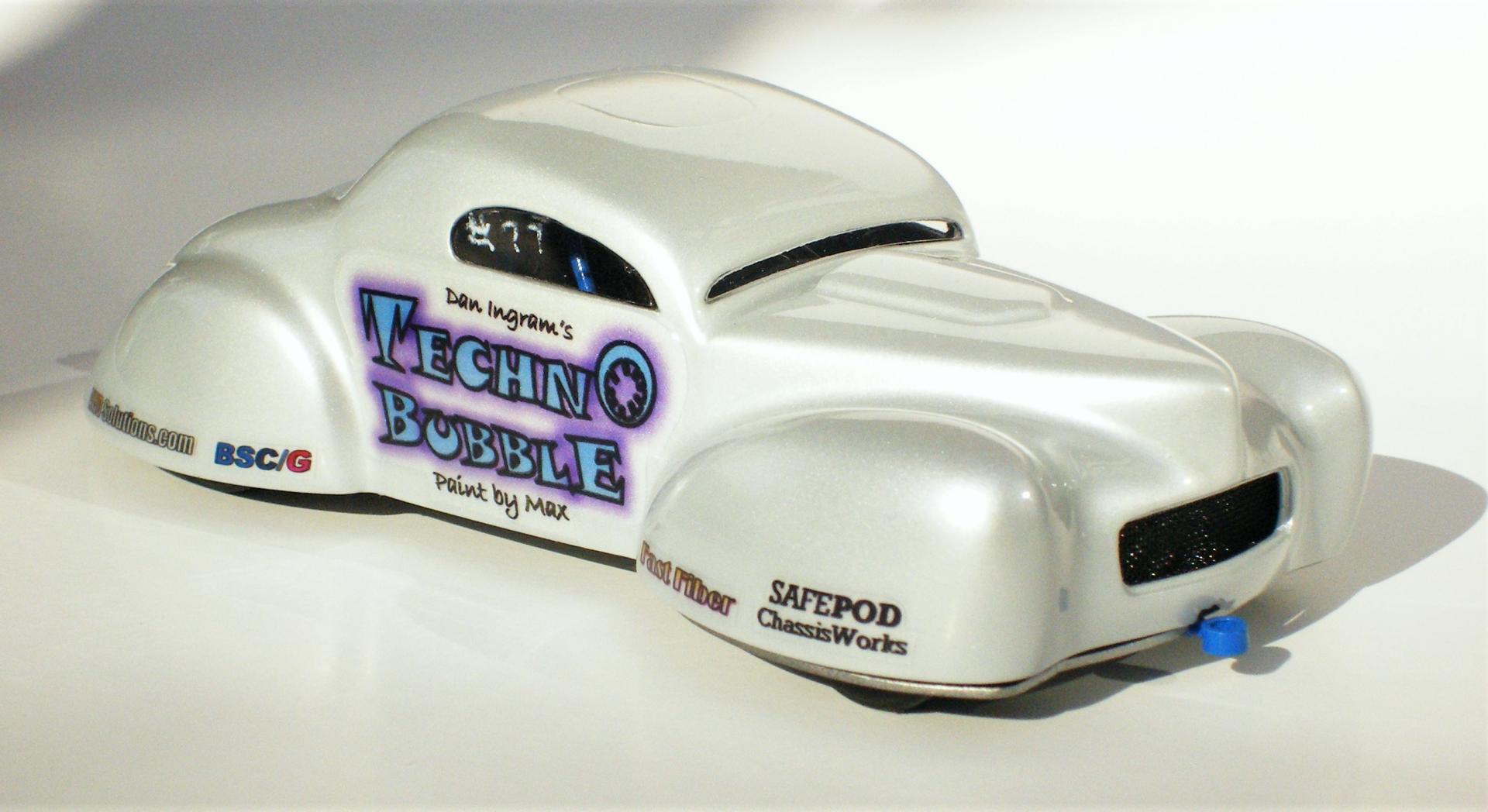

Claude Thibodeau Posted June 14, 2019 Posted June 14, 2019 Hi! I use Evercoat 2-part catalyzed putty, and it works perfectly. You actually control curing time and final "hardness" by experimenting with the ratio of hardener to putty. However, softer means it may impact finishing operations later on (sanding, grooving, scribing, etc.). Fully cured with right amount of hardener, it will usually remain rock solid, and not shrink. With all brands of kits, I have never encountered any occurence of harming or shrinking the styrene substrate. Finally, you have a "window" to slice-off any surplus with your Exacto blade after it starts to cure, reducing the sanding time, dust, etc. This Willys body made extensive use of the stuff, and never shrank. Good luck! CT
