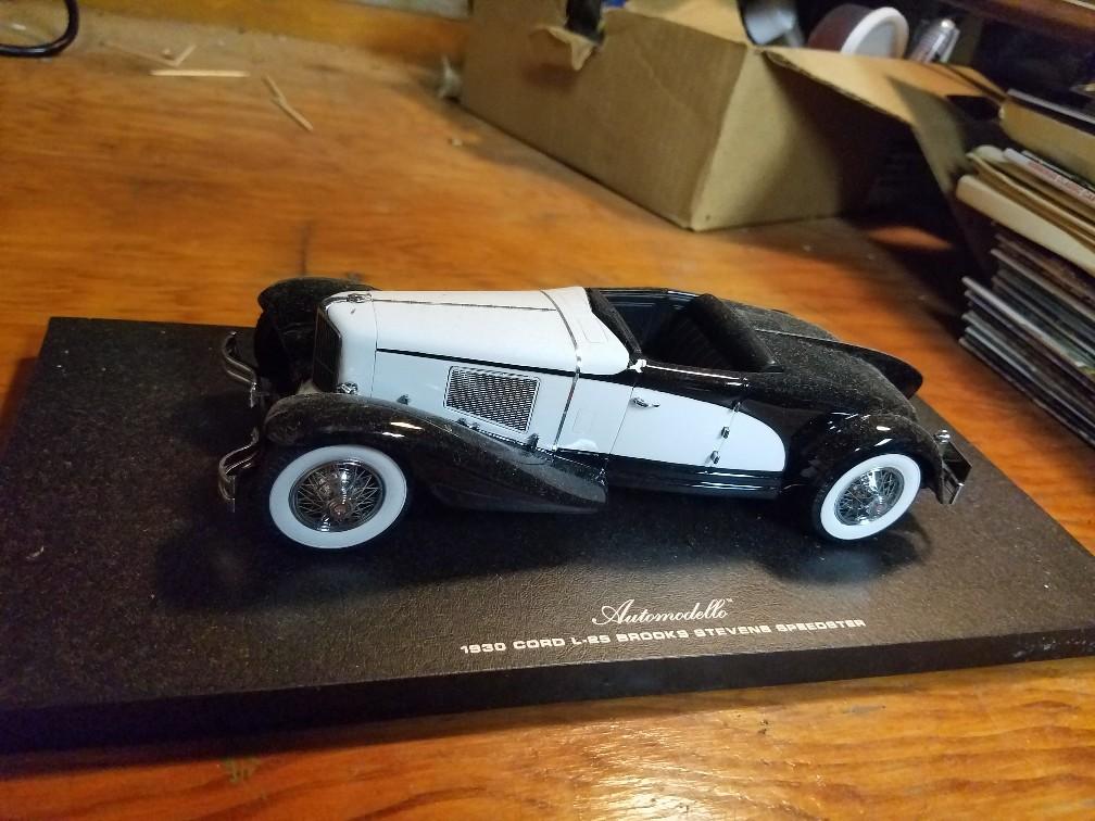

Well, I thought to myself,  if he can do it, I can too. So off I went to find an MPC Imperial Convertible Sedan.  That took a while but finding the right 1:1 L 29 was easy as there was a local car that was a fresh restoration, and a 100 point car to boot.  The gods of model building smildd upon me as I stumbled upon the book The Olympian Cars, still the best book ever written about Full Classics,  IMHO, which had a close to 1:24 photo of a L-29 Phaeton Sedan. This photo was both a gift and a curse as I was able to clearly see just how different the two cars were aside from the obvious front vs. Rear wheel drive. Fast forward to the release of Automodellos L-29 Brooks Stevens roadster . I was able to buy two in distressed condition, enough to provide wheels, bumpers, hood, grill and surround as so on. Here is where I am today. It will very likely not be a show winner, but should look the part of a 1930 Cord.

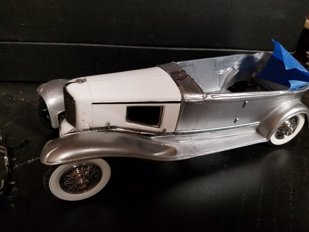

I did some work to make the cowl match the front clip. I had to narrow it by about 1/4 inch. I  also had to narrow the top about the same amount.  The rear portion of the top needs to be fitted to the body next. Lots more adjustments to do.

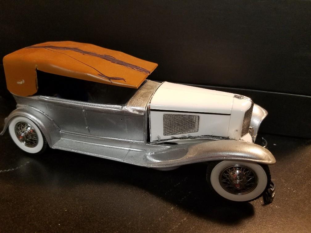

Tonight I made good progress on the fit of the hood to the cowl and made the louvered sides of the hood.  This probably doesn't look like much but will pay big dividends in the appearance of the car when I am done.  Thanks to all of you who have taken a look.

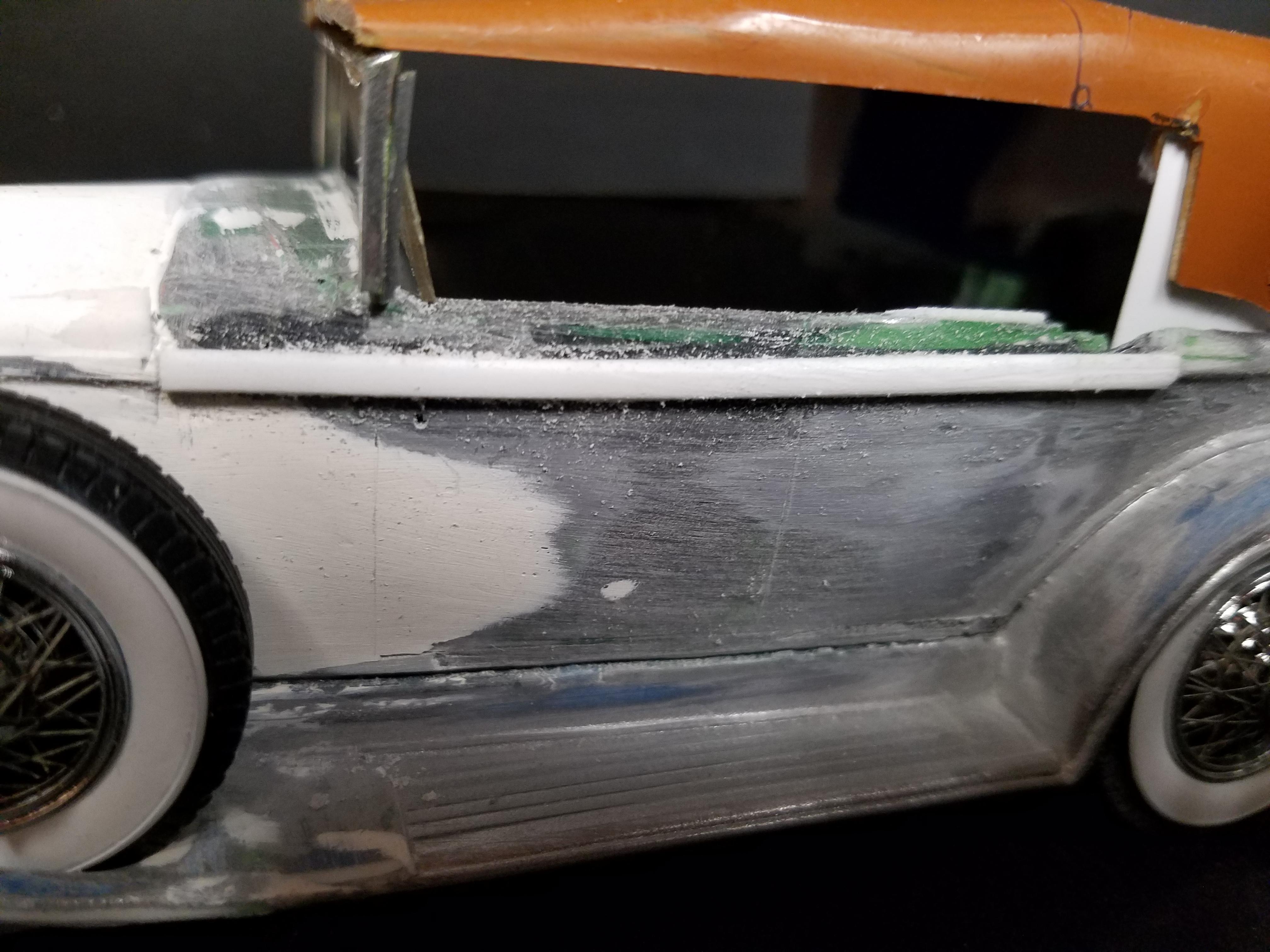

So, here it is with the guide coat sanded off and another round of putty on. If I say so myself,  it's starting to look like a Cord. Clearly there is more to do on the front passenger fender but tge others are getting pretty close.

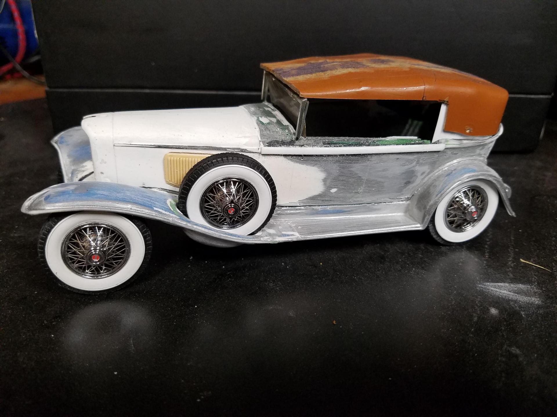

This morning I went over the whole car with 1000 grit sandpaper and gave it a good wet sanding.  I continued with fitting the top and did some small refinements of the front clip. Finally,  I epoxied the hood louvers in place. I have a long way to go but feel good about my progress so far.
