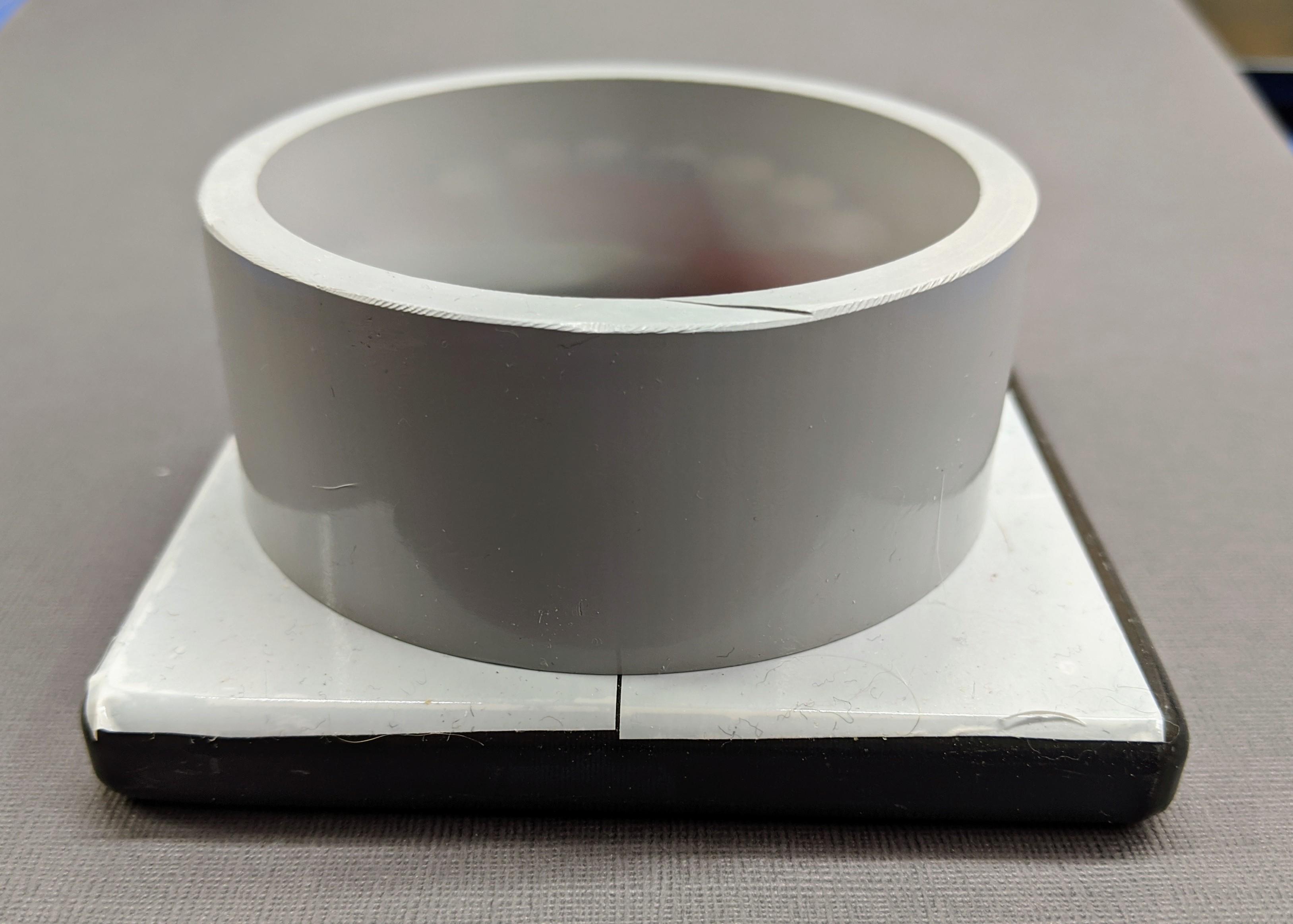

One other suggestion based upon what I see in your image. Use a smaller mold container so there's less waste. For smaller items like wheels you don't need that much mold material around the cavity, but maybe you simply used whatever you had nearby. Various lengths of PVC pipe (which is available in multiple diameters) or unions/collars are nearly ready to use or can be cut to whatever length you need, and the cut ends can be made flat and square to the side walls with some sanding on a planar surface, too. Here's an an example of that, using a piece of 3" pipe cut to 1-14" in length (height, as shown). I have several former Corian countertop material sample squares which I use as as the base, and double side carpet tape to keep the mold ring and parts in place while the mold rubber cures. Rather simple, but easy to disassemble and clean up, to allow for re-use. These are all parts which can be made with one-part molds, so again, for consistent and repeatable results, follow the K.I.S.S. method whenever possible:
