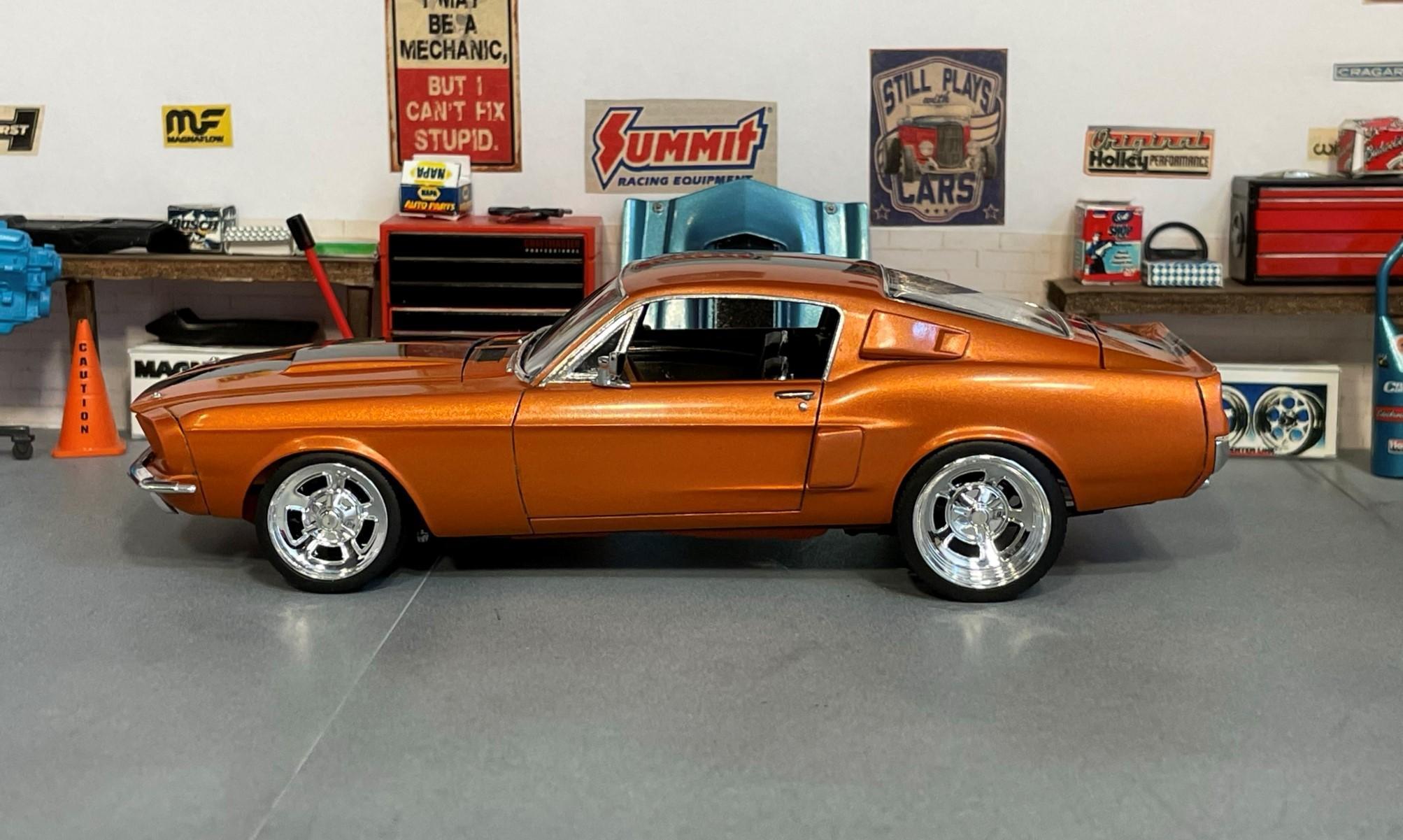

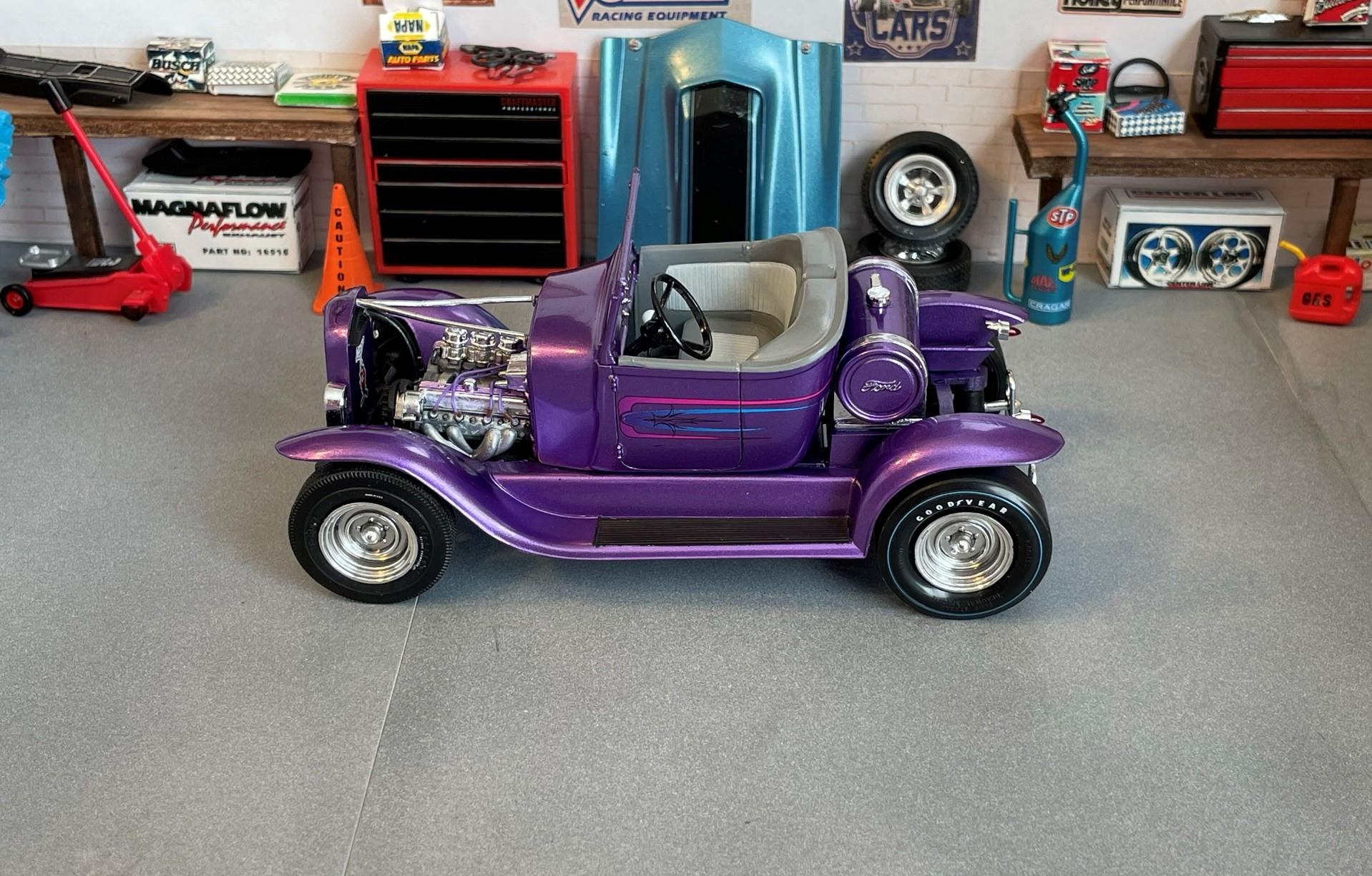

Mopar440_93 Posted May 7, 2020 Author Share Posted May 7, 2020 29 minutes ago, CabDriver said: Translucent paint over a reflective base color is basically what a candy paint job is; Tamiya’s clear colors work great and I really like them but there’s only a handful of colors.   You can mix them, obviously, but the Createx line is a lot more varied.  Harder to spray in my experience, they’re very thin and need to be mixed with a carrier for best results but a lot of colors to choose from and a good quality product. Used a mix of Tamiya clears and Createx solids and candies on this one:  You did a great job on that build. I really like the color choices that you used. Did you use just regular createx or did you use their candy2o? I also read some where that regular creatix is only meant for fabrics, but I'm not sure. But I was thinking of using createx transparent purple over a metallic chrome Quote Link to comment Share on other sites More sharing options...
CabDriver Posted May 7, 2020 Share Posted May 7, 2020 1 minute ago, Mopar440_93 said: You did a great job on that build. I really like the color choices that you used. Did you use just regular createx or did you use their candy2o? I also read some where that regular creatix is only meant for fabrics, but I'm not sure. But I was thinking of using createx transparent purple over a metallic chrome Thank you!  A little of both...the Candy2o is my favorite, but there’s some of both on there.   I’ve heard that some of the Createx lines are meant for fabrics too, but it seems that the paint doesn’t know what I’m spraying it on as I’ve never had any troubles using any of them for anything I’ve wanted to do with them.  Their weakest product, for me, is the black which doesn’t like to dry without some heat in my experience, but the others are good quality products that are easy to work with in my opinion (for what that’s worth ?) Their purple over a chrome would look great I’d think! Quote Link to comment Share on other sites More sharing options...
Mopar440_93 Posted May 7, 2020 Author Share Posted May 7, 2020 18 minutes ago, CabDriver said: Thank you!  A little of both...the Candy2o is my favorite, but there’s some of both on there.   I’ve heard that some of the Createx lines are meant for fabrics too, but it seems that the paint doesn’t know what I’m spraying it on as I’ve never had any troubles using any of them for anything I’ve wanted to do with them.  Their weakest product, for me, is the black which doesn’t like to dry without some heat in my experience, but the others are good quality products that are easy to work with in my opinion (for what that’s worth ?) Their purple over a chrome would look great I’d think! Is there anything that you would recommend over createx? Quote Link to comment Share on other sites More sharing options...

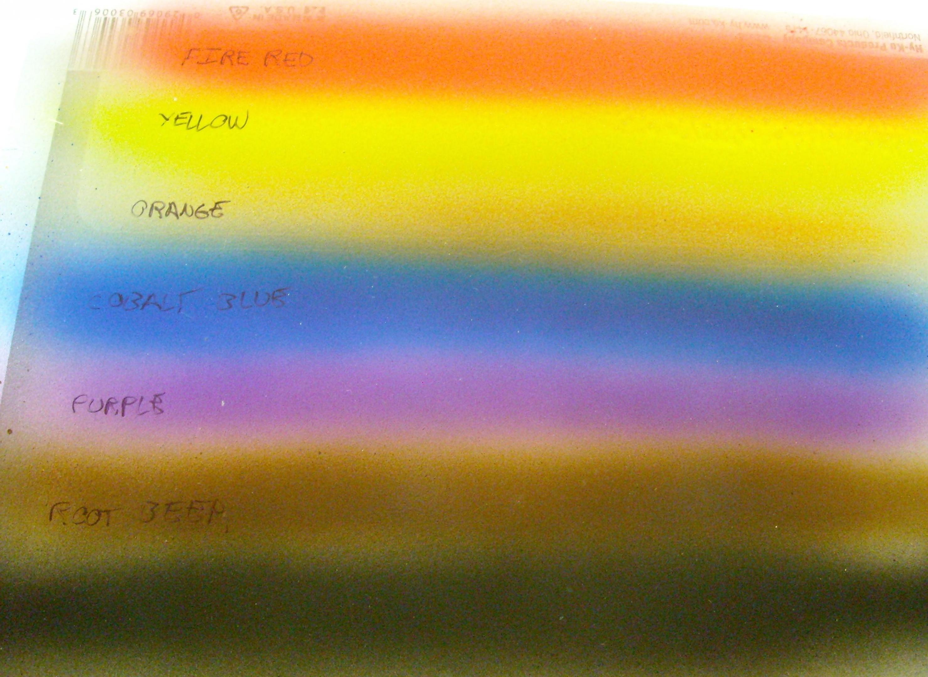

Kit Basher Posted May 7, 2020 Share Posted May 7, 2020 Here are some really poor pictures of sample boards I did of AutoAir Transparents and Candies. All are over Silver Base. The colors are much richer and deeper in real life, but maybe this will give you some idea. The first pic is Transparents, the second Candies. For a clear over Createx, just about anything will work. They recommend 2K clear, but I've used Duplicolor, Krylon, and Testors lacquer. Quote Link to comment Share on other sites More sharing options...
