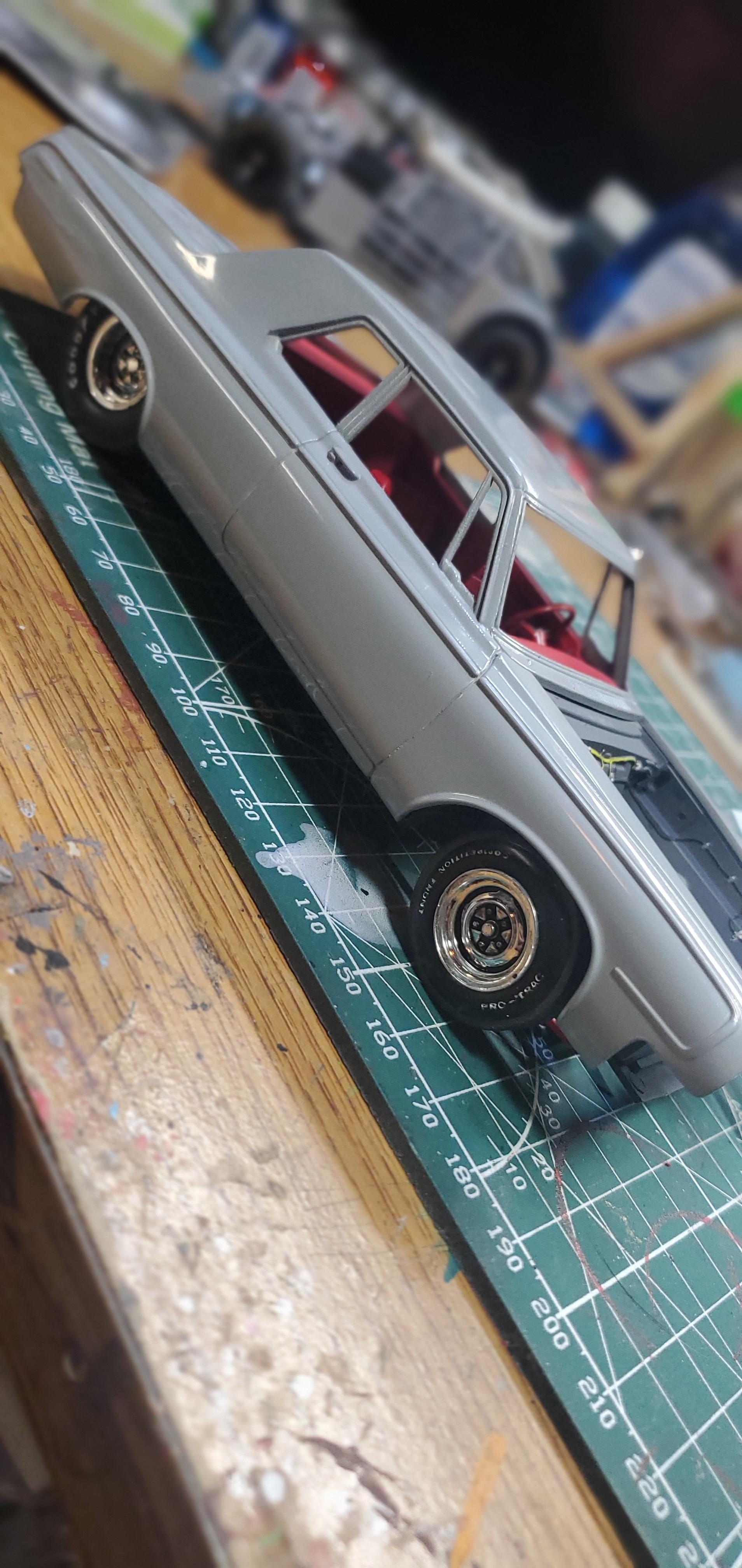

Dragonhawk1066 Posted November 7, 2022 Share Posted November 7, 2022 4 hours ago, TransAmMike said: Great looking paint work Craig. Are those the Createx Pearls? Yes, they're all pearls. I also did the AMT 1969 Plymouth GTX in Pearl Silver, but that doesn't show off in pics very well. Quote Link to comment Share on other sites More sharing options...
