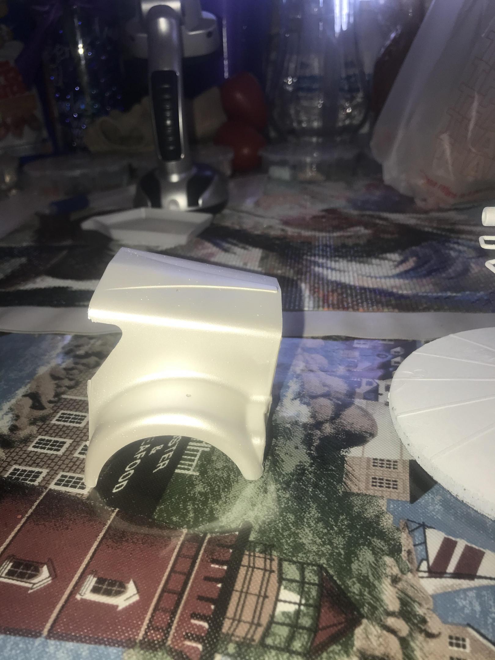

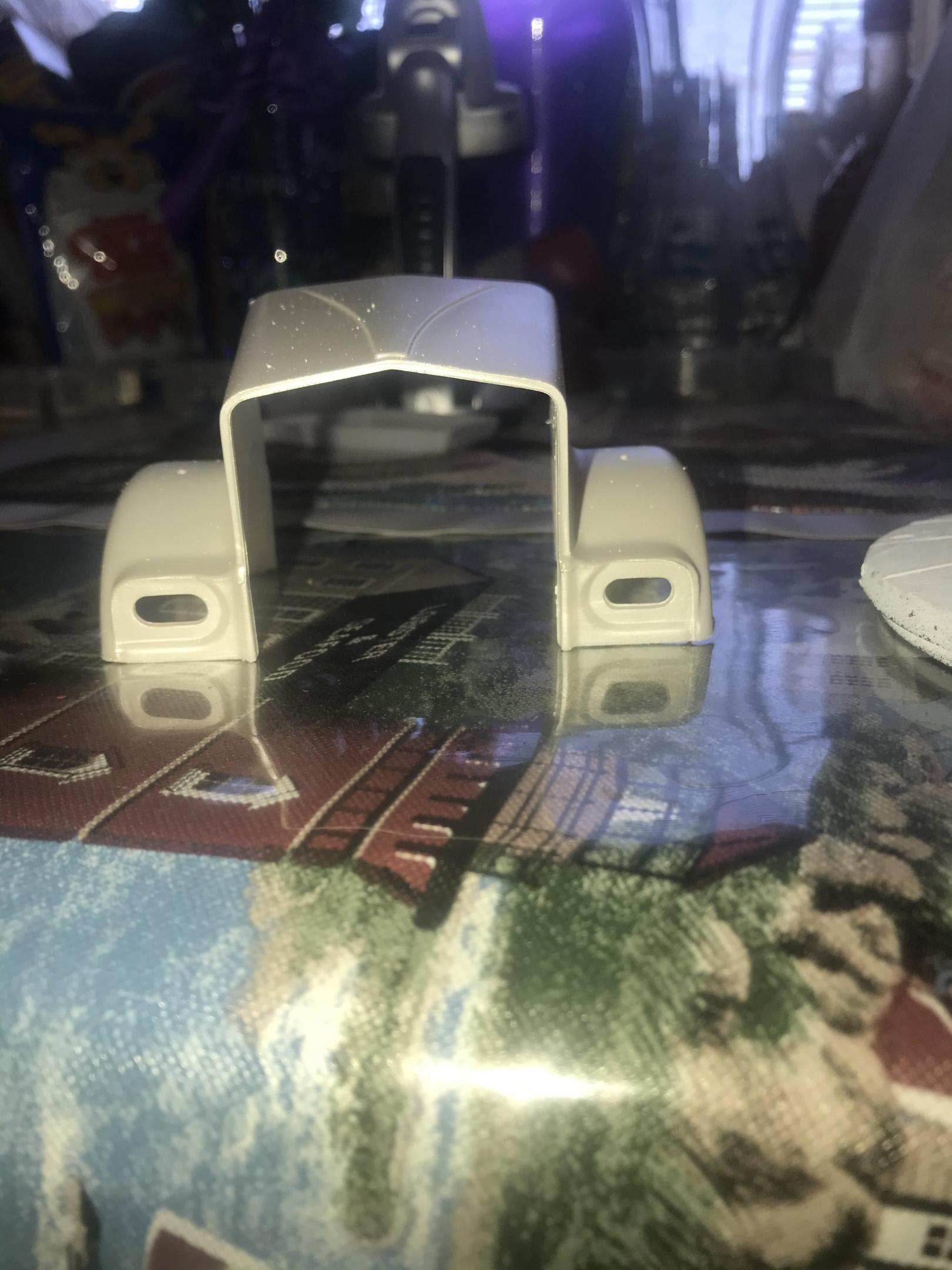

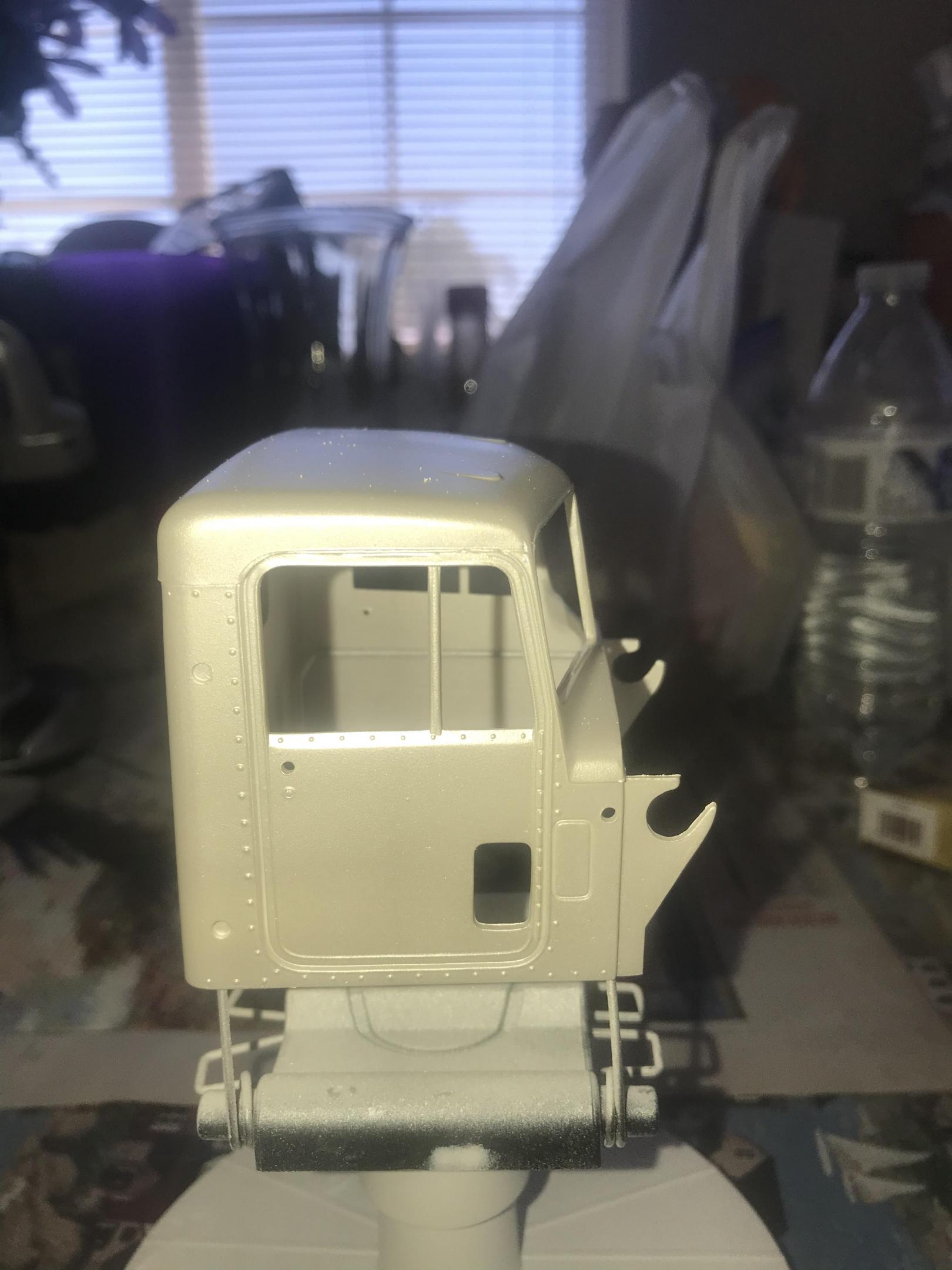

Well gang I spent the morning practicing with my passche H with #3 needle so I got brave and started painting my KW W925 AMT kit and here’s my results. Please critique as this is the first time I’ve ever held an airbrush and I shot with pearl aztek white as my base coat and afterwards I’m gonna mask and do stripes. Mike

Looks to be a promising first airbrushed paint job. Nice even coverage.
If those are dust nibs in the paint as opposed to sitting on top of your paint job, a wet sanding (after it has fully cured) and another coat of paint should set things right. I usually wash the body or parts being painted with dish soap, go over it with some rubbing alcohol and make sure it is clean, dry and free of dust before shooting primer, color coats or clear coats. If dust or debris gets caught in your clear coat(s), a polishing kit can often times get things smooth enough that you'd never notice.

...and painting individual parts mocked up together as an assembly will usually help in getting good color match, good orientation of the metallics or pearls consistent between one panel and the next.

It looks like you got nice even coverage. No runs that I can see. There is definitely some kind of debris on the surface though. Is it dust settled on the surface after it’s dried, or is it stuck to the paint? If is is in the paint, try gman’s advice above.

I wet sanded early this am and shot another coat everything is great thanks guys. Mike
