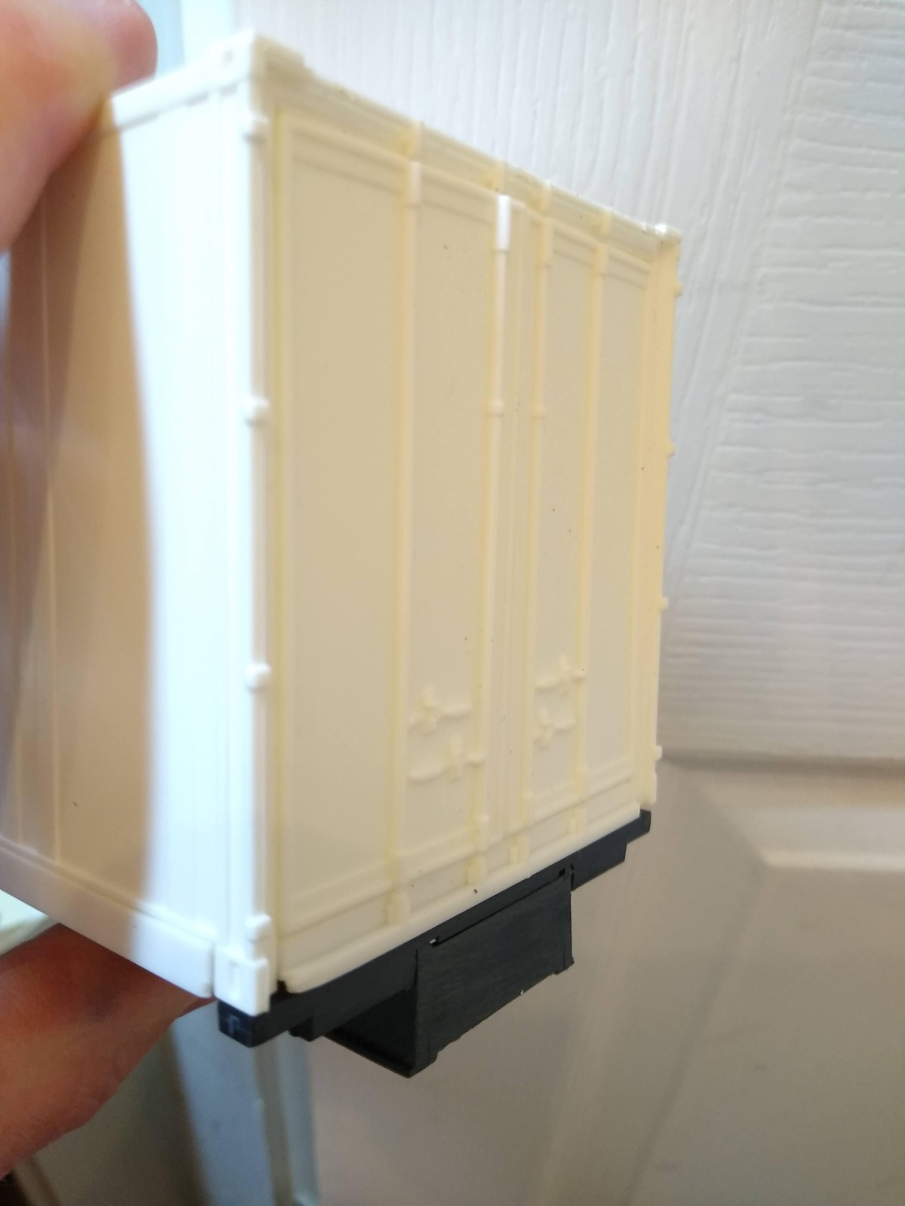

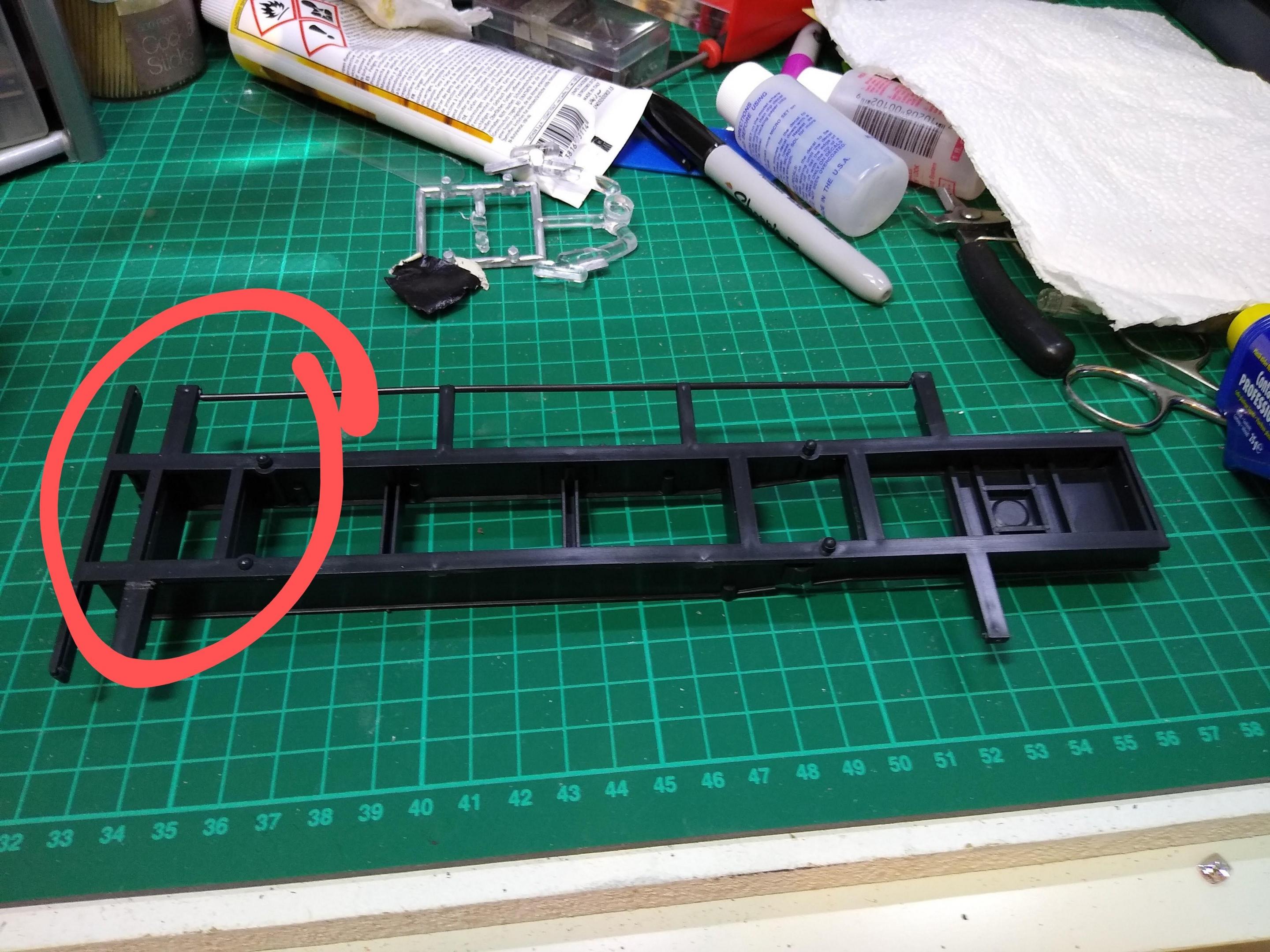

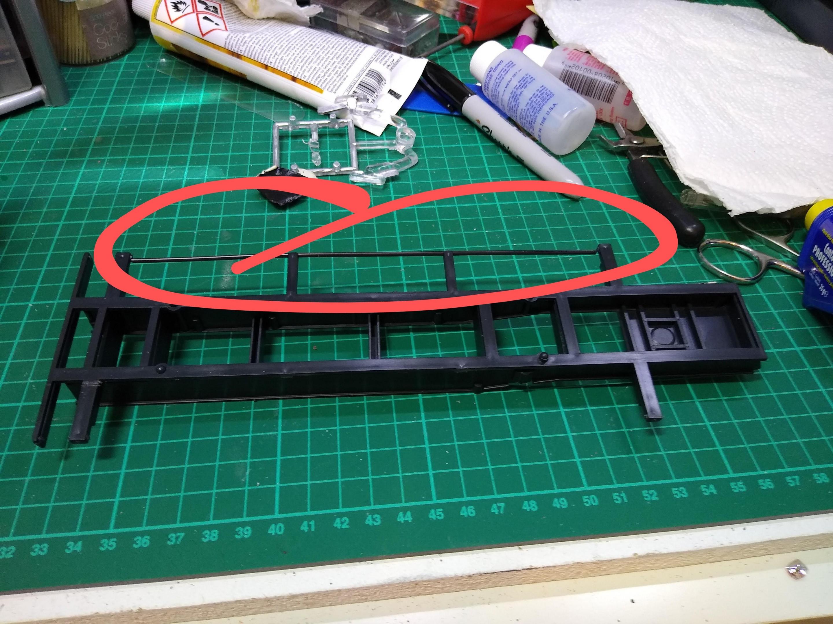

Rockford Posted October 11, 2020 Share Posted October 11, 2020 Never heard of ESCI until I saw this in Ebay. There used to be thousands of these trailer about in Liverpool because of the container terminal om the docks. They used to clatter and bang because of their short frame. They've all gone now, replaced with the more versatile [and more stable] extendable frames. This kit is very well made, no flash whatsoever and straight as a die, but has issues. From the box art you can see there's a ledge at the back which had to go, also a guardrail along the top between the twistlocks. I decided to cut the frame rather than move the container mounts backwards as the frame co es in two pieces, the top flange of the frame carries the crossmembers for the twistlocks and drops on to the chassis rails. I cut the frame down at a convenient crossmember. Quote Link to comment Share on other sites More sharing options...

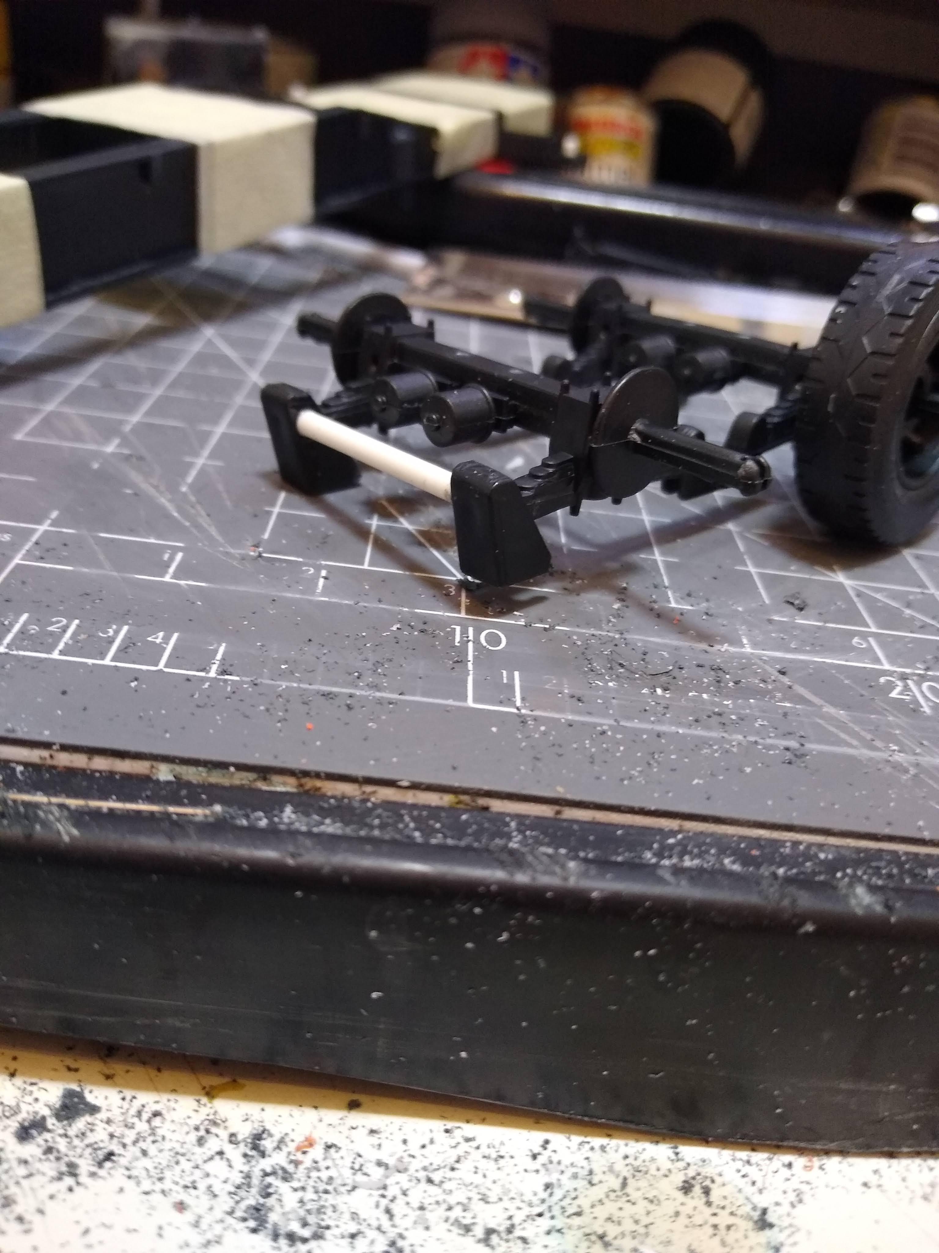

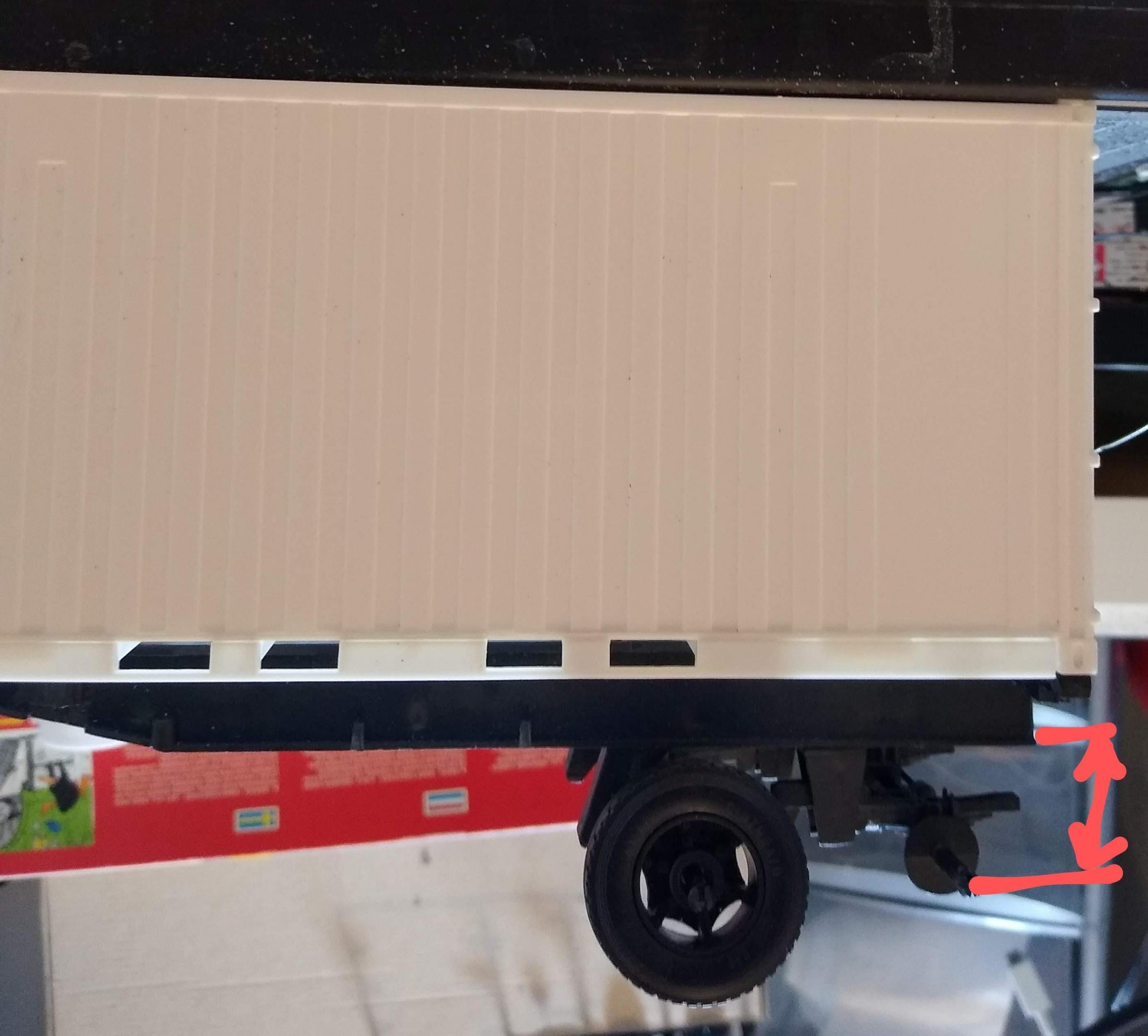

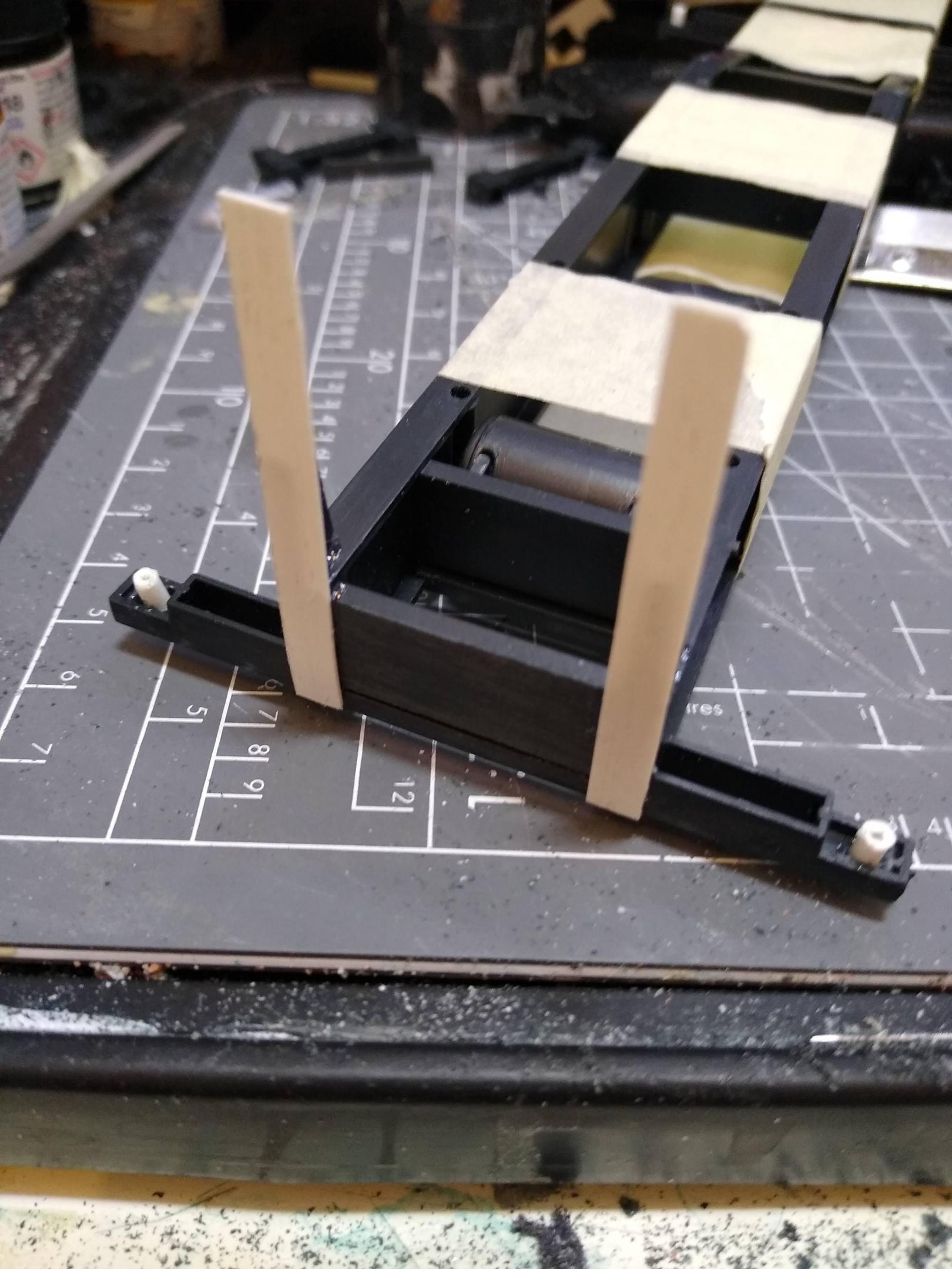

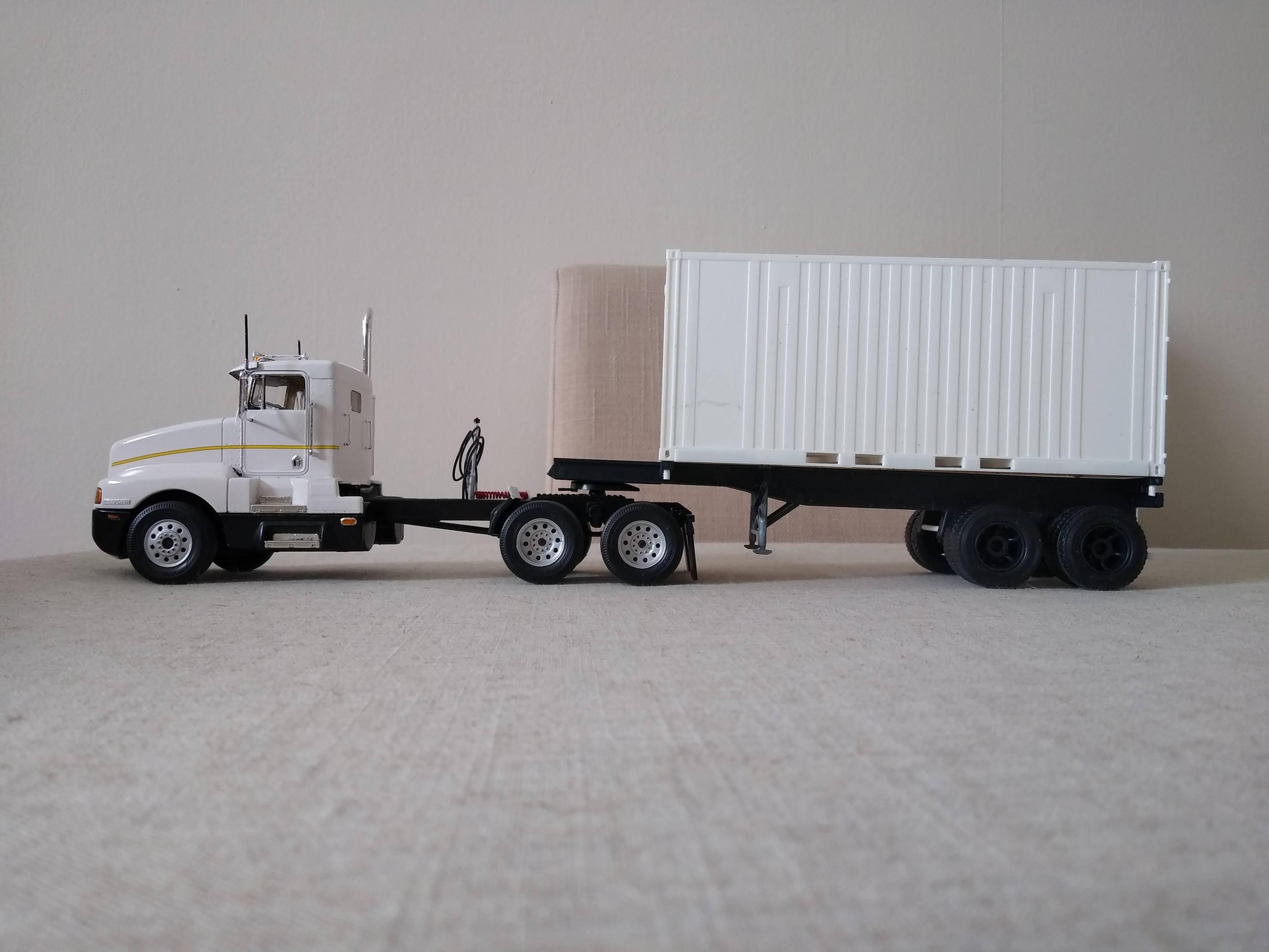

Rockford Posted October 11, 2020 Author Share Posted October 11, 2020 Mocking things up I found the ride height was that of a crop sprayer, probably because of the snap fit design. I removed about 6mm by cutting off a needless top crossmember from the suspension subframe. I added the usual tubular crossmember between the front suspension mounts. Quote Link to comment Share on other sites More sharing options...

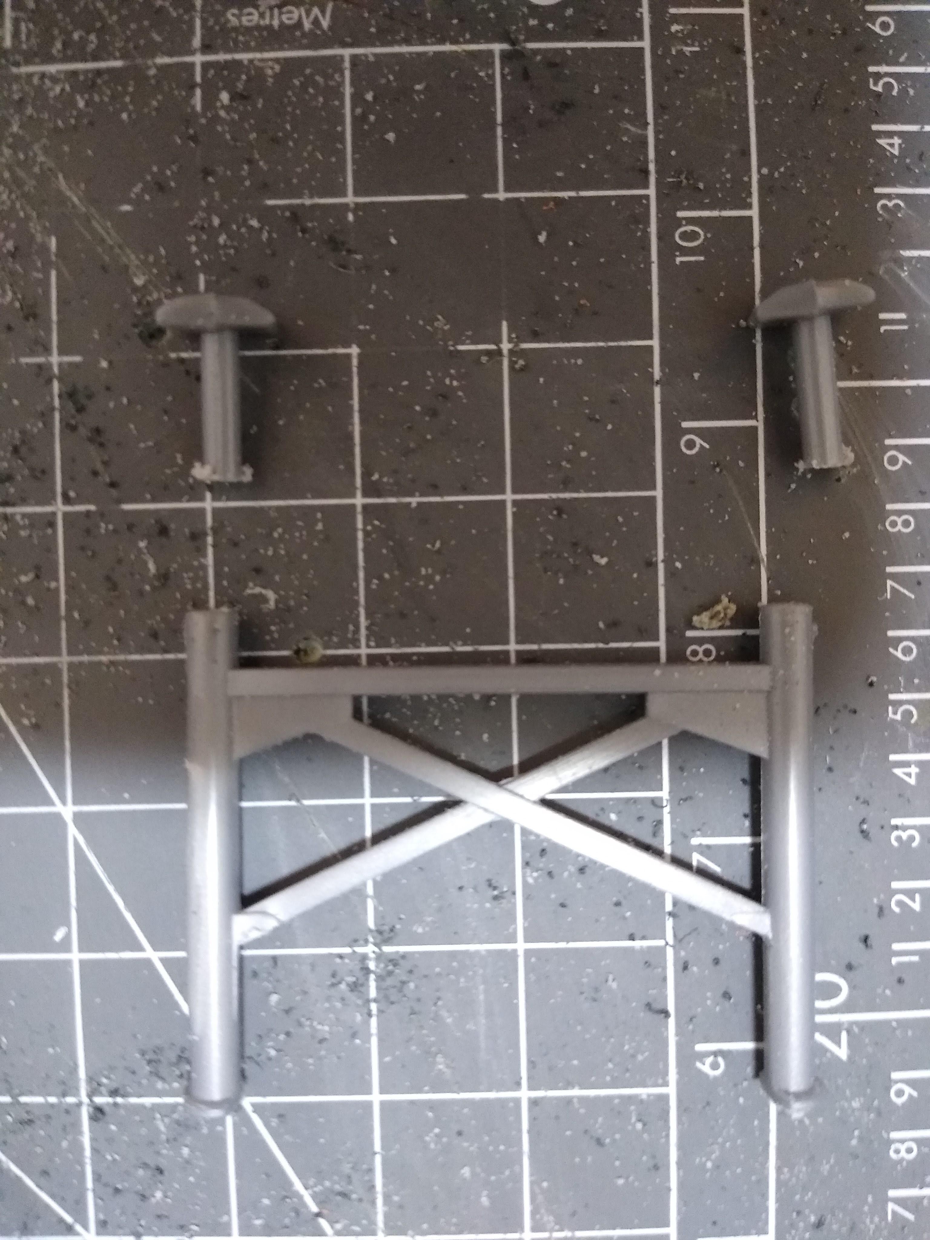

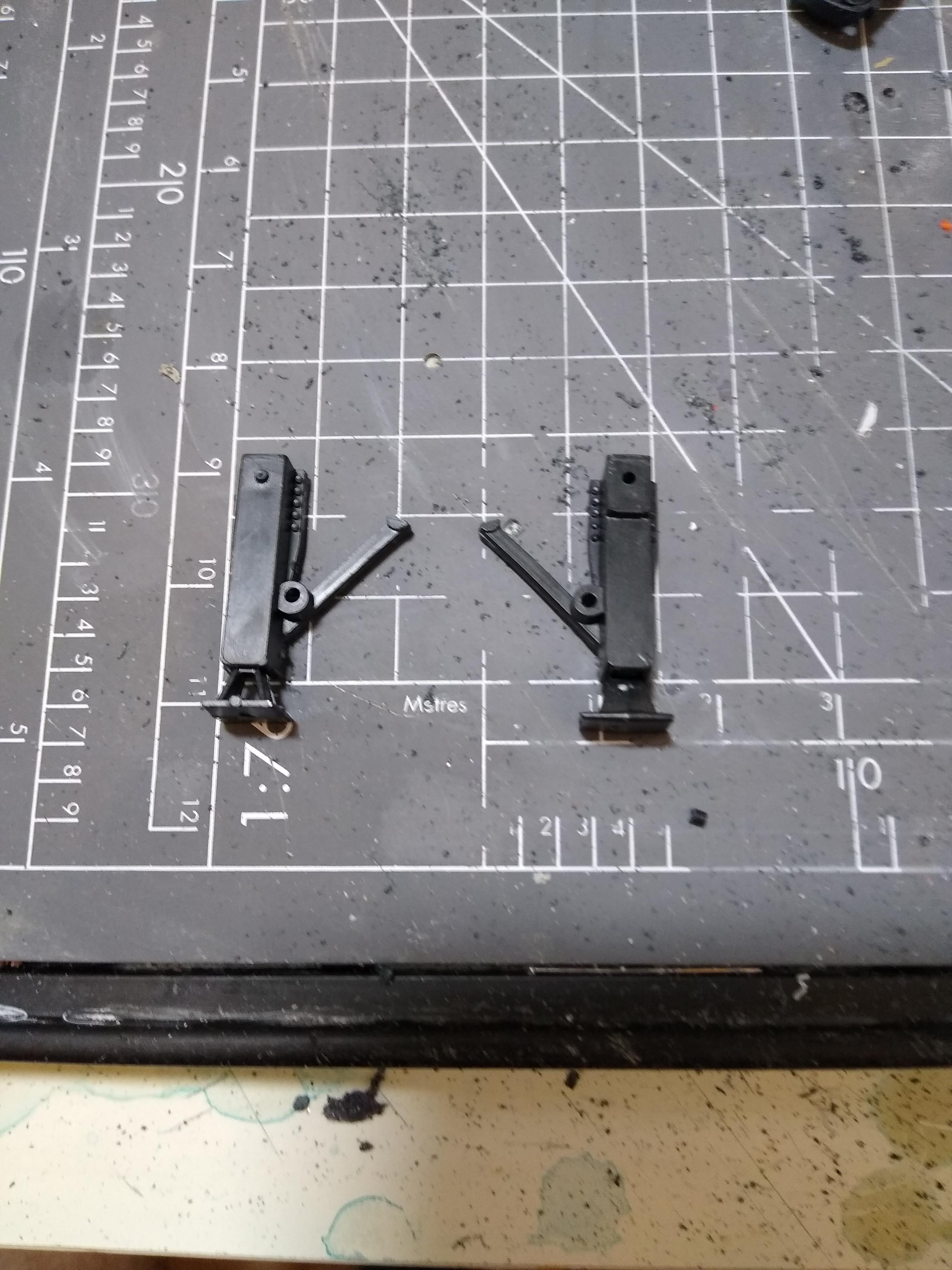

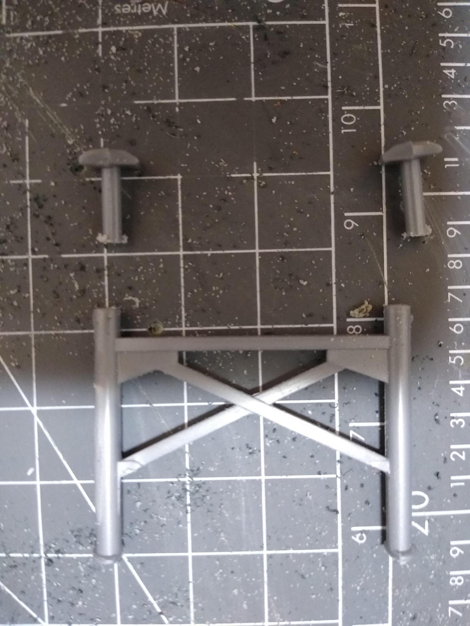

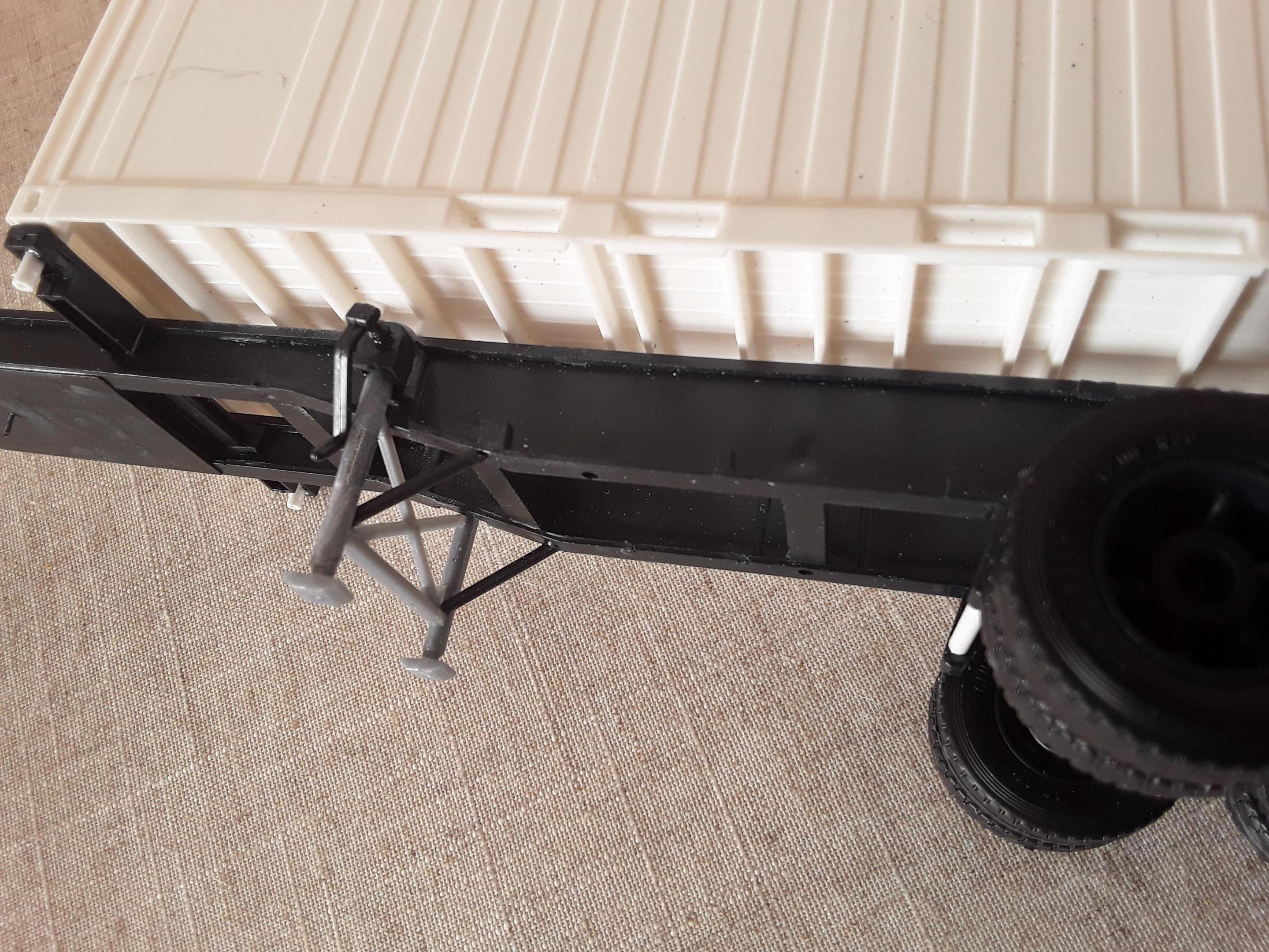

Rockford Posted October 11, 2020 Author Share Posted October 11, 2020 The landing gear was too heavy, like something off a bridge structure! I ditched it in favour of the legs off the Revell Snap Tite tanker [the spare ones that are in the extended position] which I cut down and added diagonal braces. Fabbed up a gearbox and used the winding handle fro the kit. Looks a lot better. Quote Link to comment Share on other sites More sharing options...

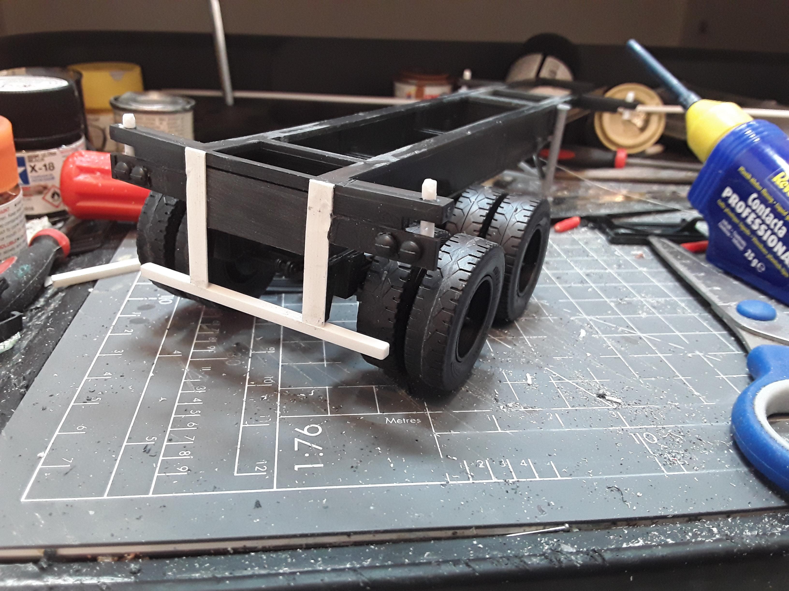

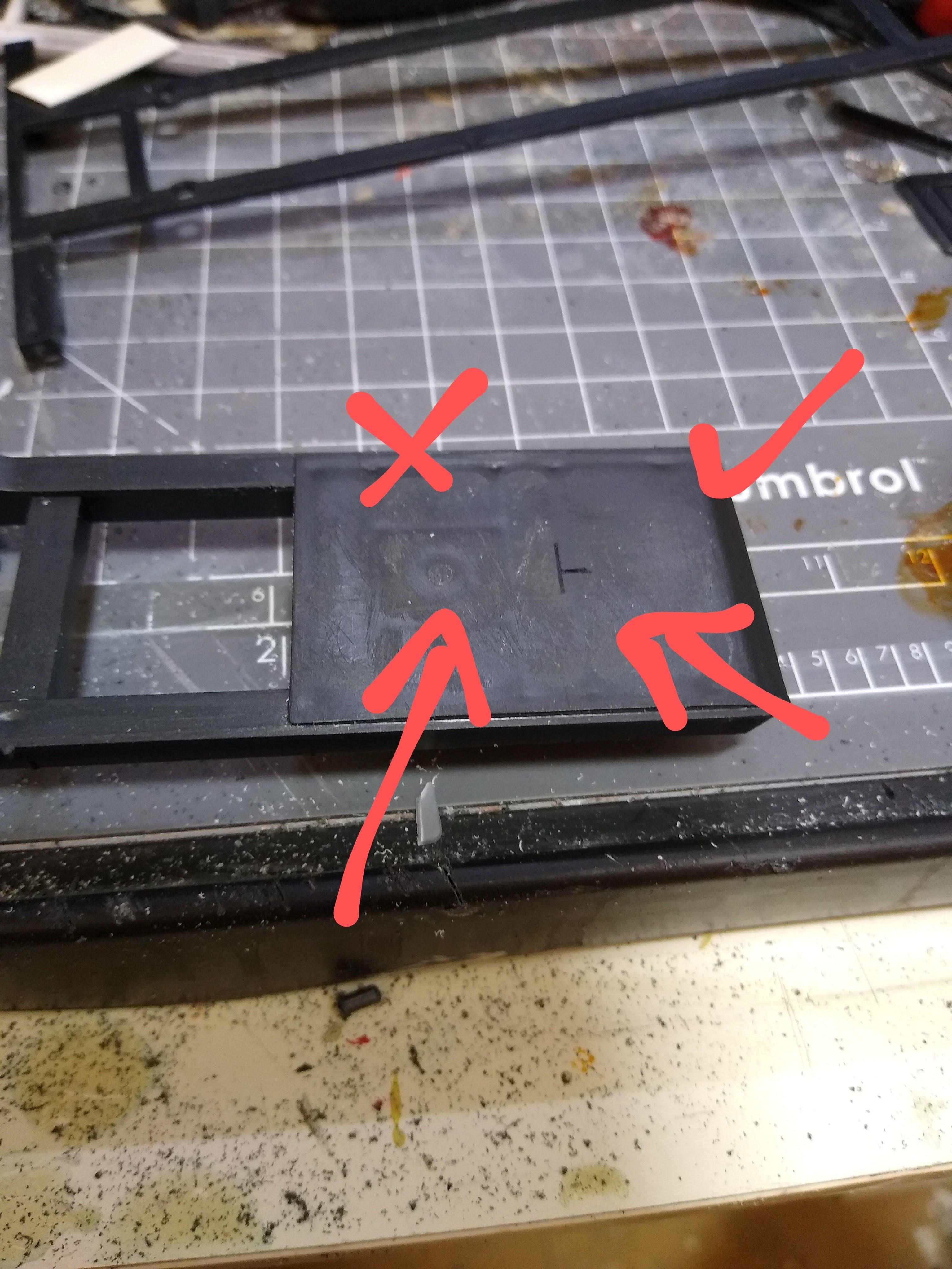

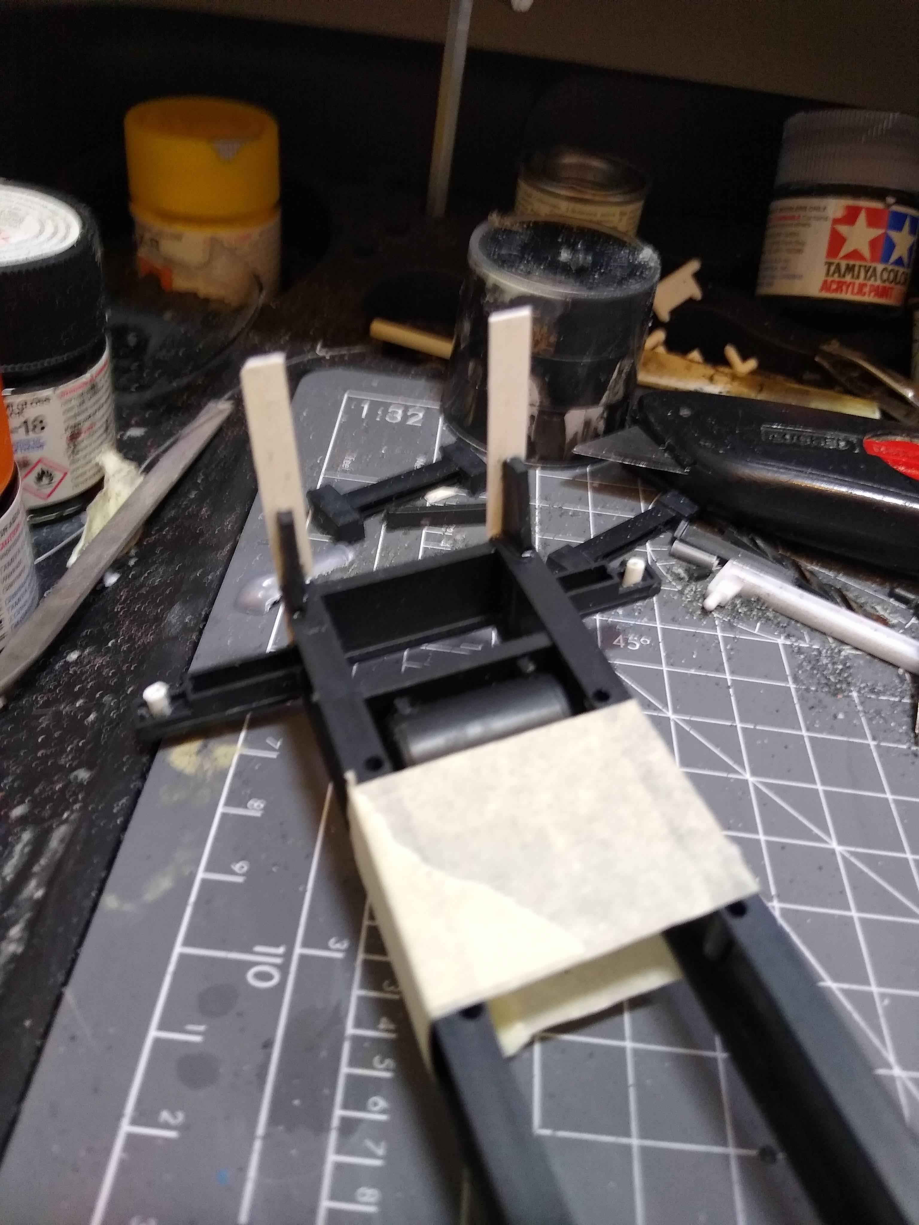

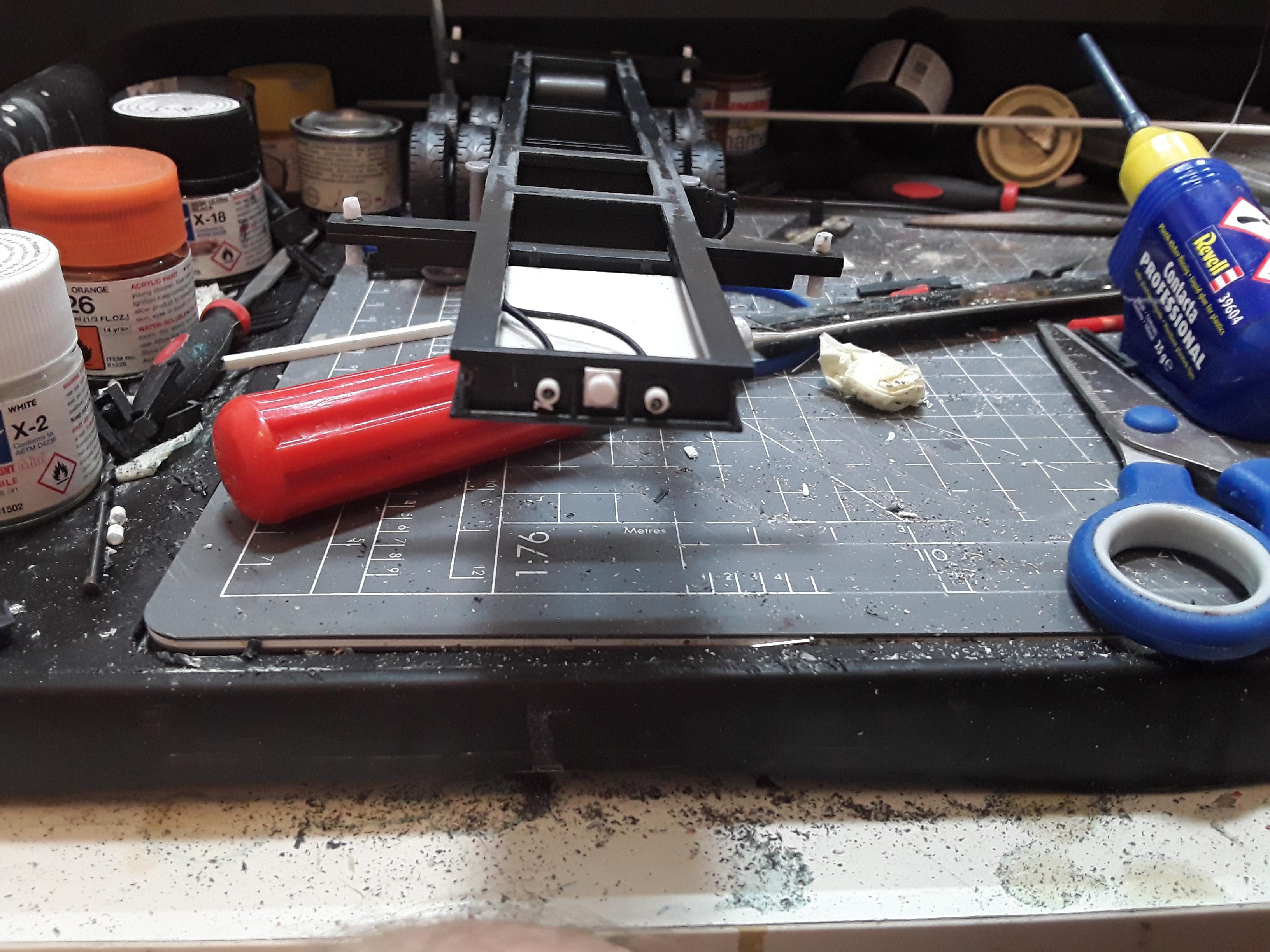

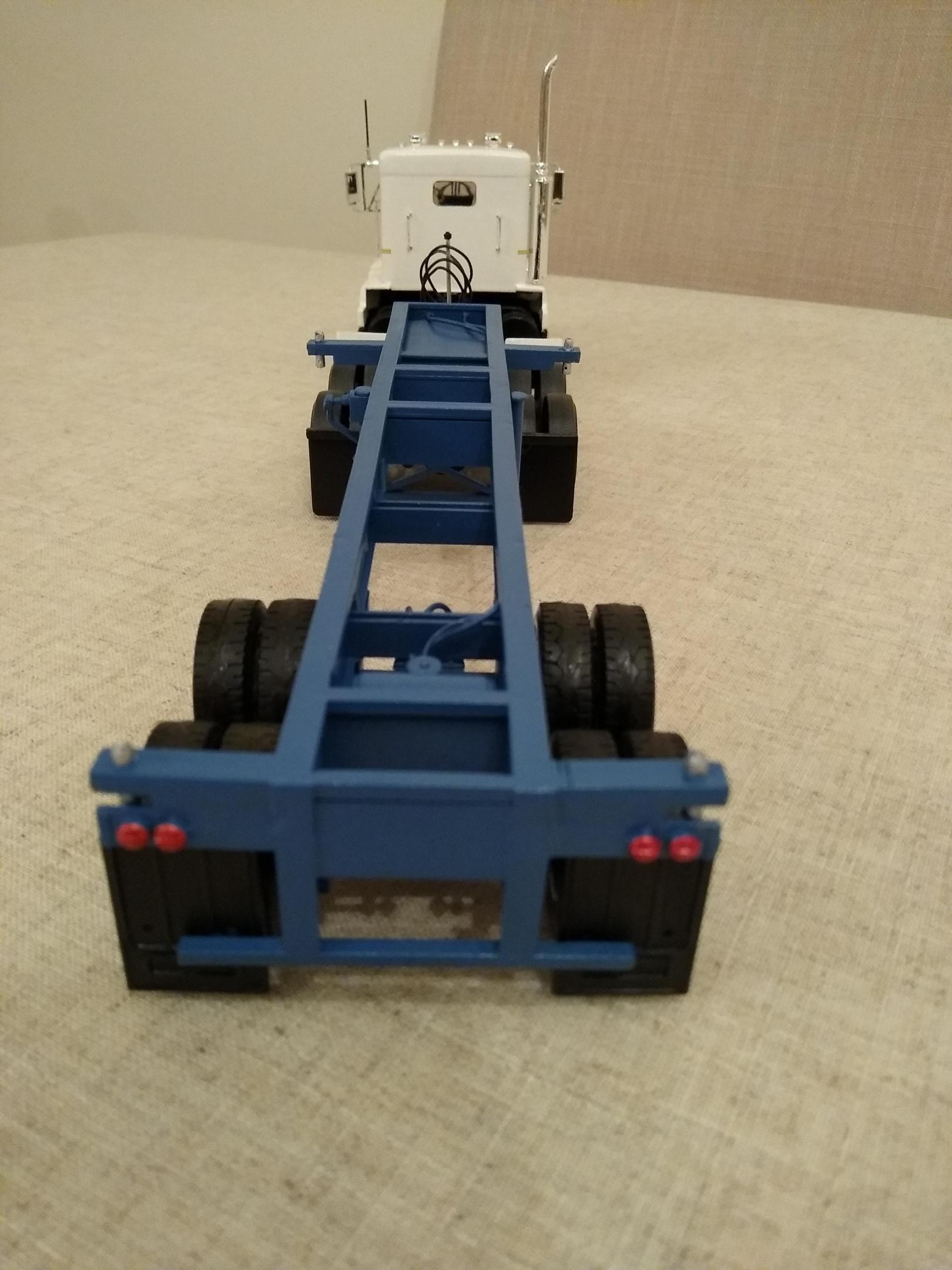

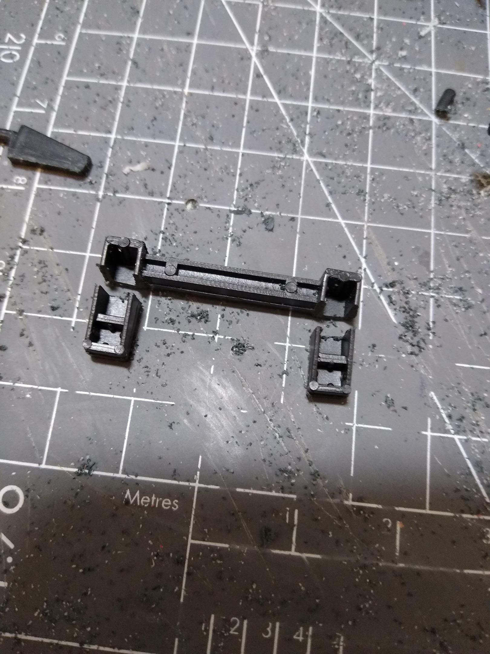

Rockford Posted October 11, 2020 Author Share Posted October 11, 2020 The kingpin was too far back and didn't look right at all, but would also cause the landing legs to foul the tractor frame if left. I moved it forward, then covered the work with a piece of plastic card. I also added couplings for air and electrics at the front of the frame and added a couple of airlines snaking off from the couplings and knto the frame. The rear bumper is a European looking thing so I fabricated a new one. Using plastic card, the triangular mounts for the original bumper and some square rod. I cut the rear lights out of the bumper assembly and put them below the outrigger for the container. Quote Link to comment Share on other sites More sharing options...

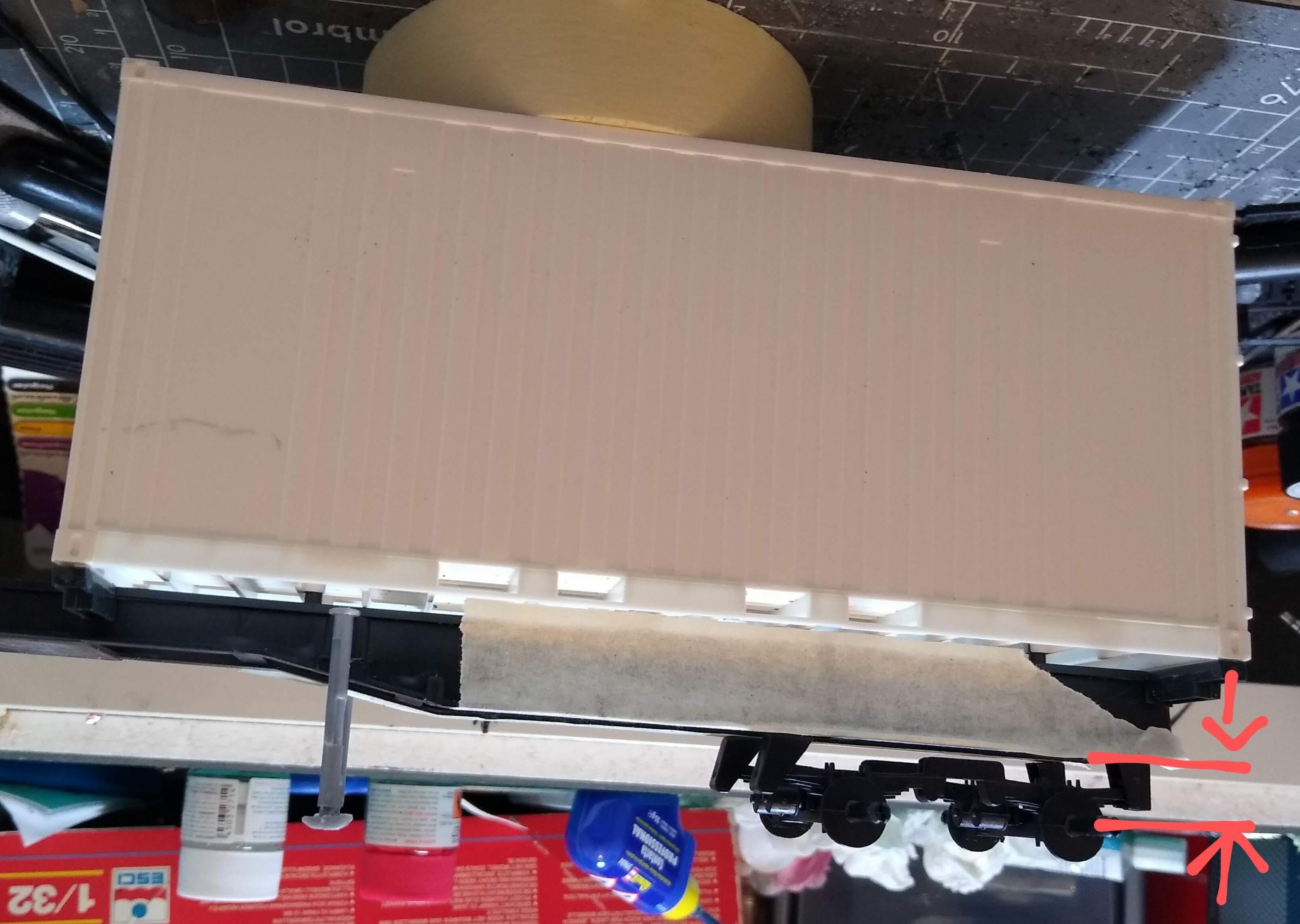

Rockford Posted October 11, 2020 Author Share Posted October 11, 2020 You can also see the twistlocks I built by drilling through the outrigger and into the container, then I used plastic rod to form a twistlock. I'll put wire through the bottom se tion to make the handle. Now that the ride height is more realistic the chassis angles upward when coupled to the point that the front axle is off the floor, I'll have to adjust the suspension a little so that it accommodates the angle. I also want to fabricate a relay valve at the air reservoir with the hoses going to the brake chambers as it is all so visible when the container is not there. So, it's coming up to paint. Now, these trailers were never very well painted so I'm not too worried about the finish. The only thing is I'm not at all certain about a colour. I'm thinking of a mid blue, but the wheels are important too, do I do the hub chassis colour with full silver rims, or paint them all chassis colour with just the very outer edge of the rim painted white. Quote Link to comment Share on other sites More sharing options...

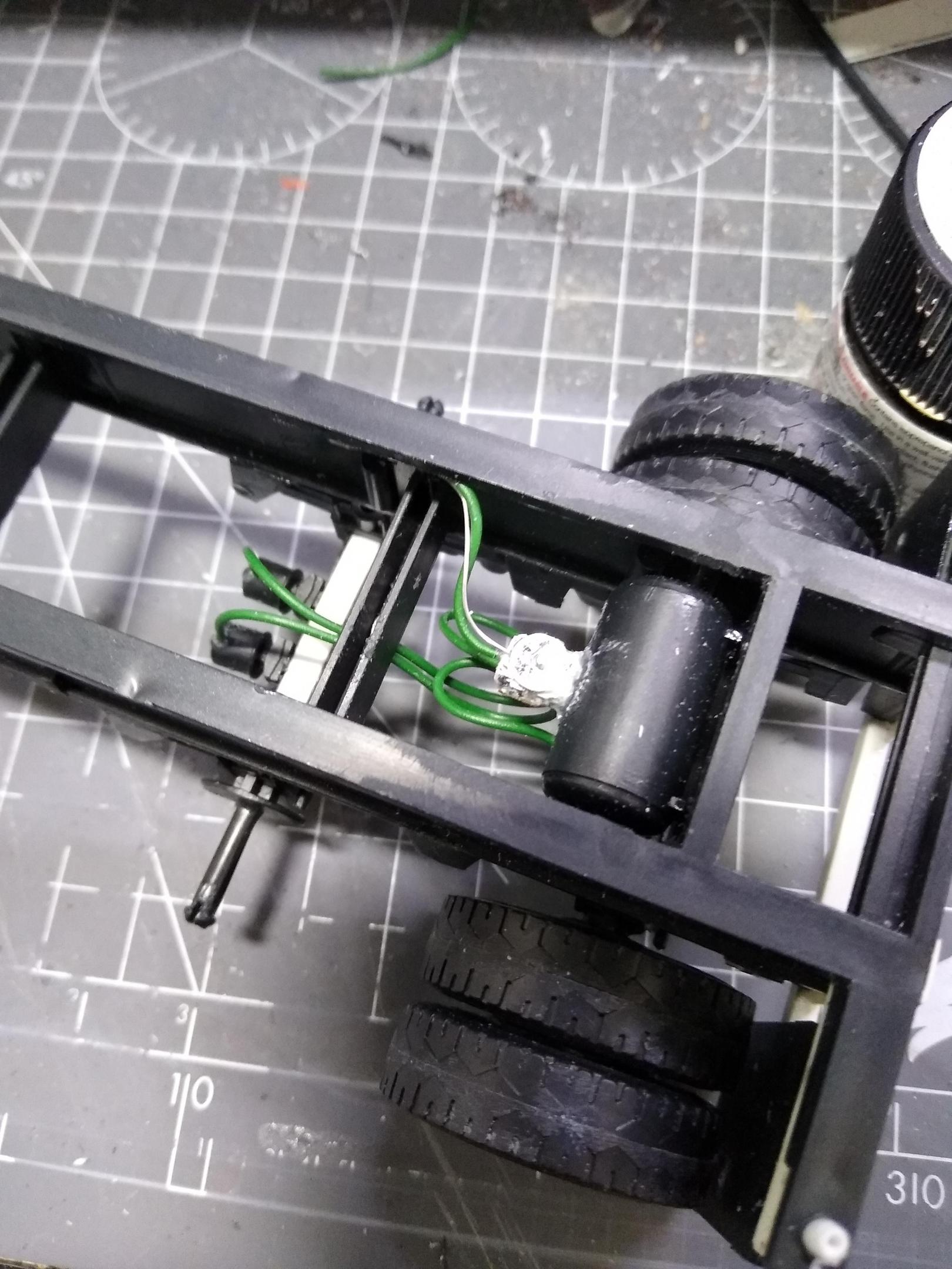

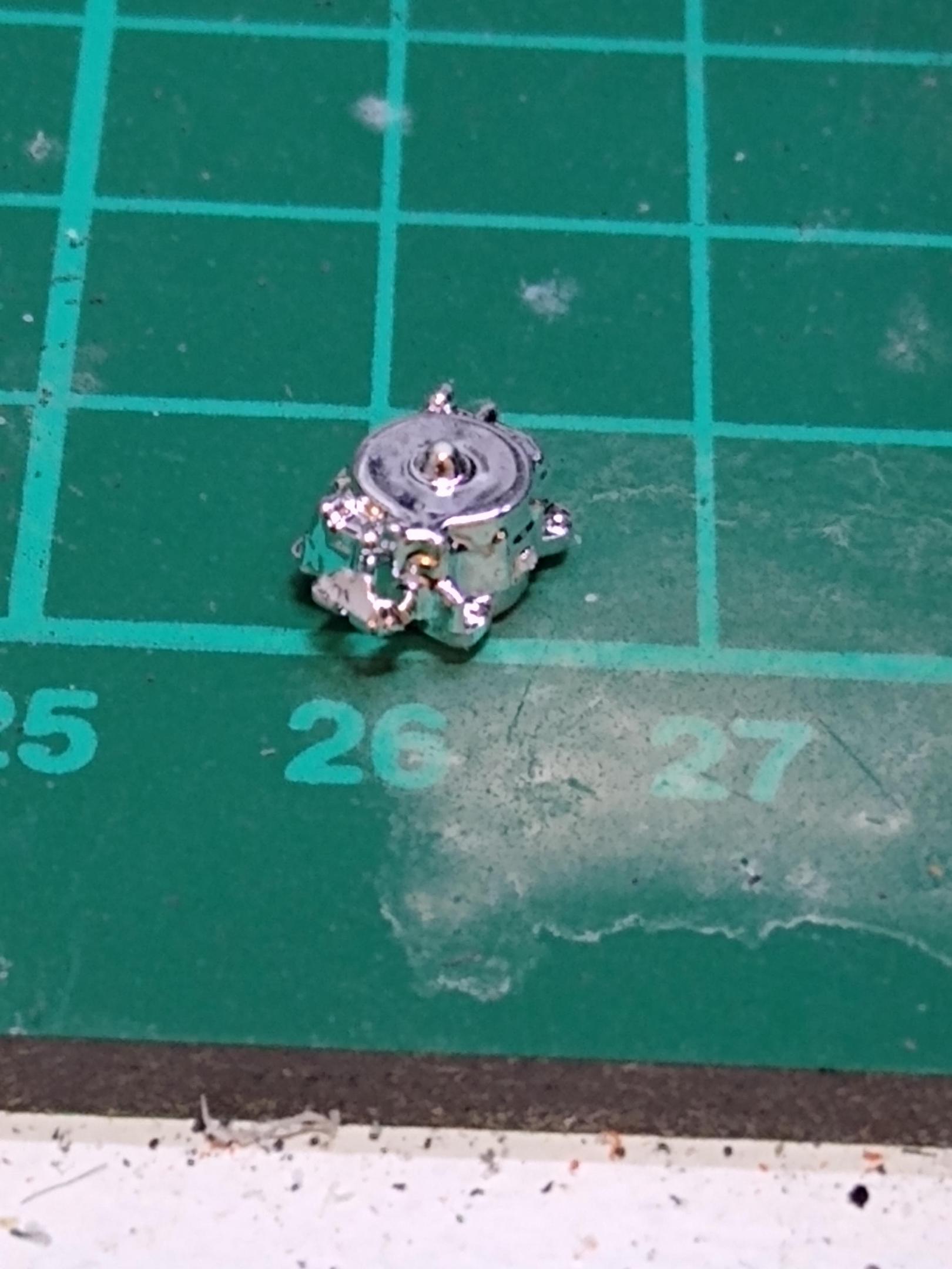

Rockford Posted October 11, 2020 Author Share Posted October 11, 2020 Thanks Dutzie. I've been rooting through my odds and ends box for something like a brake relay valve and I found this. A 1/25 carburettor, looks like a Thermoquad that became the Edelbrock carb. The body can form the diaphragm housing and the four corners of the flange can be the four outlets to the chambers. Quote Link to comment Share on other sites More sharing options...

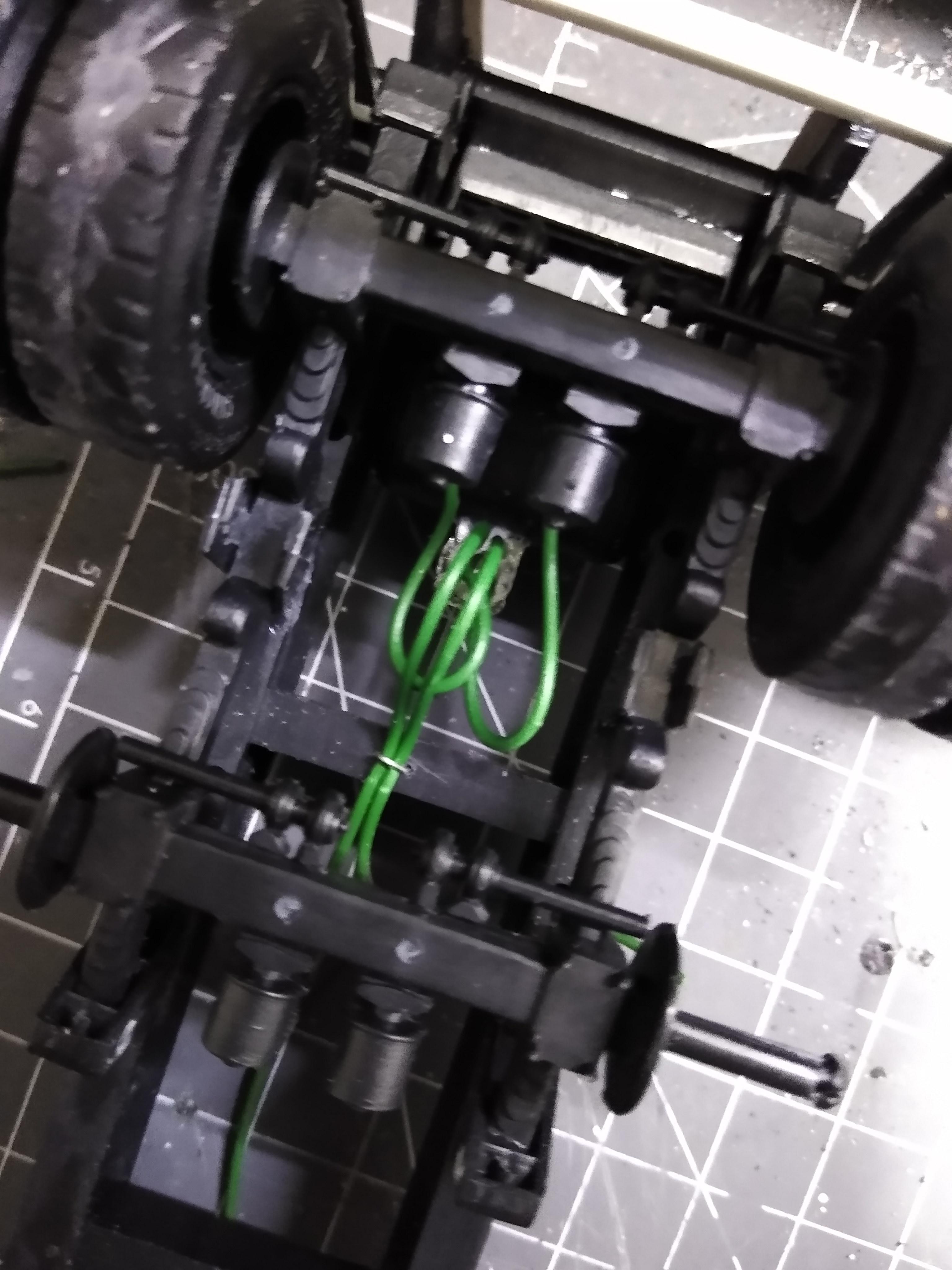

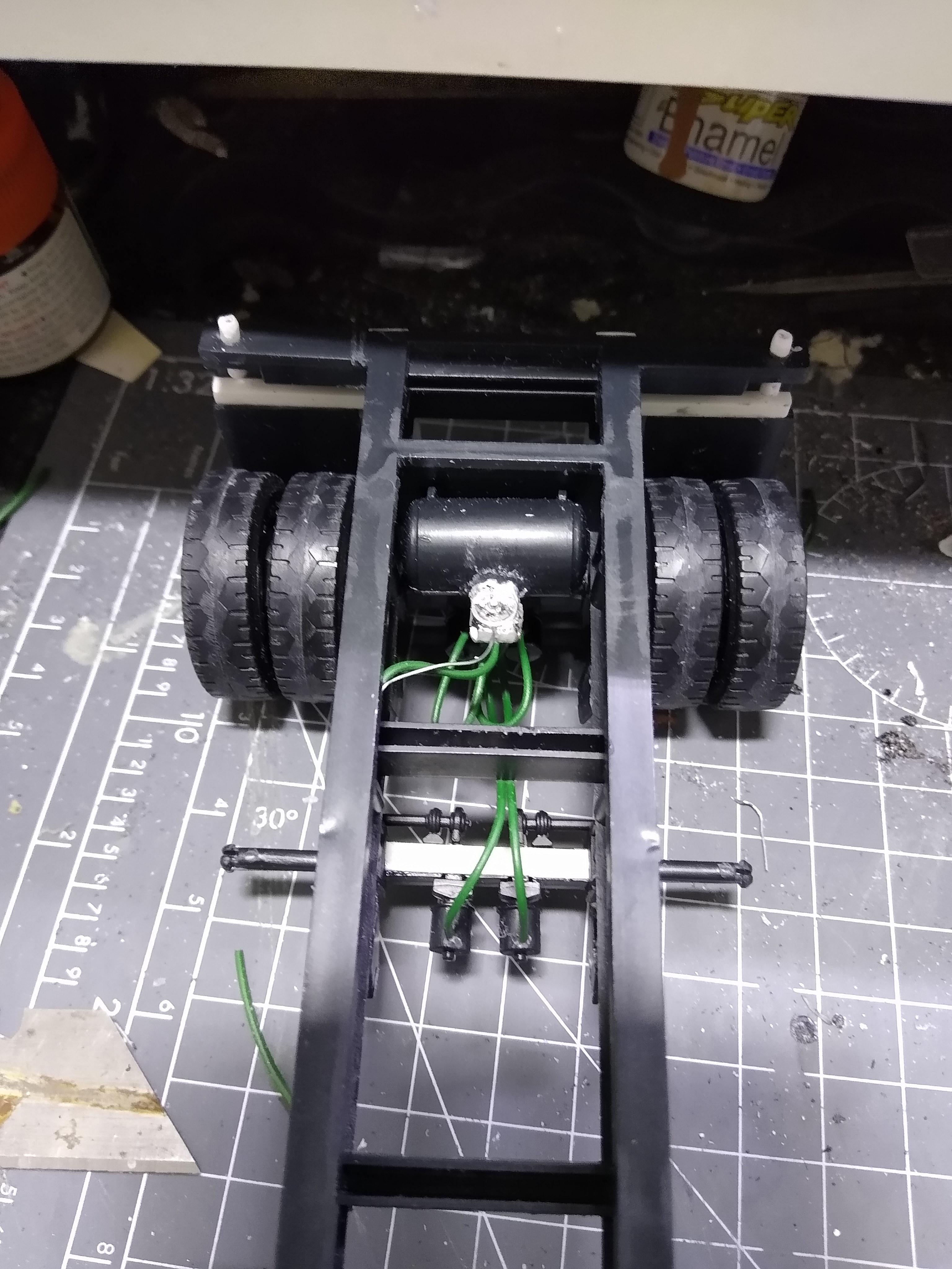

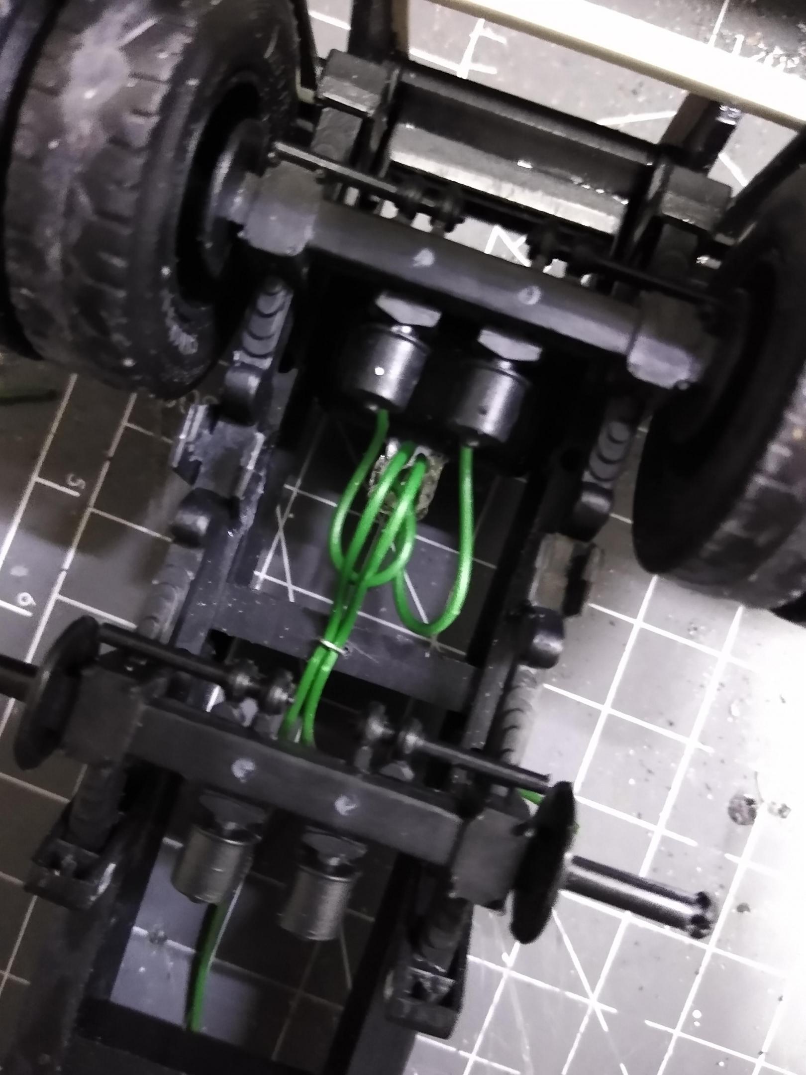

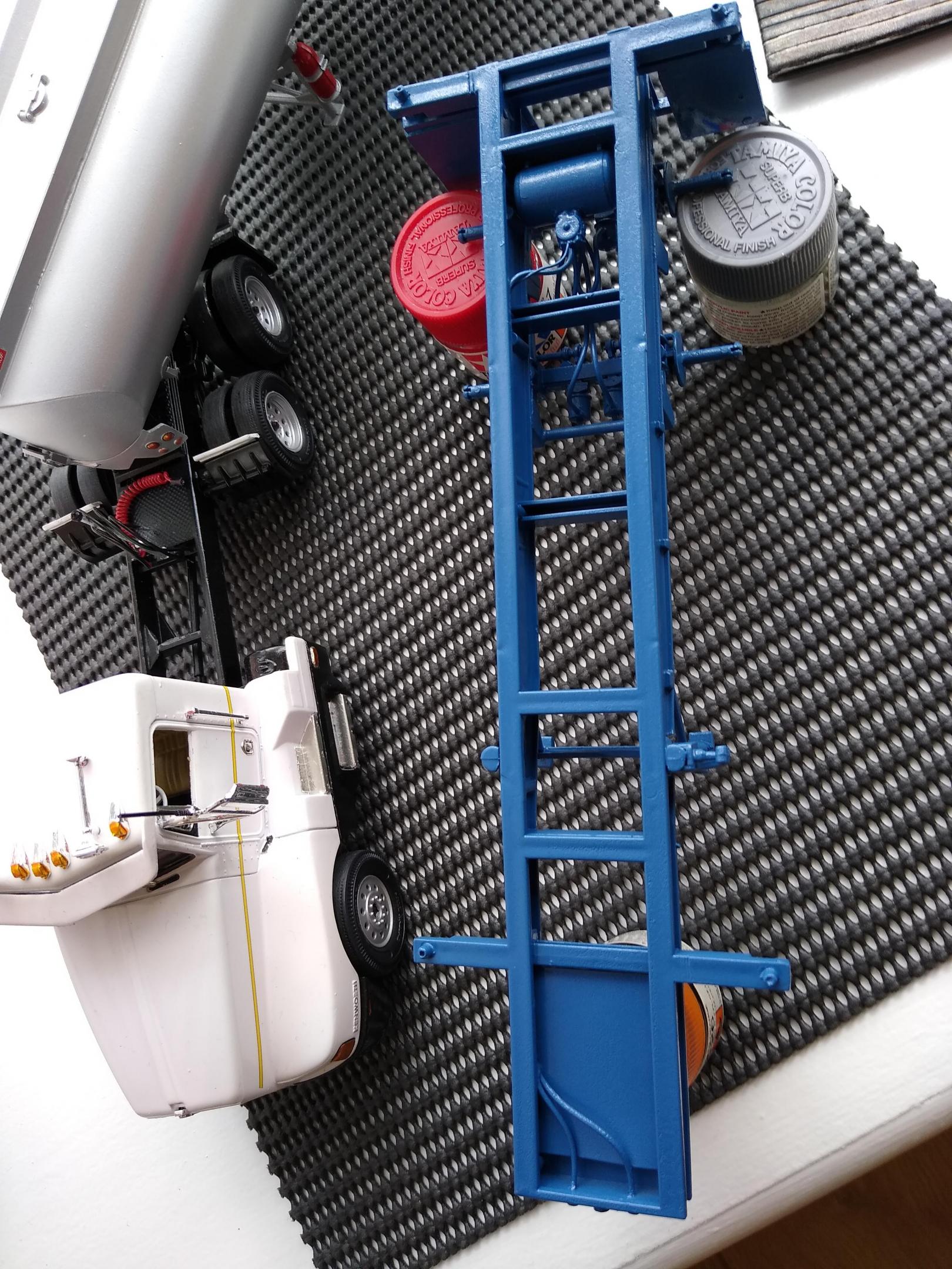

Rockford Posted October 19, 2020 Author Share Posted October 19, 2020 Did a bit more on the trailer before it goes for paint. Shaped a trailer relay valve from the old carburettor I found. Drilled holes to fit pigtails in the brake chambers and the valve. Also did the same for the signal and emergency lines to the valve. I know it will all end up painted chassis colour but that's what happened with our trailers, we didn't mask the pipework it all got blasted with colour! I also realized the top of the axles are hollow so I fitted some plastic strip over the hole, that's the white piece in the photos. Quote Link to comment Share on other sites More sharing options...

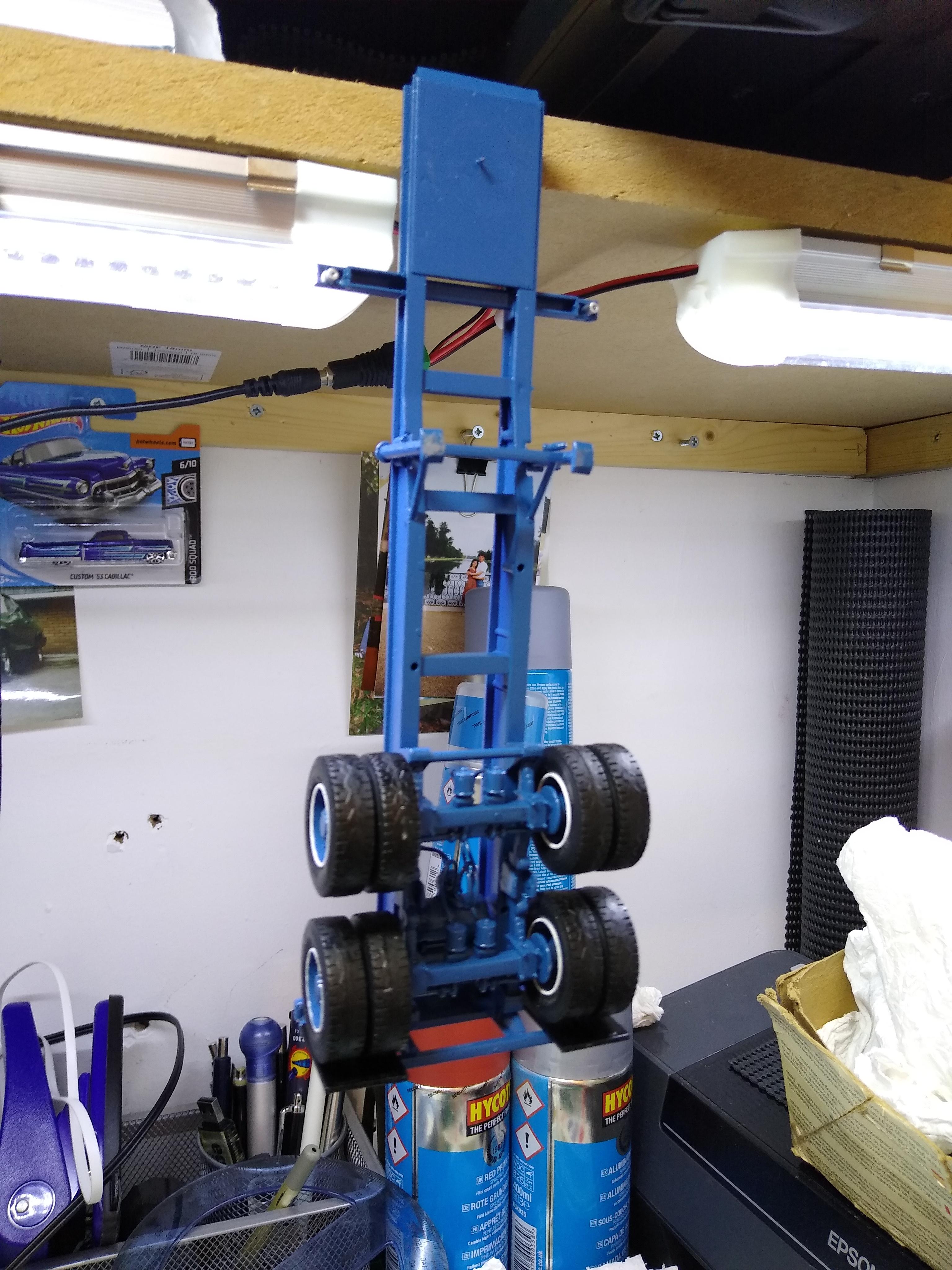

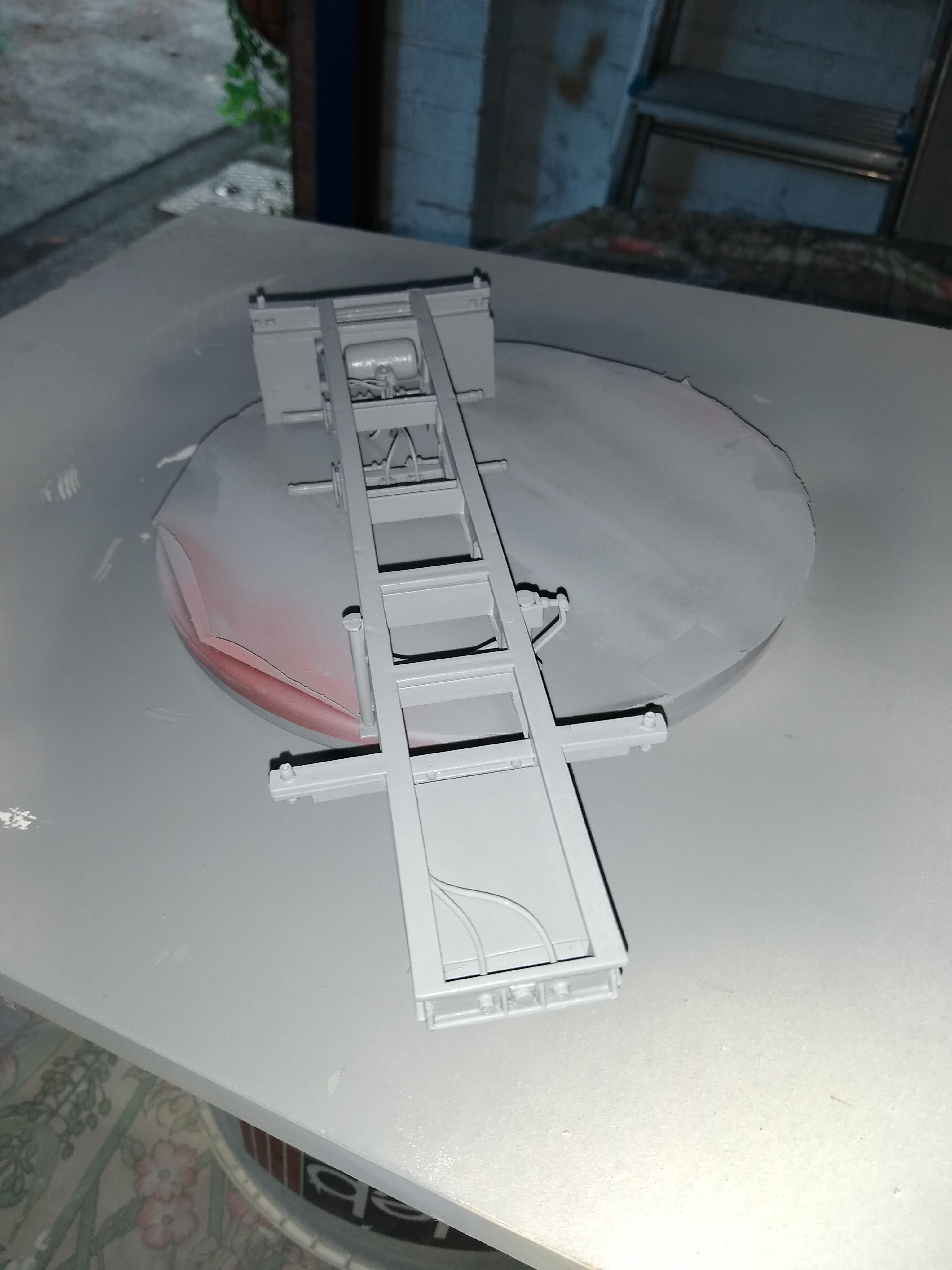

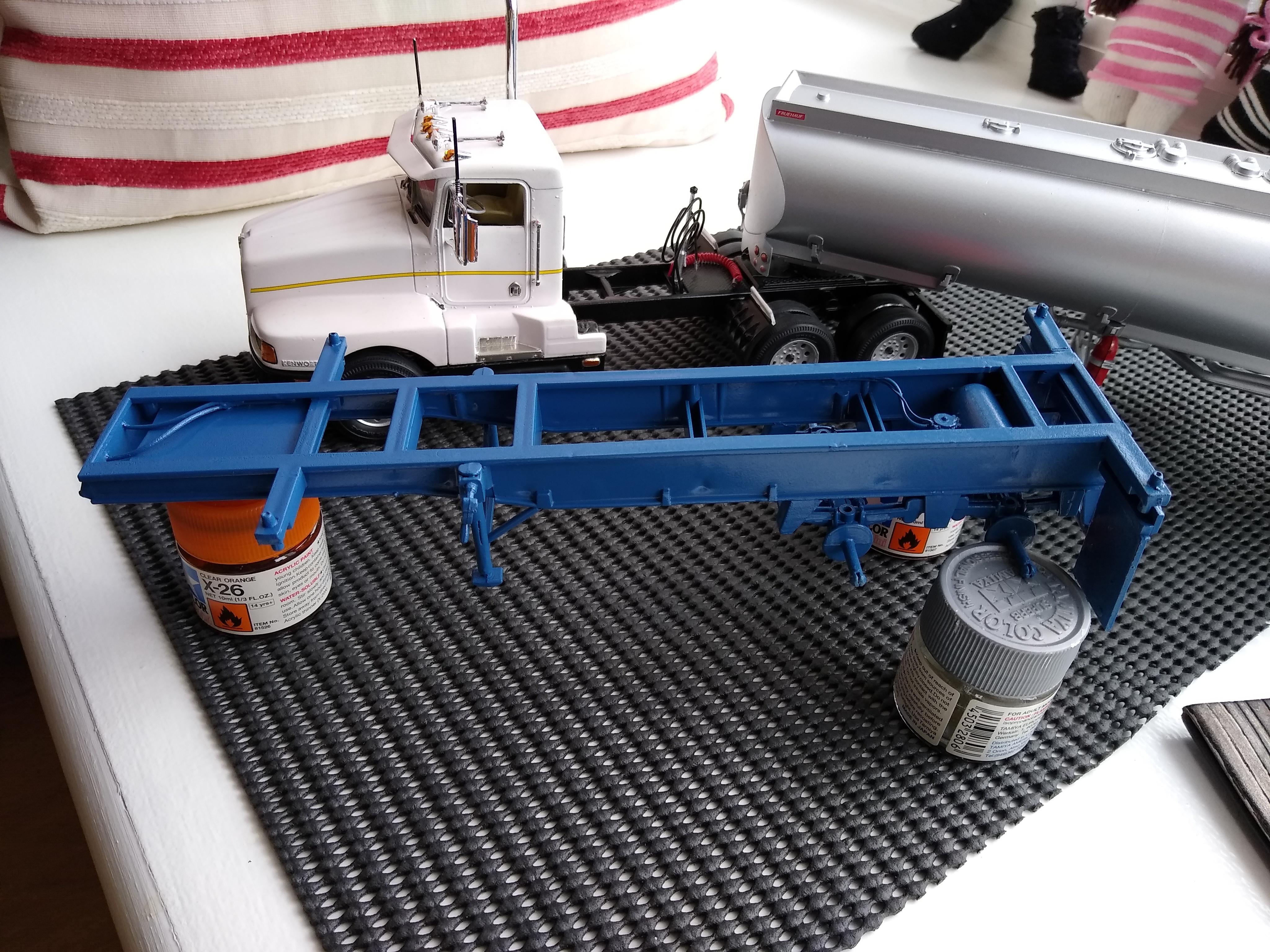

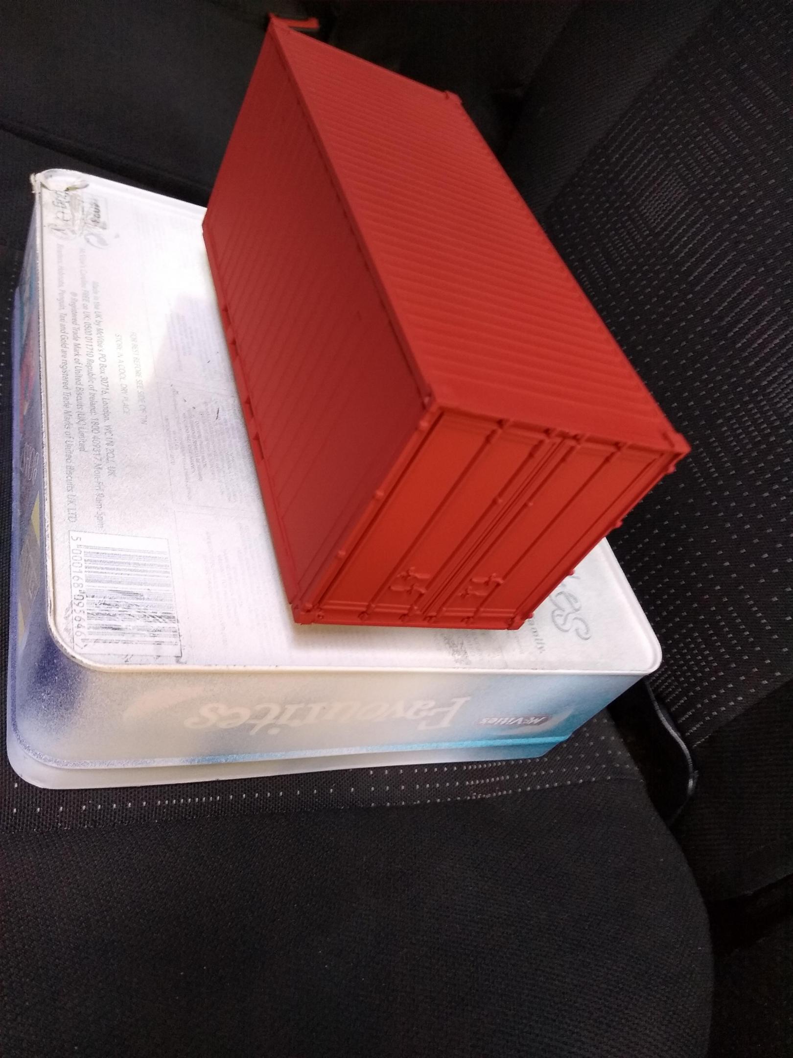

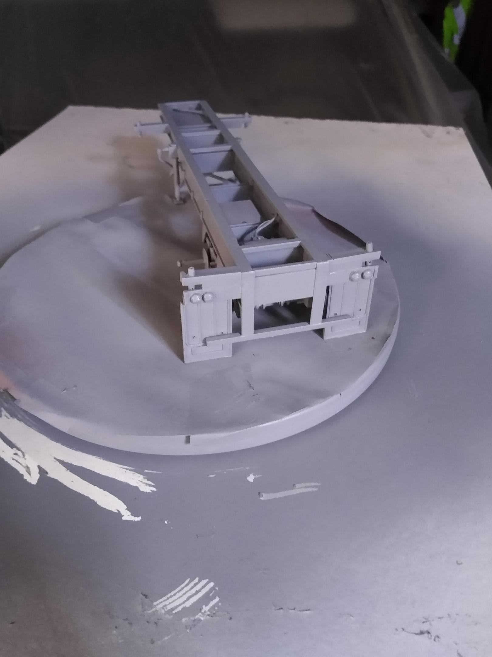

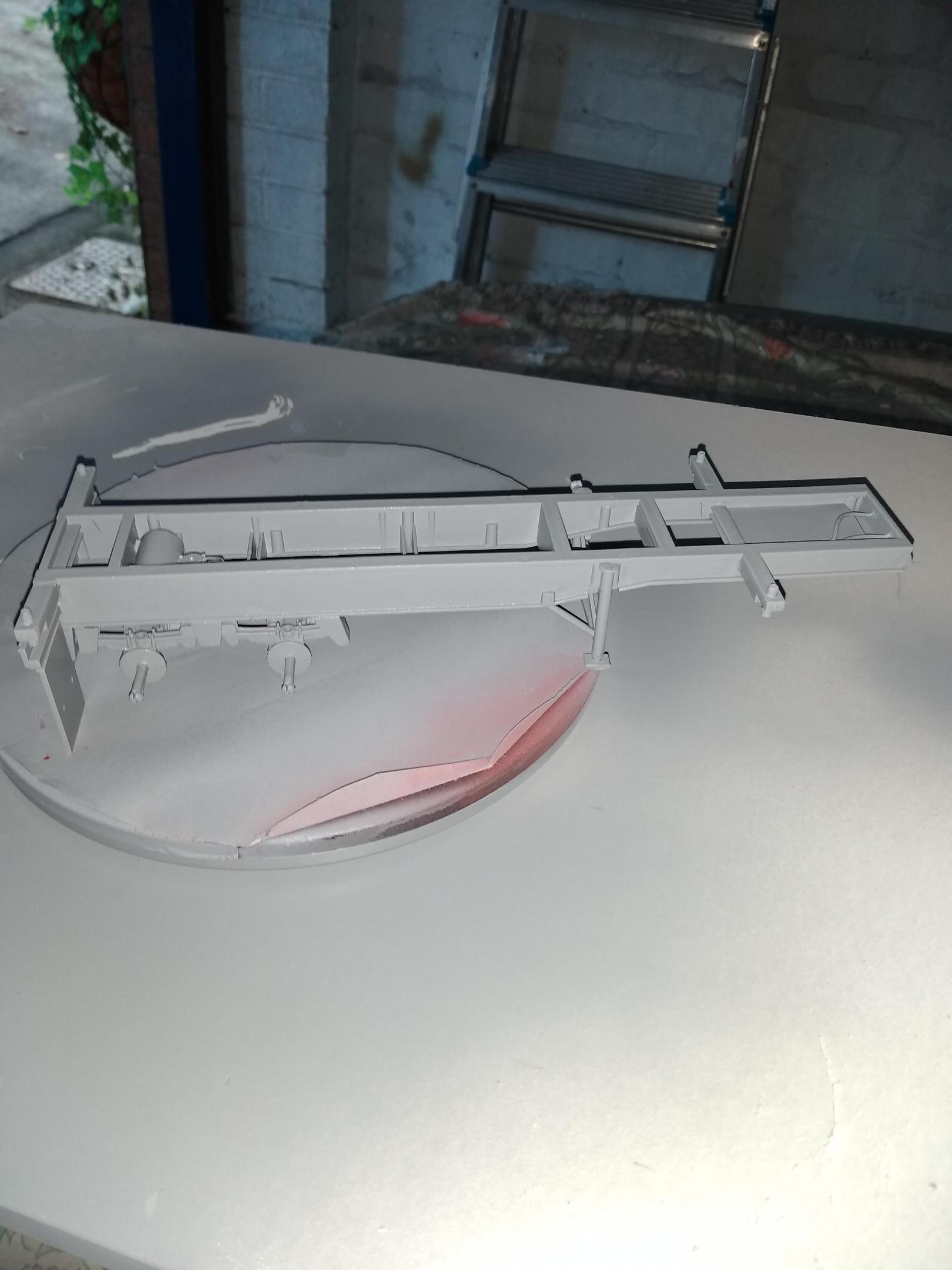

Rockford Posted October 21, 2020 Author Share Posted October 21, 2020 Thanks for the nice comments everyone. I managed to get paint on it yesterday, I shot the primer and I couldn't believe that when I went to pick it up it was soaking wet with condensation! As the solvents evaporated the surface temperature drops and the moisture in the air condensed onto it. I thought it was warm and fairly dry, but obviously not. I dried it off and later got the colour on. It's not the best finish but as I said earlier in the thread these units never got the best of finishes, as long as they were all one colour they were doing well. I'm leaning toward white rims for the wheels, leaving the hubs and spokes blue, but I wonder what just white on the very edge of the rim would look like. I think it's obvious that I should try the minimum first. Painted the box in red oxide primer. Looking at making some ACL decals for it. Quote Link to comment Share on other sites More sharing options...

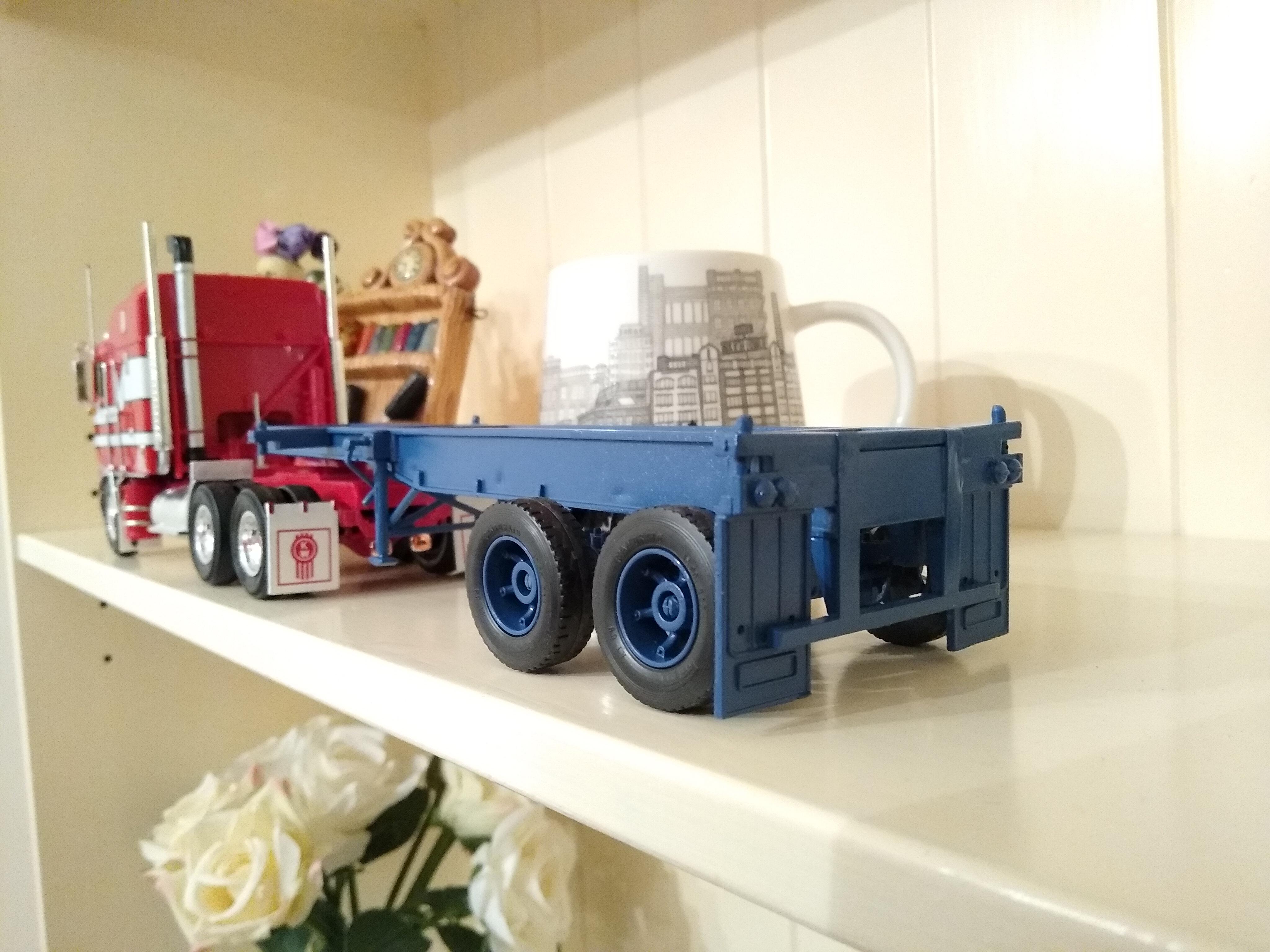

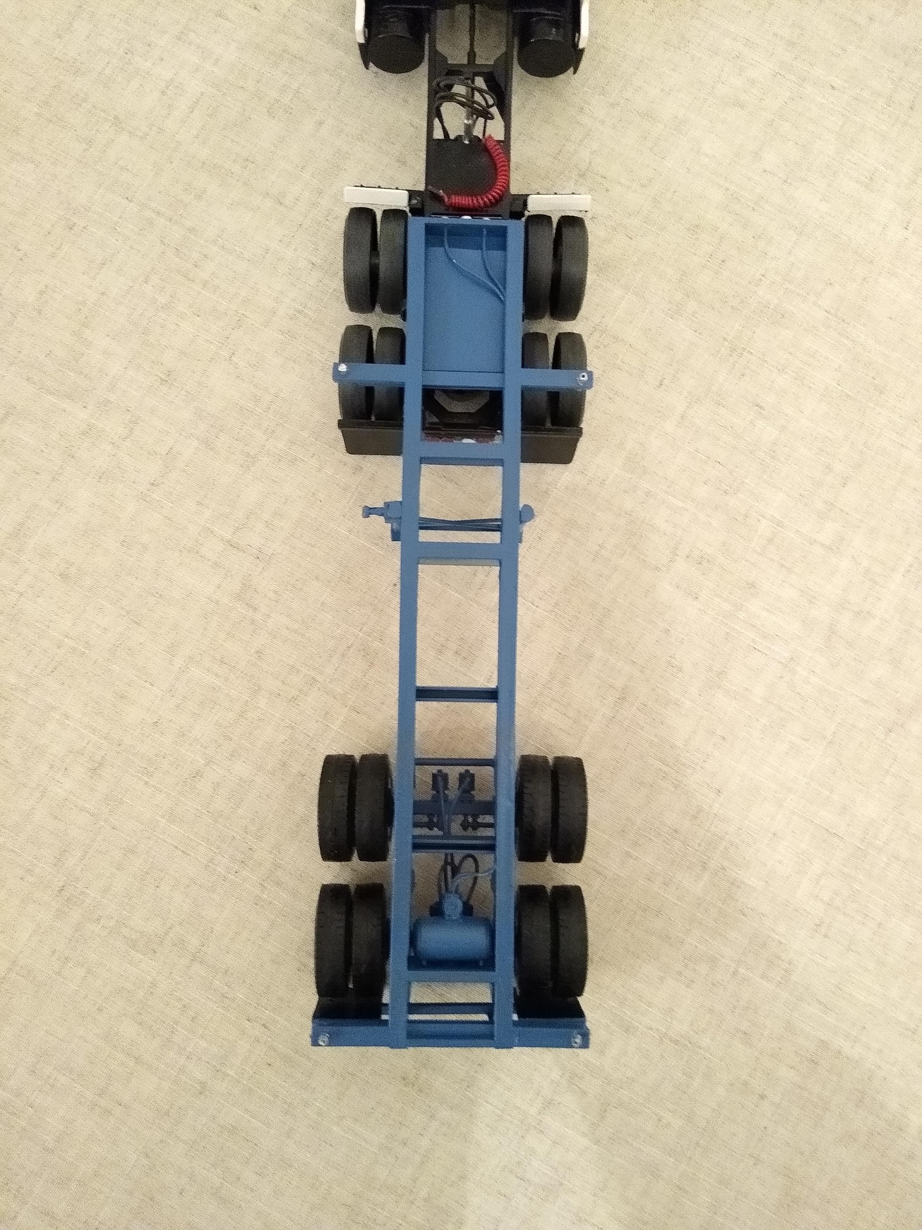

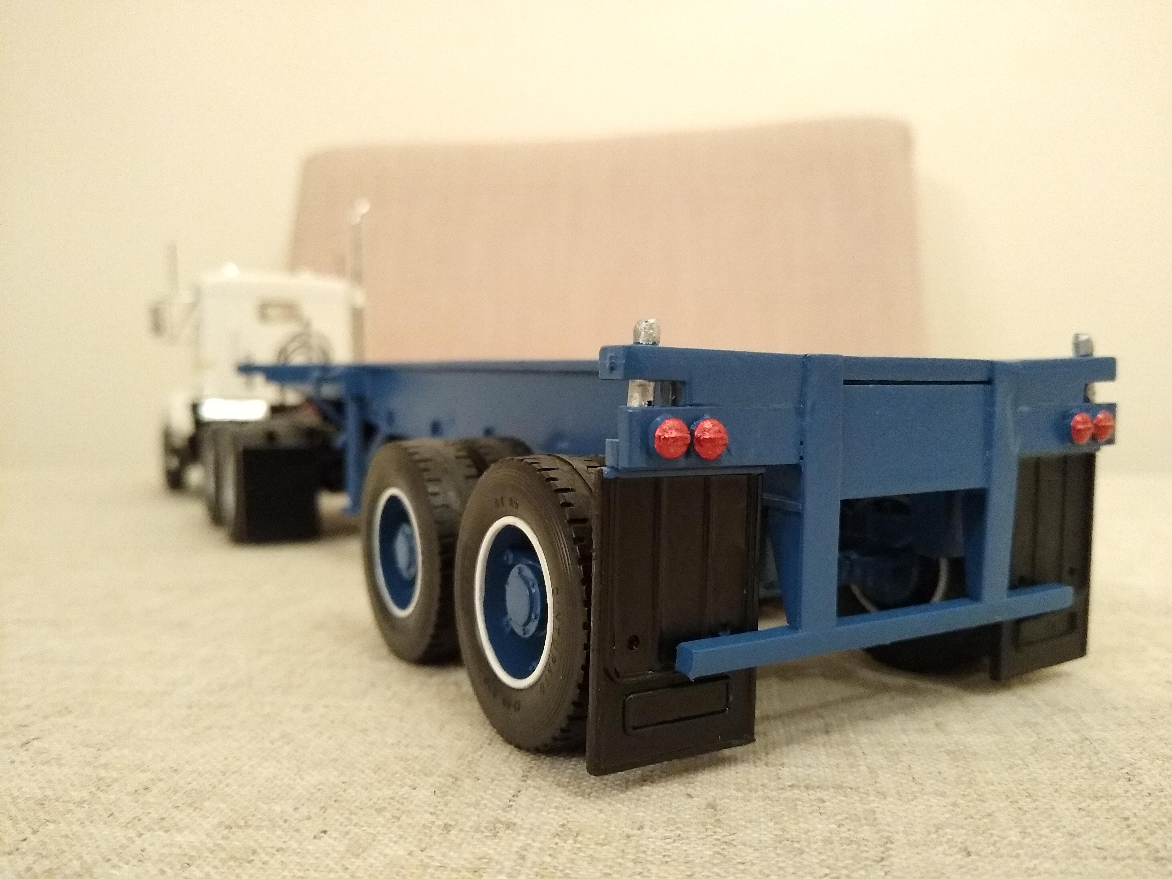

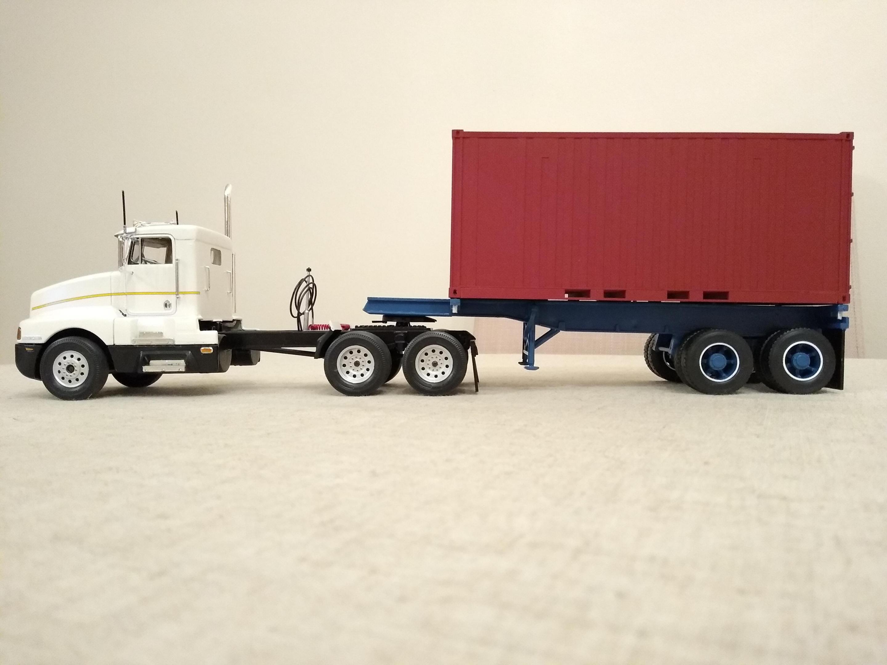

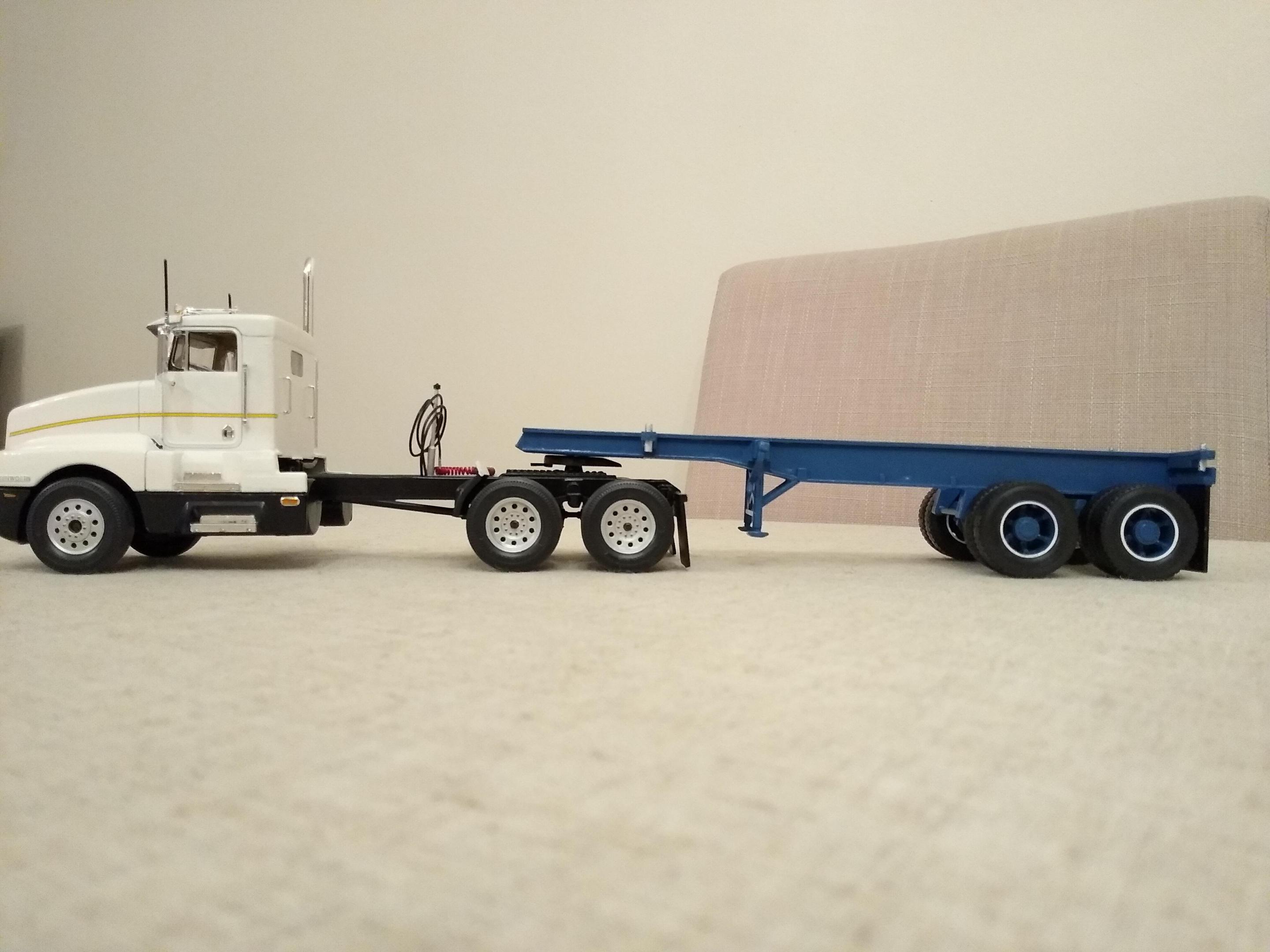

Rockford Posted October 24, 2020 Author Share Posted October 24, 2020 Did some work on the trailer today. Built the wheels up. Decided to just add the white line on the edge of the wheel rims. Painted the mudflaps too. Need to accommodate the rake in the chassis from the fifth wheel. Do I lower the front axle or raise the back axle? I'll have a think. I'm aware of the irony that the trailer has bigger hubs than the drive axles of the tractor!!! Such is SnapTite life. Quote Link to comment Share on other sites More sharing options...

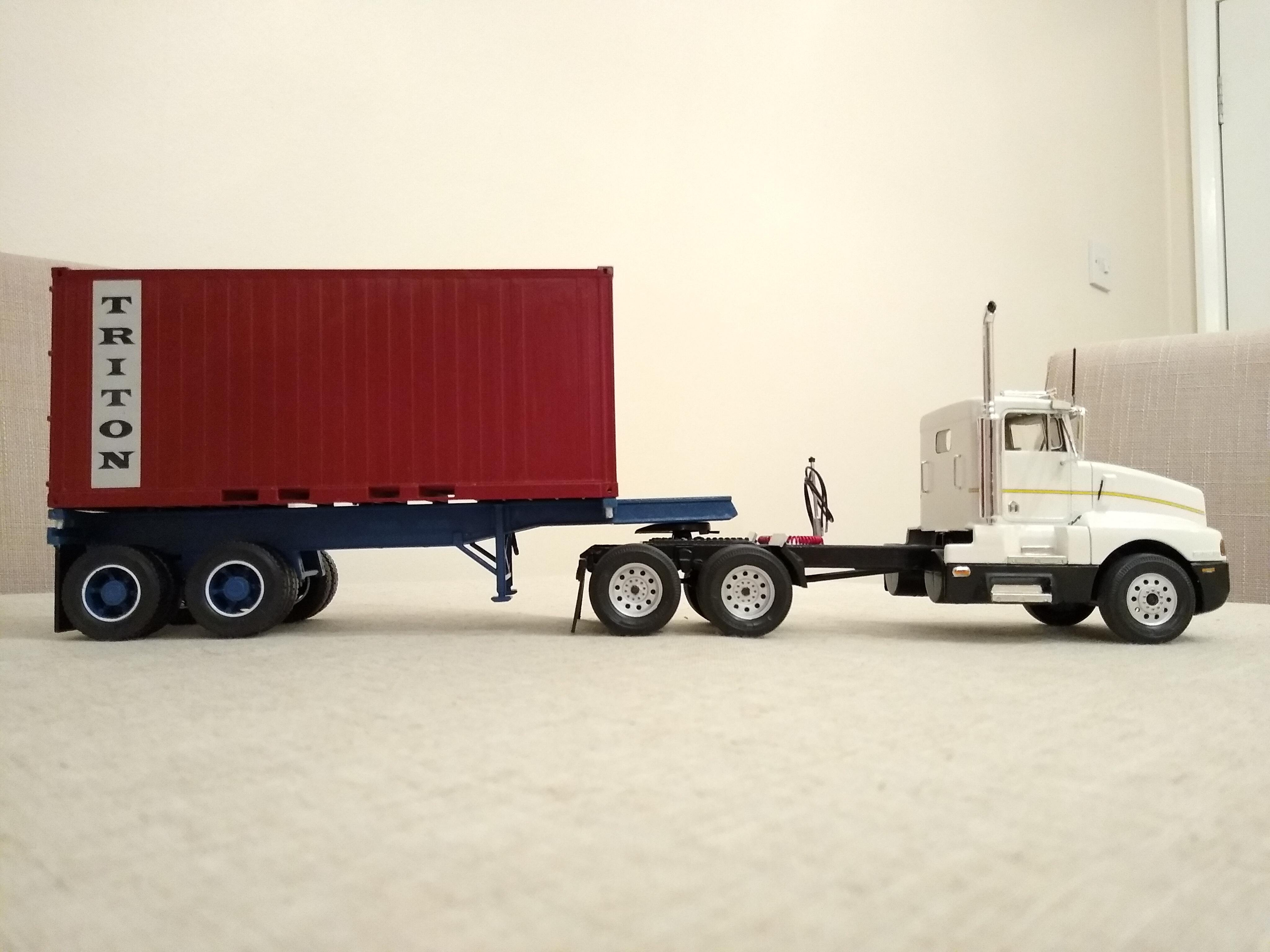

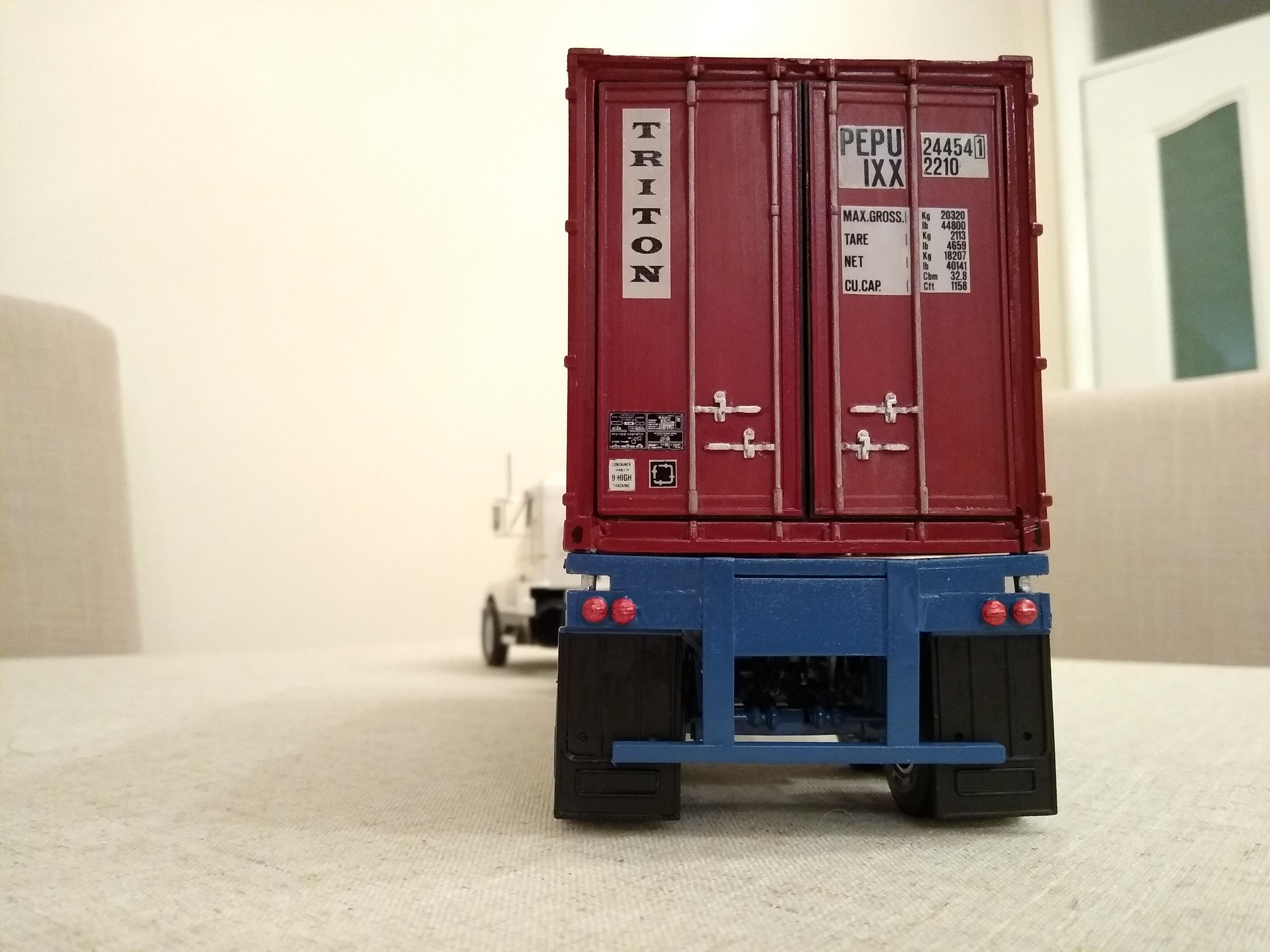

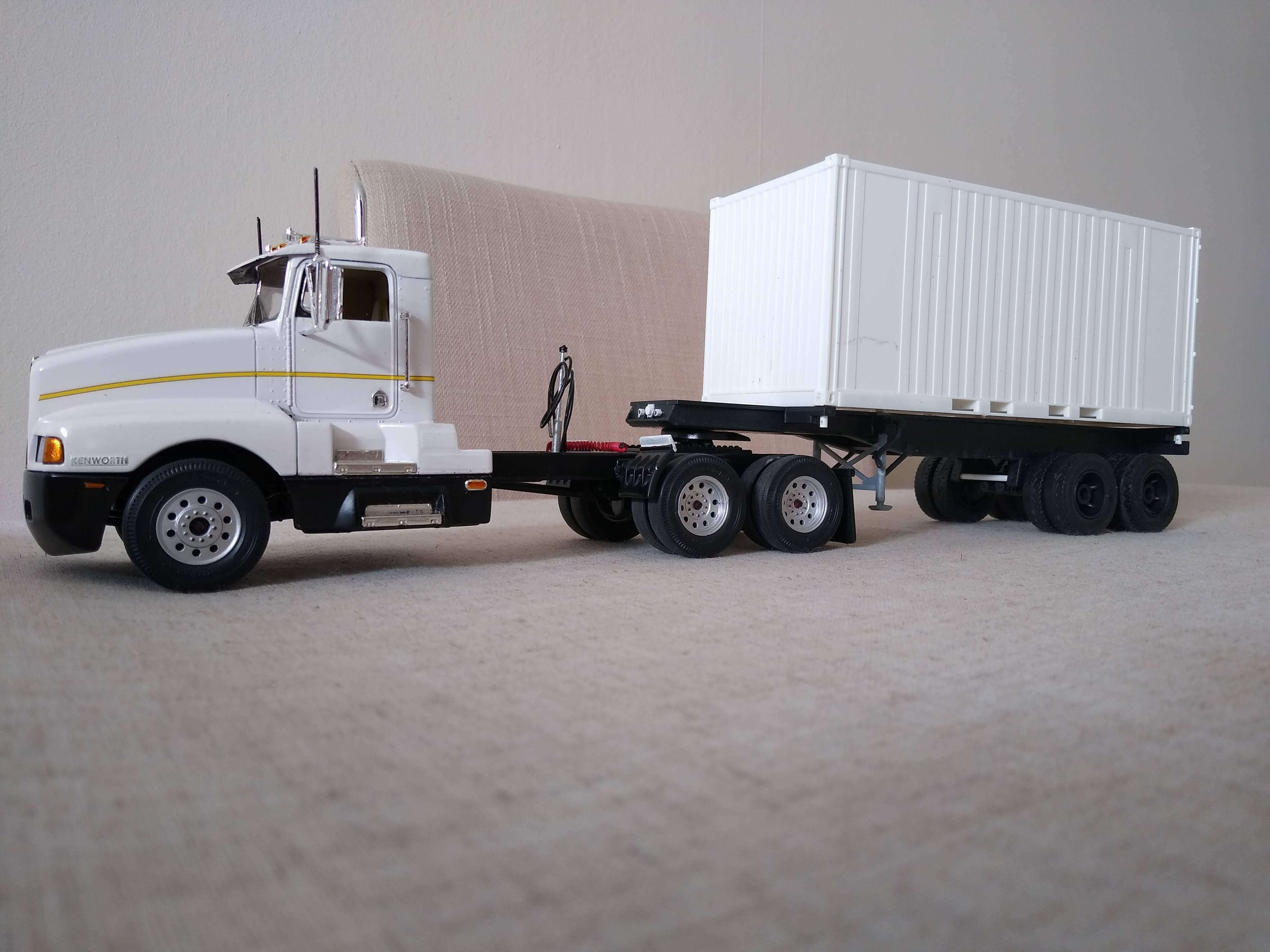

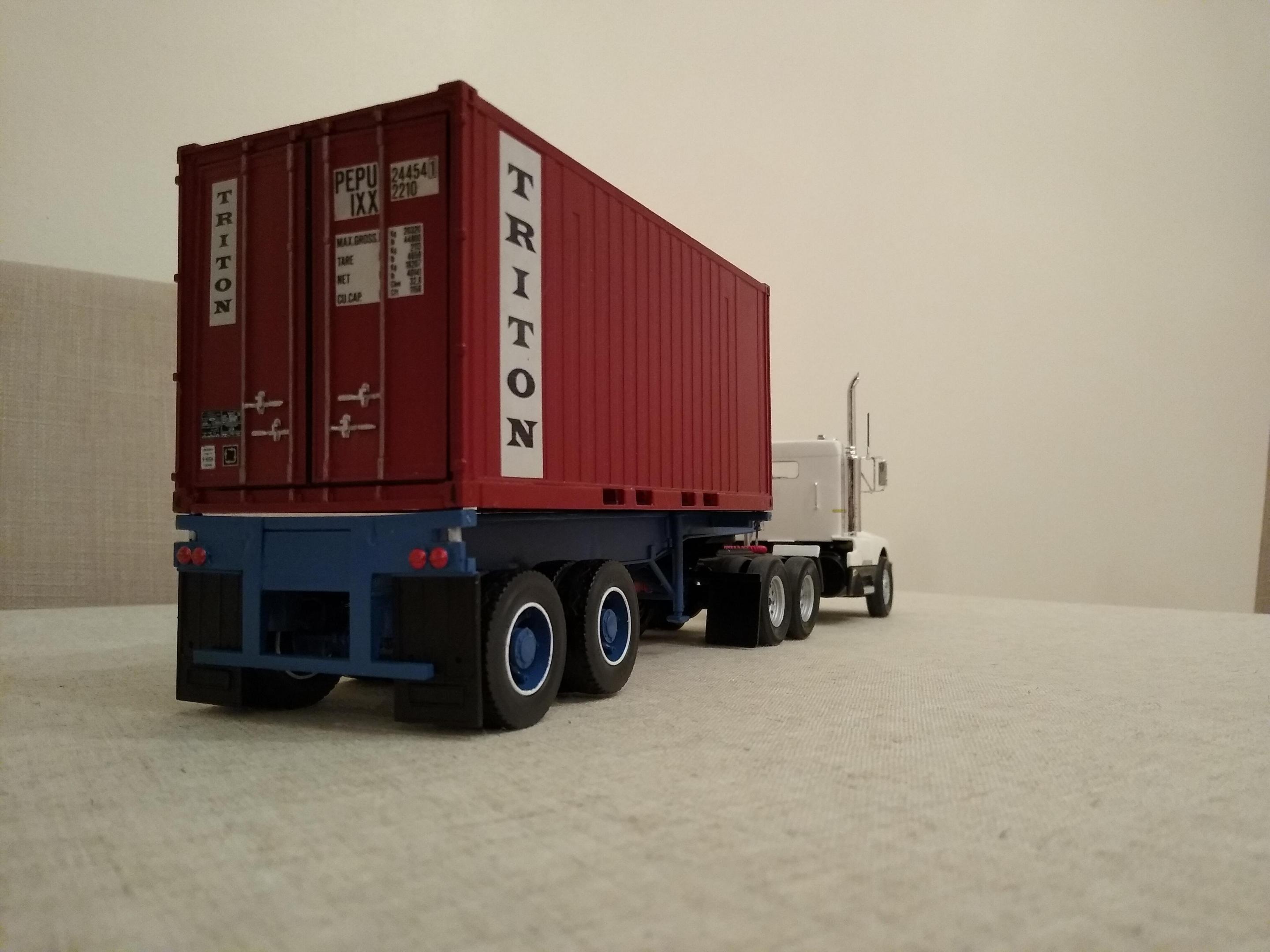

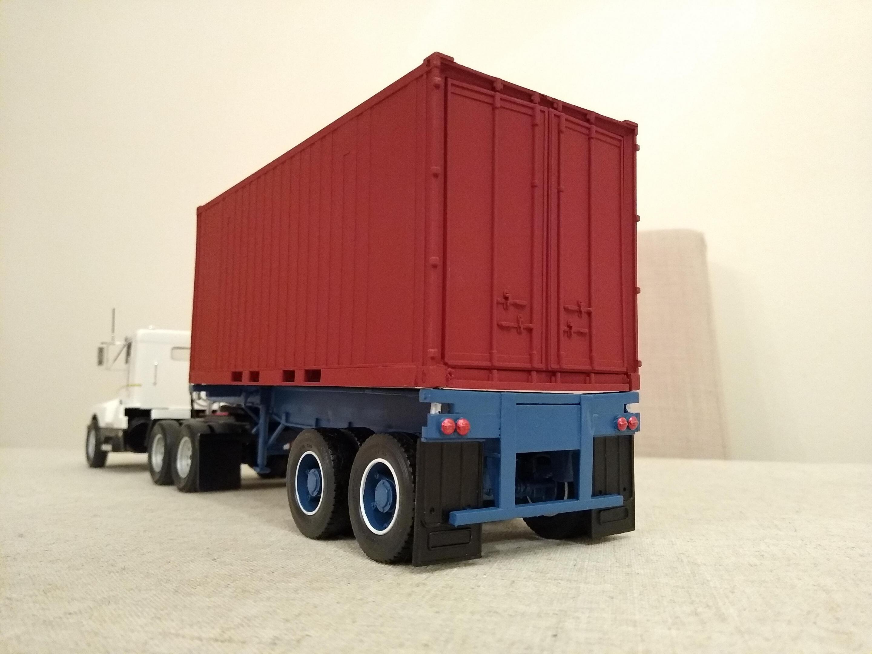

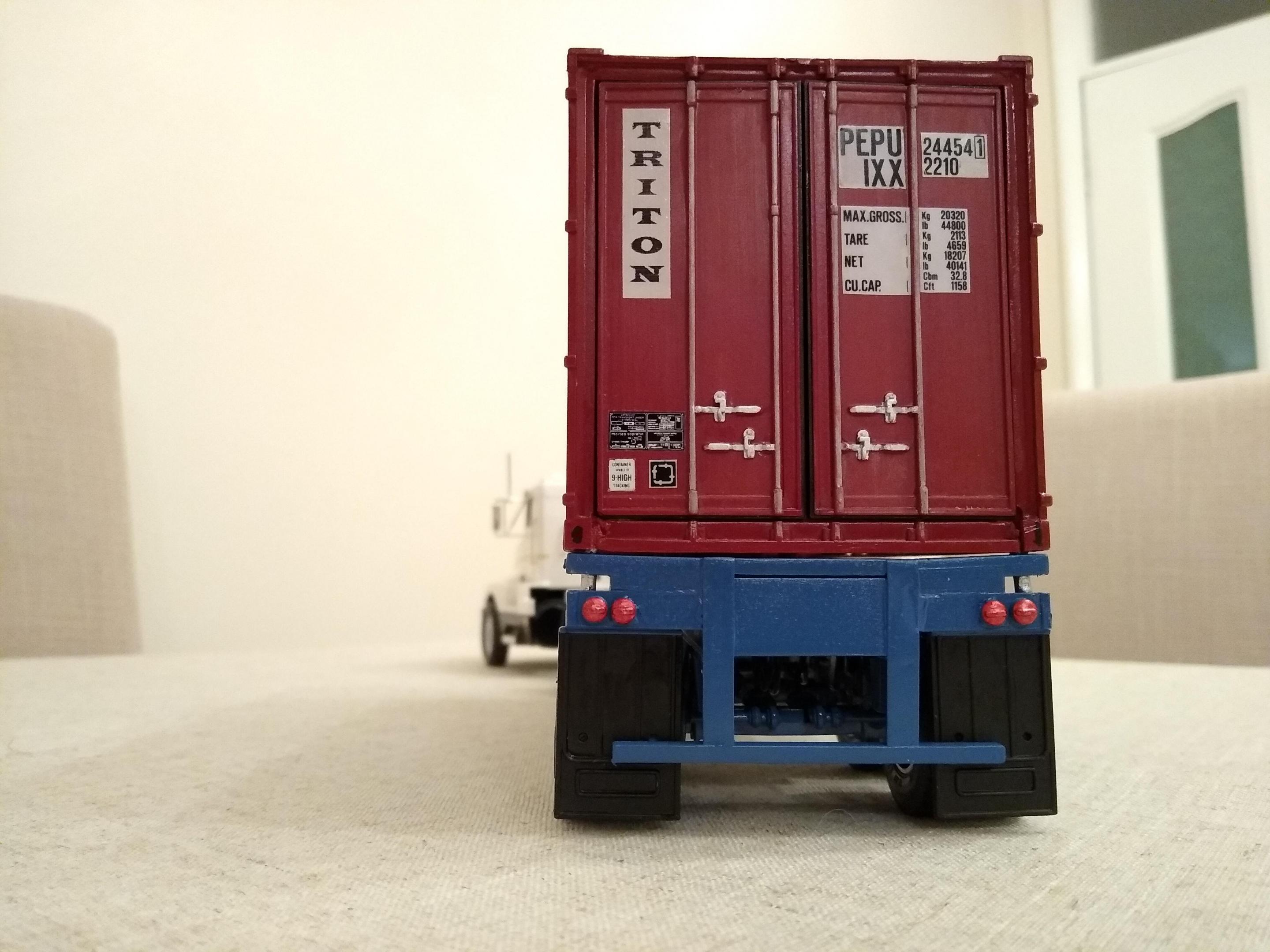

Rockford Posted November 17, 2020 Author Share Posted November 17, 2020 (edited) This is pretty much finished now, just the twist lock handles to fit and a licence plate to find. I gave the container a coat of semi-gloss clear to stop it marking easily and tone down the red oxide a little, then made up some decals for it using white decal paper. I made them for a company that does (or maybe did) actually exist, Triton, and after making and lacquering them, realised I'd been thinking about Tiphook, a British company that grew very big very quickly and promptly disappeared. Never mind, Triton it is! The details for rear doors are on one sheet of self adhesive vinyl so I cut each one out, stuck it to my white decal paper and then applied as a decal. This allowed me to move them into the right position using setting solution, stickers are a one shot gamble. I found a great way to keep the trailer out of harm's way when working on the box too. Hung from a screw! Overall I'm very happy with the result, brings back memories of all the 20ft trailers I used to see in and out of Liverpool docks, before 40 foot "boxes" became the norm. Edited November 17, 2020 by Rockford Quote Link to comment Share on other sites More sharing options...
