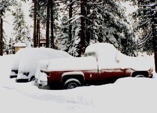

On 11/21/2020 at 11:31 AM, Rodent said:
Here is my 77 GMC K1500 in 1988 or 1989. Single tone dark red metallic.
Looks like a two-tone to me
"Red and Snow White"
Share this post
Link to post
Yeah, we were expecting snow that weekend when I visited my friend in the Sierras for a long Thanksgiving weekend. Was in 4wd and the hubs were locked when I parked it. Four days later and 40+ inches of snow, I had to dig my way to the driver's door, get in and drive out of the bank to finish clearing it off enough to hit the highway. Yes, I know that people in North Dakota are laughing at this tiny bit of snow, but I had great fun riding my snowmobile that weekend.
