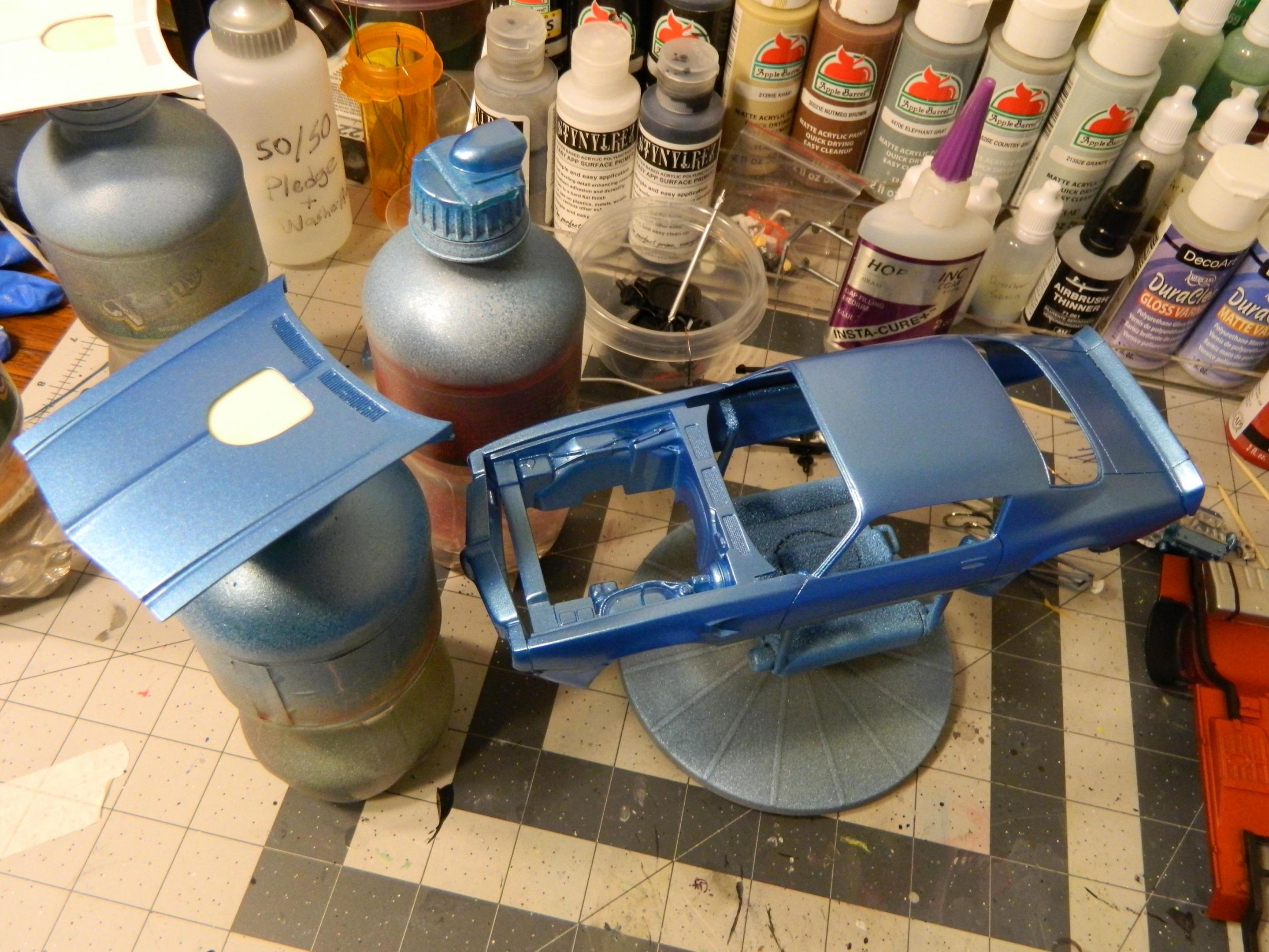

Dragonhawk1066 Posted February 17, 2021 Author Share Posted February 17, 2021 13 hours ago, FLHCAHZ said: The Trans Ams look great! I’ve been having good results thinning with was and clearing with future. I found an old bottle of the original future under my sink. I just posted up a ‘66 mustang body I just finished in wip. I bought some metallic white craft paint that I had in mind for an early Trans Am 11 hours ago, Superbird McMonte said: They look really cool! That’s a project I’d like to take on myself. I’ll be watching intently! Thanks guys! 13 hours ago, TransAmMike said: They look good Craig, I'm thinking you are better off with the WS fluid. I don't know how long you're waiting to clear but I had an experience with The 66 GT350 MUstang I'm finishing up. I got impatient and cleared it with the Rusto Acrylic Lacquer about 4 hours after spraying the craft paint. I used the hair dryer several times duing the wait then went ahead and sprayed it. I felt like it was my best paint job yet, just minute orange peel, looked great. Well, after a couple of days with the clear on it I can now see a few minor scratches from the light sanding then steel wooling prior to applying the paint and ghosting of the emblems I had to remove that weren't visable after priming and painting. I guess the paint shrunk. Anyway, take it for what it's worth. I guess my impatience bit me in the azz. I'm beginning to wonder if I'll ever get this body painting process down. Thanks Mike, it's really just all about getting the right consistency. I knew better on the first try that it was a little thick. I over-compensated on the second one and it was too thin. The third started too thin, then I added a little more paint and got it just right. I don't know if they need it, but I'm giving them a couple of days before a coat or two of clear so I can foil and decal them. As you just learned, I don't think the lacquer and enamel clearing after paint window applies to craft paint, especially depending on the clear. I am going to use this Gloss Varnish instead of Pledge for these, which I think is very similar to Vallejo and even Createx gloss varnishes/clears. I've used it before with great results and it can even be wet sanded after a couple of days. Patience is my worst trait as well, but that Mustang looks great and I've seen your other work, so I think you have the body painting thing down more than you realize. Quote Link to comment Share on other sites More sharing options...

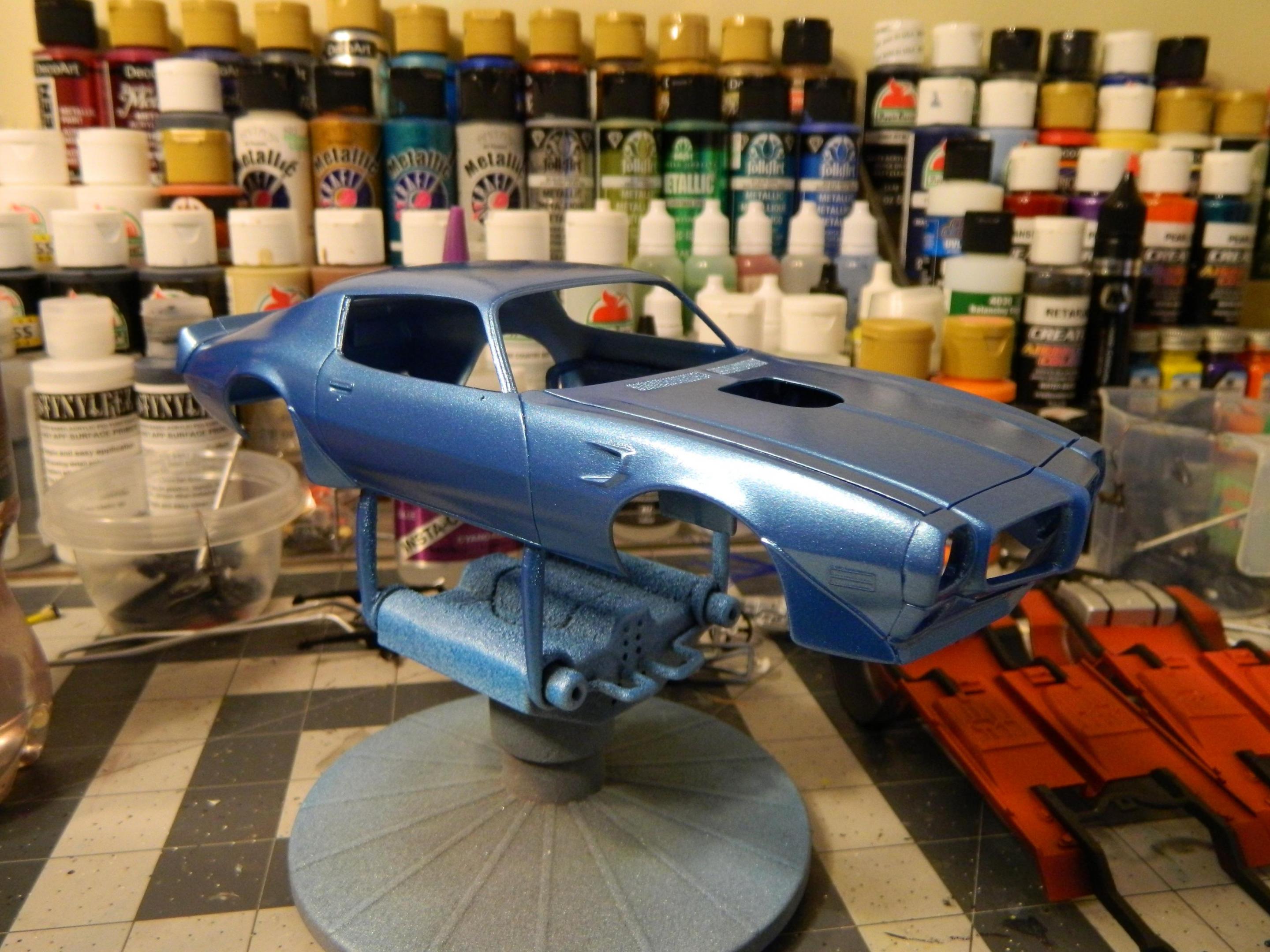

TransAmMike Posted February 17, 2021 Share Posted February 17, 2021 2 hours ago, Dragonhawk1066 said: Thanks Mike, it's really just all about getting the right consistency. I knew better on the first try that it was a little thick. I over-compensated on the second one and it was too thin. The third started too thin, then I added a little more paint and got it just right. I don't know if they need it, but I'm giving them a couple of days before a coat or two of clear so I can foil and decal them. As you just learned, I don't think the lacquer and enamel clearing after paint window applies to craft paint, especially depending on the clear. I am going to use this Gloss Varnish instead of Pledge for these, which I think is very similar to Vallejo and even Createx gloss varnishes/clears. I've used it before with great results and it can even be wet sanded after a couple of days. Patience is my worst trait as well, but that Mustang looks great and I've seen your other work, so I think you have the body painting thing down more than you realize. Appreciate the compliment Craig but I still have a long way to go with the painting process. I've gotten on this kick of being determined to get great results using craft paint. I just like the less messy easy cleanup with it. Quote Link to comment Share on other sites More sharing options...

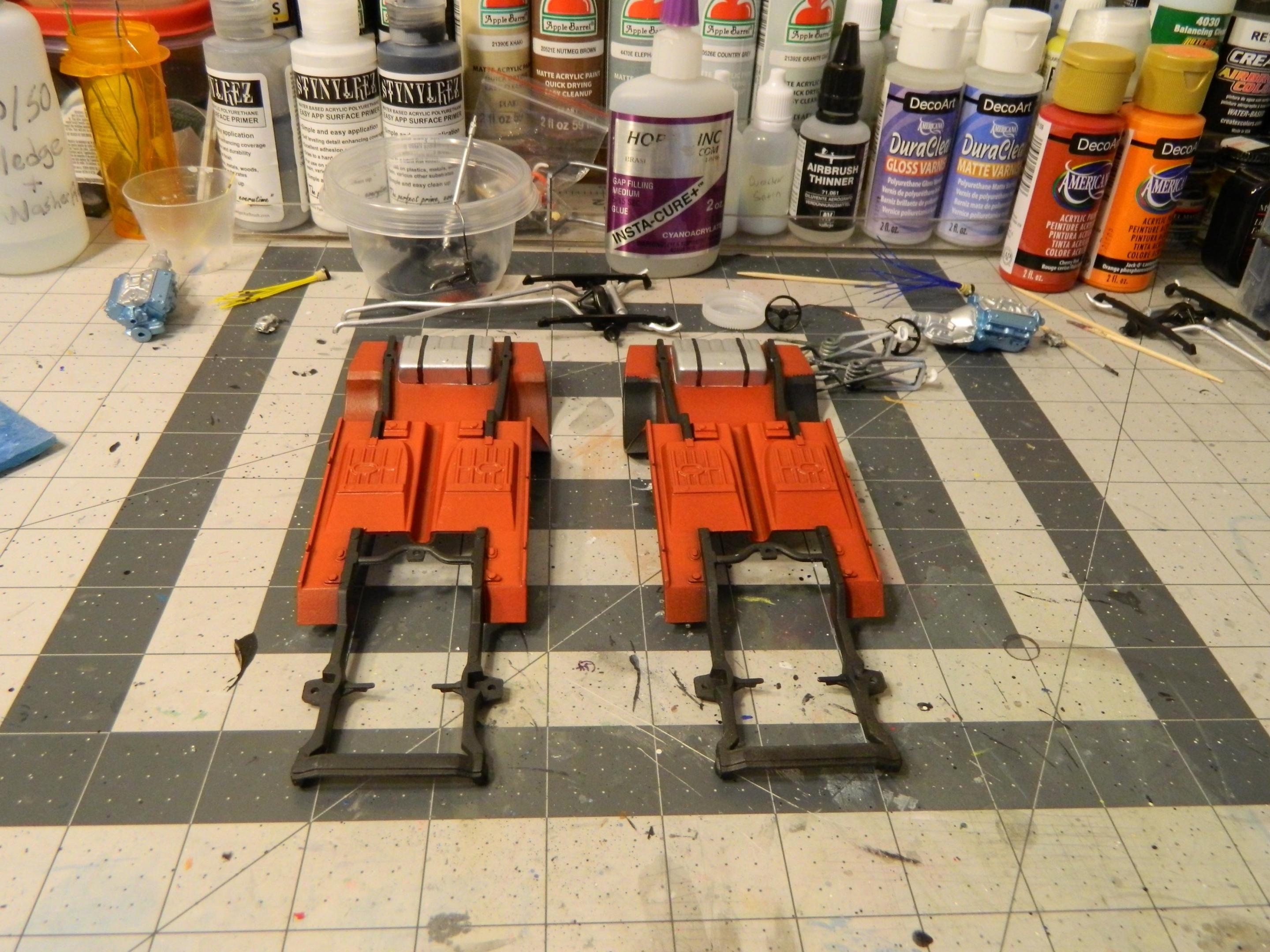

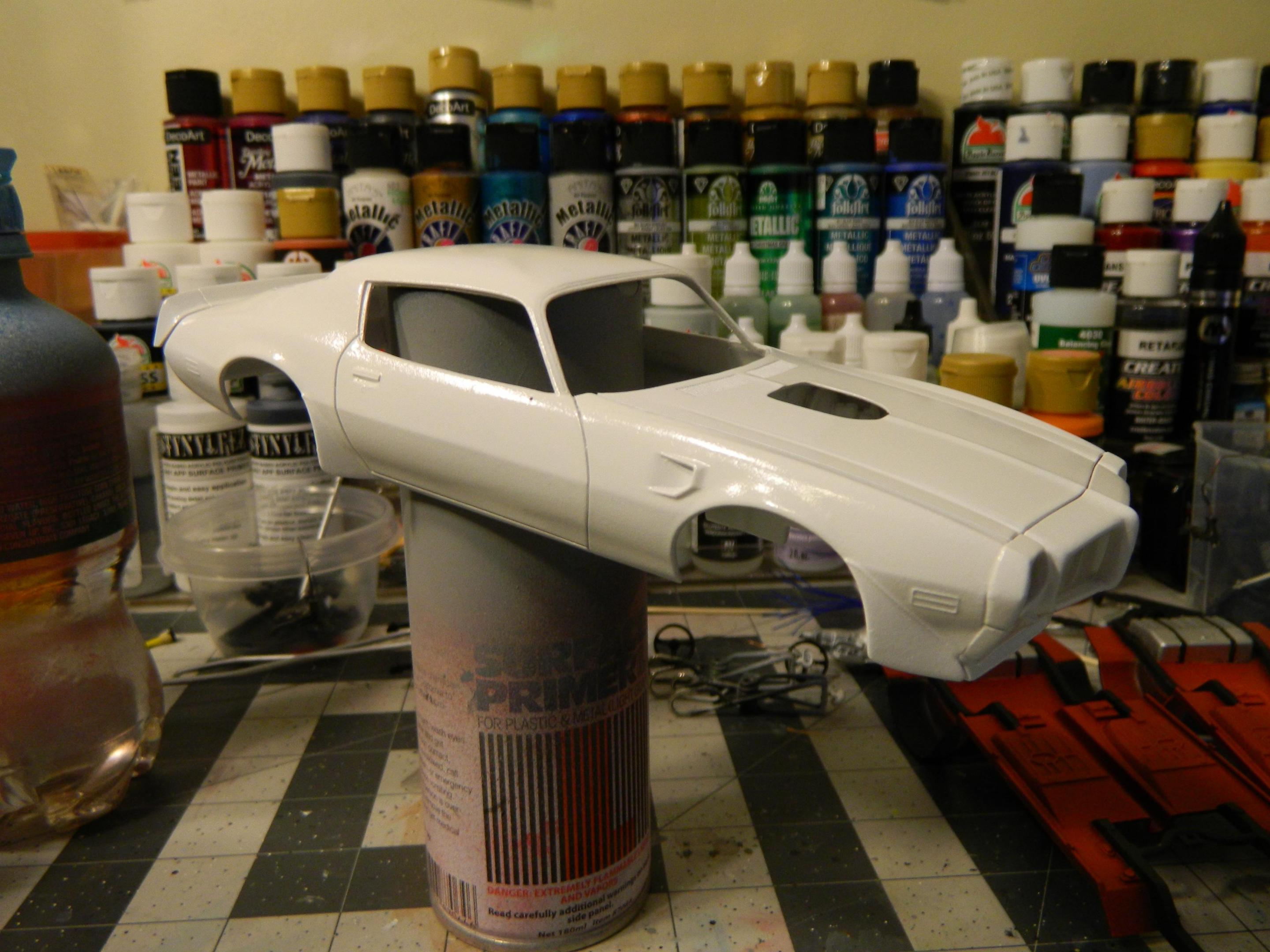

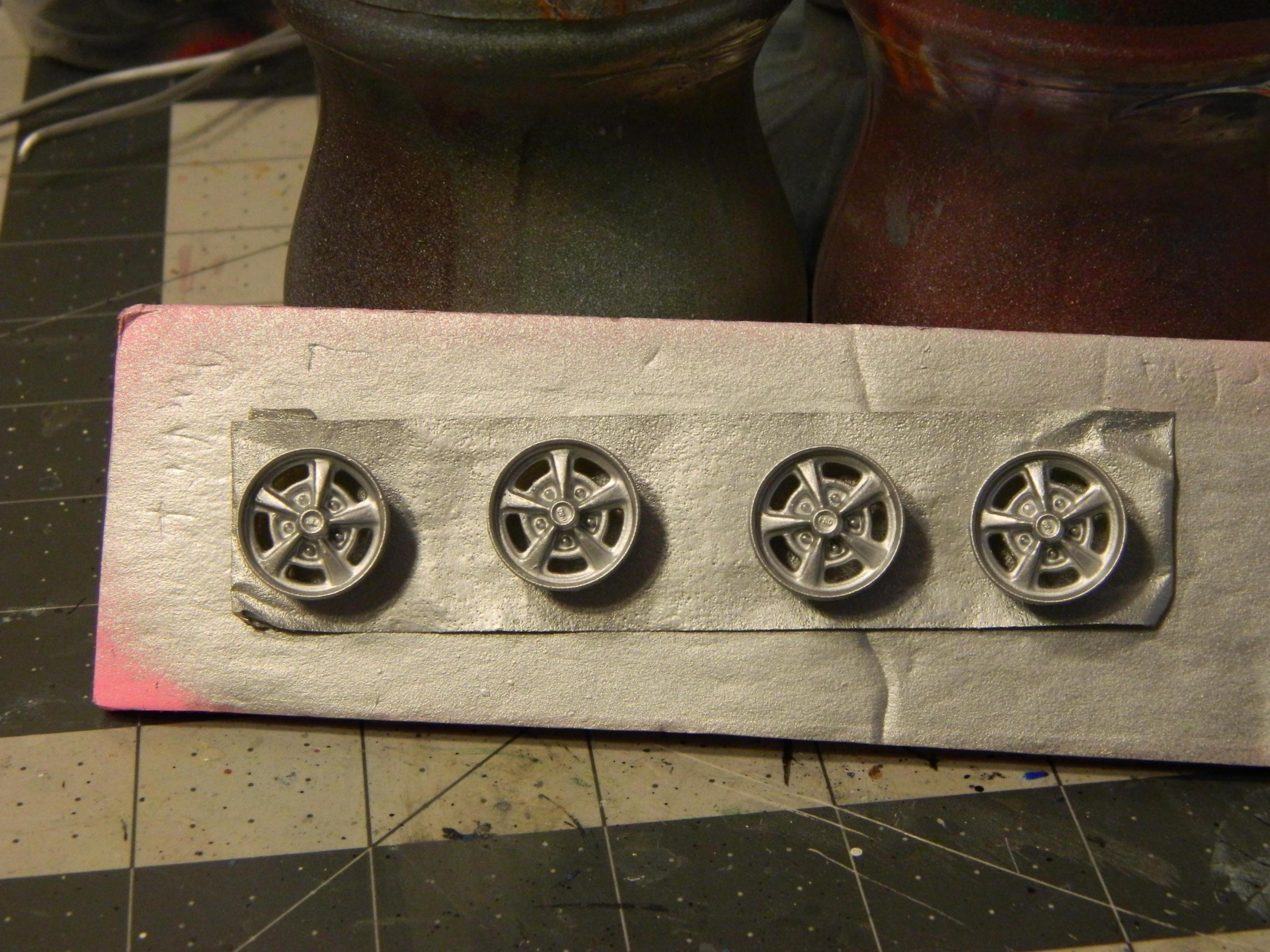

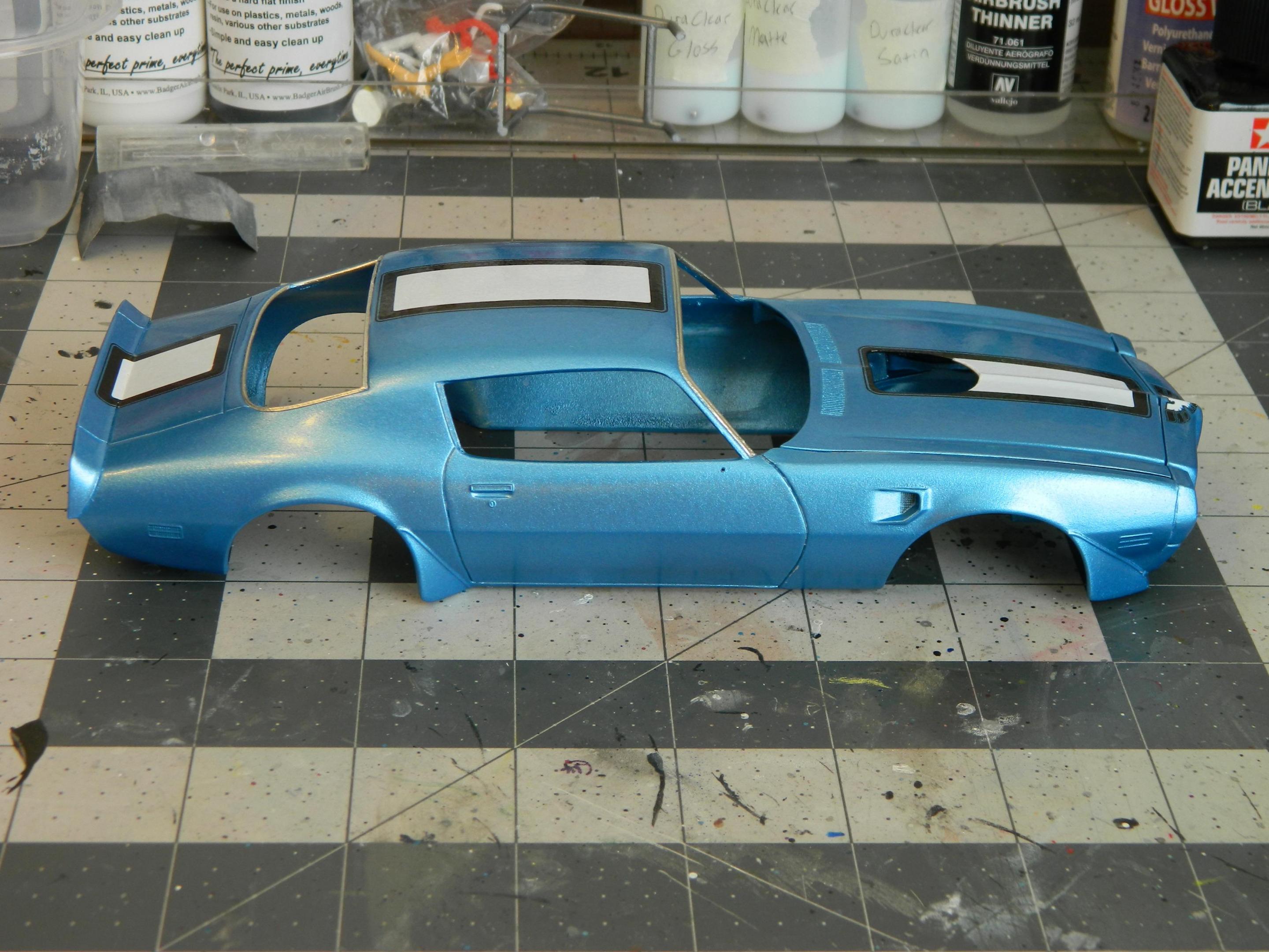

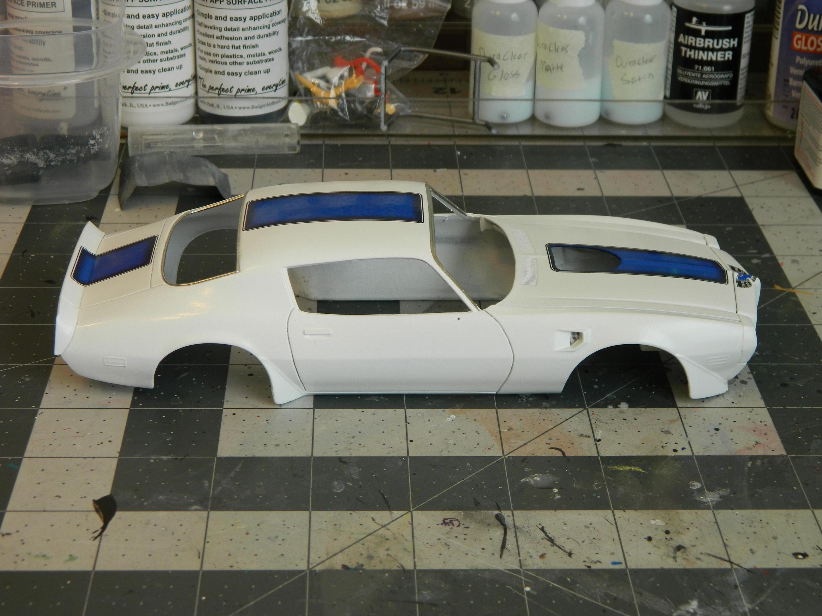

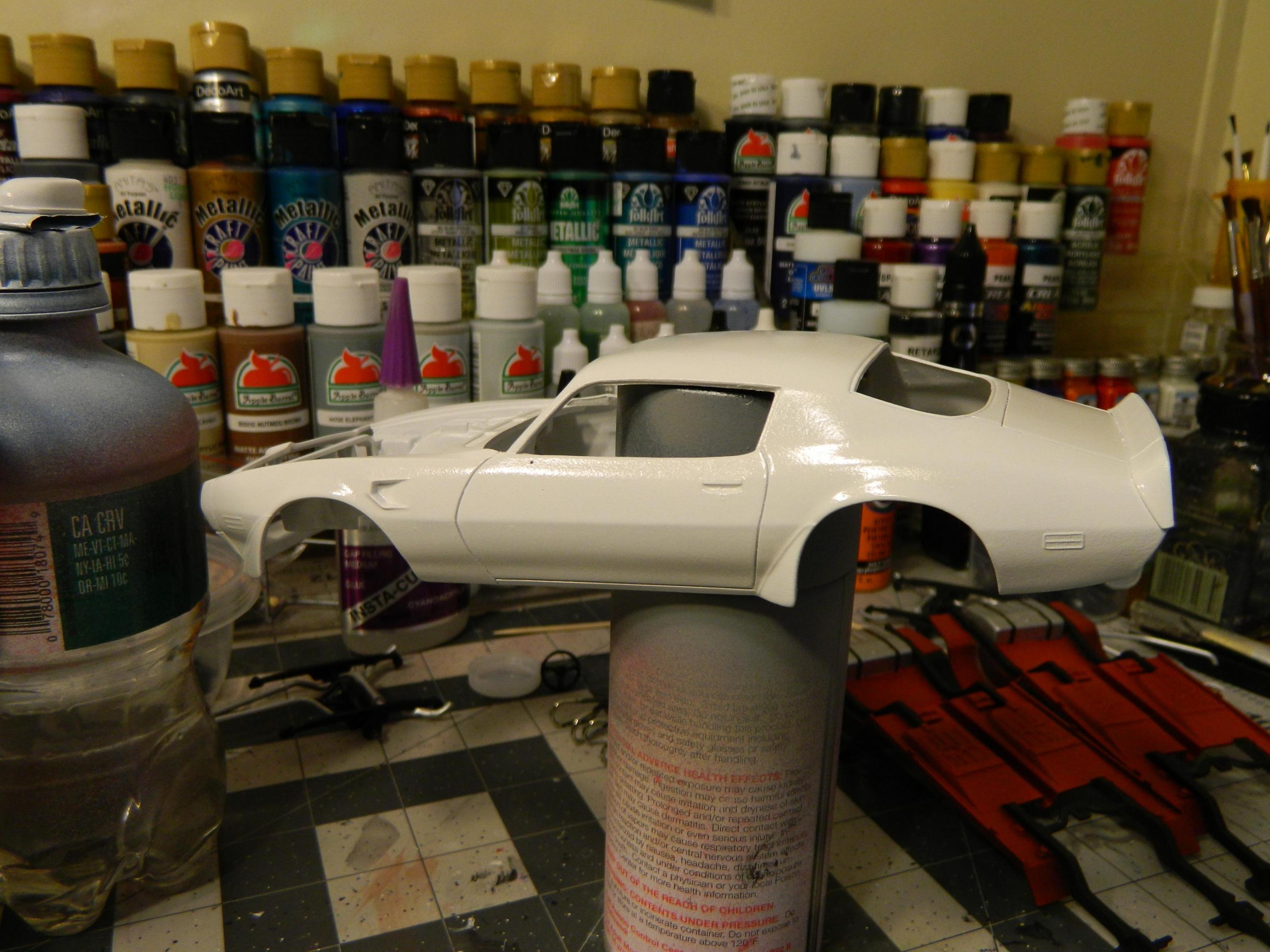

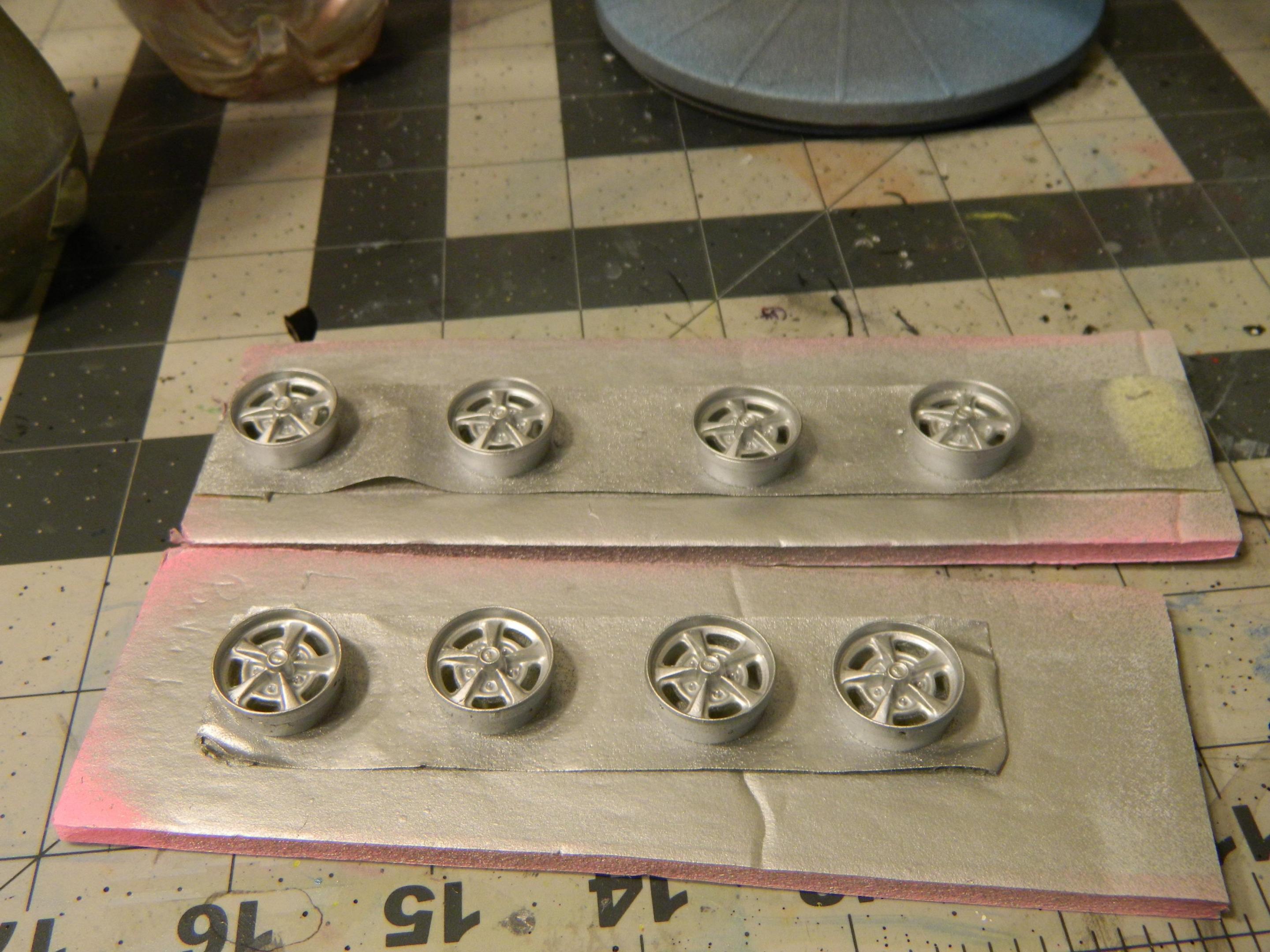

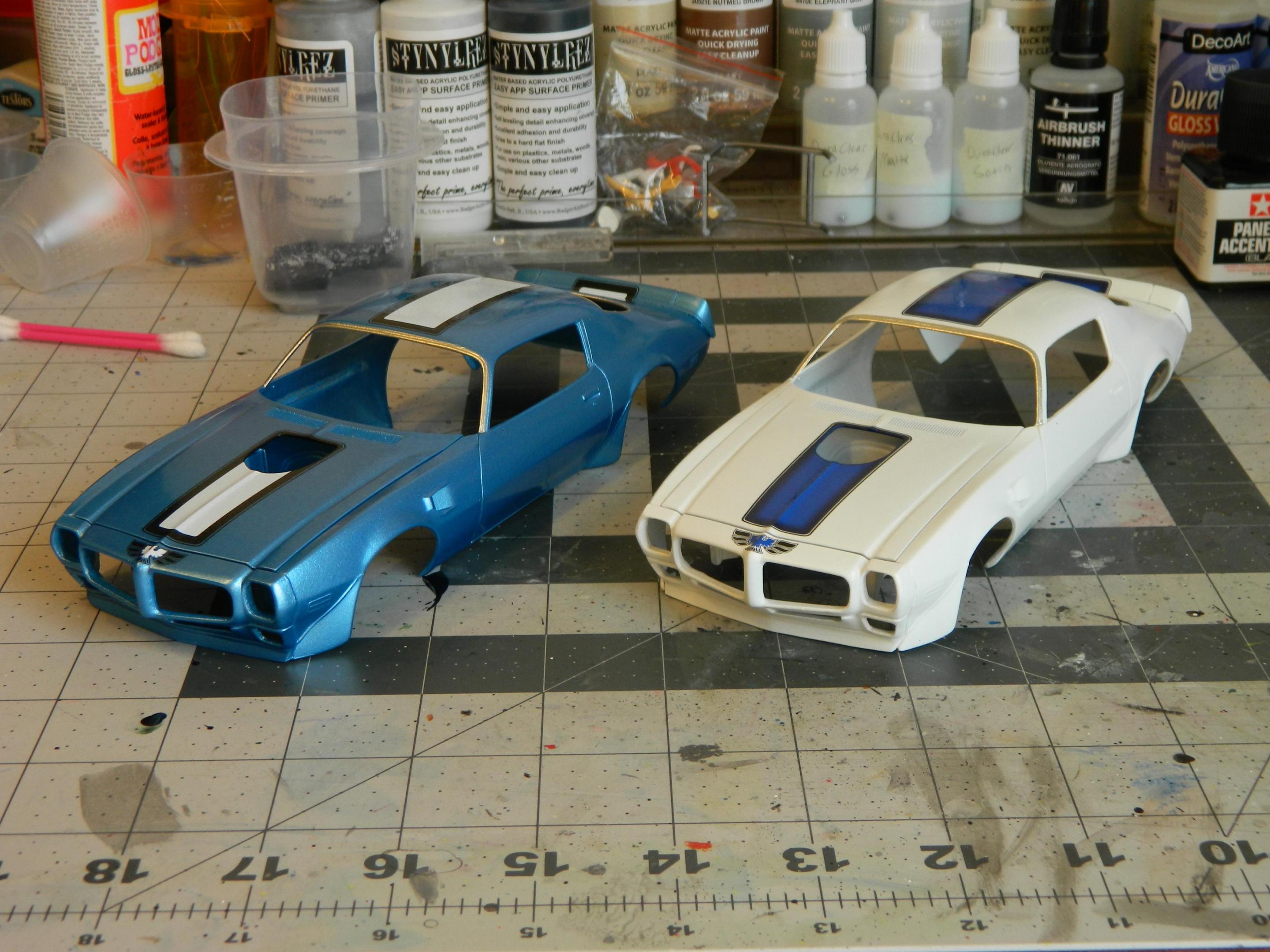

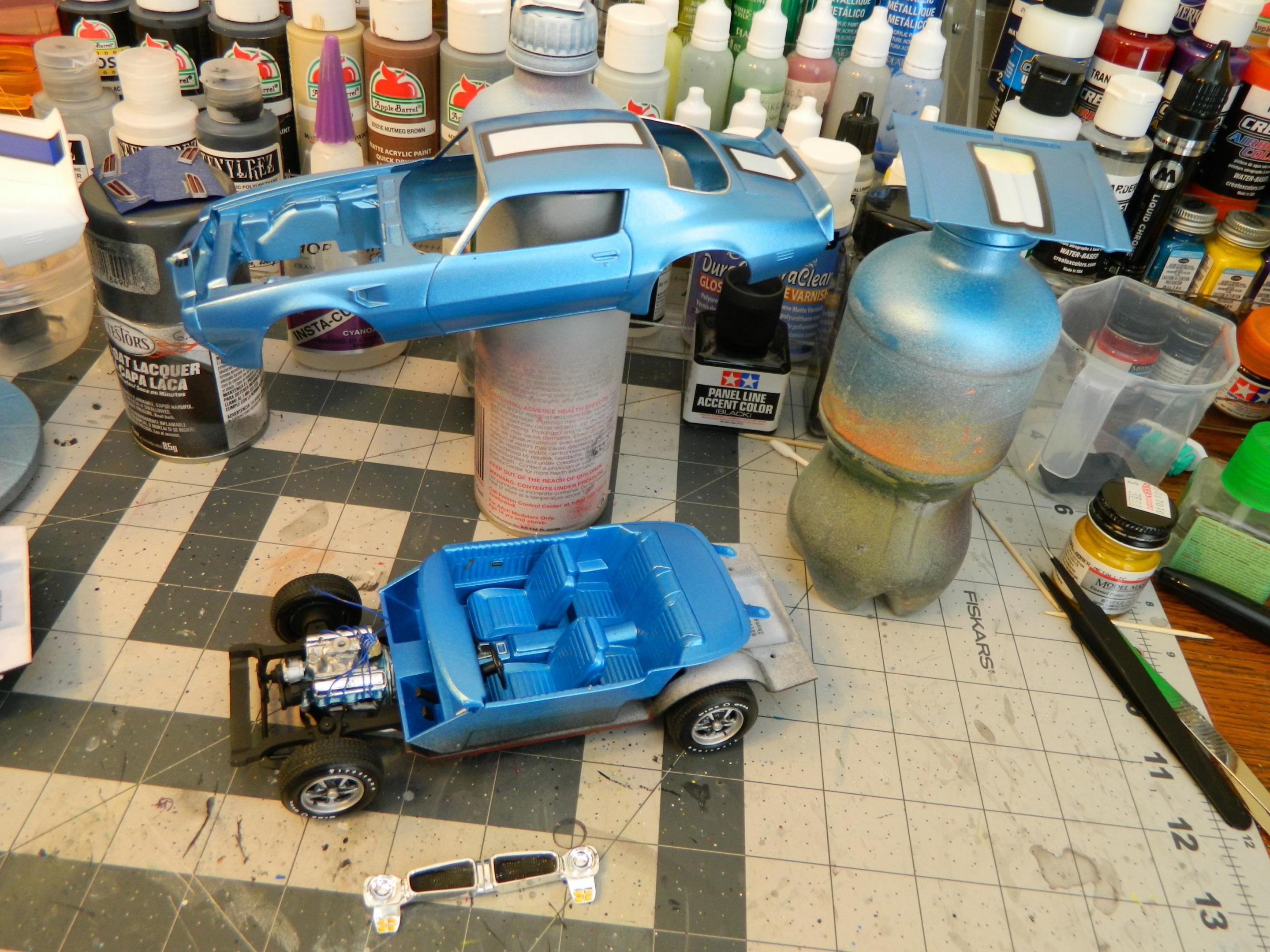

Dragonhawk1066 Posted February 20, 2021 Author Share Posted February 20, 2021 I got some clear on both bodies this morning. They're not super shiny, but it's only the initial coat before BMF and decals, and they weren't miles deep in clear back in '70 anyways. I got my decals in from Keith Marks, but I think I'm going to have to wait a couple of weeks to order another set because the size script I need has only one of each color on the sheet. I also got the chassis pans painted red after research showed that they were indeed red, at least on the 90% or so I saw on google, and I sprayed the wheels in Vallejo Aluminum. Hopefully tomorrow I can wire the engines and get some dash detailing done. Quote Link to comment Share on other sites More sharing options...

TransAmMike Posted February 20, 2021 Share Posted February 20, 2021 Come on Craig, you didn't use craft paint on the wheels?????😂 Looking good my friend. Quote Link to comment Share on other sites More sharing options...

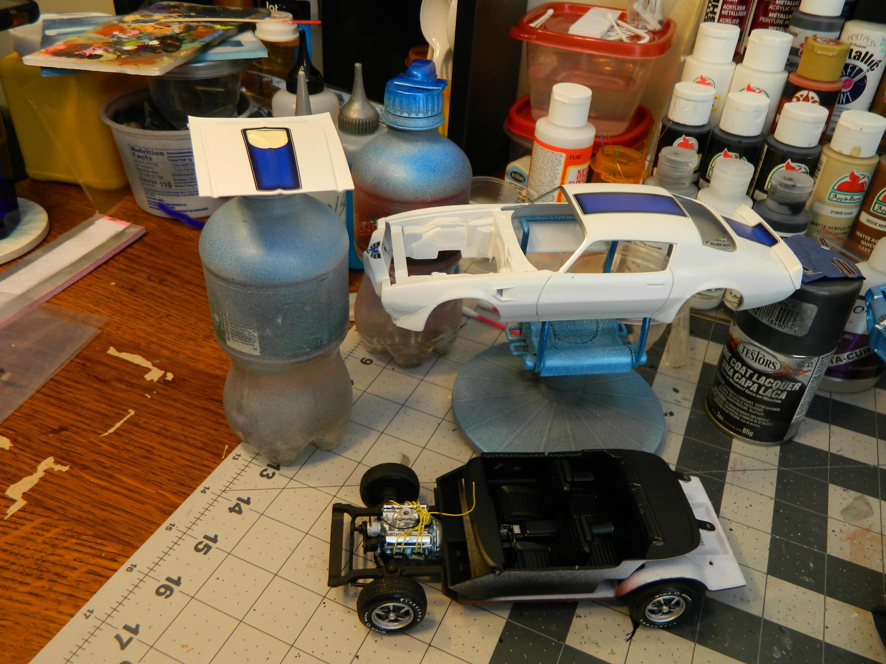

Dragonhawk1066 Posted February 22, 2021 Author Share Posted February 22, 2021 On 2/20/2021 at 11:42 AM, TransAmMike said: Come on Craig, you didn't use craft paint on the wheels?????😂 Looking good my friend. I know right?!?!? It was still water based though, LOL. The wheels are almost done, and the engines are wired and pretty much built. The interiors are detailed and ready for the dash decals, and the chassis and suspension pieces are painted and ready for assembly. The bodies are just waiting for me to be in the mood for BMF and then decals before final clear coat. It's been slow going, al least it seems like it, but everything should go together pretty quickly. Quote Link to comment Share on other sites More sharing options...

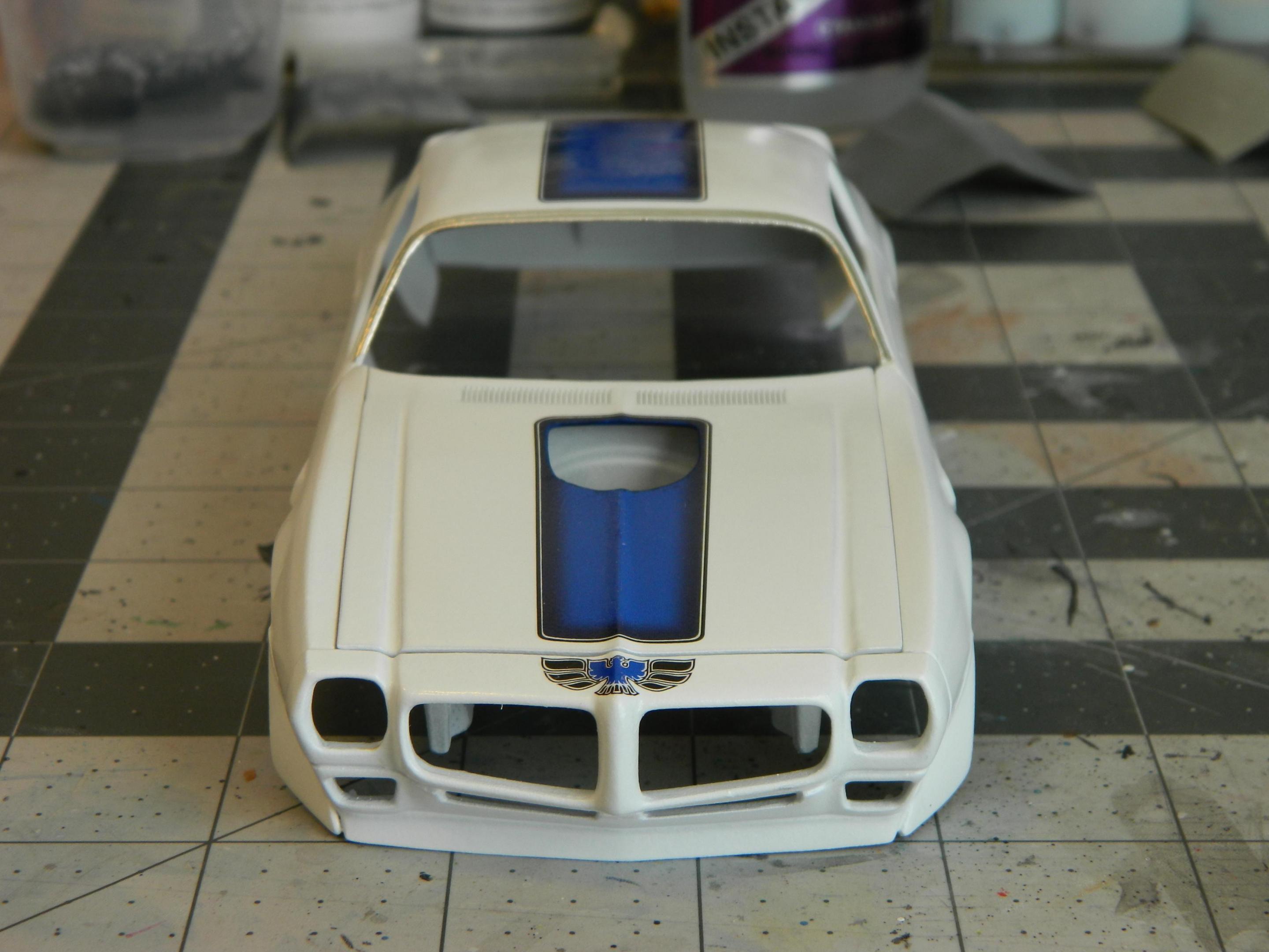

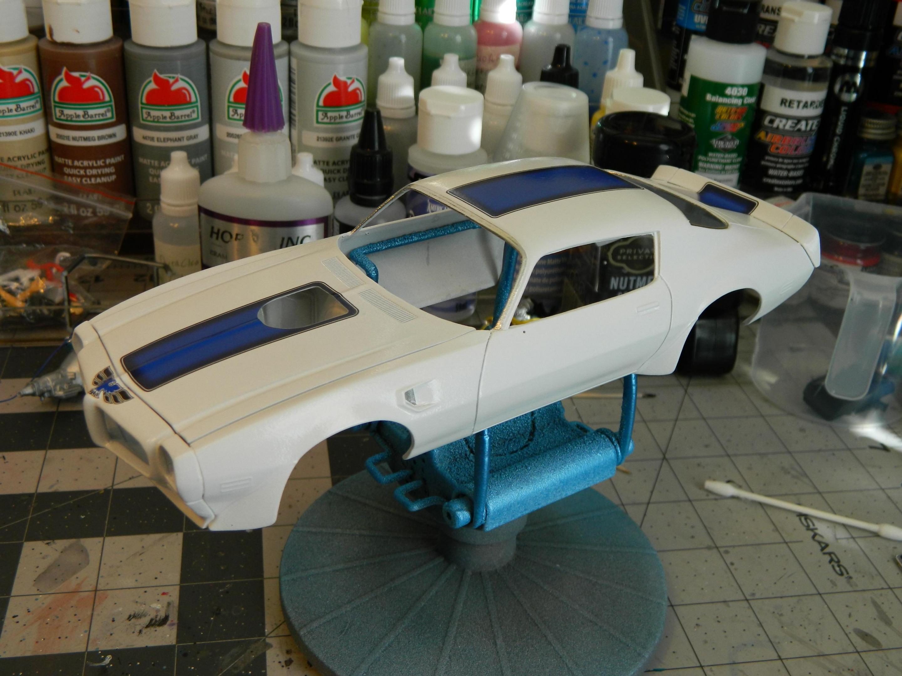

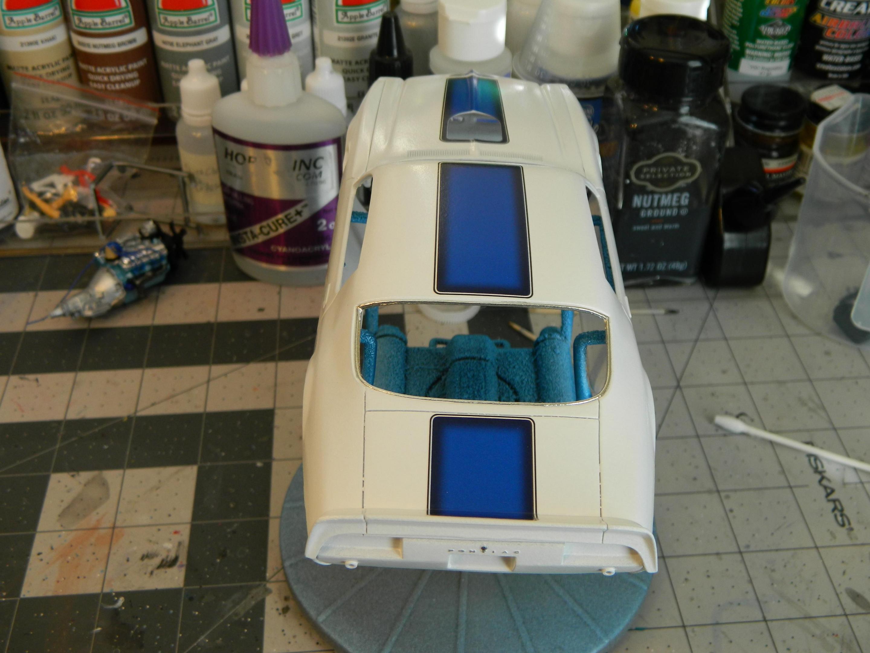

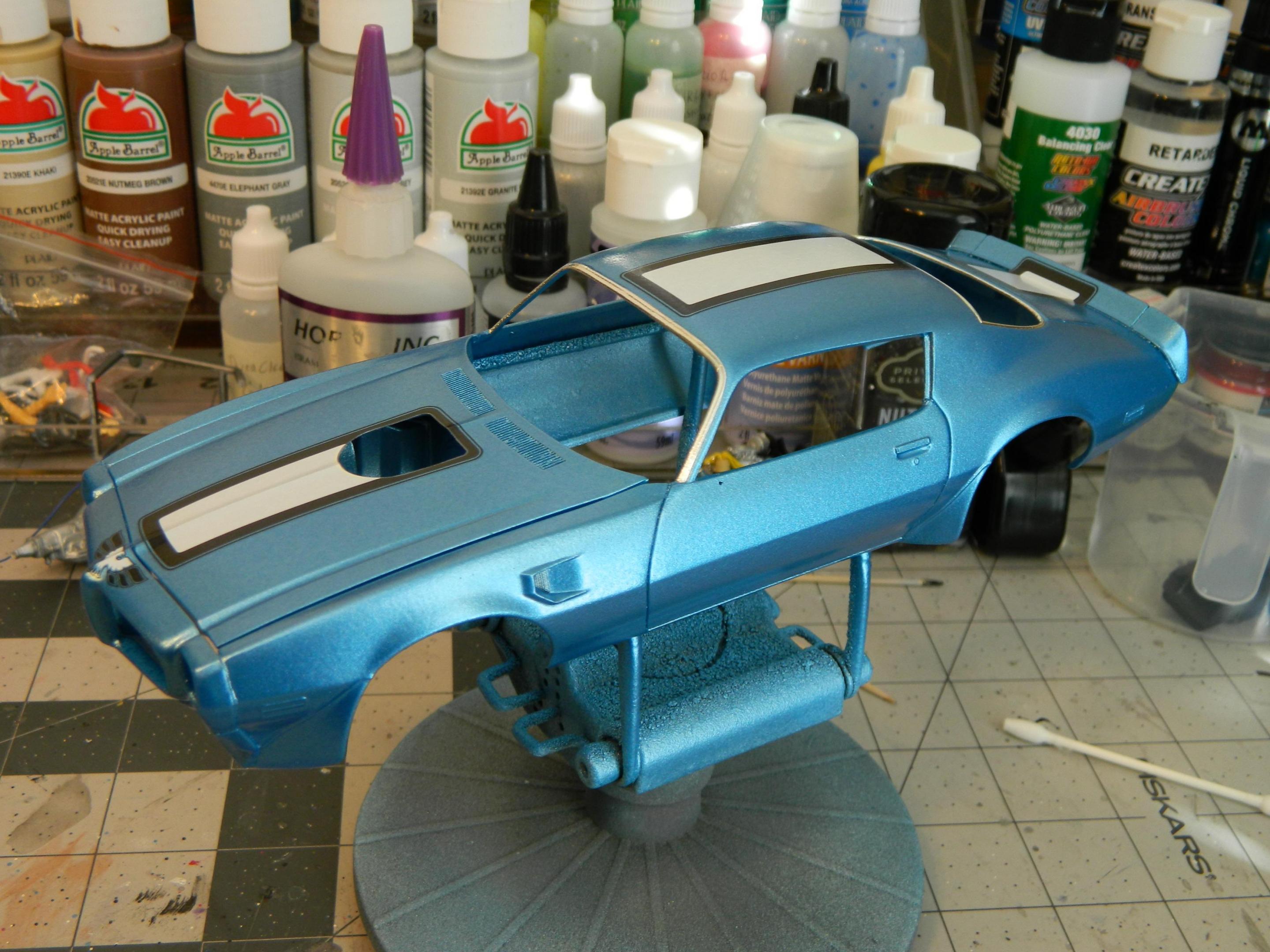

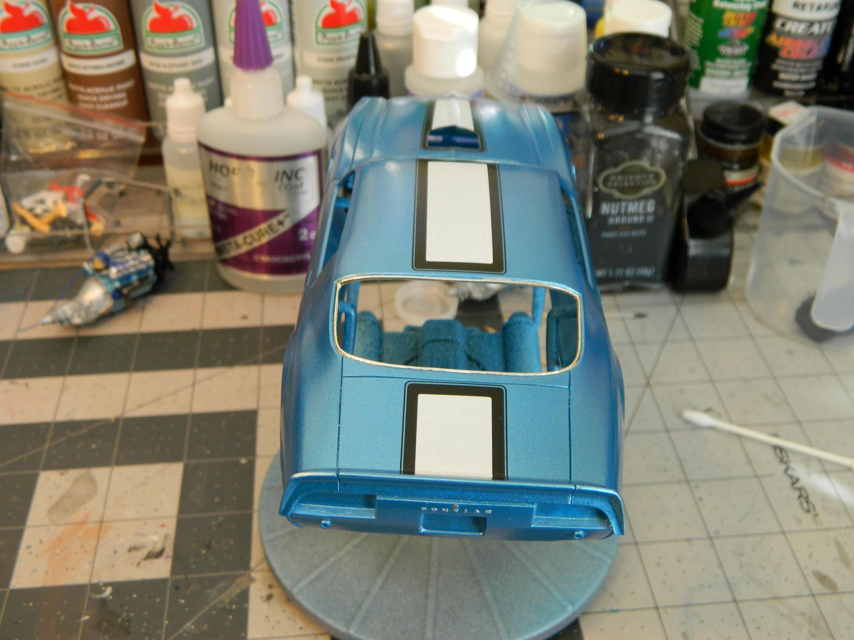

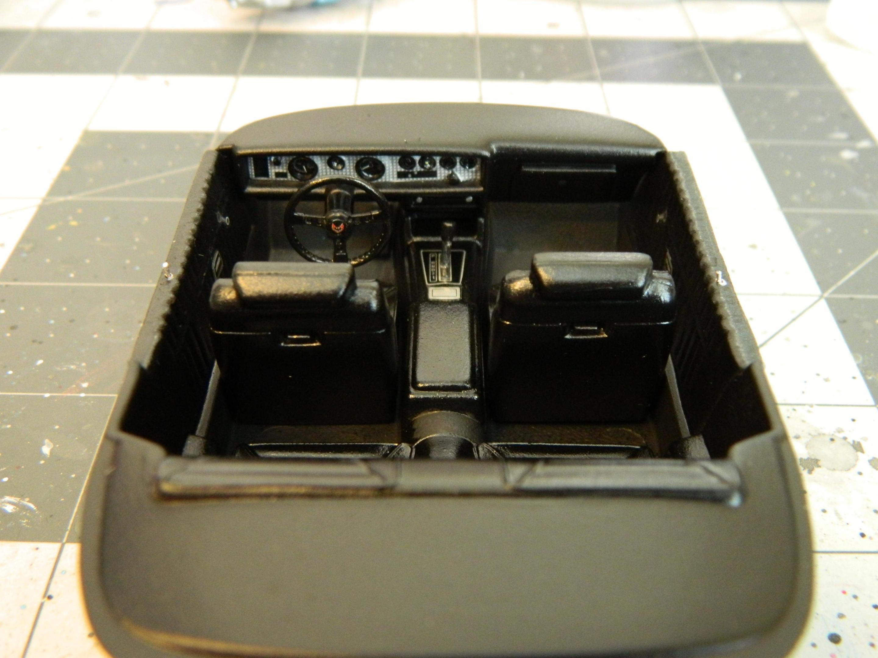

Dragonhawk1066 Posted February 23, 2021 Author Share Posted February 23, 2021 I got the BMF on the window trim yesterday, and the decals on today. I also finished both interiors today. There wasn't much of a groove for the front windshield, so I used some Tamiya tape for curves and outlined the trim, applied the foil, and used the tape edge as a guide for trimming. The back windows had a decent groove molded in, but I still deepened it a little for a better guide for the blade. I have the Trans am script for the front fenders and rear spoiler from Keith Marks, but I'm waiting until final clear, wet sanding, polishing, and wax before I apply them. The KM decal sheet has the right tiny fender script, but only includes one of each color, so I would need to order another sheet. There are 3 different shades of script just a little larger that I'm going to put on at the end, and decide afterwards if it looks ok with the slightly larger script. If not, I can easily remove them while I await another sheet. Tomorrow's schedule calls for both bodies to get their final clear coats, and getting the grilles and tail lights detailed. Quote Link to comment Share on other sites More sharing options...

FLHCAHZ Posted February 24, 2021 Share Posted February 24, 2021 Those dashes look amazing. Very nice detail work. I am also looking forward to see the shine go on Quote Link to comment Share on other sites More sharing options...
Dragonhawk1066 Posted February 24, 2021 Author Share Posted February 24, 2021 So I got the Decoart DuraClear Gloss varnish sprayed on and it definitely needs to be wet sanded and polished. I fear I might have gone too heavy with the first coat over the decals. We'll see if I can sand and polish it out, but if not I do have the second set of stripes for both to fall back on. I'll let the clear sit and harden until Friday or Saturday before attacking it. I'm at a standstill until then, because all that's left is detailing the engine bay, installing the "glass", the front grille and tail lights, and final assembly. Quote Link to comment Share on other sites More sharing options...

FLHCAHZ Posted February 25, 2021 Share Posted February 25, 2021 Did you freehand paint the details on the dash and consol? Quote Link to comment Share on other sites More sharing options...
Dragonhawk1066 Posted February 25, 2021 Author Share Posted February 25, 2021 (edited) 3 hours ago, FLHCAHZ said: Did you freehand paint the details on the dash and consol? Nope, the gauge panel, gauges, and gear selectors are all decals. The gauge panel is a little tricky as the gauge openings in the decal don't quite line up right with the gauge bezels. Edited February 25, 2021 by Dragonhawk1066 Quote Link to comment Share on other sites More sharing options...
FLHCAHZ Posted February 25, 2021 Share Posted February 25, 2021 Did the decals come with the kit, or did you source them somewhere? Quote Link to comment Share on other sites More sharing options...
Dragonhawk1066 Posted February 28, 2021 Author Share Posted February 28, 2021 On 2/25/2021 at 3:37 PM, FLHCAHZ said: Did the decals come with the kit, or did you source them somewhere? The decals come in the kit, it's a really nice sheet. Quote Link to comment Share on other sites More sharing options...

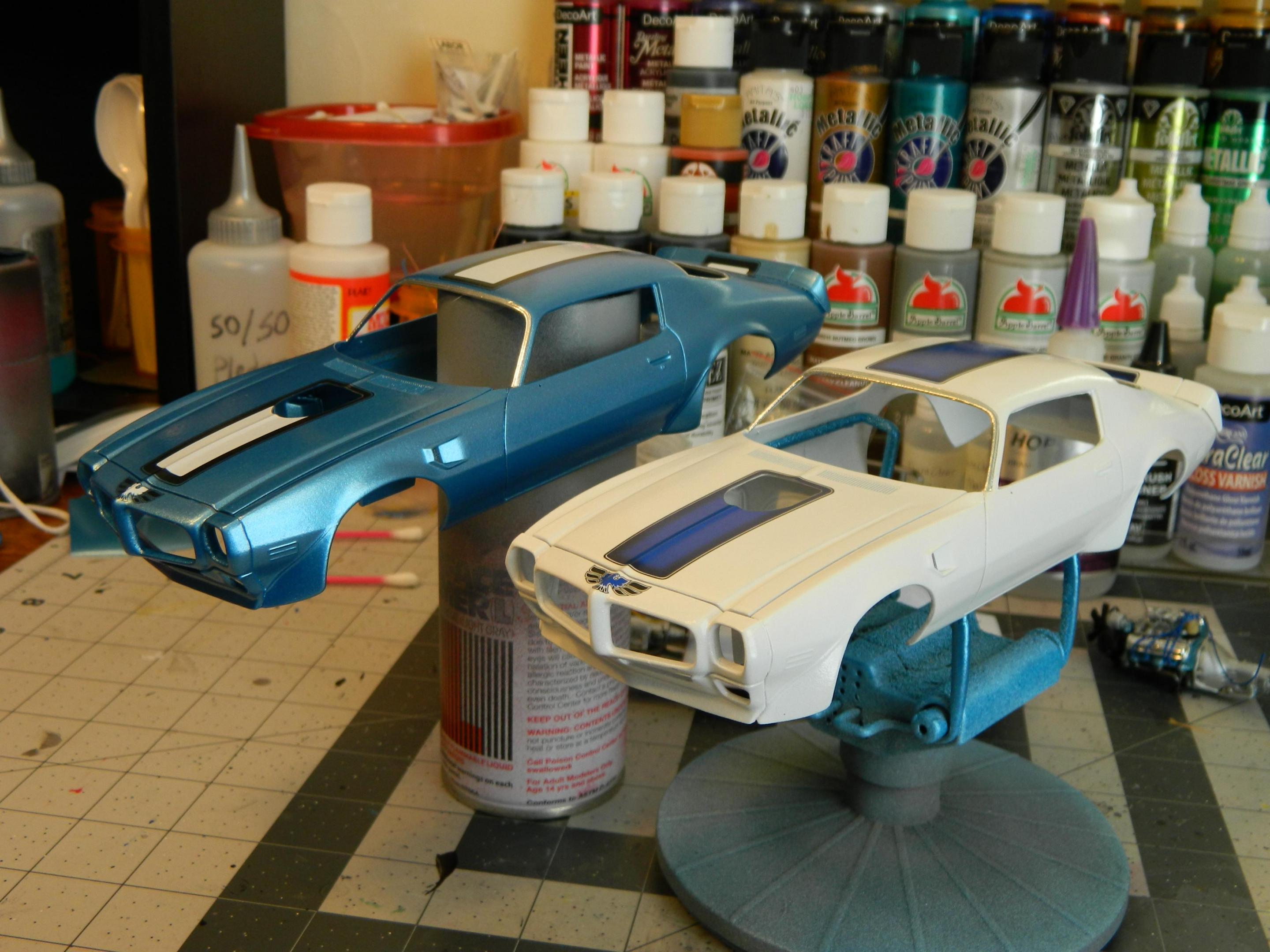

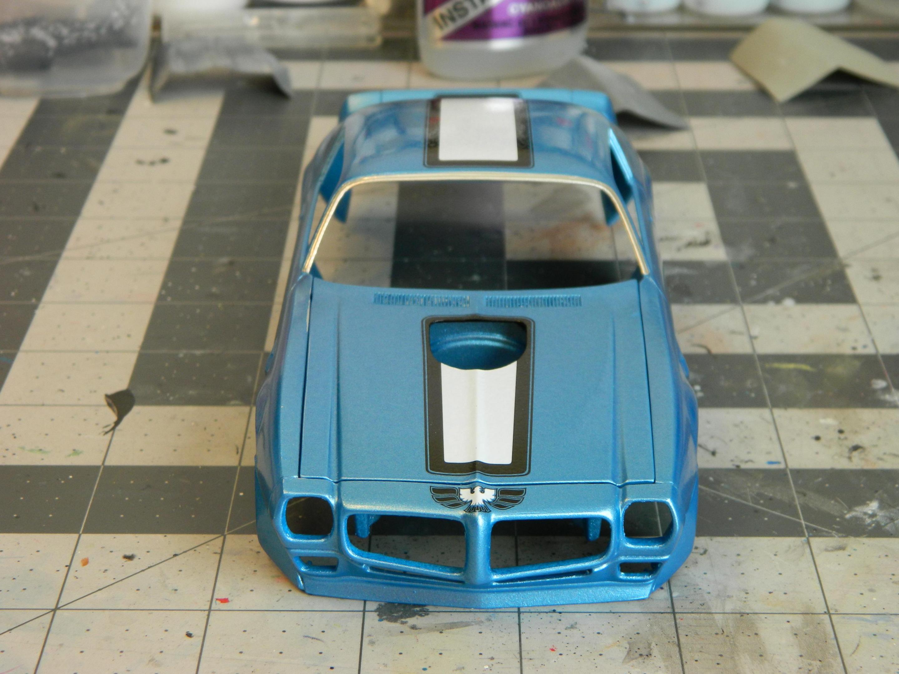

Dragonhawk1066 Posted February 28, 2021 Author Share Posted February 28, 2021 My right arm and hand are not going to forgive me any time soon, but I got both bodies wet-sanded, polished, and waxed. I started with 2000 grit, then 4000, then 6000. I went over the stripes with 2000 grit three different times to get them to where I was happy. The clear was plenty tough enough after 3 days drying time to handle some rigorous wet-sanding with 2000 grit without burning through. After wet-sanding, I polished them with Novus #2, and then applied a coat of Meguiar's Cleaner Wax. I also painted the head-liners, and started painting the engine bays just before dinner (no pics of that yet). Quote Link to comment Share on other sites More sharing options...
TransAmMike Posted February 28, 2021 Share Posted February 28, 2021 They look great Greg, too deep of a shine won't be factory "authentic" any way. Love those cars!! Quote Link to comment Share on other sites More sharing options...
