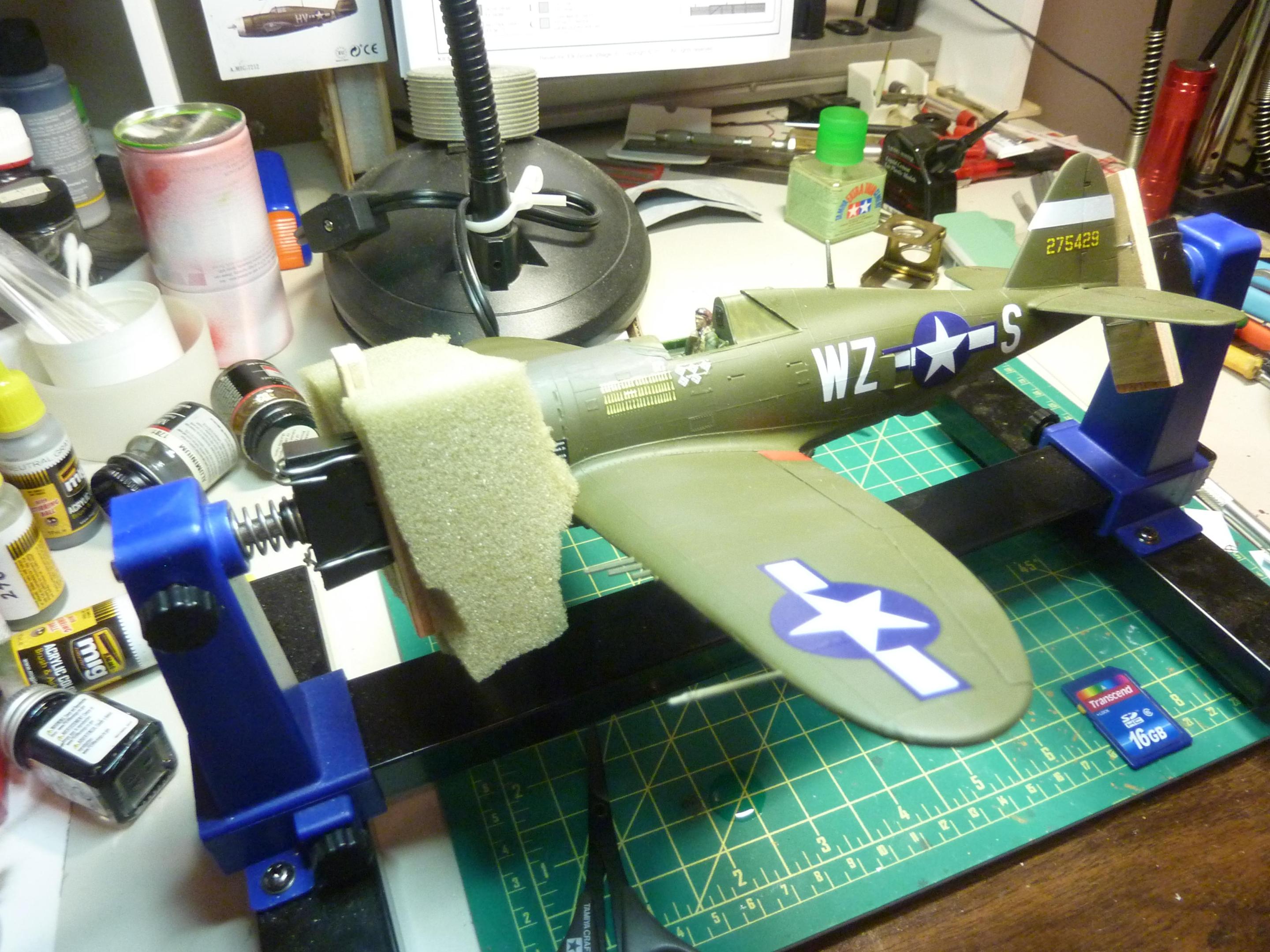

Raoul Ross Posted September 7, 2022 Share Posted September 7, 2022 (edited) Also, how have you been 'holding' you're model? I bought a circuit board holder which has been of infinite help with applying decals. Edited September 7, 2022 by Raoul Ross Quote Link to comment Share on other sites More sharing options...

Mike C. Posted September 7, 2022 Author Share Posted September 7, 2022 Thanks for the help, guys. I don't have quite an elaborate holding method as the airplane, but I am using the toothpick to position the decal and I brush on both more water and the micro set solution then the decal more decal solution and when everything is all set, I follow up with the micro sol with a Q-Tip while pressing out the air bubbles. Then I let the entire thing air dry for a few days before spraying it with clear. Fingers crossed. I won't ruin my last side graphic. Quote Link to comment Share on other sites More sharing options...
