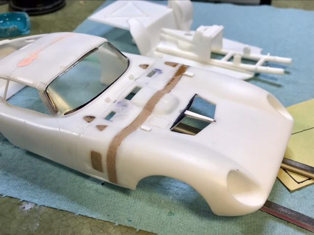

absmiami Posted November 29, 2022 Author Share Posted November 29, 2022 The new bonnett dimensions match the measurement that i took from the worn out rep daytona coupe bonnett shell … 23 ish inches to not quite 1 scale inch … Quote Link to comment Share on other sites More sharing options...

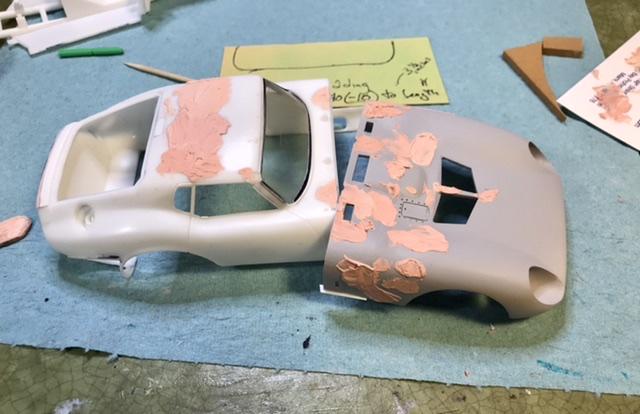

absmiami Posted November 30, 2022 Author Share Posted November 30, 2022 The wheelbase thing - i was part wrong and part right in my earlier posts - both the Model Car Mag and the later digital drawing have the correct 90 inch wheelbase - which scales to 95 mil … Quote Link to comment Share on other sites More sharing options...
absmiami Posted November 30, 2022 Author Share Posted November 30, 2022 So when i laid my new “long bonnett” coupe out on the digital drawing - the wheelbase is very close - bout 96 mil - ill take it …. Off we go … Quote Link to comment Share on other sites More sharing options...

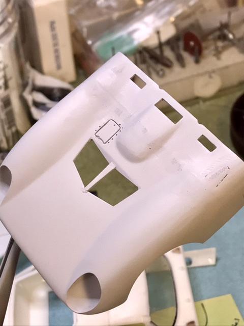

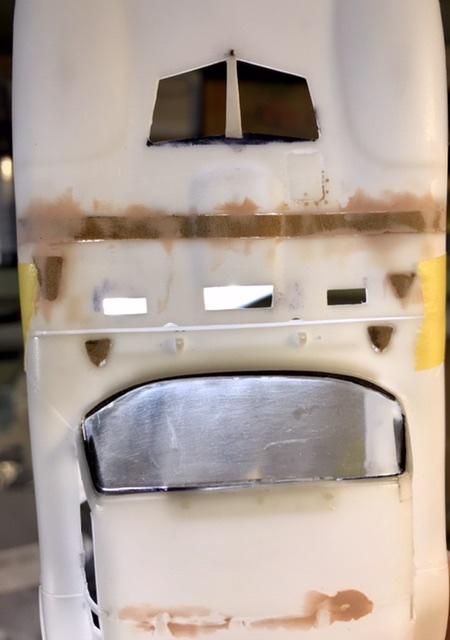

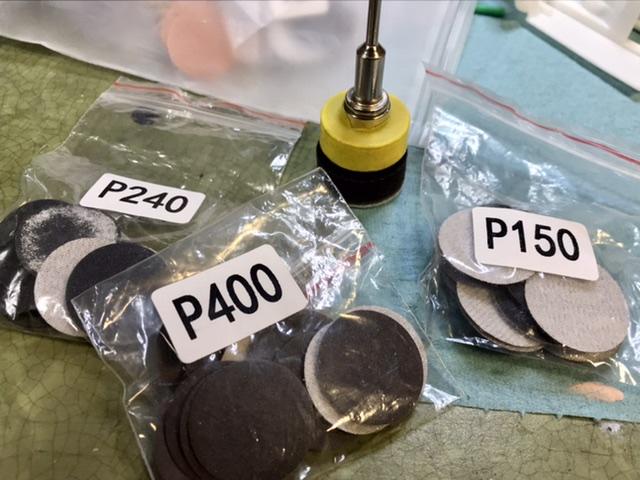

absmiami Posted November 30, 2022 Author Share Posted November 30, 2022 The 150 grit sanding drum took off most of the putty - followed by some random diamond bits and that odd bullet shaped sanding drum …. Quote Link to comment Share on other sites More sharing options...

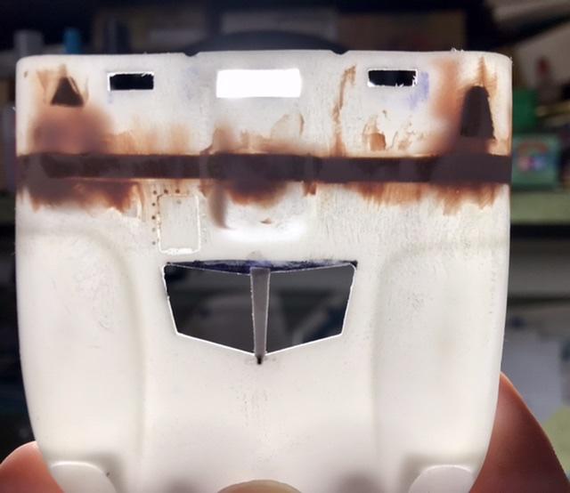

absmiami Posted November 30, 2022 Author Share Posted November 30, 2022 Against the shop lamp light you can see how thin the casting is - so i want to use only a minimum amount of putty - the scientific “finger”’test tells me that there is more to be done - but I’ll probably throw some primer on this just to see how close i am … Quote Link to comment Share on other sites More sharing options...

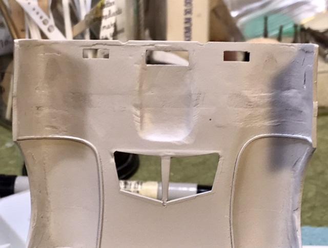

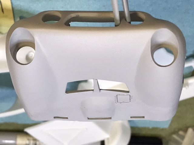

absmiami Posted November 30, 2022 Author Share Posted November 30, 2022 First coat of primer - better results than expected - another thin coat of putty and some more careful sanding and the Renshape strip will disappear … next to lengthen the frame and the rocker panels … 1 Quote Link to comment Share on other sites More sharing options...

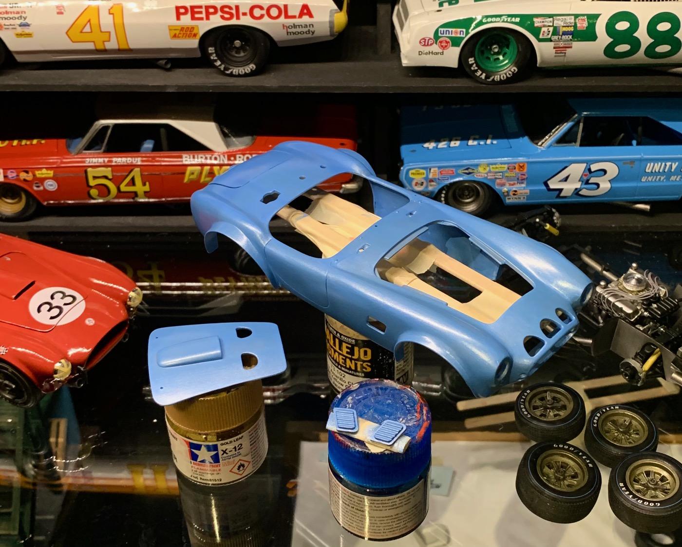

Pierre Rivard Posted December 1, 2022 Share Posted December 1, 2022 (edited) Entry #1 body has color on it. Always a bit of a go-no go check point for me with the challenge of brush painting, especially a light metallic. At this point it's a go. Edited December 1, 2022 by Pierre Rivard Quote Link to comment Share on other sites More sharing options...
MarkJ Posted December 1, 2022 Share Posted December 1, 2022 I can already tell it's going to be a winner, Pierre. That metallic blue looks awesome already and not the hint of a brush stroke. Quote Link to comment Share on other sites More sharing options...
