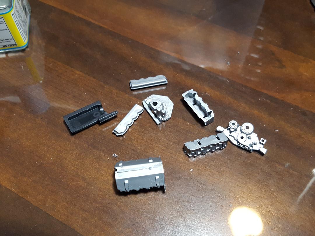

Thanks, David. I found out about the fitment issues during the first round of assembly on the engine. I'm using a liquid glue that is very thin and seems to be working quite well. Did you paint the engine or just keep it oob?
Link to comment
The kits are molded in colours that are like the real car so those new to the hobby or just NASCAR fans can buy and build them OOB with no paints. Personally I paint everything, or just about. The grey/silver they use in the kits is a decent base for tinting with panel wash. But for the engines I paint them. When you get to the chassis I build mine as one unit. Center, rear then the front. Then put them all together.

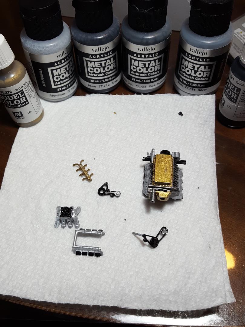

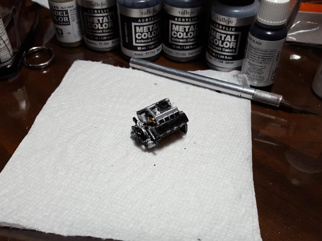

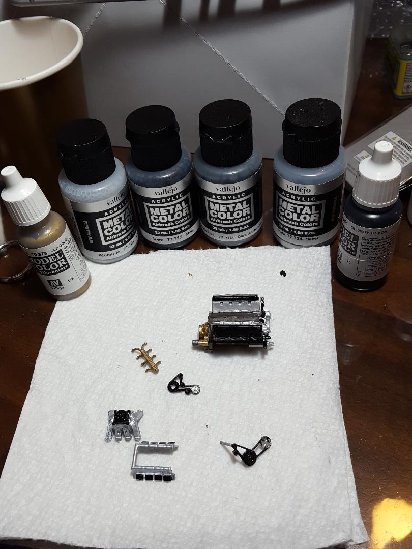

Got all the engine parts painted so hope to get it together tomorrow. I usually like to paint an engine after its completely built but I don't think that is possible with this baby. It's really a cool looking engine. I might have to make some decals for the valve covers if I find out what's on them or if there are decals on the real ones.
Link to comment
Good start Mark.
For the engine, here's the decals for the valve covers. They're for the previous gen of car but to the best of my knowledge they didn't change the engine specs, or very minimal if at all, so they should be correct. All the guys on the NASCAR groups are using them still for the Next Gen cars. Has decals for Roush, Hendrick, RCR, Toyota etc.

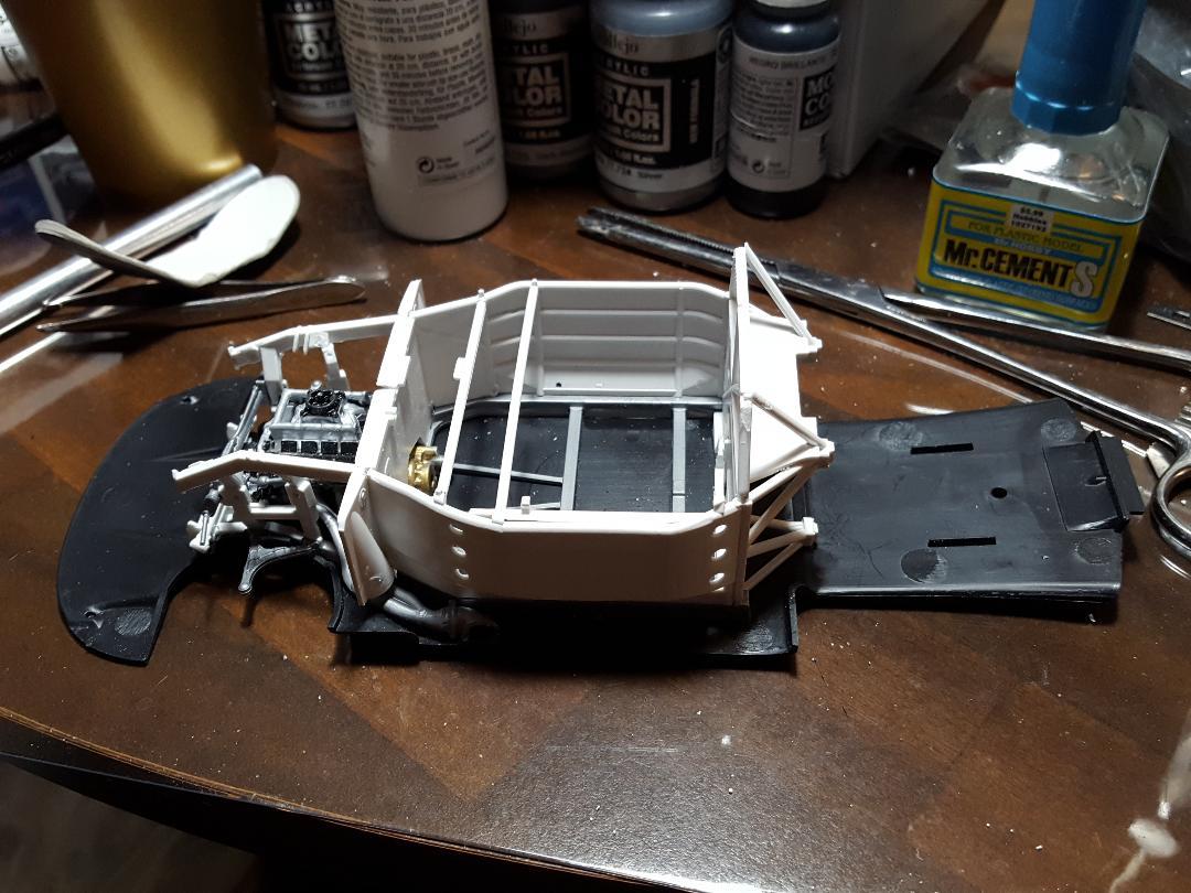

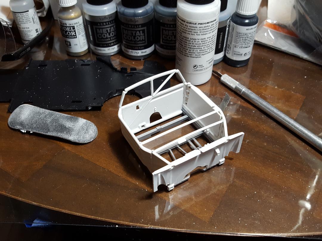

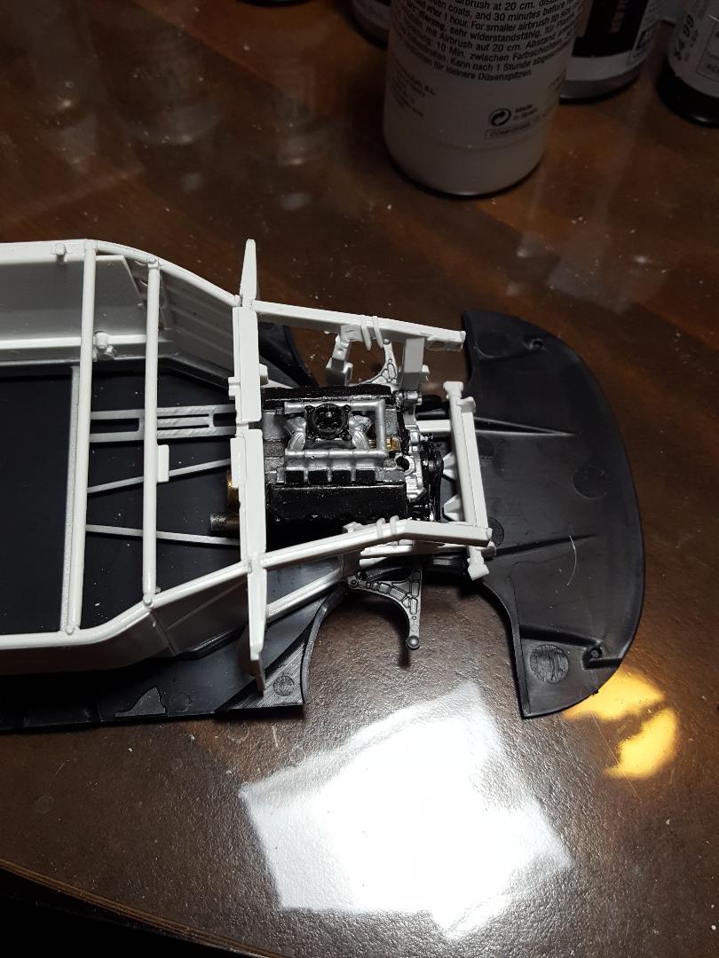

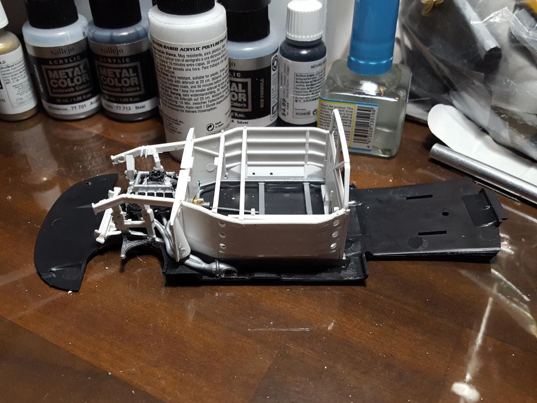

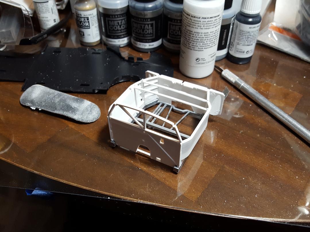

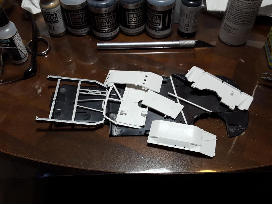

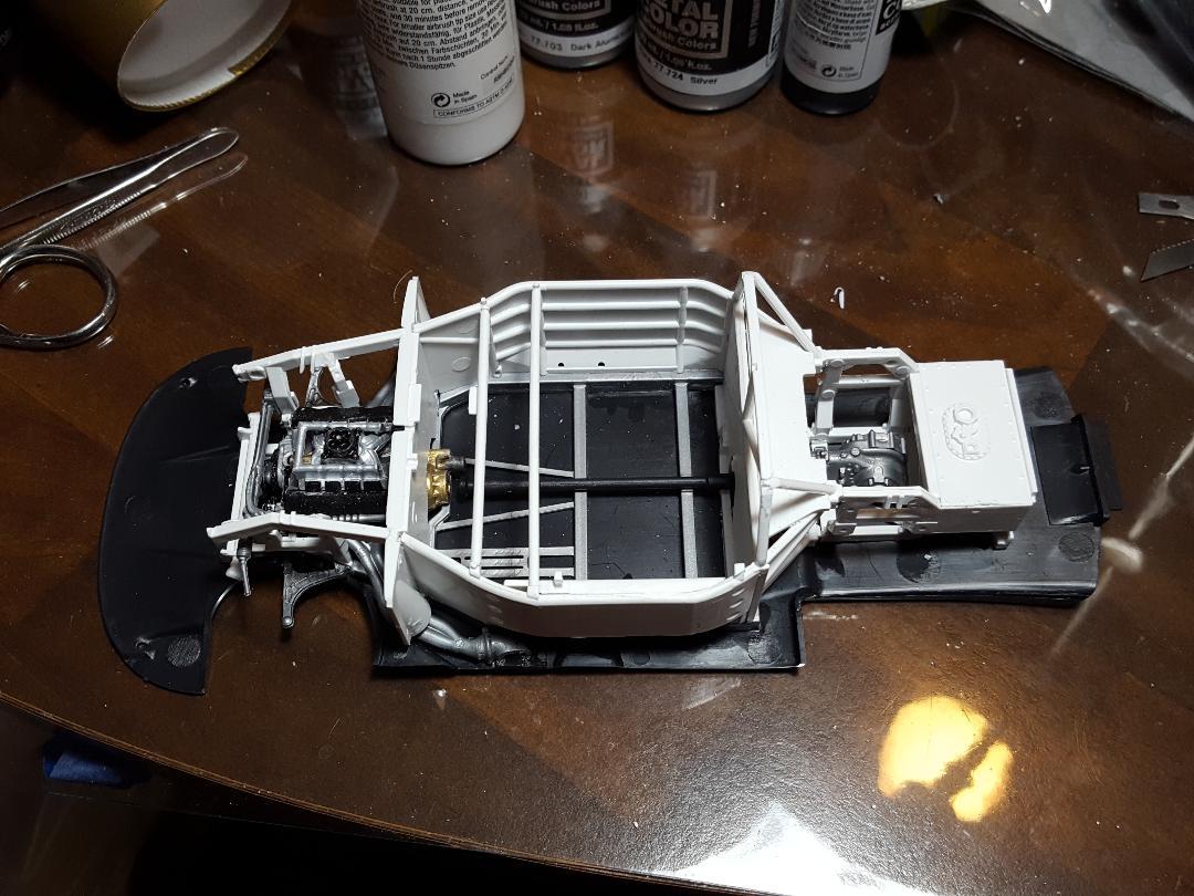

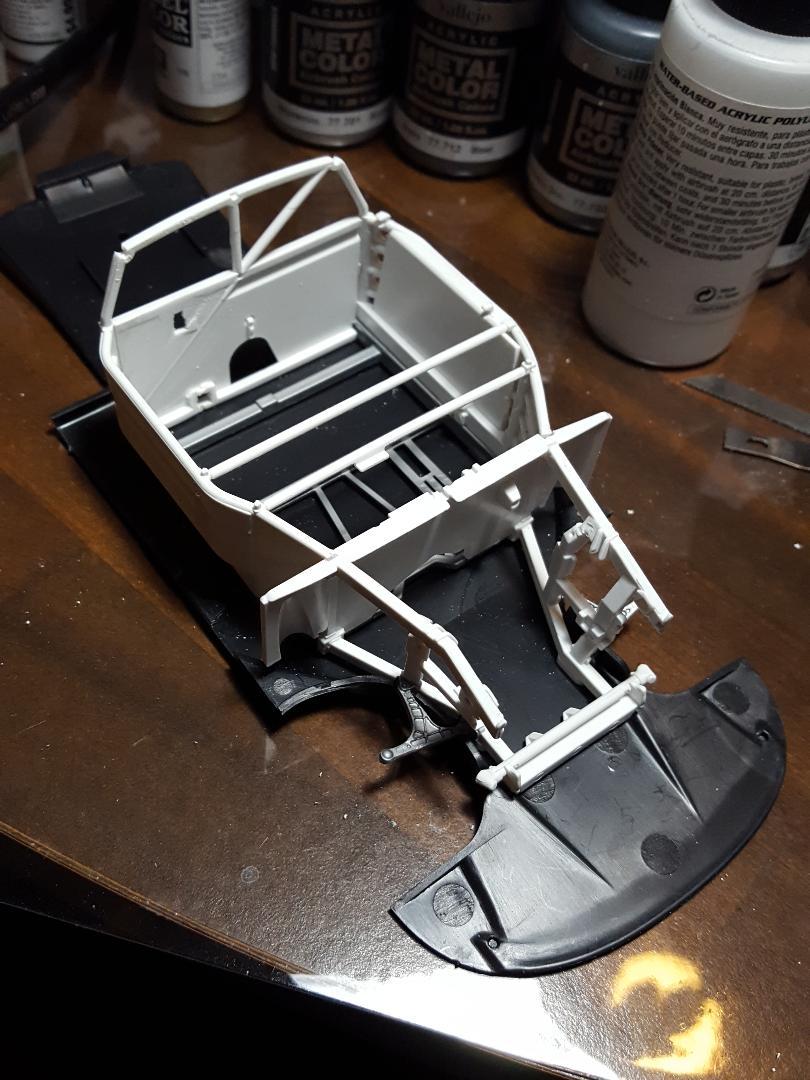

I skipped over direction section 2 because its wheels and tires and I need to prime and paint them first. I finished direction section 3. I cut off those 2 boxes that Clay recommended be done and will paint and add them later. I have found that I need three arms and hands to put this model together. 2 hands to hold the parts together and one to apply the glue.
Link to comment
40 minutes ago, Jonathan said:
I am enjoying watching your progress.   I've been thinking about buying this kit. :)
Thanks, Jonathan. You won't be disappointed if you do. It's a fine kit so far for me other than the body roof Moulding that doesn't extend far enough and the drive shaft that is too short, but you really can't see the driveshaft after its built, so it doesn't really matter. Just put a drop of glue between it and the floor to make sure it doesn't rattle. Instruction #11 is a little sketchy, so I need to find a picture of the completed front suspension for some help on that.
