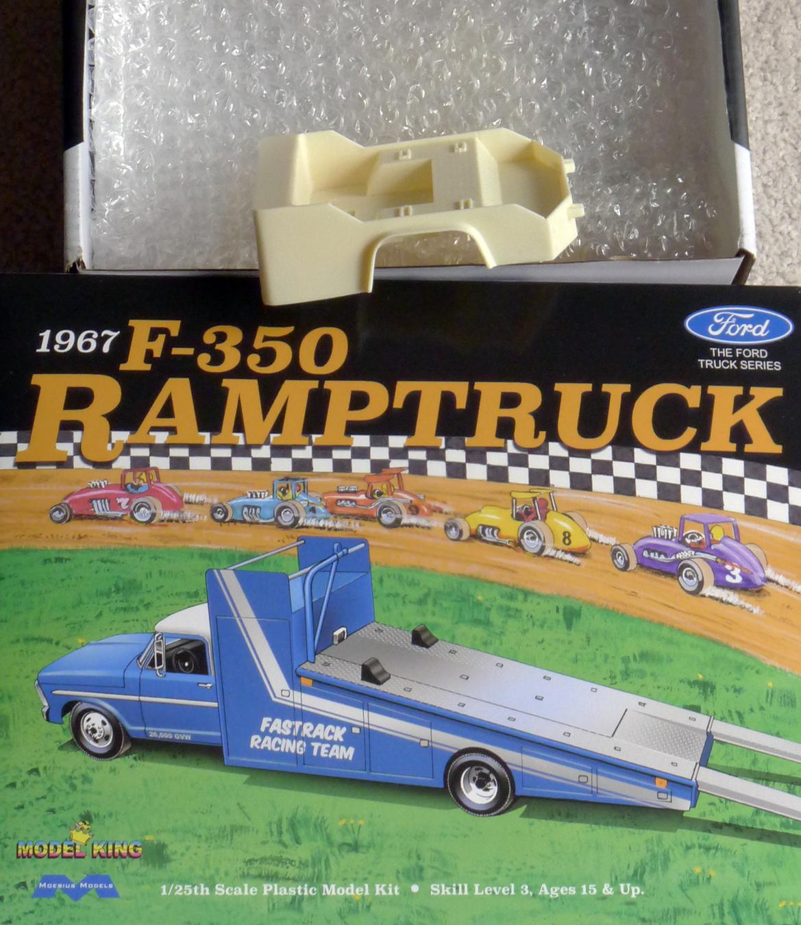

Warren D Posted May 5, 2023 Posted May 5, 2023 Found a small wrecker body on the auction site and found the Mobius ramp truck to be a good donor. Frame will need to be shortened, but that's about all. The frame is warped, so it's being straightened before I cut it down. Otherwise, my first Mobius kit is going together well. Of course, one day after I start Mobius announces almost the same thing coming in a kit. The wrecker body was supposedly made for an 8' p/u but it looks too wide to me. The F350 cab looks to be just the right size.

mikemodeler Posted May 16, 2023 Posted May 16, 2023 That wrecker body is a re-pop of the Midnite Cowboy wrecker bed and it was 1/24 scale, so it will look big on that 1/25 truck. That kit did not accurately represent a 8 foot bed so it does require some adjustment. I have a stalled project that uses that same bed, maybe you will inspire me to finish it.
Warren D Posted May 20, 2023 Author Posted May 20, 2023 On 5/16/2023 at 9:49 AM, mikemodeler said: That wrecker body is a re-pop of the Midnite Cowboy wrecker bed and it was 1/24 scale, so it will look big on that 1/25 truck. That kit did not accurately represent a 8 foot bed so it does require some adjustment. I have a stalled project that uses that same bed, maybe you will inspire me to finish it. Thanks, I guess that's why it looks better behind a larger cab. The ramp truck chassis is way too long anyway so it's cut down to the proper length.
