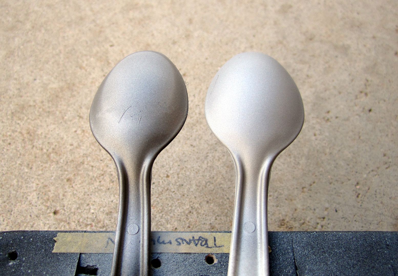

Mooneyzs Posted November 15, 2013 Author Posted November 15, 2013 Scott... Thank you for the kind words. you are welcome for the Alclad color guide, I wasn't sure how many people knew about it or not and thought it would be good to share. Gabriel... I originally shot it with the ALC-101 aluminum and I know that color isn't the best match. I never did think of shooting some dullcote over it. I just picked up some of the Semi-Matte Aluminum from Hobby Depot and I have been torn between the ALC-117 Dull aluminum and the ALC-116 Semi-Matte Aluminum. I think I may need to do a spoon test of each. I really need to be smart and have a bunch of spoons pre primered...lol

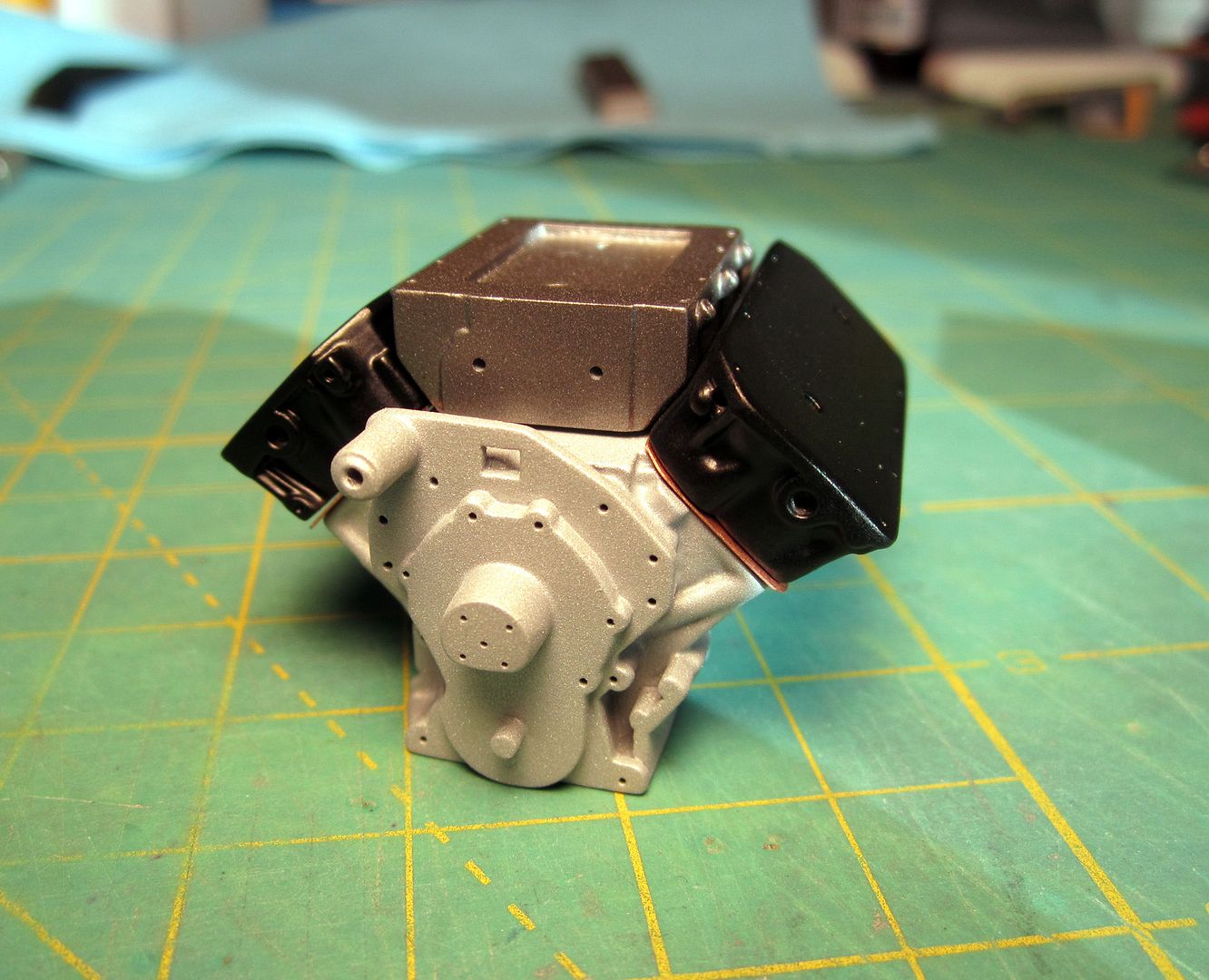

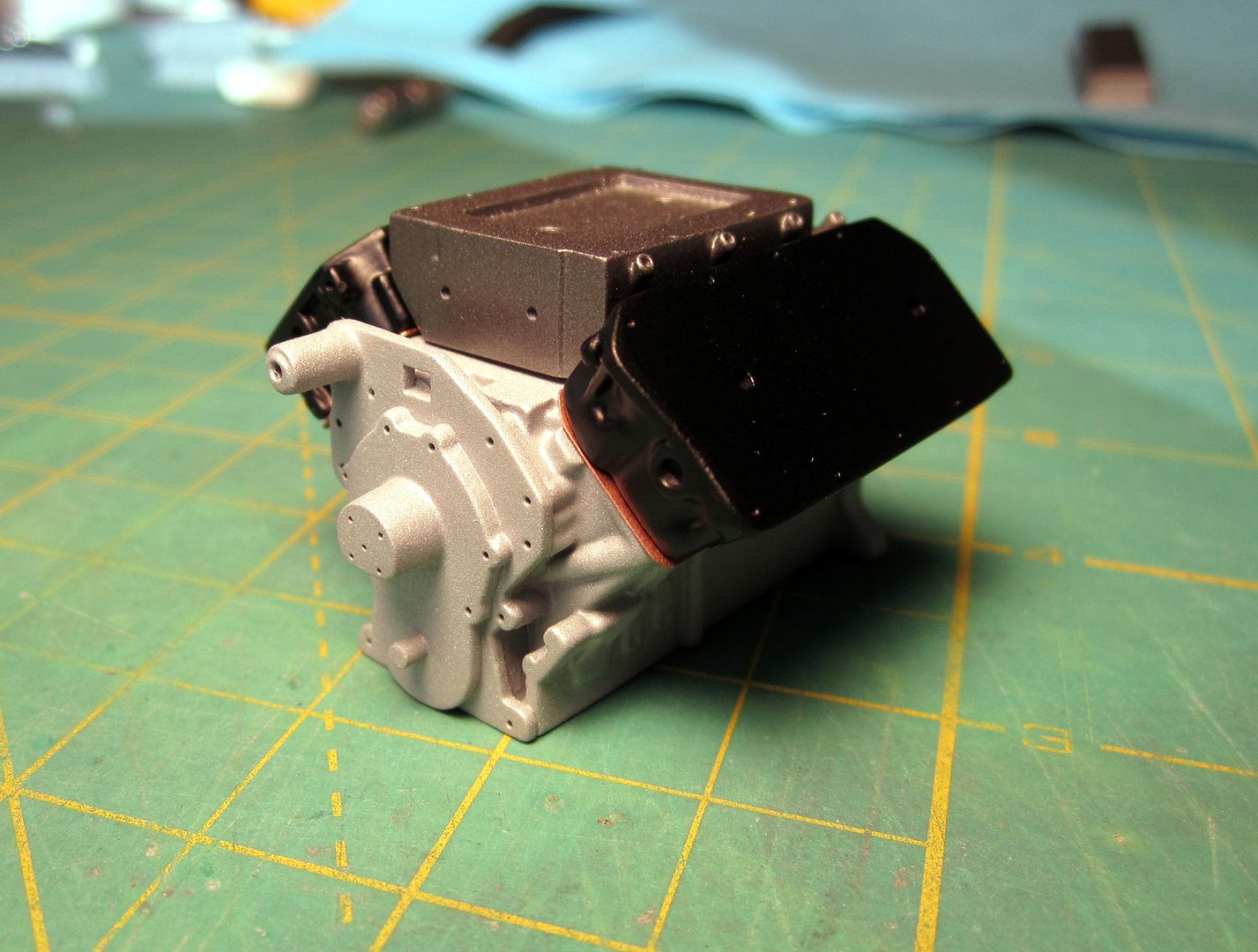

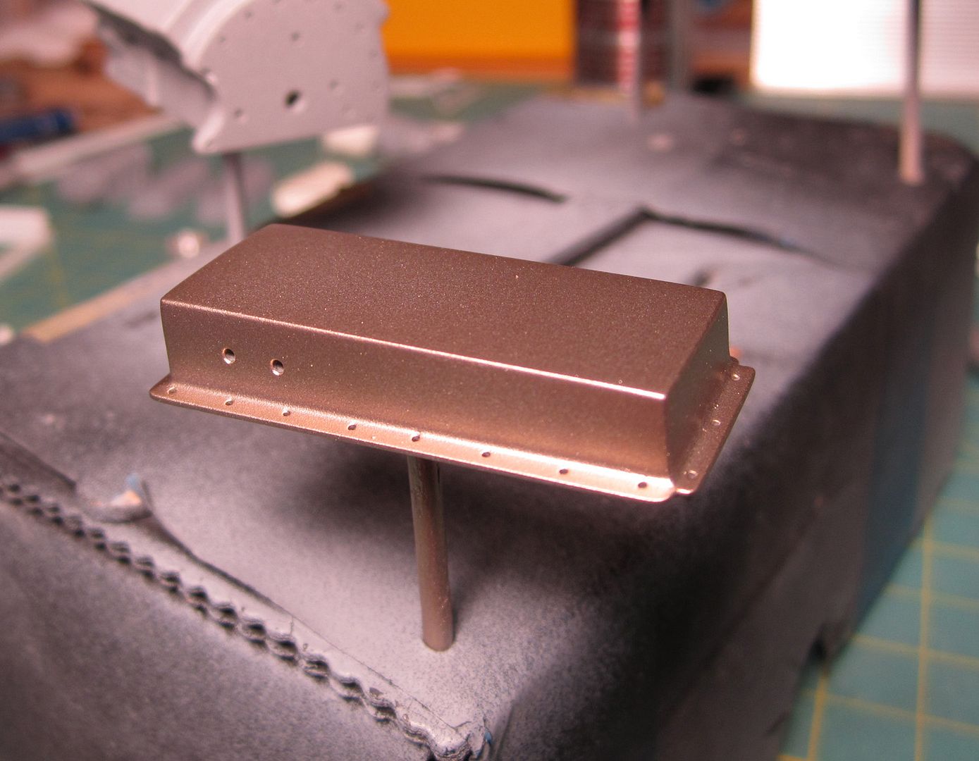

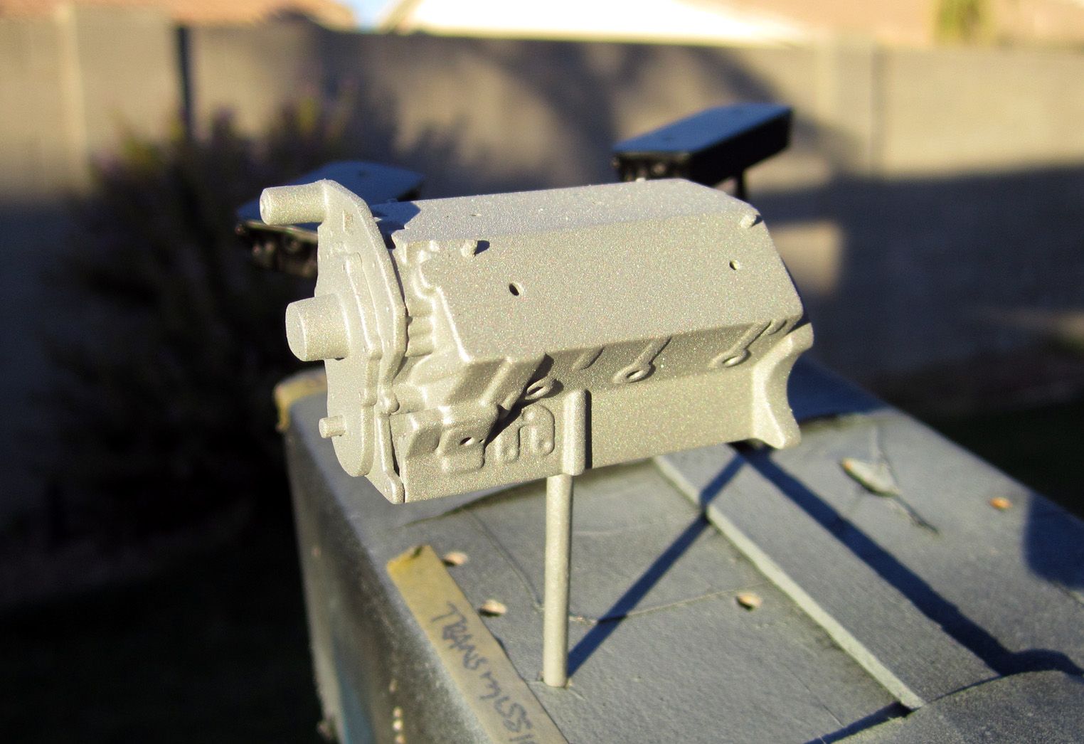

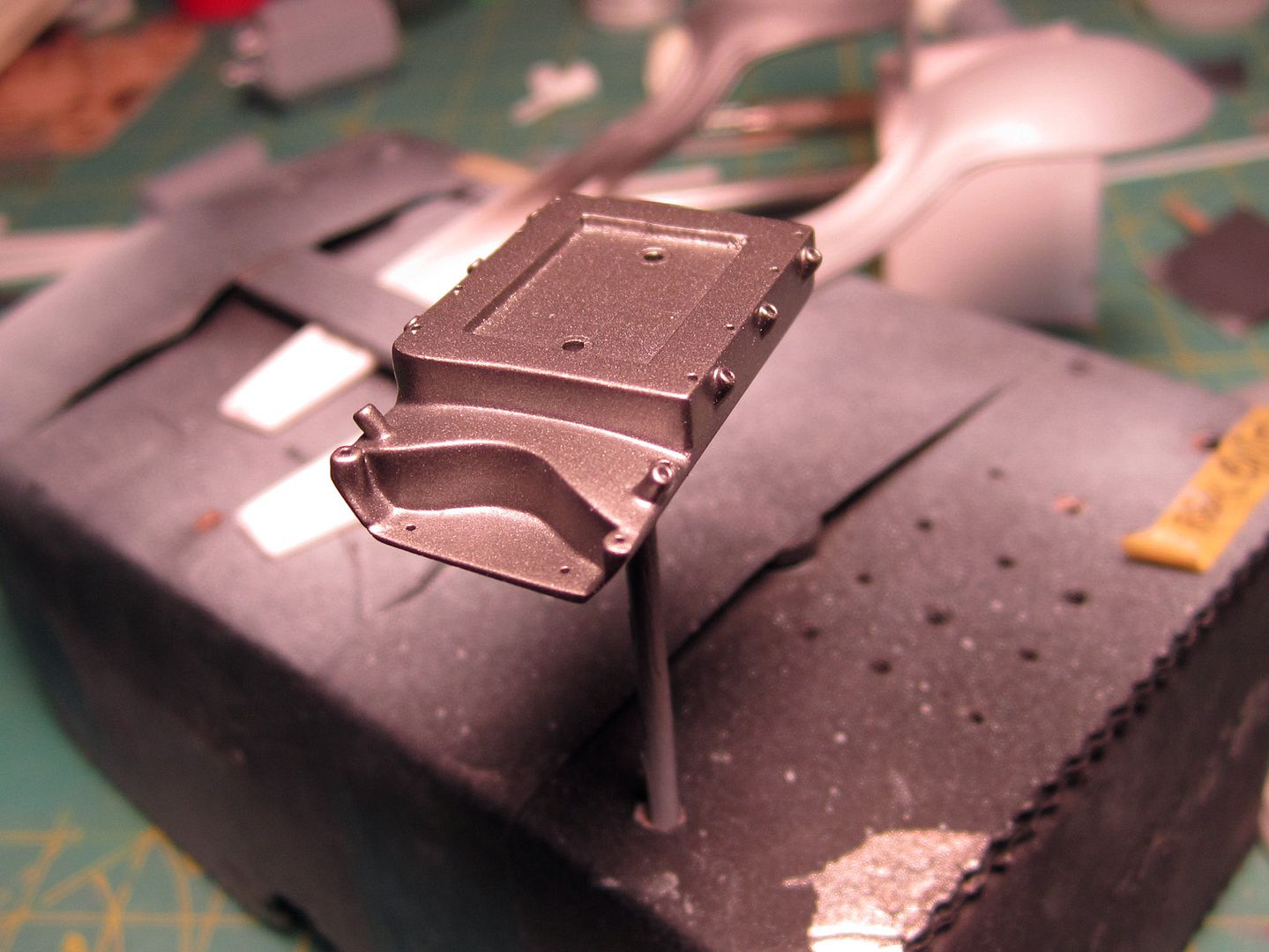

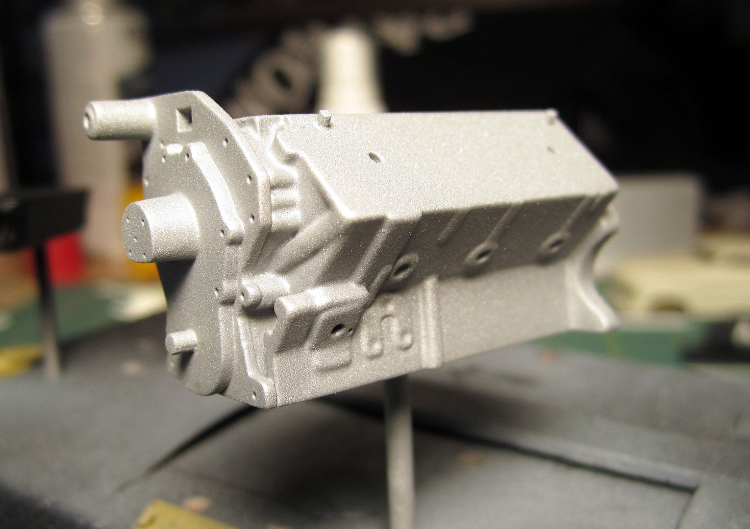

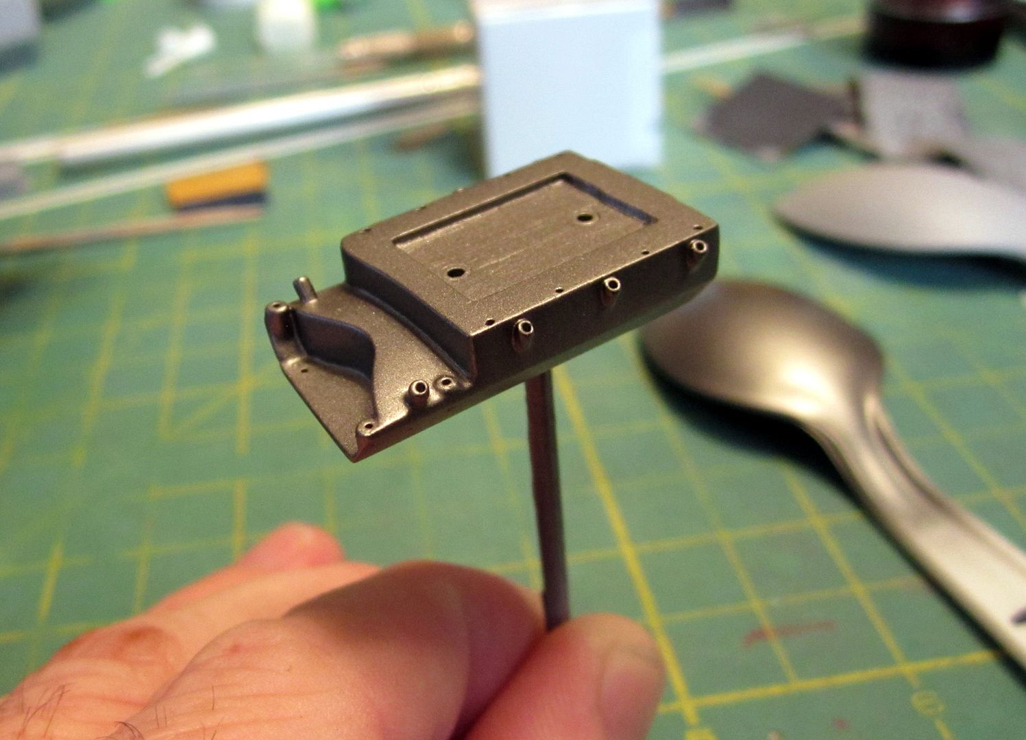

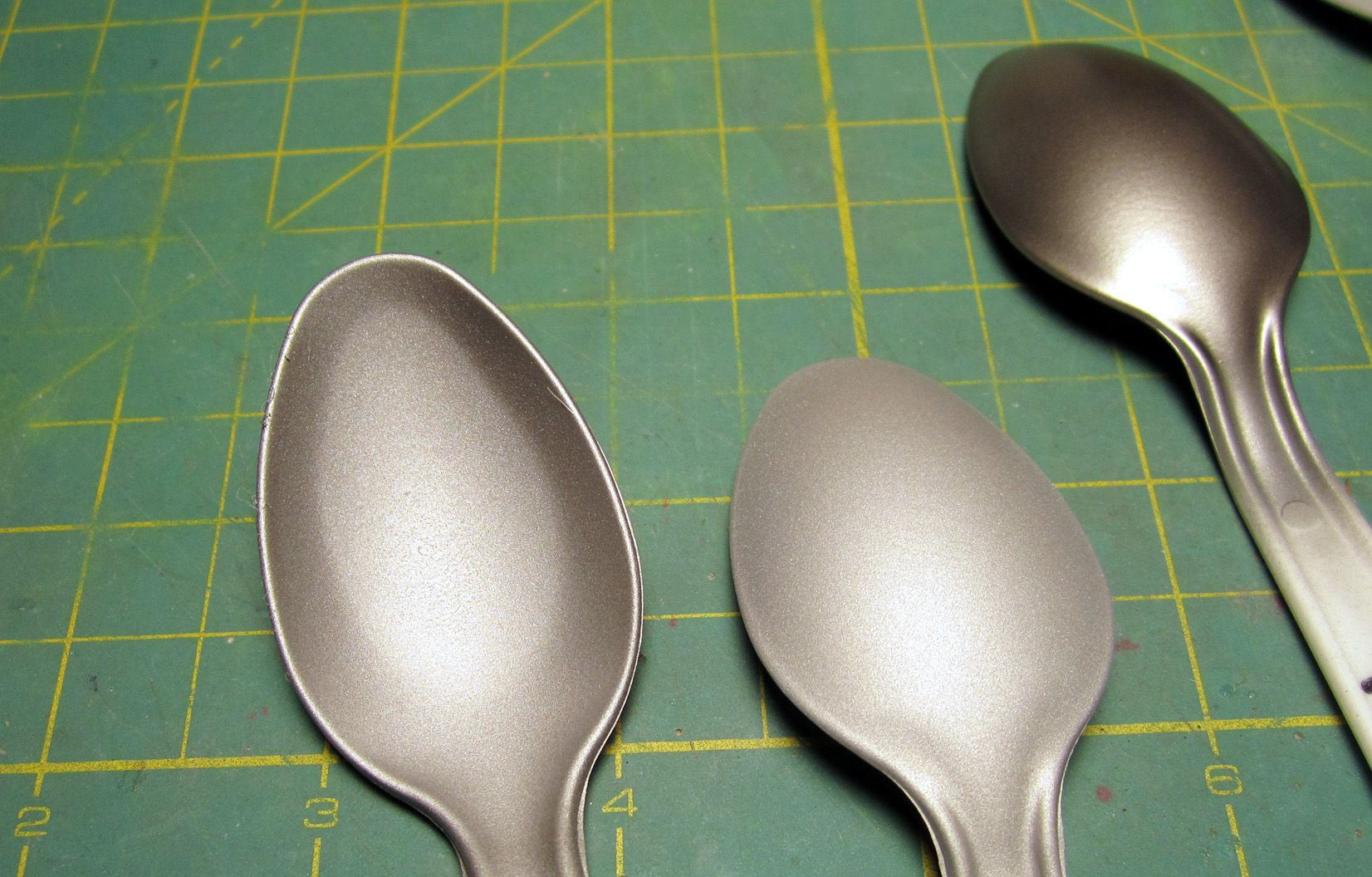

Mooneyzs Posted November 15, 2013 Author Posted November 15, 2013 Ok Fellas.... I did a real quick spoon test as well as painted the manifold. Here are a few pics: Here is the manifold painted with Alclad Magnesium: Different Lighting: Spoon Test... ALC-117 Dull Aluminum over a black base (Left Spoon) ALC-117 Dull Aluminum over gray primer base (middle spoon)..... Magnesium over gray primer (right spoon), Pics taken inside Outside Pics: Dull Aluminum over black base (left spoon)...... Dull Aluminum over gray primer base (right spoon):
Armornv Posted November 16, 2013 Posted November 16, 2013 Looks really good so far Chris. I can't really see the manifold in the engine pic, but the Magnesium looks spot on for the doohickies right at the top of the blower. As for the block, based on the pictures of the airplane, it looks to be somewhere between the steel and the semi matte aluminum. Just my two cents of course. Any which way you go, it's going to be absolutely stellar!

Mooneyzs Posted November 18, 2013 Author Posted November 18, 2013 Clint... thanks for the kind words. Here is another shot of the engine at different angle where you can see the manifold. I will have to say I am pretty happy with the color I sprayed on it...lol Gabriel... Thank you... I have to agree with you that the right spoon is the color that it will get sprayed. John... thank you for the nice words and for taking a few hours to go thru part of this thread. I know there are a lot of pages to go thru. Thank you for following along. Greg... Hey my long lost Aussie mate... How you doing buddy? It's great to hear from you and see you are back online. Thank you for the kind words. I have been a little busy on this and getting more done, I really can't wait until I have the motor assembled. I am getting really close to starting it but still have a few parts that need a little work to them. I look forward to see progress on some of your steller builds. Have you done anymore to the Pro Mod Camaro of yours?? So Fellas... I have some good news or what I think is good news. I finished all of the prep work on the block yesterday and got another couple coats of primer on it. I had it sitting under my make shift heat lamp to help the primer cure faster and It is ready to be painted. At the same time I sanded down the oil pan because it had some scuff marks in the paint from my height stand I made way back to get it to set at the correct height when I was making all of the mount brackets and well I couldn't let it fly so its going to get repainted as well. Then I also wasn't happy with the heads because I saw that they had a few sand scratches in them. So I decided to repaint them, the heads had too much of a gloss look so once I paint the black again I will hit them with some sort of a satin clear to tone it down. Hopefully I will be able to break the airbrush out today and spray these parts, if not I will spray them tomorrow Here are a couple of pic of the parts in their last days of primer... ... Before I primered the block, I started making a mounting plate for the Fuel pump that will be scratch build for this: Here is the block with the final primer coat on it. All I am going to do is hit a few of the spots that there was dust in it with some fine paper before it is painted: All of these parts are ready to be painted:

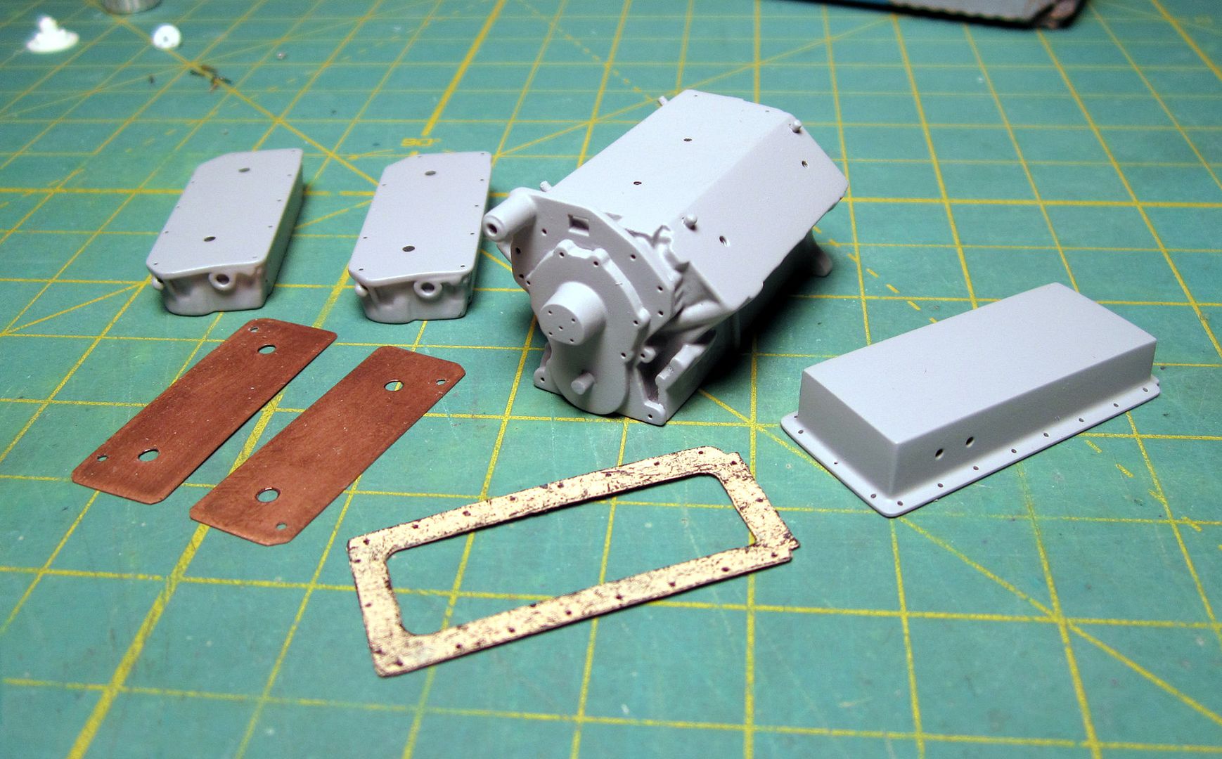

Mooneyzs Posted November 18, 2013 Author Posted November 18, 2013 Bob... I got the gaskets covered already Oil Pan and Head Gaskets: Danno.... thanks my friend. I was really hoping to make it out there this past weekend and wan't able to get there. Man I missed out on some good stuff. Did you by change get any pictures of the 1/6th scale funny car and 1/8th scale dragster?? Would loved to of seen them. I will make sure and make it out to the Goodguys show in march. Scott... Thanks brother!! the pieces are starting to fall together.....lol I hope anyway

Armornv Posted November 18, 2013 Posted November 18, 2013 Yep Chris, now that I've seen the other pic with a better view of the manifold, You definitely got the right color for it. I also think I was wrong about the block color. The second pci it appears lighter. So, I think you nailed that color too(not that I doubted you would get it wrong) . I can't wait to see this one finished, but I'll hate to see it end! There is just so much awesomeness here. As a side question, Are any of these 1/16 funny cars/pro mods etc. available in kit form or is it (what I'm guessing) buy or make a body, get a bunch of aftermarket parts, and scratchbuild the rest? the more I look at these big scale drag cars, the more I wanna build one but, I don't think I have near the skill to pull it all off.

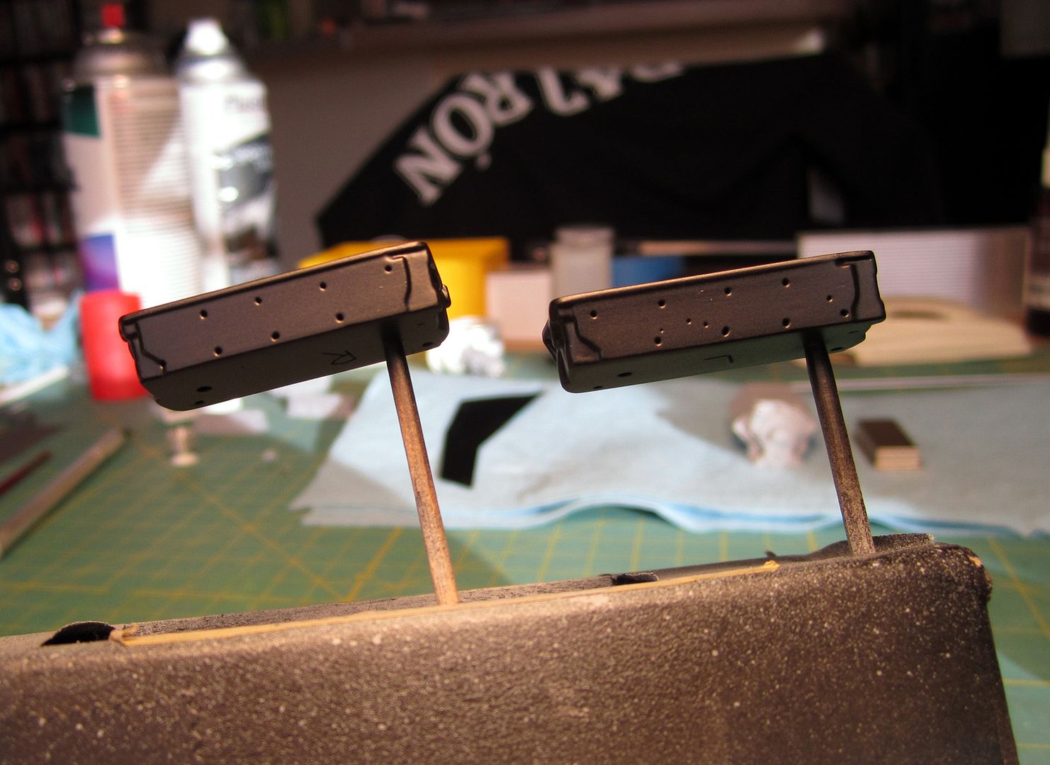

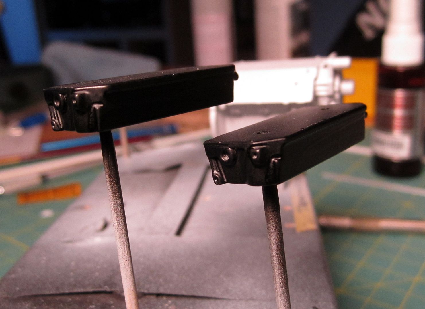

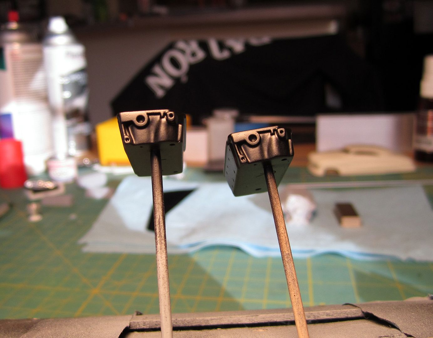

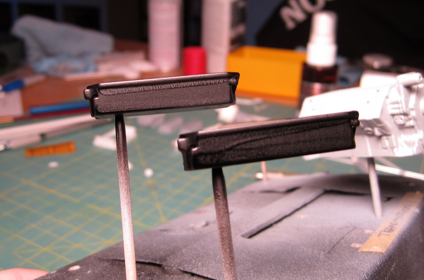

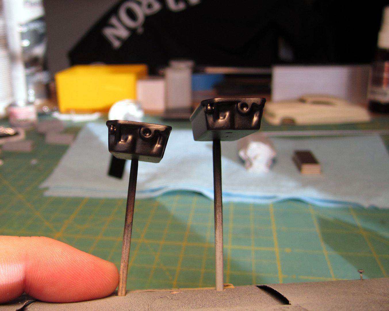

Mooneyzs Posted November 19, 2013 Author Posted November 19, 2013 Greg... Thanks Mate!! I am glad to hear that you are going to be hitting your stride again. I can not wait to see your big scale funny car build. That is going to be awesome. I can not wait to see your pro mod back on track. Joe... Thank you so much, I appreciate you following along on this adventure. Alan.... Thank you.... I have to be honest, I really hope its ready for the Winternationals...... . Please don't don't toss your F/C out. that's the last thing i ever want my build to do is discourage others. Well Fellas... I got some good news, I was able to spend a little time earlier repainting the heads and I have to say I am much happier with the results. This time I took HOK BC-25 Black Base and I added some flattening agent to it. I started out by spraying a spoon with no flattening agent in it then I proceeded to add flattening agent a little at a time and doing sample sprays on spoons to get the result I wanted. took me a total of 4 times of adding a little more flattening agent to the base until I got the result I wanted. I sprayed 2 coats of the base on the heads and I think they turned out great. Here is the results..... Heads, Header Side Painted: Heads, Manifold Side Painted: One End of the Heads: Other End of the Heads:

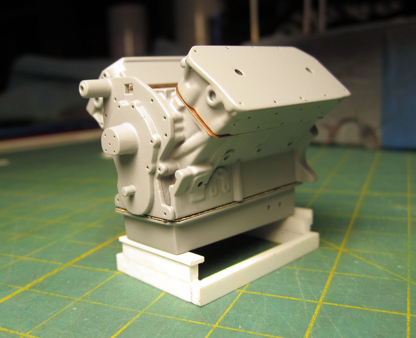

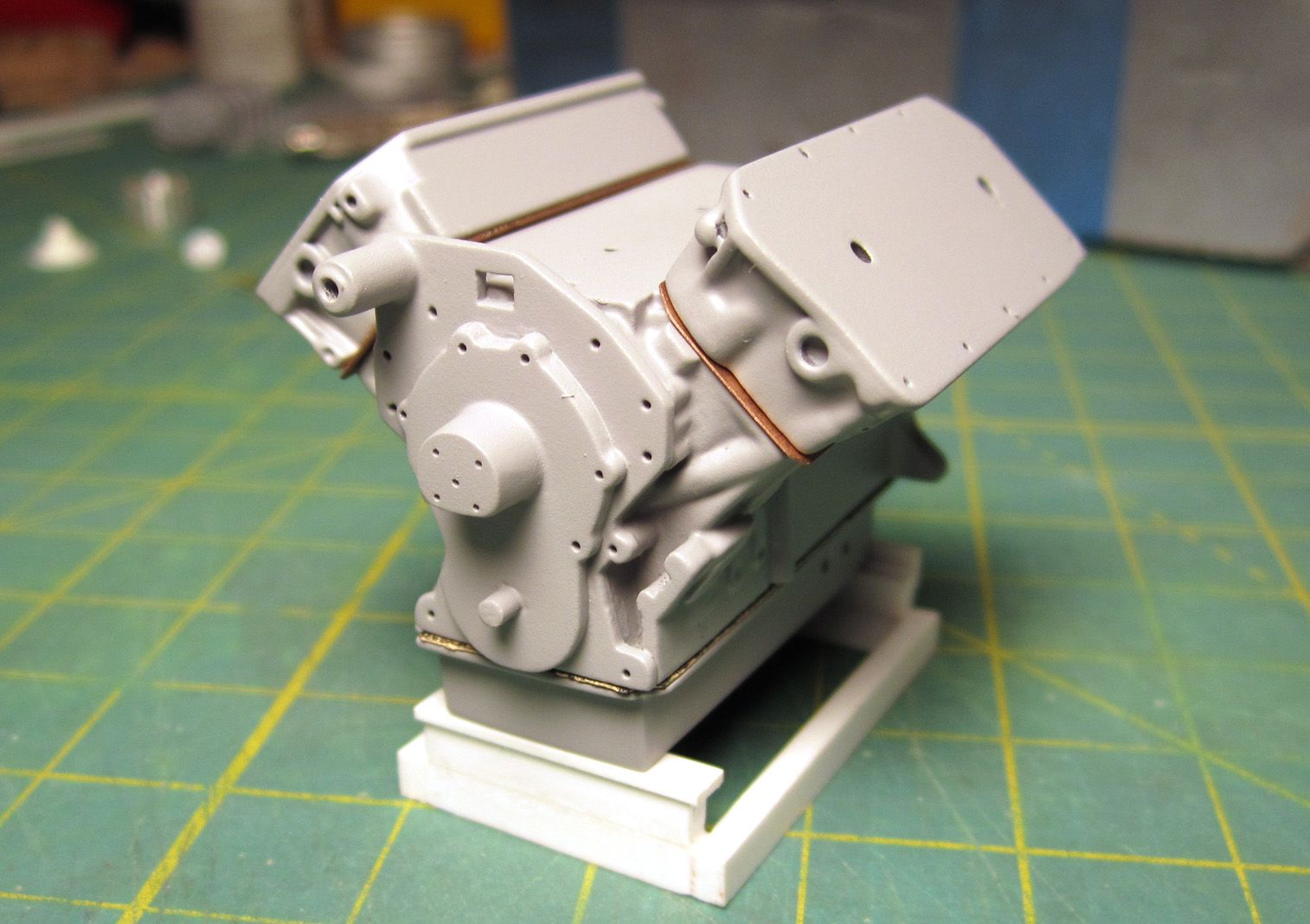

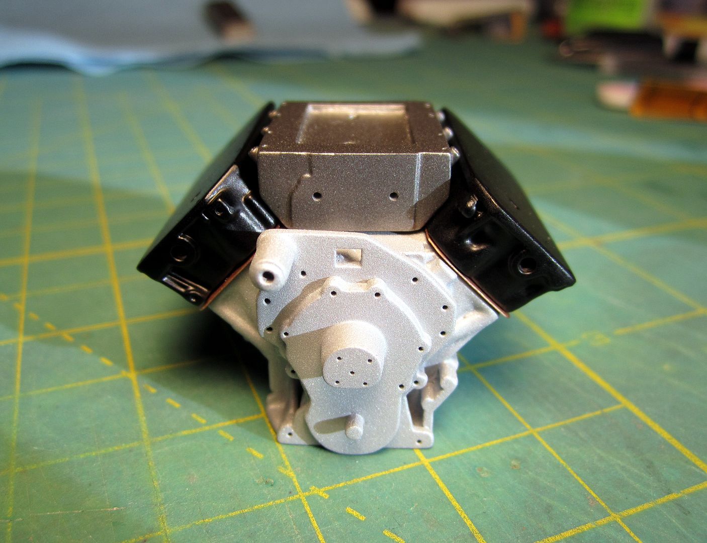

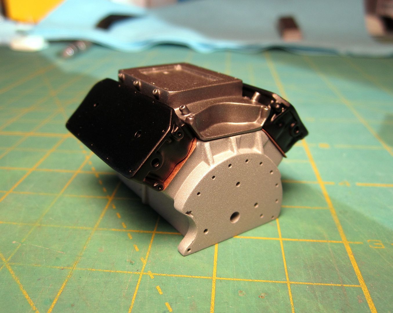

Mooneyzs Posted November 19, 2013 Author Posted November 19, 2013 And as usual I had to mock a few pieces up on the engine block to see what it will look like. Mocked up the block, head gasket, heads and manifold. I think it is finally starting to come together..... Engine Mocked up with painted parts:
