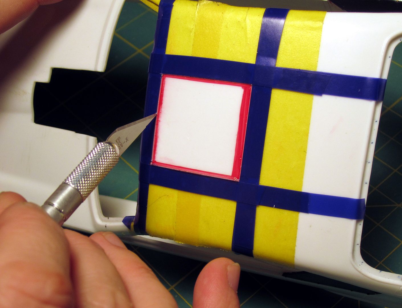

Here is the start of cutting the escape hatch out. I started by laying a few layers of 1/4 tape to use as a guide to cut along. I also went around the border with a sharpe so I could see what I have cut:
I am using the technique of scribing with the back side of an Xacto knife where I broke the very tip off. I typically like to use my Bare Metal Foil scriber but thought that the Xacto black would cut a little smaller gap:

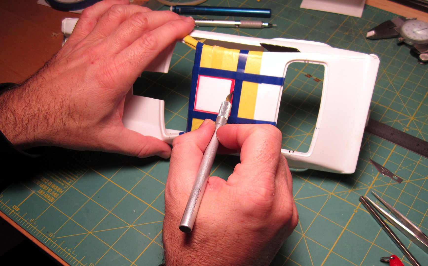

Another Scribing pic of the other side:

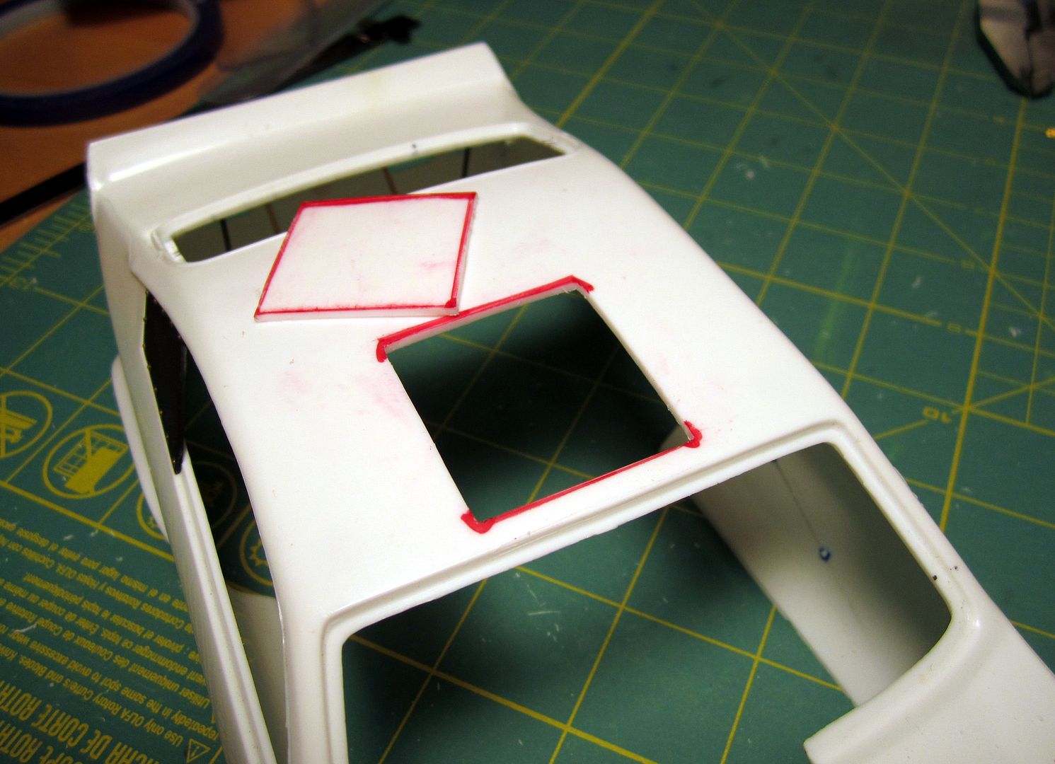

Here the scribing is pretty much complete other than having to work the corners a little more for the hatch to come out:
The scribing is complete and the opening is ready for the lip to be installed:

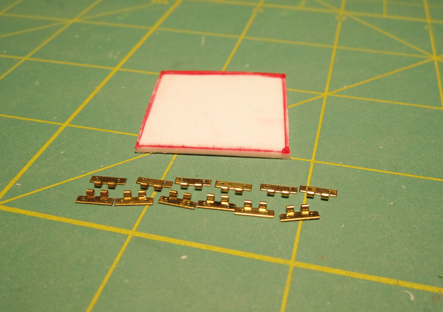

Here is the hatch and brass hinges that I got from Micro Marks which I will be modifying (will be shortening them) and then they will be soldered together to create a piano hinge for the escape hatch:
