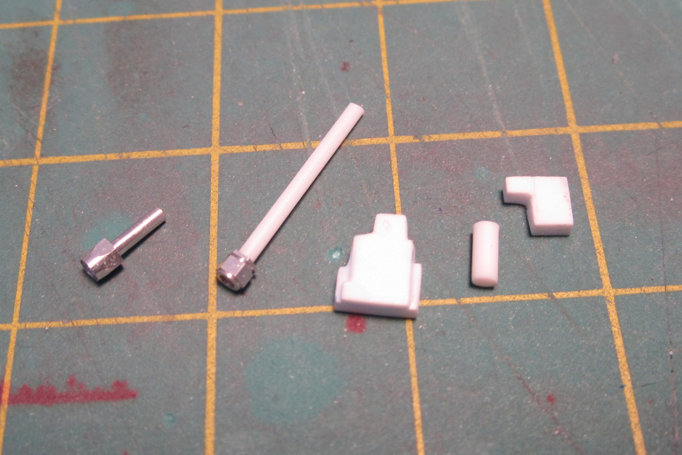

AZ Boy Posted May 25, 2012 Share Posted May 25, 2012 If you take a close look you can see that the oil filter housing has a push button quick release pin that holds it in place, and yes I am going to attempt to make it too...... yes I am nuts.... Funny, Chris! Quote Link to comment Share on other sites More sharing options...

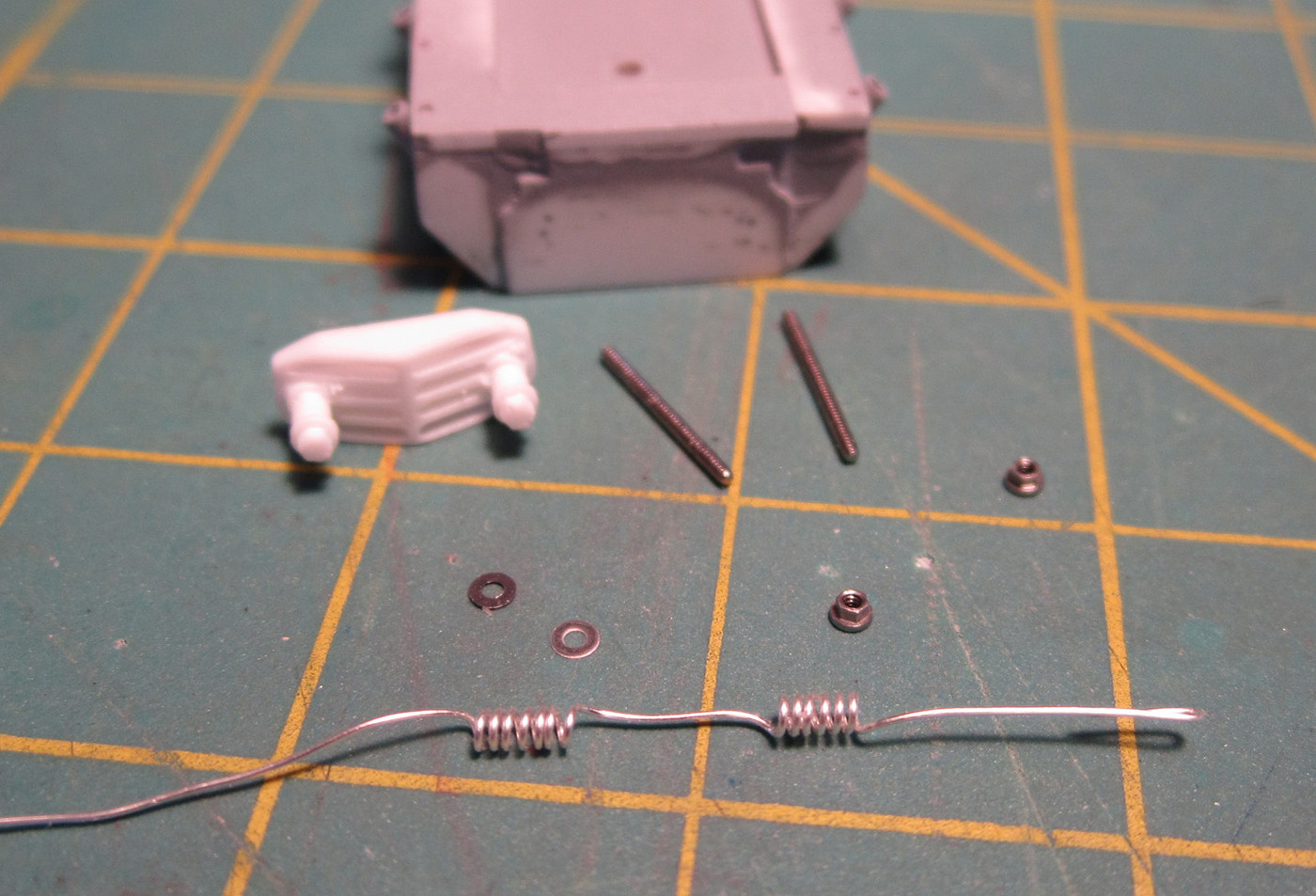

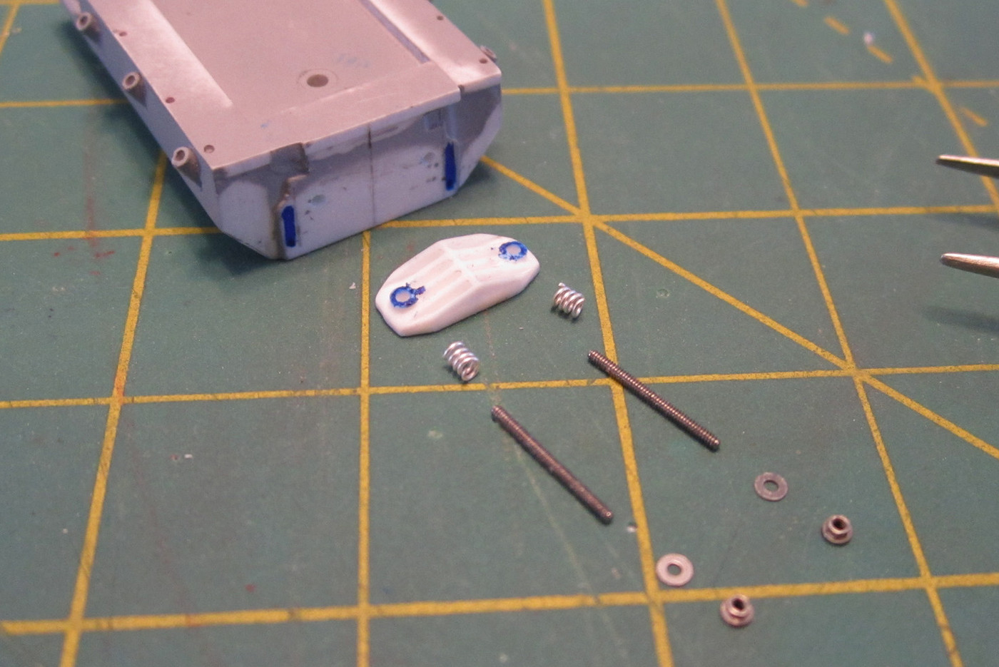

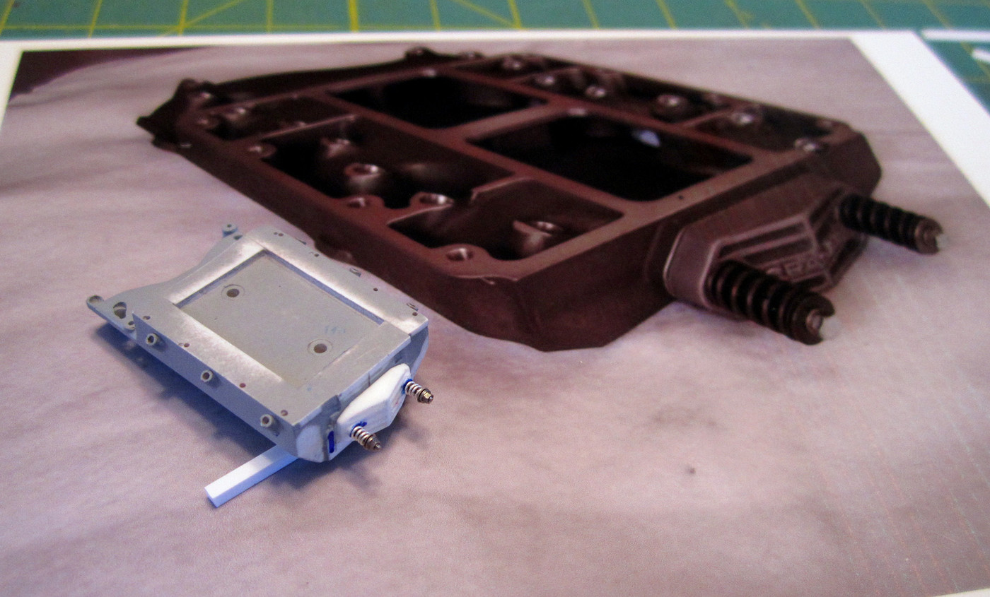

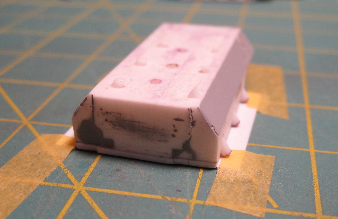

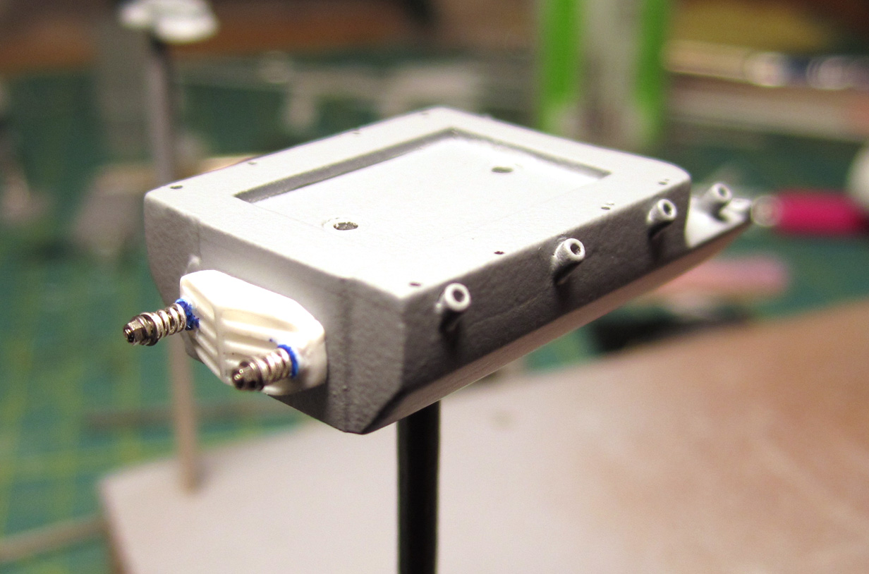

Mooneyzs Posted May 26, 2012 Author Share Posted May 26, 2012 (edited) Here is a quick afternoon teaser for everyone. I have been back working on my manifold again. I decided to start working on on the burst panel to change it up for a few. Here is the progress so far... I started out by sorta making a make shift jig.... real high tech if you ask me ..... more like Redneck Engineering... . Put down a piece of .015" thick styrene and taped it to my hobby mat. Then I sat the manifold on the hobby mat and this is to get the injector lines all at the same height for gluing them in place: Here is the parts that I have gathered for the burst panel and the start of the springs which I made from 30 gauge wire that I stripped: I proceeded to cut off the burst panels spring and bolt, then drilled holes in the spots I cut off. Then I transfer drilled the holes into the manifold and cut the springs down to the correct length: Once I did that I had to mock it up and put it together to see how it looks: Here it it next to a picture that I found online and printed the pic out, not to shabby if I'd say so: Edited June 16, 2020 by Mooneyzs Quote Link to comment Share on other sites More sharing options...

brett Posted May 26, 2012 Share Posted May 26, 2012 Very nice little detail Chris. Its that sort of work that you've put throughout this whole build that will make it stand way above the rest for a very long time Quote Link to comment Share on other sites More sharing options...

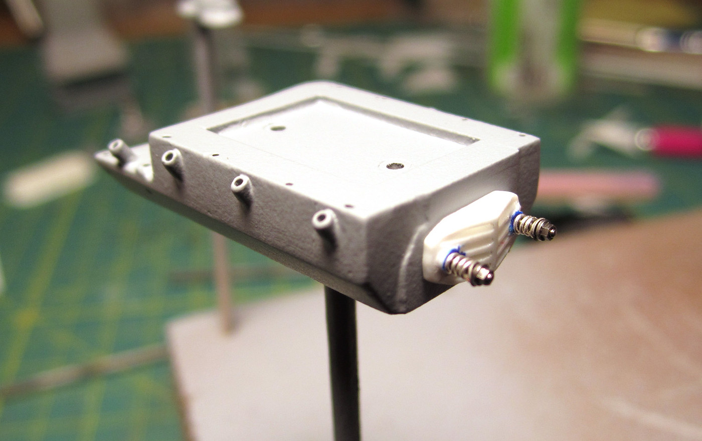

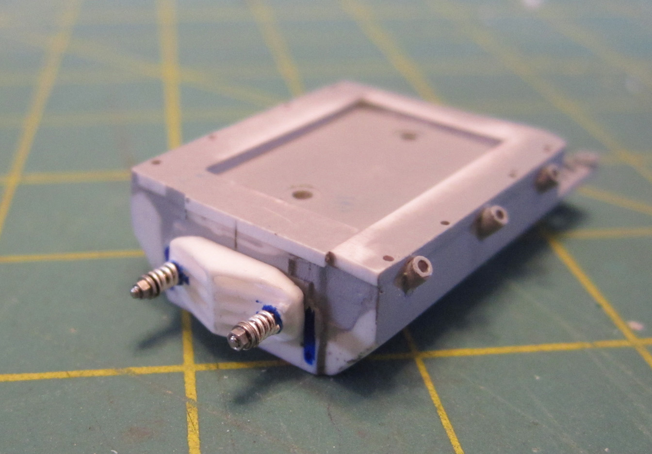

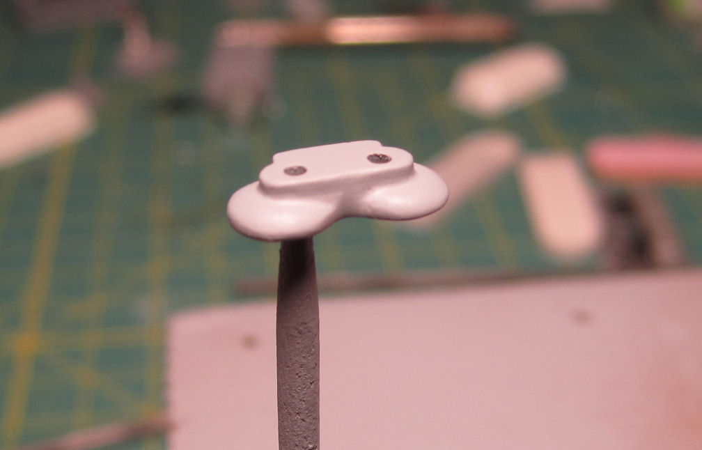

Mooneyzs Posted May 27, 2012 Author Share Posted May 27, 2012 (edited) ok another small update... All I have pretty much been working on this afternoon is the manifold..... I got the rear injector line locations redone so now they sit at the same angle as the rest of them. then it was Little things like sanding adding bondo..... spray a little primer sand some more add some more bondo...etc...lol So the manifold is now pretty much done other than I need to sand it down again just to clean some of the work up and reprimer and then it should be ready for paint... as well as I need to primer the pop off plate. I will say that I am finally happy with how it is turning out now. Here is a shot of the manifold as to where it is now.... little more sanding and primer and we should be good to go: Here is the other side: Then I worked a little on the oil filter housing. sanding down edges and all I need to do now on this is glue my bracket I made and add a final primer coat and it will be ready for some Alclad: Next up to work on is the oil pump which I will be scratch building and redoing the location for the oil lines in the oil pan. A Big thanks goes out to Dave (Comp1839) for some reference material to show me what type of oil pump and system that was used on this engine. We truly have great guys here on this board willing to help out when you ask them questions. Thank you Edited June 16, 2020 by Mooneyzs Quote Link to comment Share on other sites More sharing options...

Prostreet Posted May 28, 2012 Share Posted May 28, 2012 Manifold and burst panel look great Chris. Quote Link to comment Share on other sites More sharing options...

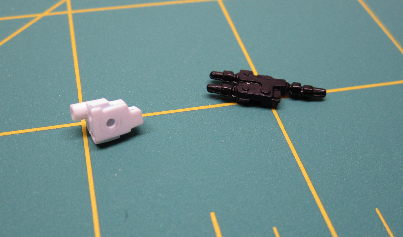

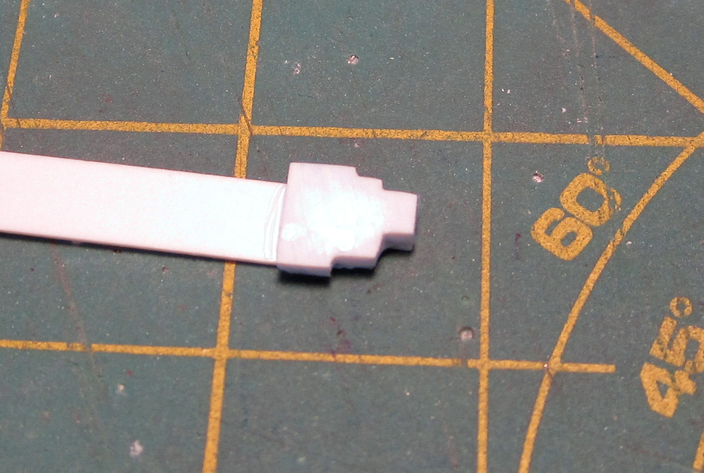

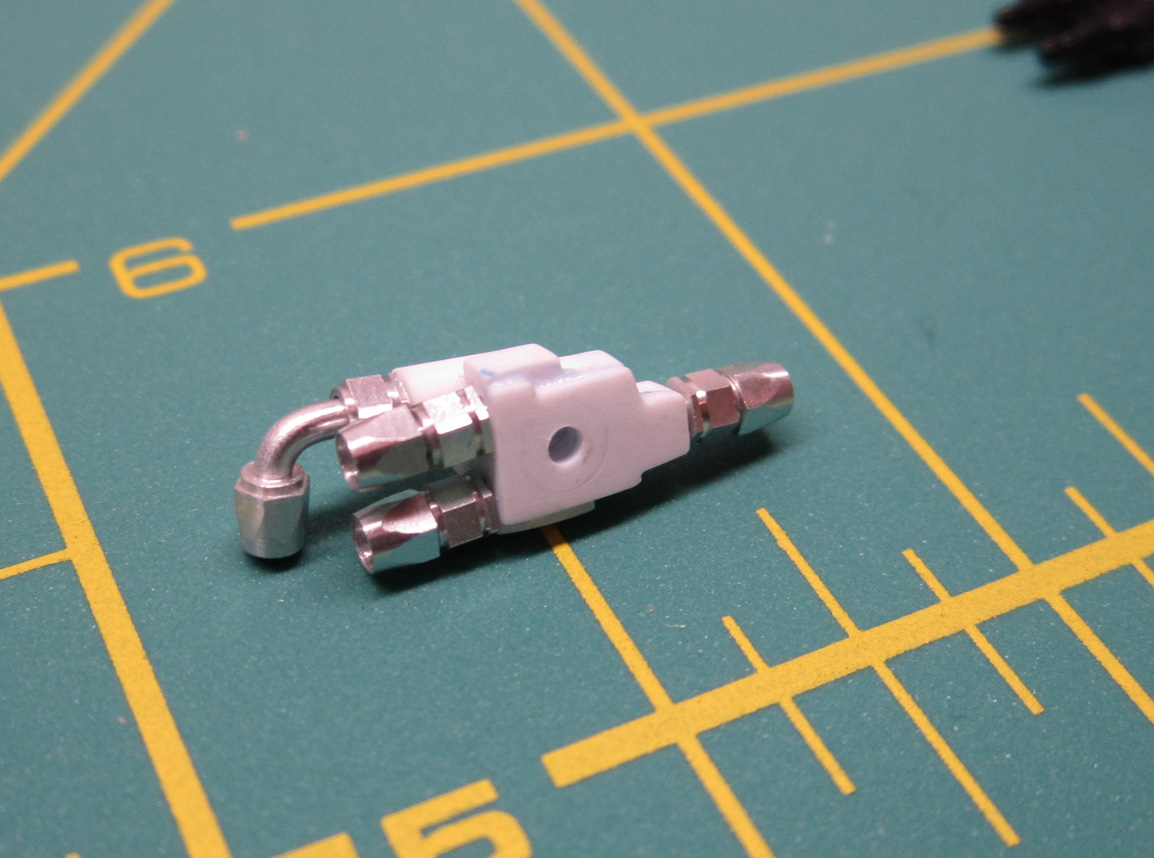

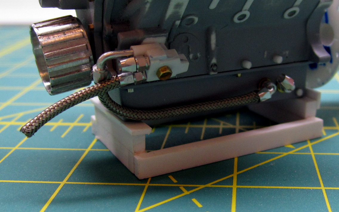

Mooneyzs Posted May 30, 2012 Author Share Posted May 30, 2012 (edited) Thanks guys..... got a little more to show you from what I worked on yesterday. I first off have to say thank you to Dave (Comp1839) once again if it wasn't for his help I wouldn't have know what type of oil pump was ran in this car. He answered a few questions for me and here is the results so far. Take note that The oil pump isn't 100% finished in the design, I have a few little details left for it. I started out by shaping some styrene from a reference pic. I measured it and scaled it down: More parts that were cut and made from styrene that will be glued together: Here is the new oil pump (left) and the oil pump that is supplied in the kit (right), Don't mind the hole in the middle of the pump, it is there for mock up purposes so I can bolt it to the block. I will actually be changing how it is mounted since I need to drill holes for smaller bolts to detail the pump out: Here it is with RB Motion fittings added to see how it will look, Fittings still need to be painted: Here it is mocked up on the block and mounted with my bolt for mock up purposes. I even cut off some small Pro Tech braided line and put in the fittings to get a feel of the look: And for a teaser here is my Hobby room's workbench area: Edited June 16, 2020 by Mooneyzs Quote Link to comment Share on other sites More sharing options...

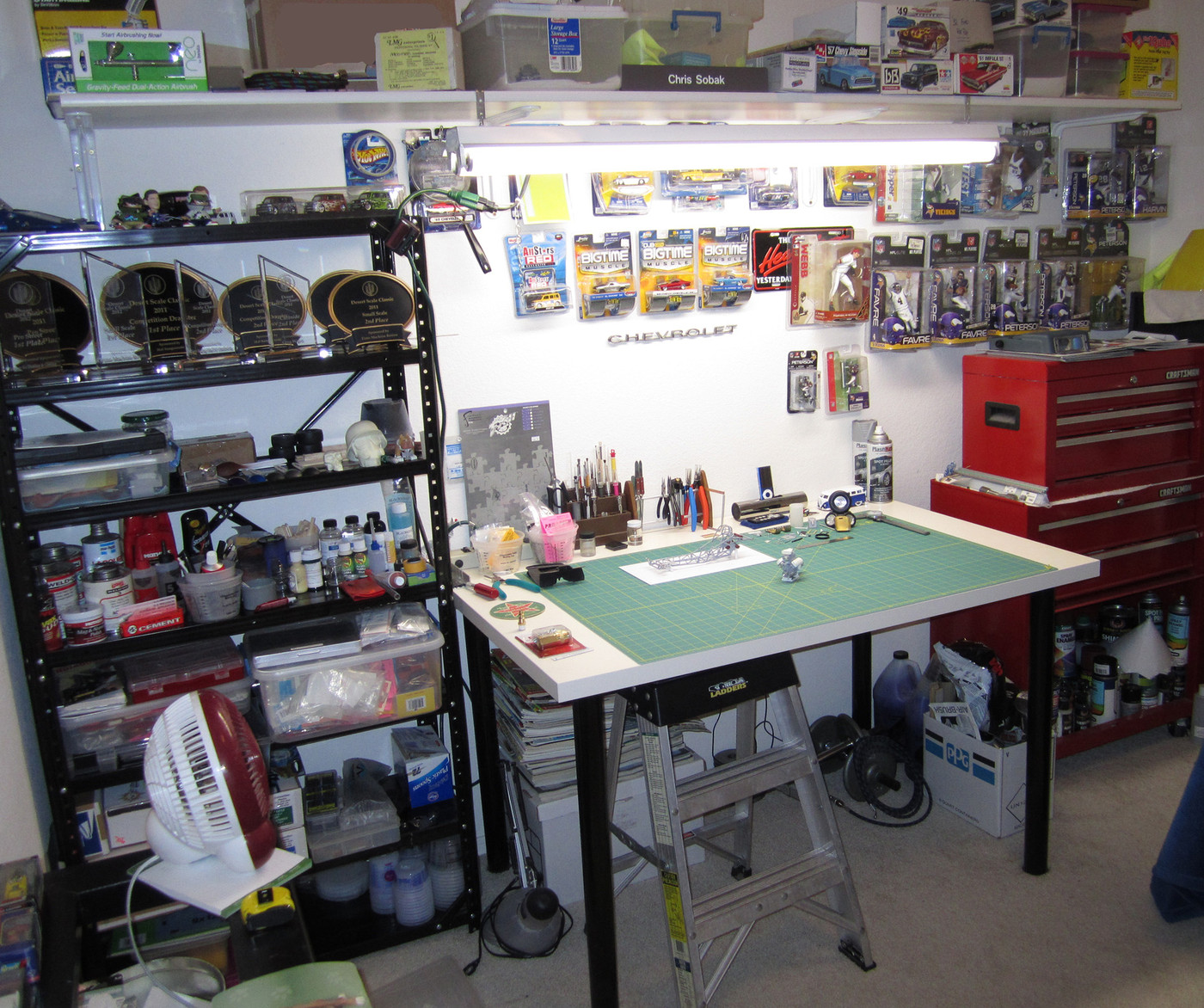

comp1839 Posted May 30, 2012 Share Posted May 30, 2012 holy smokes, chris!!!!! your pump is incredible! remind me to give you reference shots more often. well done! i love your work area. all nice and organized and clean. i feel like a pig. thanks. hehe. Quote Link to comment Share on other sites More sharing options...
pharr7226 Posted May 30, 2012 Share Posted May 30, 2012 Wow! Awesome work on the oil pump. Quote Link to comment Share on other sites More sharing options...
Mooneyzs Posted May 30, 2012 Author Share Posted May 30, 2012 Dave.... without your help I wouldn't of been able to to do this. just wait because I still have a few little details to make this oil pump complete. Thank you again for being able to tell what type of system it was and which lines went where. And as far as my work area goes... I finally gave a a good cleaning this past weekend, it was a disaster for a while...lol Rick... Thanks man!! Quote Link to comment Share on other sites More sharing options...
MODELFREAK2112 Posted May 30, 2012 Share Posted May 30, 2012 Are you a Vikings fan? Right on theres two of us. Can't wait to see this beautiful model painted and done I am sure it will be totally awesome. Great details that engine is going to be SWEET. I love the Mn. Vikings as my wife and I are from Cambridge Mn. Quote Link to comment Share on other sites More sharing options...
Danno Posted May 30, 2012 Share Posted May 30, 2012 Oil pump? Slick! Quote Link to comment Share on other sites More sharing options...
vintagedragfan Posted May 30, 2012 Share Posted May 30, 2012 beautiful work Chris! outstanding! Quote Link to comment Share on other sites More sharing options...
futurattraction Posted May 30, 2012 Share Posted May 30, 2012 Super job on the oil pump, Chris. Isn't Dave amazing? He's been helping me out sending pics and drawings of things for PE development. I just love all the details you've added to not only your OP but every cubic millimeter of your Army car... woohooo! Quote Link to comment Share on other sites More sharing options...
