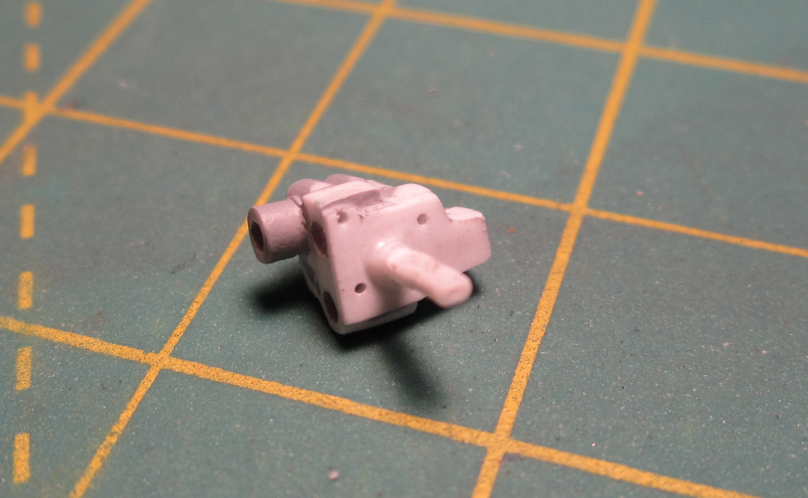

I got some initial primer on the oil pump to see some areas that I will need to add some bondo:
Another View:
Then I started by filling in the main hole I was using for mounting purposes and drill a few holes in the body for some bolts:
since these pics I have added some more bondo on this oil pump which I need to sand off and then it will be time for more primer. and hopefully after that the next thing is for it to be ready for paint. I will be getting back to the bench a little today and tomorrow so I hope to have some more pics up soon for you guys.

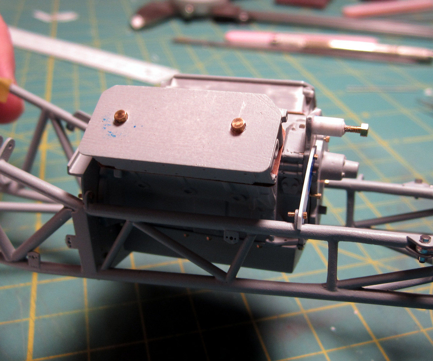

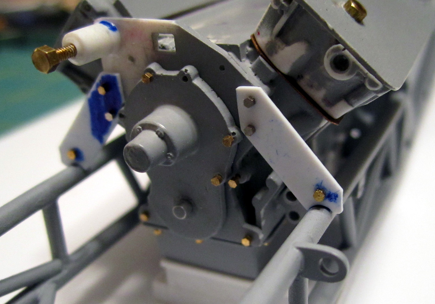

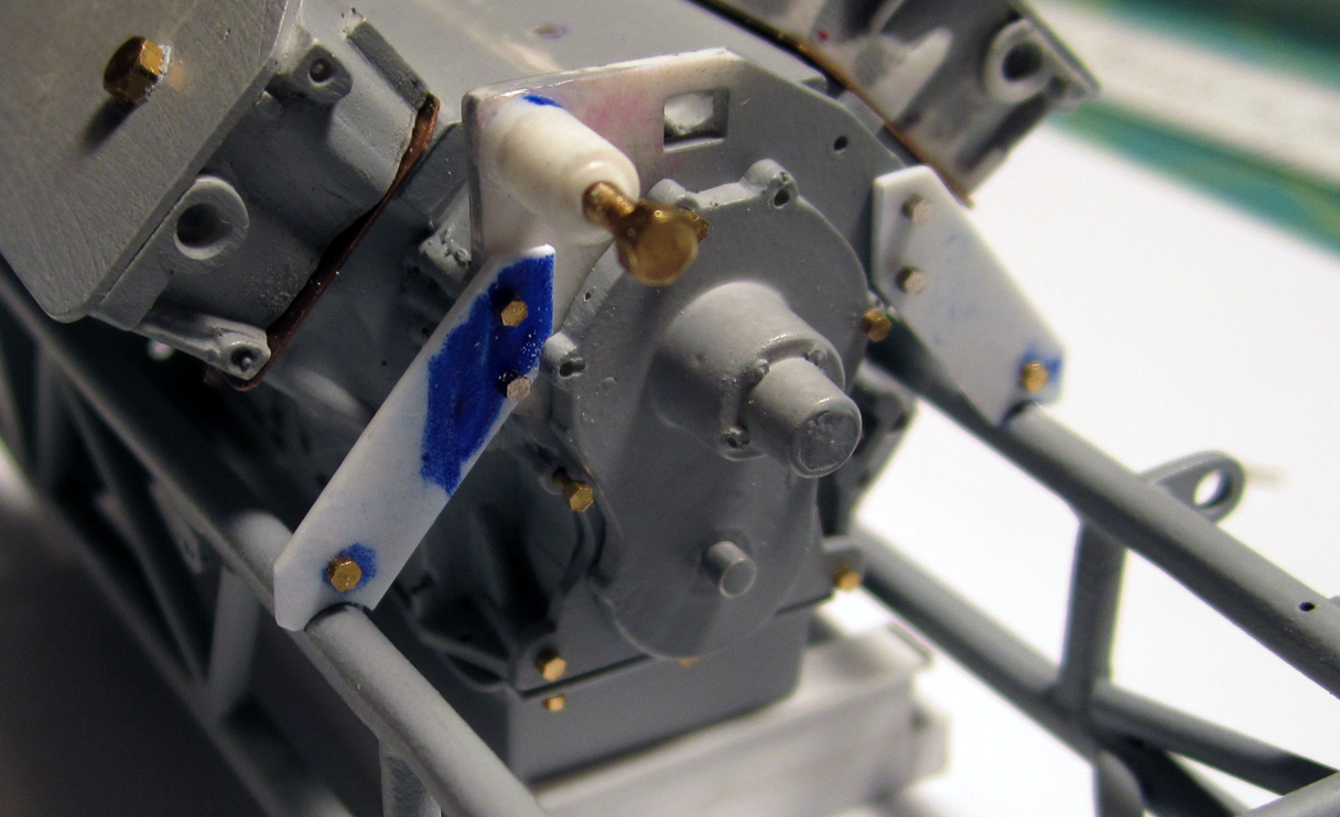

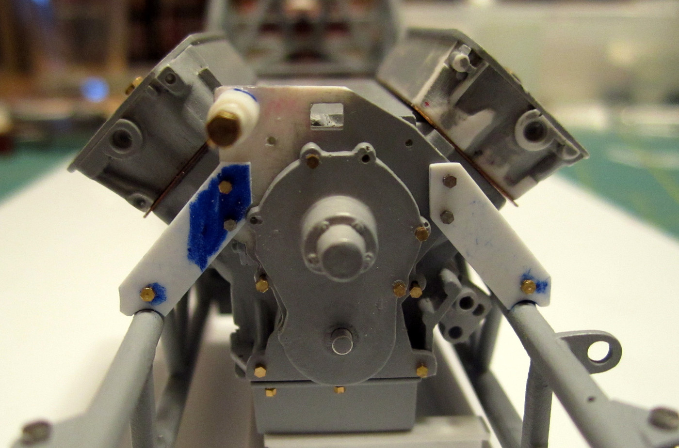

I got a little more bench time in tonight. I got the oil pump primered and little bit left to sand and then It is ready. So I focused on redoing my front motor mounts since the original ones weren't quite right. I am pretty happy with how they turned out tonight other than I just need to trim a little more off of them and then they will be good to go. But most likely I will be taking these patterns and putting them on brass strips that way the brackets will be a little stronger. Anyway here are some pics of them.....
Right Side Bracket:
Left Side Bracket:
Front View, Keep in mind that I will be trimming a little off of each side so that the bracket won't over hang the chassis so much:
Here is two views to show that I have the engine block in supported by the motor mounts with the Scale hardware bolts in place, testing that they all hold like I wanted:

Your new mounts look great, Chris. It would seem that there are two or three questions that will determine your decision as to whether or not do them in brass: 1) will the plate be more in scale if it is (~.016" thick if 1/4" in 1:1); 2) if done in brass, what does that do to affect the scale of your motor mounts as compared to all the plates you've made, which I'm sure is .016"; 3) how much work will it be to have brass ones turn as out as nicely as your styrene ones? Whatever you choose to do, I know it'll be the right choice.
Link to comment
Henry.....I am with you on this one, I think I will be happier with them made from brass.
Dave.... It sure means a lot with you saying that. Very encouraging to say the least. I have to thank you again for all of your help you have provided me so far. It has helped me to be able to make some of the parts that I have.
Scott...Thank you bud!!....I believe the plate would be a little more in scale going the brass route. Currently I made the mounts out of .020" thick evergreen styrene and the brass I was going to use is .016" thick K&S stock. I don't think it will be really hard at all to make them out of brass now and think i did all of the hard work making the ones out of plastic figuring everything out. I would take the ones I have already made Transfer drill the holes to the brass and then basically trace the plastic ones with a sharpie and then cut out with my dremel and or razor saw and then use my sanding boards and files to clean it up. Then I am thinking of using some of the Blacken-It from Micro Marks to see how well it turns the brass black. wondering if it would look a little more realistic than paint.
Brad.... Thanks buddy!!! I couldn't agree more that they would look better once trimmed. Hoping to have something more for you guys soon.
