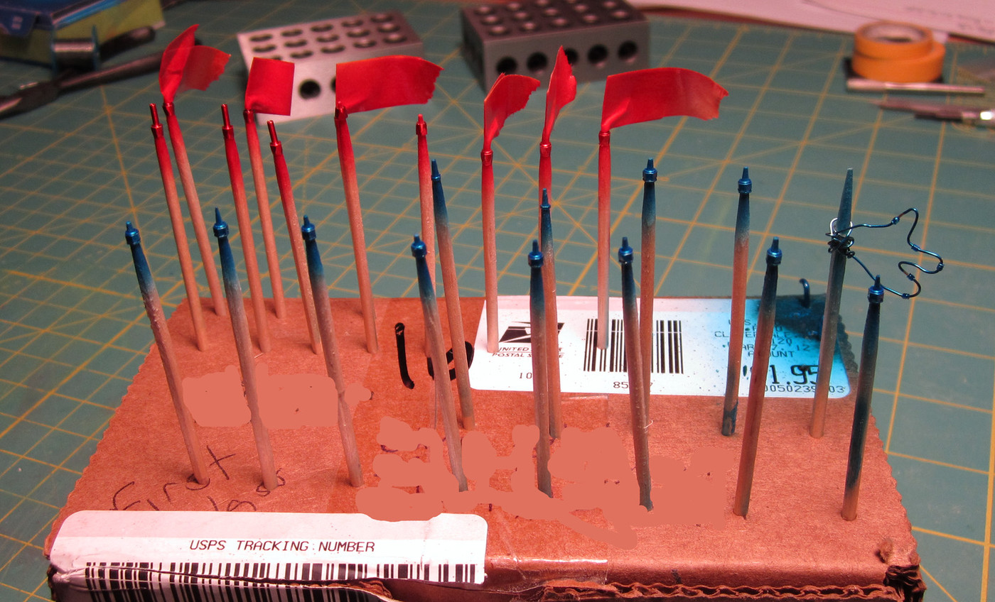

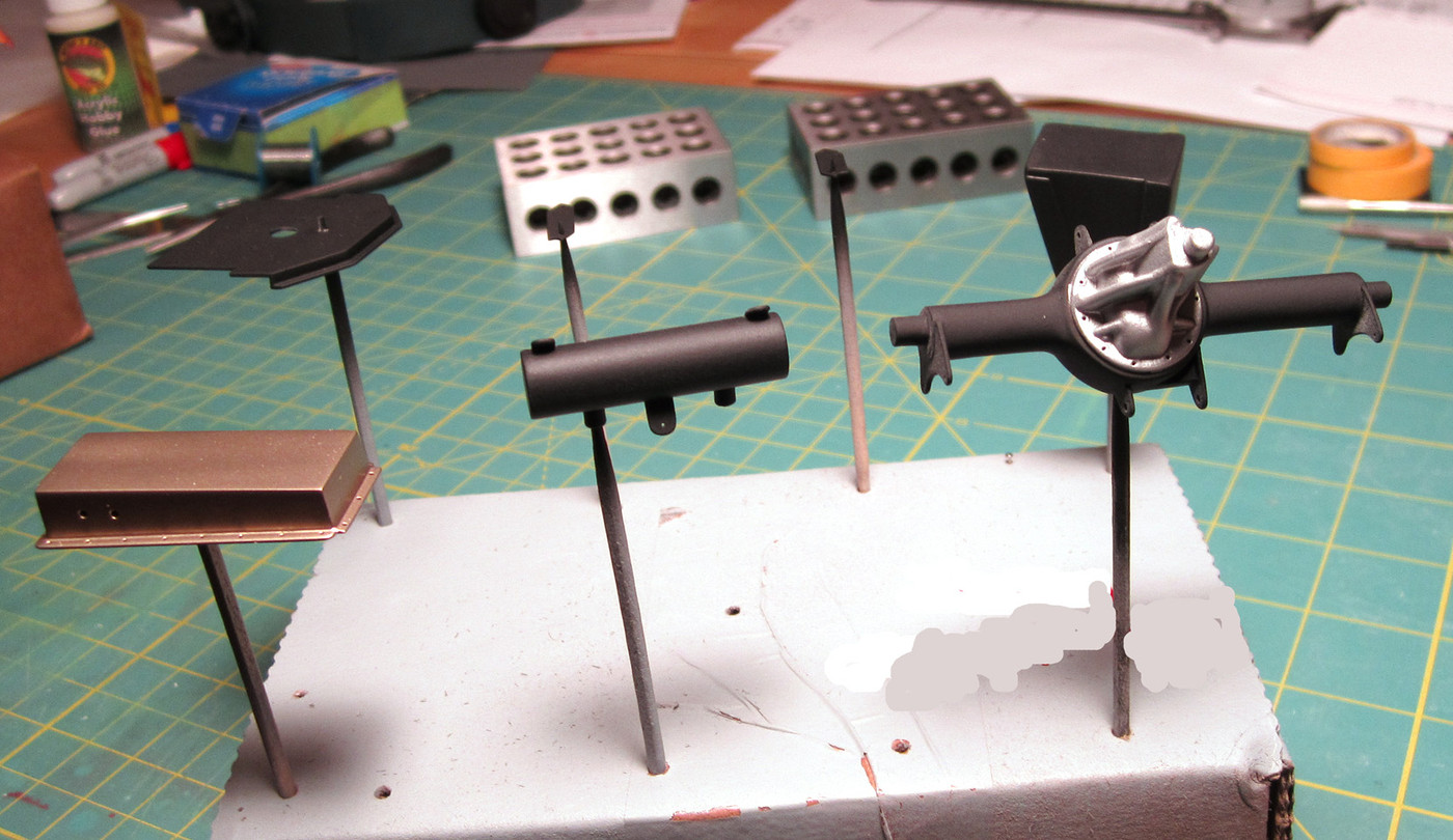

Mooneyzs Posted August 28, 2012 Author Share Posted August 28, 2012 (edited) Ok Fellas... I know this has been long awaited but I was able to get some paint on some parts yesterday and had to finish a few off tonight when I got home. I can't tell you how stoked I am to haves some parts finally painted. I am happy with how most of it turned out but One of the items that I will be redoing is the oil pan. I had some pieces of lint that got into the paint and there is a spot that you can see that some how I didn't get an even coat on the bottom so I am going to sand back down and redo but really happy spraying Alclad on it. I don't have it show but i got the calipers painted a Steel color from alclad that I am very happy with and the black and silver are house of Kolors base paints, sprayed with only base on them. and then I threw some innercoat clear with flattening agent in over them. Also I have started painting some of the RB motion fitting with tamiya Clear red and Clear blue mixed ans sprayed with my airbrush. Hope you all enjoy the pics. I will try to get one of the rear end mocked up as well and add in a bit. I also got the disks glued to the hubs and my test run for the line. Now time to bend the line out of music wire. Here is the parts I was able get sprayed other than the calipers missing from this picture: Here are the RB Motion fitting painted to color: Edited June 19, 2020 by Mooneyzs Quote Link to comment Share on other sites More sharing options...

futurattraction Posted August 28, 2012 Share Posted August 28, 2012 Everything looks super, Chris. What prep did you do on the RB fittings before spraying them? Quote Link to comment Share on other sites More sharing options...

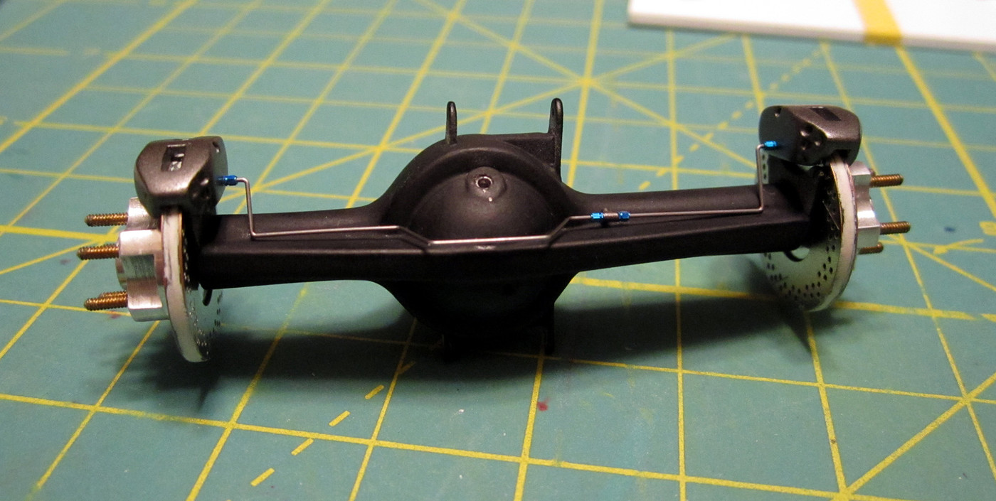

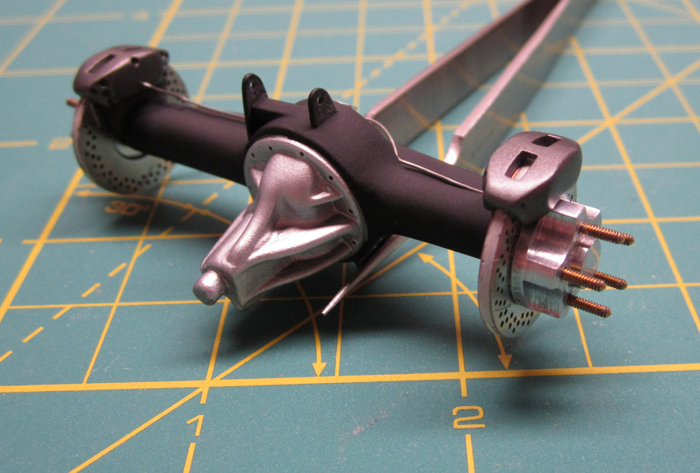

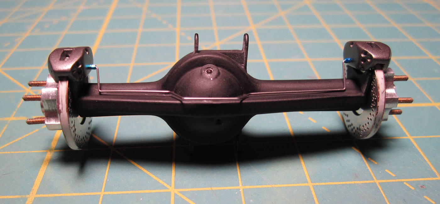

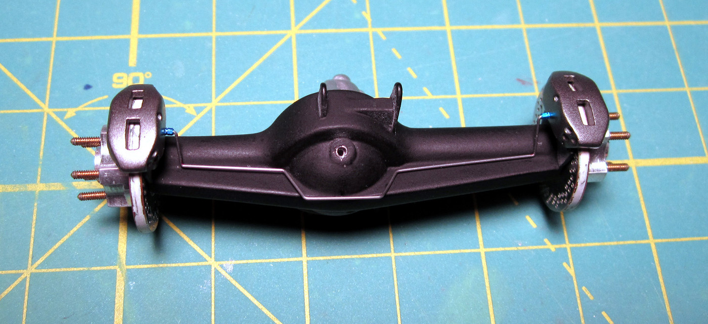

Mooneyzs Posted August 28, 2012 Author Share Posted August 28, 2012 (edited) Gabriel... Thank you man. It has definitely has a new level of excitement that's for sure. Scott.... Thank you man.To be honest. I really didn't prep the fittings any certain way. I just stuck them on tooth pics and painted away. These are all of the ones that I have been using for my mock ups. I have always had good luck just painting them. Art..... Thanks buddy. You and me both on seeing paint on them. I feel I have hit that first milestone... Ok Well I had to go mock the rear end up for a few teaser pics for all of you. Don't mind that the disk's are still not done I need to paint the edge all the way around. Also the brake line is my mocked up line and i will be bending one out of music wire since I want this one to be nice and straight and not wire off a spool. I did see a few blemishes in the rear end where I may go ahead and repaint it again but we will see. but then again knowing me. If I don't redo it I know it will eat at me... haha Front View: Rear View: Edited June 19, 2020 by Mooneyzs Quote Link to comment Share on other sites More sharing options...

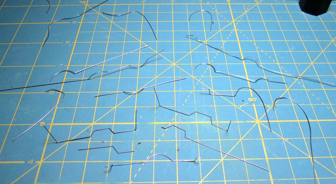

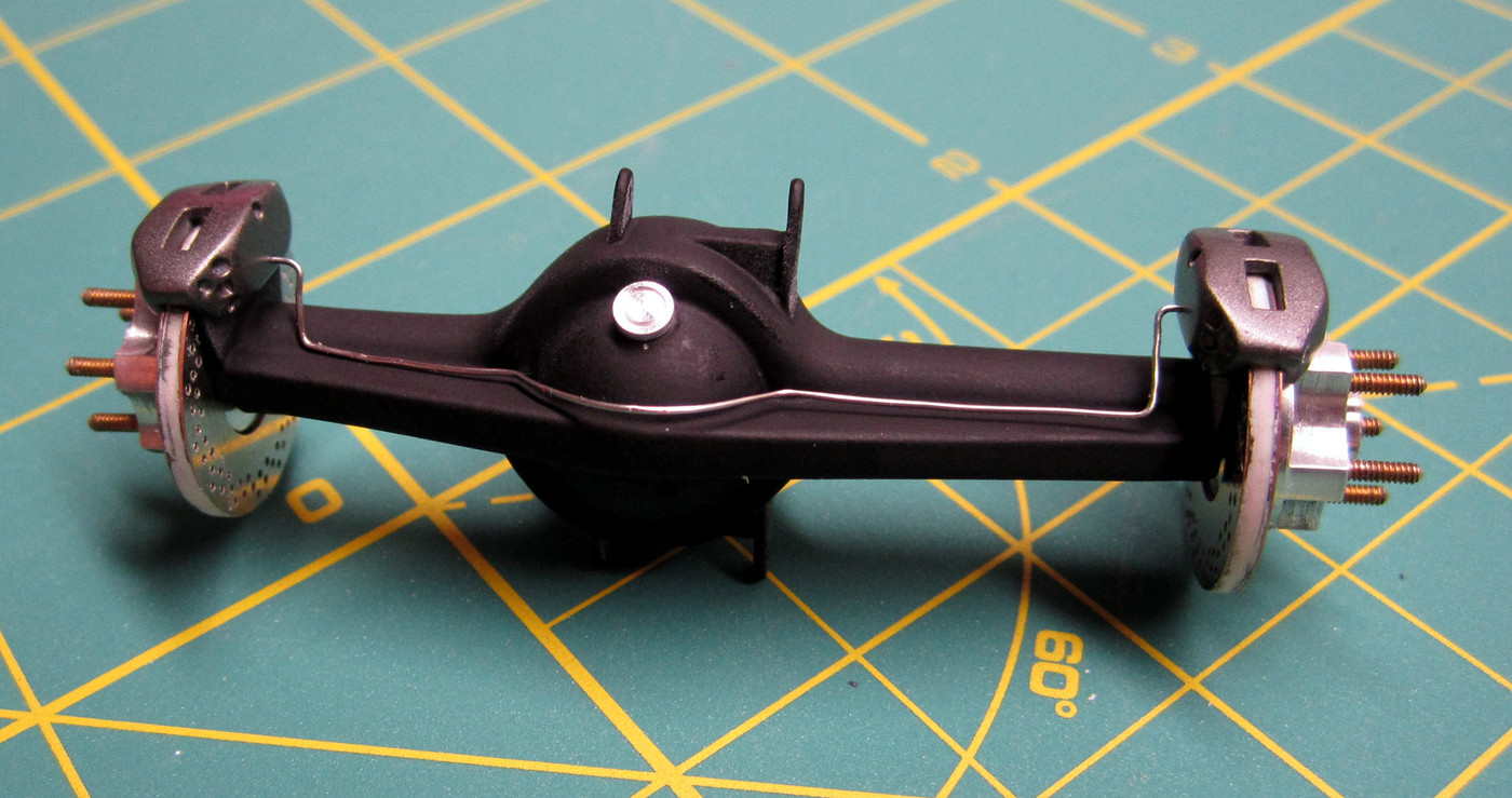

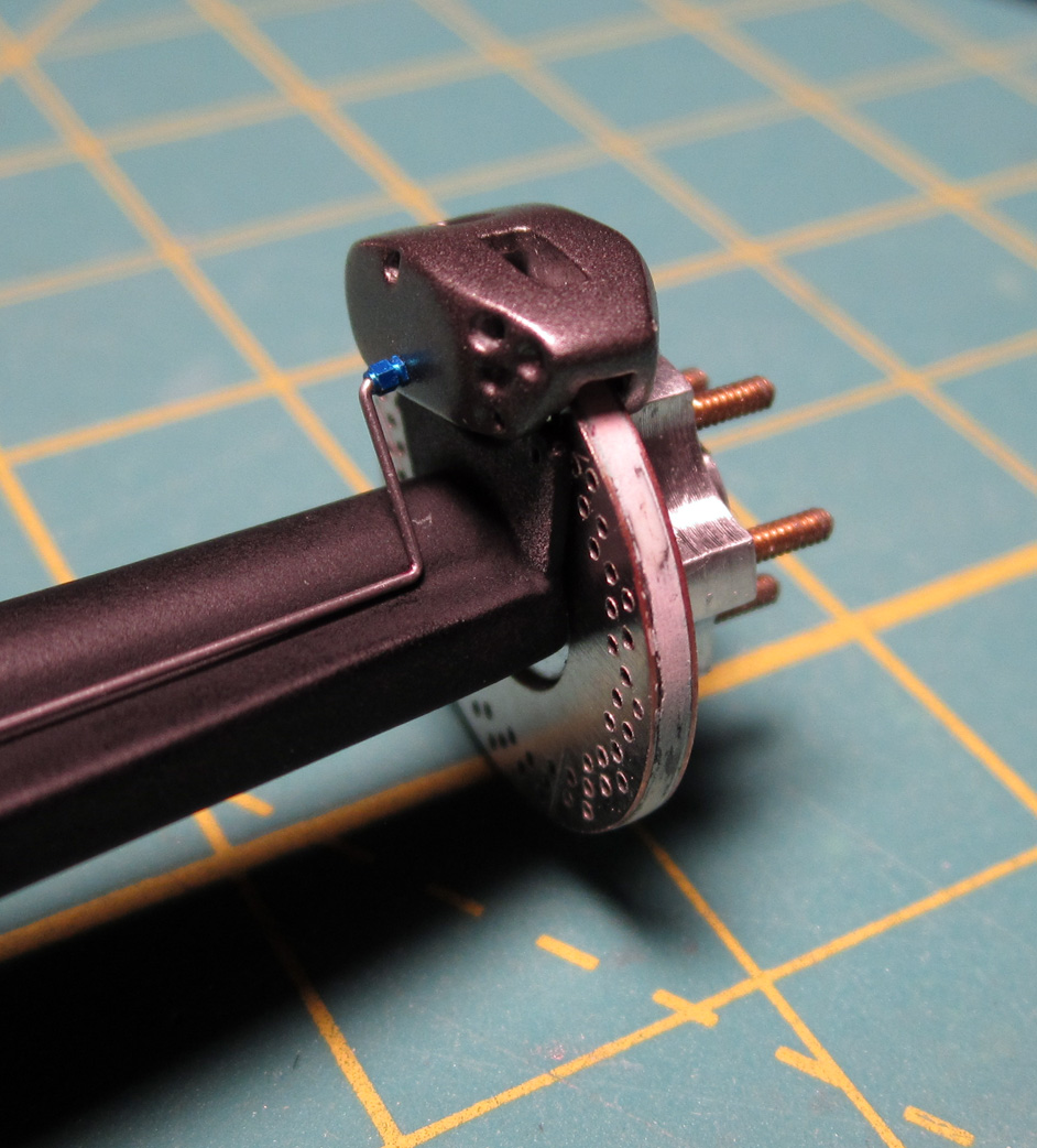

Mooneyzs Posted September 11, 2012 Author Share Posted September 11, 2012 (edited) Hey Everyone!! I wanted to say thanks again for all of the kind words. Sorry I have been away from this build for about 2 weeks and haven't had time to work on it. I finally sat down for a bit tonight and worked more on my rear brake lines. I worked on this for probably 3 hours or more tonight bending and re-bending wire only to re-bend once again . I finally got an end result that I am happy with. So I started out with .015" Steel Music wire as well as .015" guitar string. The guitar string had more of a chrome like finish since it had a plating on it and the bare steel music wire seemed to look a little more like Stainless tubing. Let me share with you a little of this adventure tonight. In my first pic you will see that I went thru quite a few trials before I got something to work LOL. In this first pic was my many attempts at bending this wire in one shot. I first started with the idea of having the tubing bend in a half circle around the back part of the rear end only to find that I was not able to get a great half bend. So I then changed it up in bends with straight sections: Here is what I ended up with after I was happy and tired of redoing this line: Here is a view from the back: Up close Left side: Up Close right side: Now the kicker to all of this....After I had this done I didn't pay attention and then when I was starting to take pics I realized that I forgot to put my T-Fitting along with the RB-Motion fittings on before I made my bends on the right hand side. So now I am contemplating on what do do. Either. I re-bend a whole new brake line again or do I cut this brake line and put my fittings where I cut the line. Which would you choose to do?? Thanks guys. Hoping to have more for you Tomorrow. Edited June 19, 2020 by Mooneyzs Quote Link to comment Share on other sites More sharing options...
vintagedragfan Posted September 11, 2012 Share Posted September 11, 2012 DOH! I do that a lot Chris! nothing like redoing something you just spent an hour making, lol I would think you could just cut it and add the tee, I would at least try it first! Quote Link to comment Share on other sites More sharing options...
MoparWoman Jamie Posted September 11, 2012 Share Posted September 11, 2012 I would just mark out on the line how big the "T" would be and how far in you want the lines to go in the "T" fitting to. Then cut the center piece out and fit the T fitting into place. Plus can i ask, what about the cliper bleeders? I don't see any. Quote Link to comment Share on other sites More sharing options...

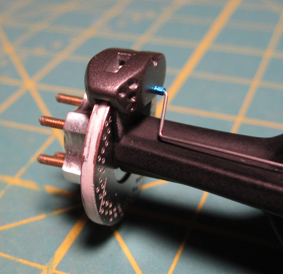

Mooneyzs Posted September 13, 2012 Author Share Posted September 13, 2012 (edited) Bill... Practice makes perfect right?? LOL Jim... You know I still need to add caliper bleeders to it. I need to check with Robert at RB motion. He has them in 1/12, 1/24 and 1/8th scale but none 1/16th scale. I was thinking of checking how big the 1/12 and 1/24 are see if i could possibly use them but If I can get Robert to make them in 1/16th I will go that route Well Fellas.... I am stoked to say that I have redone my brake line and happy I re-bent it rather than cut and spliced the T-fitting in it. Here is a quick pic and hoping to get some more done on it tonight. Edited June 19, 2020 by Mooneyzs Quote Link to comment Share on other sites More sharing options...
