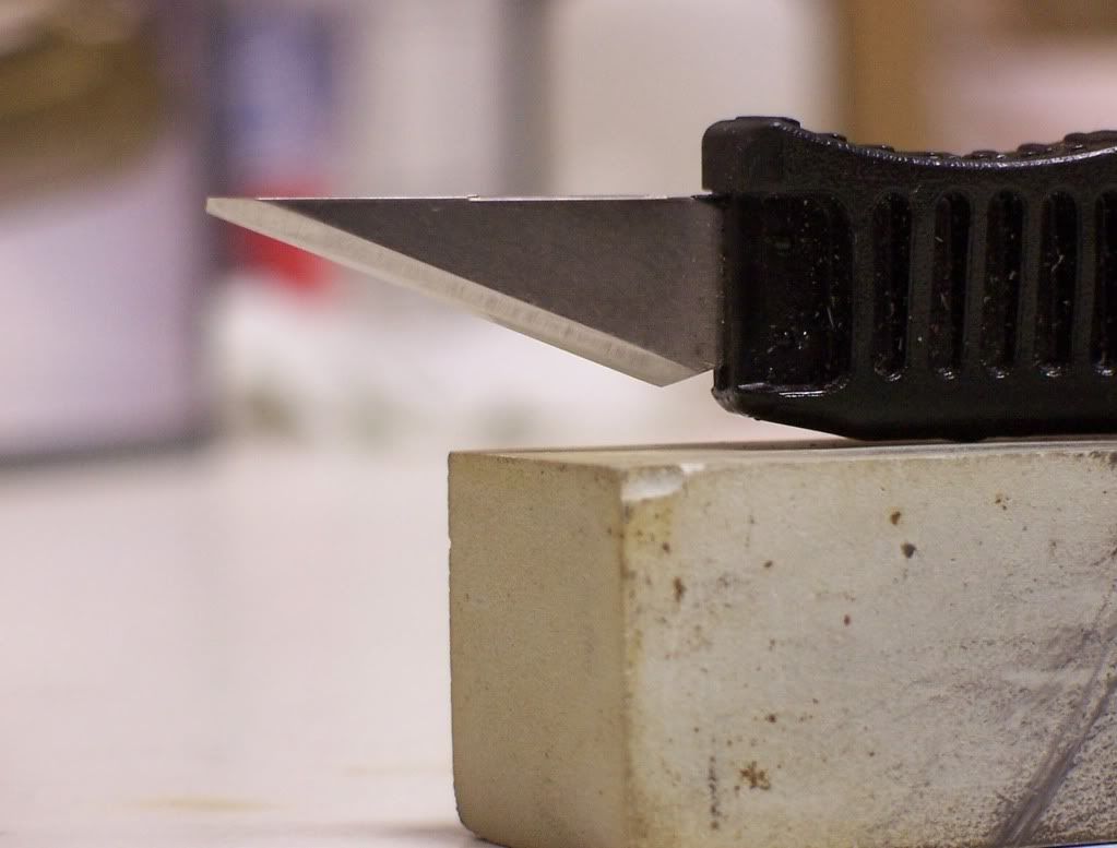

Iron Fist Posted April 20, 2011 Share Posted April 20, 2011 (edited) I use a sharpening stone (below blade), this testors blade has completed five builds four of which had BMF and I have two build on the bench; and still cuts like butter. Edited April 20, 2011 by Iron Fist Quote Link to comment Share on other sites More sharing options...

Cato Posted May 3, 2011 Share Posted May 3, 2011 I use a sharpening stone (below blade), this testors blade has completed five builds four of which had BMF and I have two build on the bench; and still cuts like butter. How do you get the correct angle on the blade edge? Quote Link to comment Share on other sites More sharing options...

Iron Fist Posted May 4, 2011 Share Posted May 4, 2011 How do you get the correct angle on the blade edge? Practice, and don't let the blades get too worn out that way the edge angle is still there to guide you, also use a fine stone as you don't need to remove much material to get the sharp edge back. Quote Link to comment Share on other sites More sharing options...
Cato Posted May 4, 2011 Share Posted May 4, 2011 Practice, and don't let the blades get too worn out that way the edge angle is still there to guide you, also use a fine stone as you don't need to remove much material to get the sharp edge back. Thanks Justin-will do. Quote Link to comment Share on other sites More sharing options...
