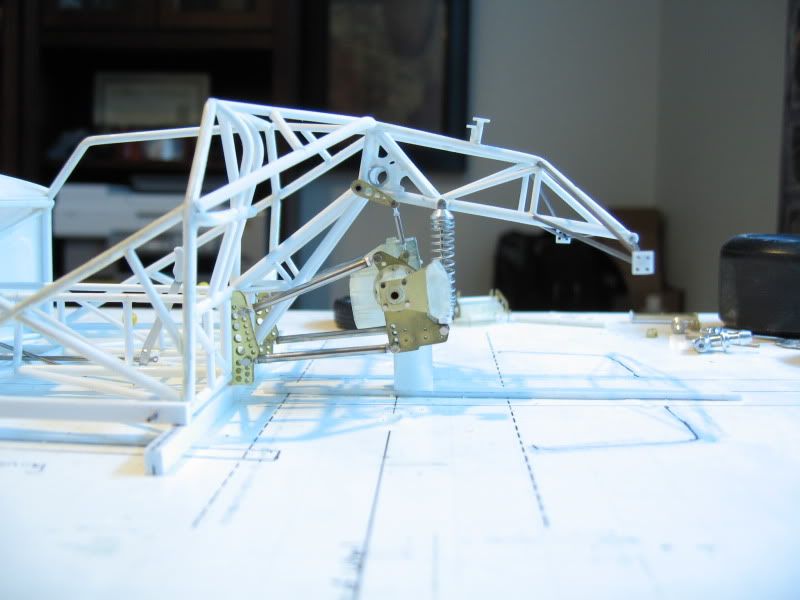

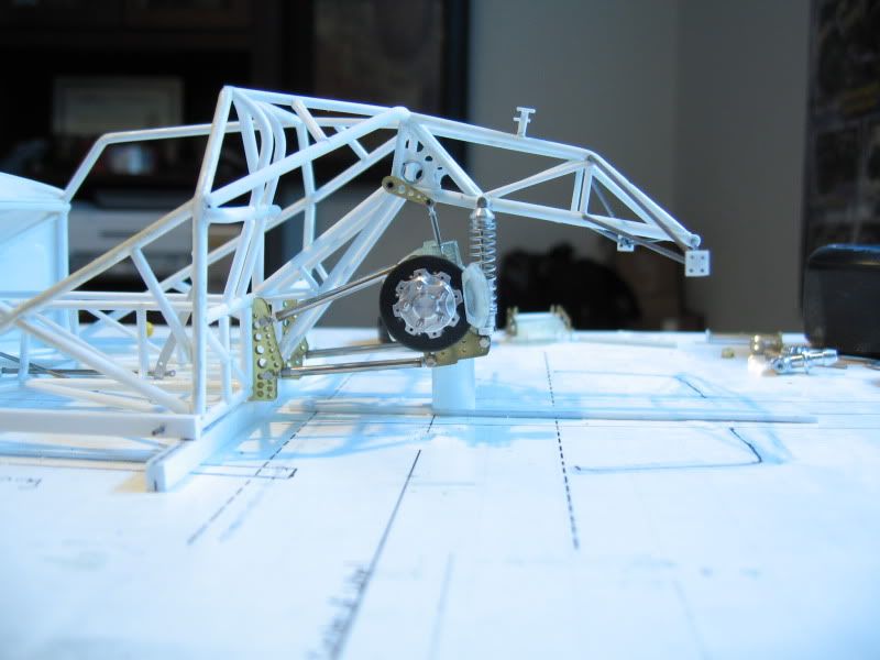

Well, I thought I would resurrect this build from the DEAD and show a small update... :) With the Heartland Nationals next weekend, I would like to have it standing on its own two legs (4 legs in this case) so I can at least set it in the "Unfinished" category.
So needless to say the wafer thin 3D printed part that comes from TDR to mount the rear Caliper to is just way to flimsy, so I had to do something about that. Plus the kicker was that it wasn't long enough to work in my application to fit over my Hub and onto the Carbon rotor. So I got out my brass and begin to draw a pattern out and and today was the day with my second attempt and I like the final result. Now I just need to duplicate it for the other side.
On with the show as they say!!
Once I complete the other side I can move to the front and begin figuring out what I need to do with that mess. :lol:
Thanks for looking in, at my slow as molasses progress. LOL
Link to comment
Thanks Dave for pointing that out because I actually hadn't tried the wheel on the assembly at the time. The only thing I had to do was slightly massage the outer part of the caliper and the wheel fits right on the assembly with no binding or friction. I would assume that in 1:1, it would an 1" or 2" away from the inner wheel or would it be much more than that?
The rotor when measured with the calipers says 0.7555", so that works out to be 12.08" somewhere in the ball park of a 12" rotor then?
Link to comment
yes, the rotor dia. is too large. also, the caliper sits out too far on the rotor. getting these two details correct would have alleviated the un-nessecary grinding on the outside of the caliper.
Well that is a shame, if the rotors need to be smaller. A couple things need to be changed then on the turned parts. Right now the way it sits the Caliper is very close to the mounting points on the Hub for the rotor. If the rotor was turned down to a smaller diameter then the caliper will hit on the rotor the way it is made. :(
A suggestion for Jim (MicroNitro) next time or going forward might be to off set the rotor mounting so the Hub sits into it deeper on the face side. This way the mounting points would sit flush with the rotor face, then the caliper when it turns wouldn't hit the hub as it rotates.
