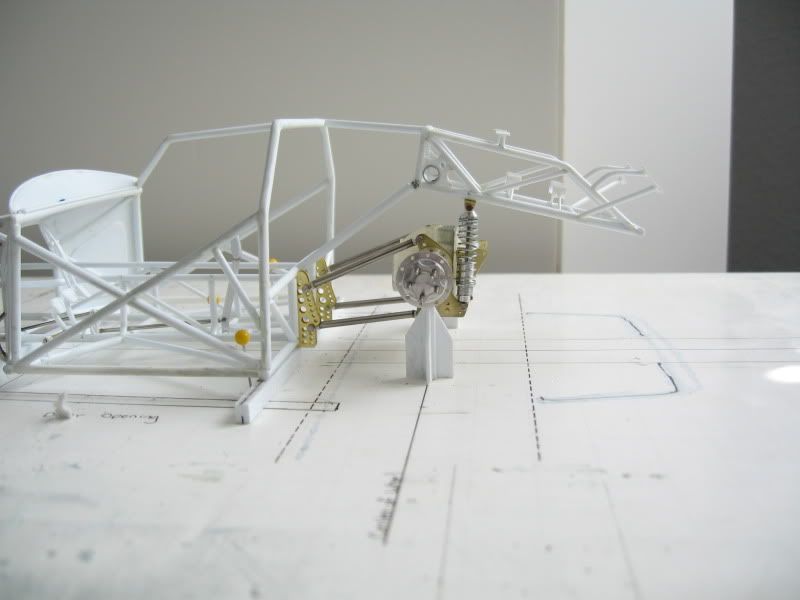

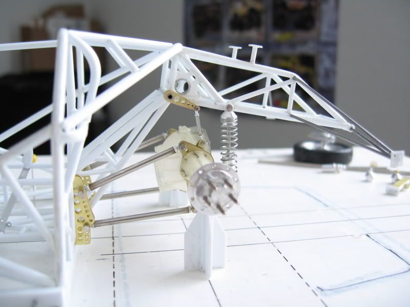

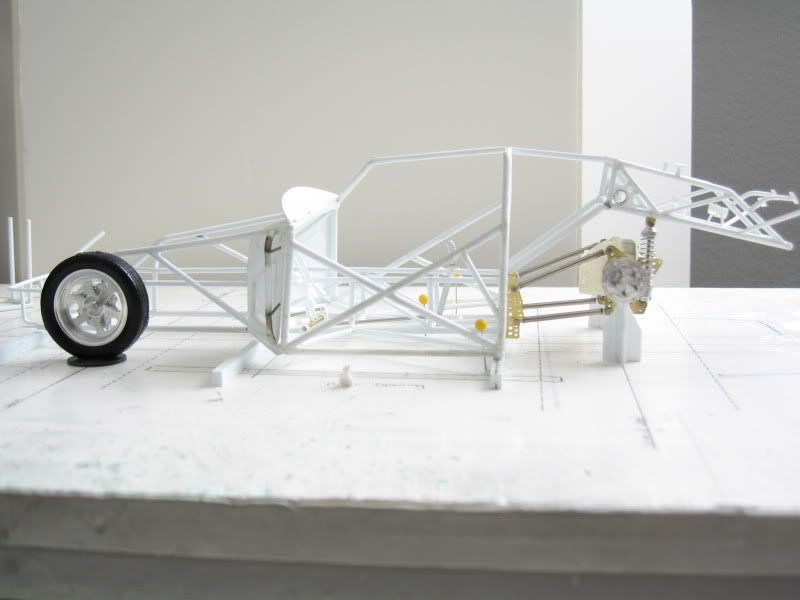

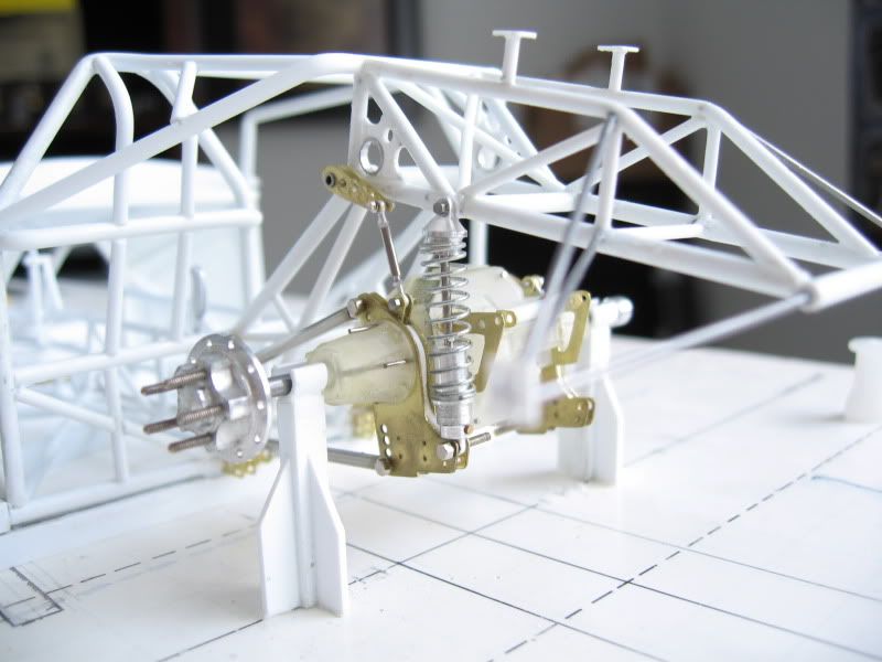

eviltwincustoms Posted April 16, 2012 Author Share Posted April 16, 2012 Just a small update for everyone, after redoing the rear chassis and the funny car cage I started working on the Anti sway bar linkage. I have one side mocked up and will leave the other side off so I can get the tube out for paint and clear. I mocked up my Brass arms after the Quartermax Pro Series Anti-sway bar kit they sell. Thanks to Dirtmodeler's brass 4 link brackets, I was able to modify them to work for what I needed. Then the usual RB Motion Rod ends and stainless tubing and this is what I ended up with. Quote Link to comment Share on other sites More sharing options...
ClayK Posted April 16, 2012 Share Posted April 16, 2012 Very nice Bart. Looks like it's going together pretty well. What size of S.S. tubing are you using for your 4 bar links? Clay Quote Link to comment Share on other sites More sharing options...

eviltwincustoms Posted April 16, 2012 Author Share Posted April 16, 2012 Very nice Bart. Looks like it's going together pretty well. What size of S.S. tubing are you using for your 4 bar links? Clay Thanks Clay for the props! The tubing I am using is from my old Slot Car Drag racing days.... I had some left over 0.072 and 0.082, so I used both since they are really close to the 1 1/4" and the 1 3/8" tubing I am seeing in Quartermax Racing catalog for the Heavy Duty Pro 4link bar kit. Quote Link to comment Share on other sites More sharing options...
