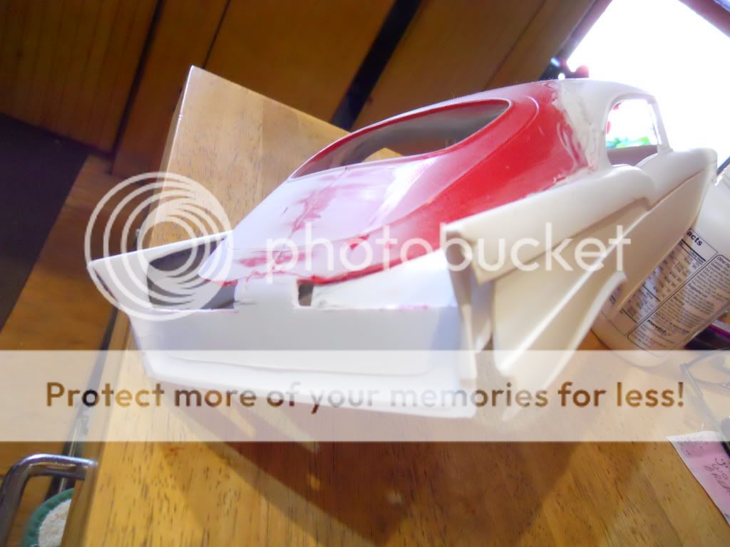

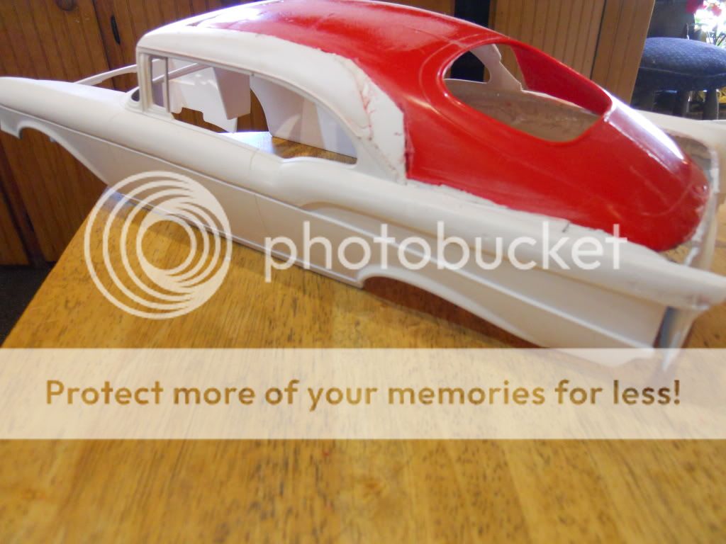

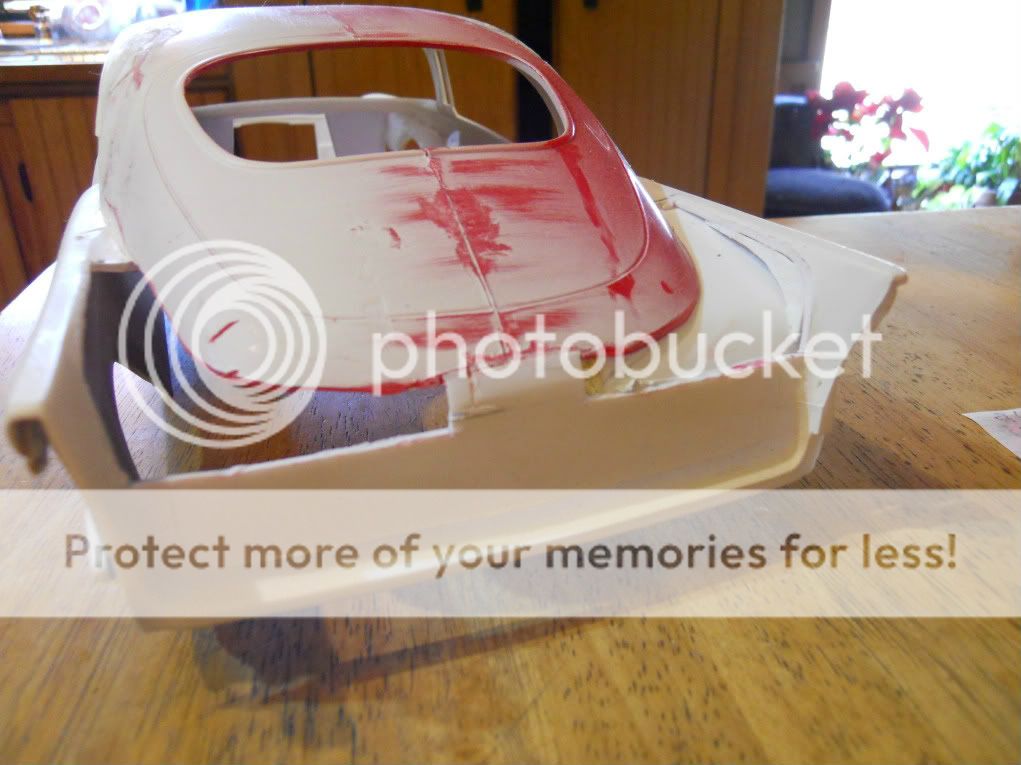

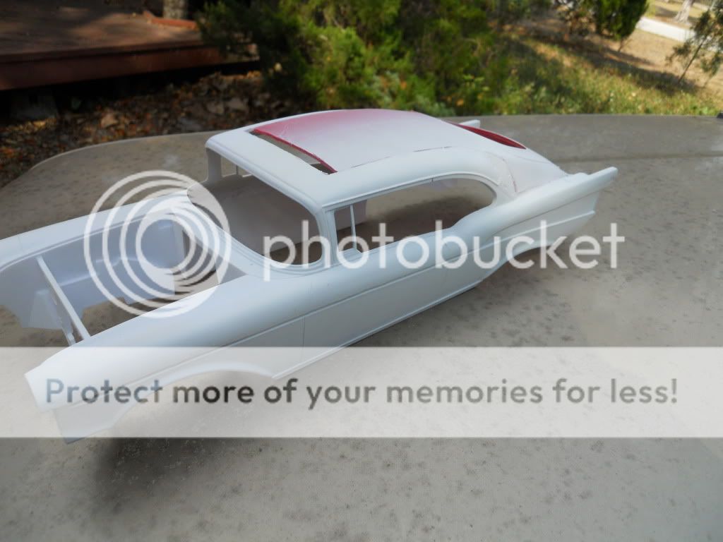

GrandpaMcGurk Posted February 2, 2012 Author Posted February 2, 2012 Here's a few more pics and a brief explaination of how I'm doing it. I had to cut the Jag top in half again to remove more material "measure twice & cut once" never seems to work out for me. I also cut some sections away that weren't conforming to the overall shape I am after. I then shaped and welded in some filler pieces from the inside

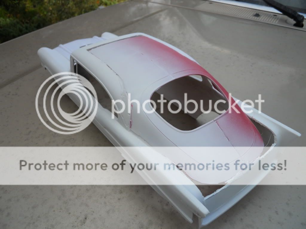

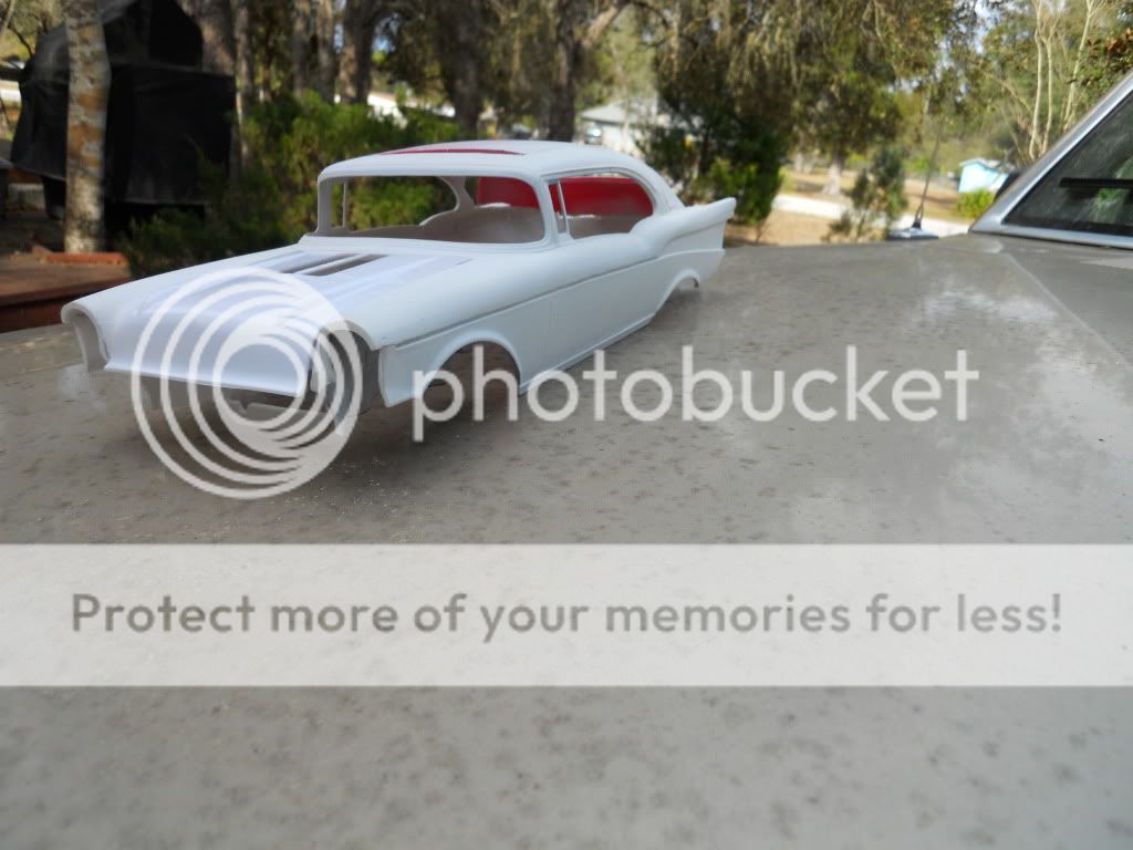

GrandpaMcGurk Posted February 3, 2012 Author Posted February 3, 2012 I shot some white primer on it to get a better overall look see.....it's kinda hard to visualize with that contrast between the red and white plastic. I've got some plastic scraps dissolving in solvent, when it softens to the point where I can spread it like a thick paste I'll use it to fill the low spots and seams in the outer shell to keep it as bondo free as possible. From this view it almost looks stock. Still have a lot of shaping to do back here...lots of compound curves.

Casey Posted February 3, 2012 Posted February 3, 2012 It'll be interesting to see how this progresses. I like the wedge sectioning you've done, but I fear the stock greenhouse is going to look too tall now, especially with the added bulge of the Jaguar roof. Then again as long as it doesn't look like Chezoom, it should look great. Nice technique on the plastic welding, too.
GrandpaMcGurk Posted February 3, 2012 Author Posted February 3, 2012 Thumbs up, bud! Good to see you're still wrecking perfectly good plastic. Yeah Glu...I don't know how else to act. If I can't bend, twist, melt and torture the plastic there is no joy in it for me. When I open the box to a new model the first thing I do is throw away the instructions......close the box and put it in the holding tank until it starts talking to me. Yes, I've been known to carry on some rather lengthy conversations with model cars...my wife finds it rather disturbing.
GrandpaMcGurk Posted February 3, 2012 Author Posted February 3, 2012 It'll be interesting to see how this progresses. I like the wedge sectioning you've done, but I fear the stock greenhouse is going to look too tall now, especially with the added bulge of the Jaguar roof. Then again as long as it doesn't look like Chezoom, it should look great. Nice technique on the plastic welding, too. Thanks Casey, my thinking is the same as yours......the green house (because of the sectioning) looks a bit tall in the saddle at the moment. I will be dropping the lid, probably a bit more in the front than the rear to follow through with the tapered sectioning....in other words a slightly nose down attitude. I can't chop it until the top is back in one piece as I'll have to stretch it some and add a section, it would be very difficult to do if it were in pieces. No worries.........if it looks like Boyd's Chezoom when I'm done....it'll get tossed in the parts box and cannibalized as it won't work for me!

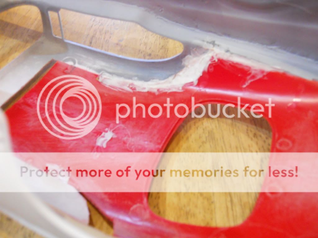

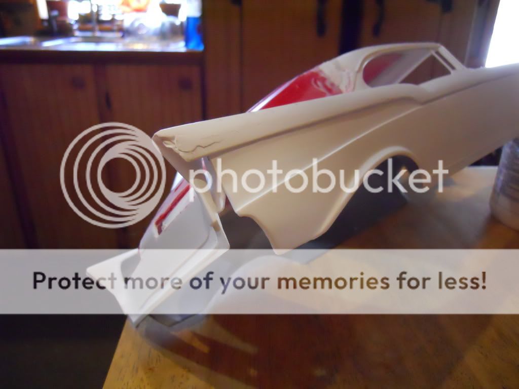

GrandpaMcGurk Posted February 3, 2012 Author Posted February 3, 2012 I started using some of the dissolved plastic filler, keep in mind (if you try this) that the filler is hot and can soften the surrounding plastic causing sags, low spots and all manner of strange things. I clamp everything in position (you can never have enough clamps) as it will take a few days for the plastic to completely gas out and harden before sanding. Yes, I have bonded clamps to a model before...LOL. While I'm waiting I'll start modifying the front inner fender wells, firewall etc. to make up for the sectioning..... they won't fit in the new profile OB.
David G. Posted February 4, 2012 Posted February 4, 2012 The new roofline reminds me more of a car from the mid 1940's than the late 1950's. A very interesting fusion. David G.

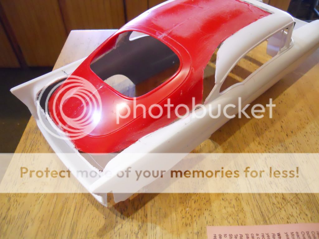

GrandpaMcGurk Posted February 4, 2012 Author Posted February 4, 2012 Yeah, David from one angle it'll look 40ish from another it might remind someone of a Batmobile and so on.......that's what I liked most about the full & radical customs of the 60s & 70's.......there were no rules, builders were able to let their imaginations run wild. As you can see in the photos the hatch sits quite a bit lower than the top of Chevy trunk lid did. I didn't want to run the hump all the way down to the bumper....that really would have looked (at least to me) 40ish, so I stopped it part way down. I've added an inner skin to give myself something stable to build on. Now I can contour the seams and get the overall look flowing.
