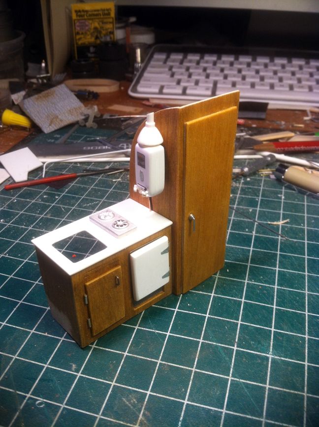

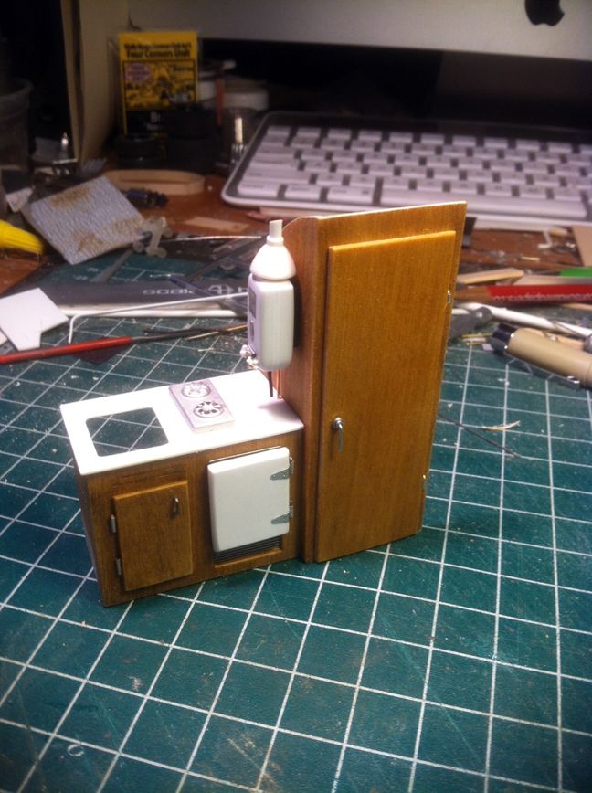

gasser59 Posted March 9, 2015 Author Share Posted March 9, 2015 (edited) Ok gents...here's some the results from the weekend's considerable bench time. Most of the time was spent on the water heater and now its plumbed with a gas line. The water line will come in from the backside of the wall in the bathroom. I glued the galley cabinet to the bathroom walls so its now one piece. Had a bit of fitment issues and had to sand the curvature of the bathroom wall. The bathroom door got a piece of thin Evergreen stock like the rest of the bathroom interior. I'm still working on a threshold for the door since it has a drain pan and had to be stepped over to get into the bathroom. I also worked on the from hubcaps by drilling out the centers for the 4WD hub centers which extends through the hubcap. Those had to be made too. I screwed one of them up and had to use some bondo to fix it. Of course that had to dry before sanding, sealing and hitting it with some light grey primer. They got hit with a coat of white paint this morning. Here's a couple of pictures of the galley/bathroom cabinet. The door handle actually works. Thanks so much for your interest. I'm closing in on the DSC deadline of April 11th. Edited March 9, 2015 by gasser59 Quote Link to comment Share on other sites More sharing options...

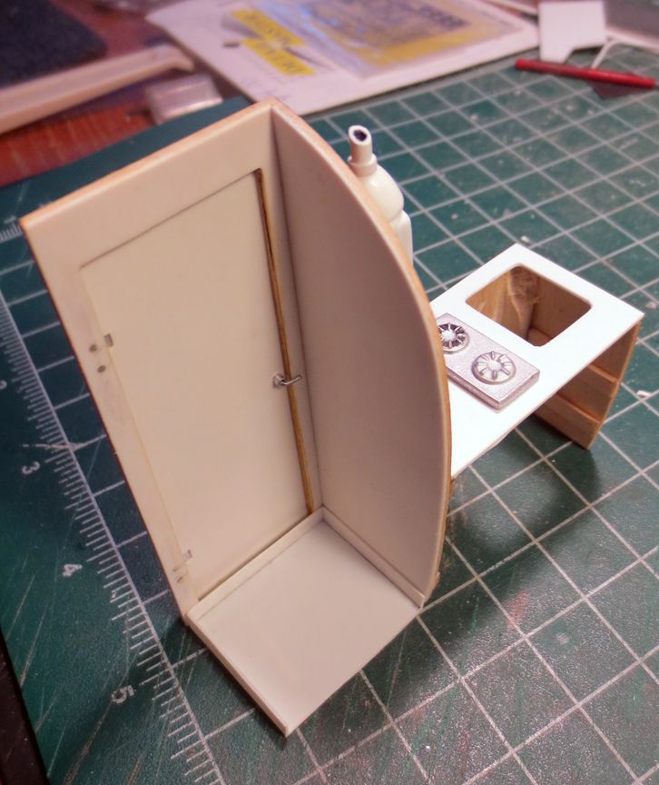

gasser59 Posted March 10, 2015 Author Share Posted March 10, 2015 (edited) Thanks so much Chris. Really appreciate you following along. Here's a shot of the inside of the bathroom walls along with the functioning door latch in the closed position. There's a gap where the door meets the shower pan and I hope to have that taken care of this evening. Hopefully more bench time tonight. I've really got to getting some aluminum on the walls, both interior and exterior. Edited March 10, 2015 by gasser59 Quote Link to comment Share on other sites More sharing options...

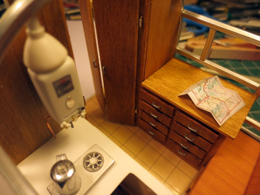

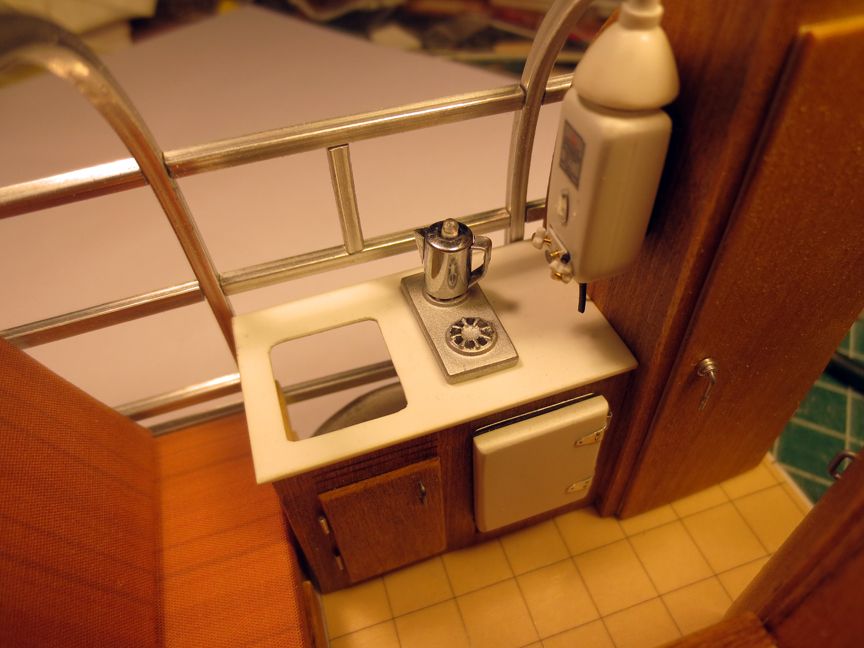

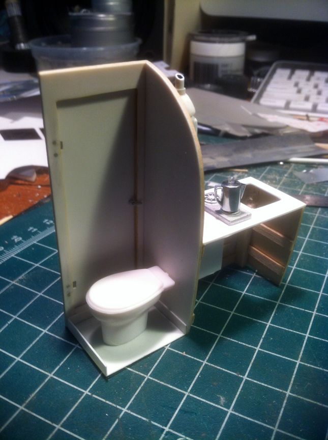

gasser59 Posted March 11, 2015 Author Share Posted March 11, 2015 Last night I was able to get the drawer handles along with the cabinet door handles made and installed. Also, I just had to make a coffee pot for the back burner. Its made from pen parts and some printing plate. The map is one I had laying around back from the teardrop build. I'll have a few Africa maps in there eventually. This one is of Montana, Idaho and Wyoming. Thanks for your interest and following along. Quote Link to comment Share on other sites More sharing options...

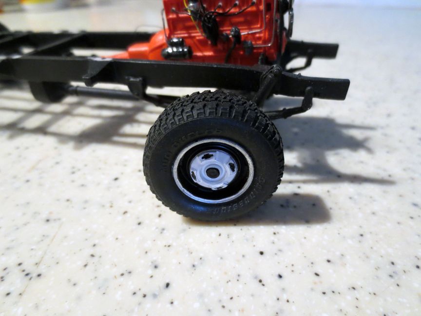

gasser59 Posted March 12, 2015 Author Share Posted March 12, 2015 Thanks Jose. I appreciate your interest and comments. I got the hubcaps done and attached just now and I'm off to work. Quote Link to comment Share on other sites More sharing options...

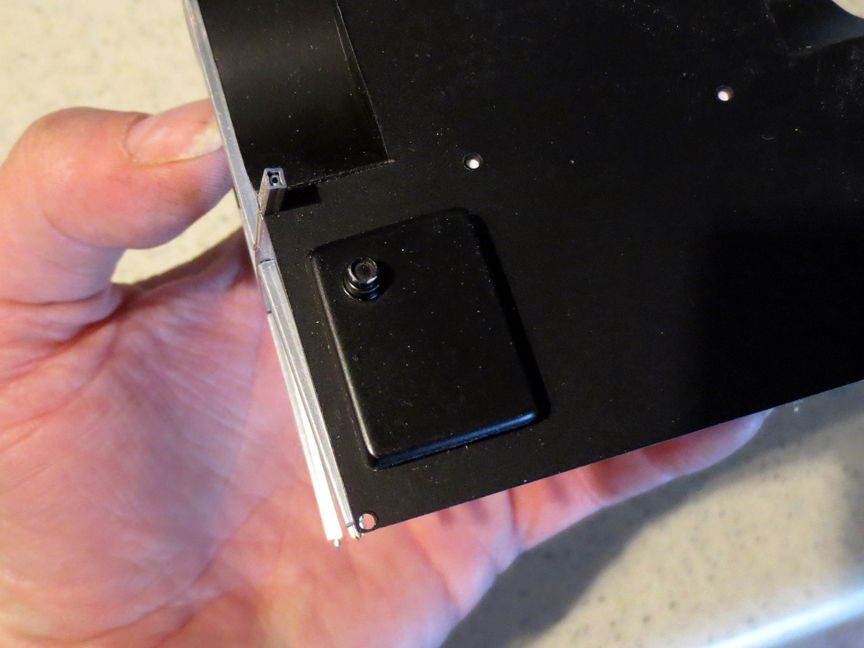

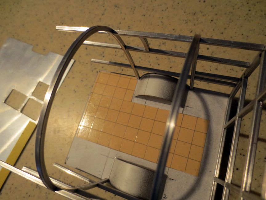

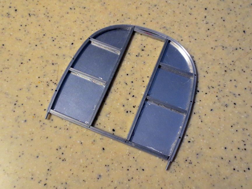

gasser59 Posted March 16, 2015 Author Share Posted March 16, 2015 (edited) Hi fellas - a bit more work done at the bench this weekend. Started to work on the exterior skin made from printing plate and am still trying to determine where to cut the top portion of the side skins for the interior to be viewable. Have to take into account the three roof vents with the end ones being close to the front and back. I got the inside skin cut for the front of the cab and its been painted and the rear one has been cut and glued to the end frame. It still needs painting. The interior skins will go on after the exterior unless I find a good reason to do it differently. The reason for the exterior ones first is so I can glue them on from the inside with the interior skins in the way. The interior skins will be partially held in place with all of the cabinetry, at least that's my plan anyway. I also got the floor tile made and glued in. They were originally 9" x 9" asbestos tile with a yellow / tan color with a bit of a darker color that was almost indistinguishable. I made the color in PhotoShop and the grid in Illiustrator and place the color pattern behind the square grid and printed them out. I laid clear packing tape over the tile, burnished it down and slightly roughed it up with fine sanding film. Once done, I put a needle in my pin vice and using a straight edge, ran the needle along the lines at a flat angle to put a depression at the tile seams. I additionally made a black water collection tank under the bathroom complete with a dump valve. Here's a few pictures. Thanks for following along and your interest. As always, comments welcome. Edited March 16, 2015 by gasser59 Quote Link to comment Share on other sites More sharing options...
