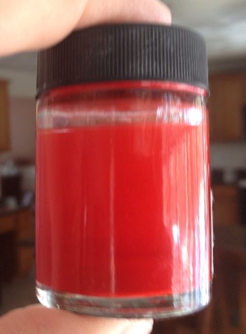

Jeff Johnston Posted February 8, 2014 Posted February 8, 2014 (edited) It definitely depends on the paint. Though typically I never use anywhere near 1 oz. I recently bought a 2 OZ bottle of paint form Scale Finishes (wonderful paint) and I used at least an ounce to get the hue I wanted. I have also similar projects where I used far less. Last night I painted a Ferrari Testors Laquers Gloss Red, thinned about 3/4 lacquer thinner 1/4 paint. I mixed a 1 oz jar almost to the top and sprayed 2 light coats at VERY low pressure, which covered the model nicely. Here is how much paint I have left... So I really do think the paint matters. Edited February 8, 2014 by Jeff Johnston
