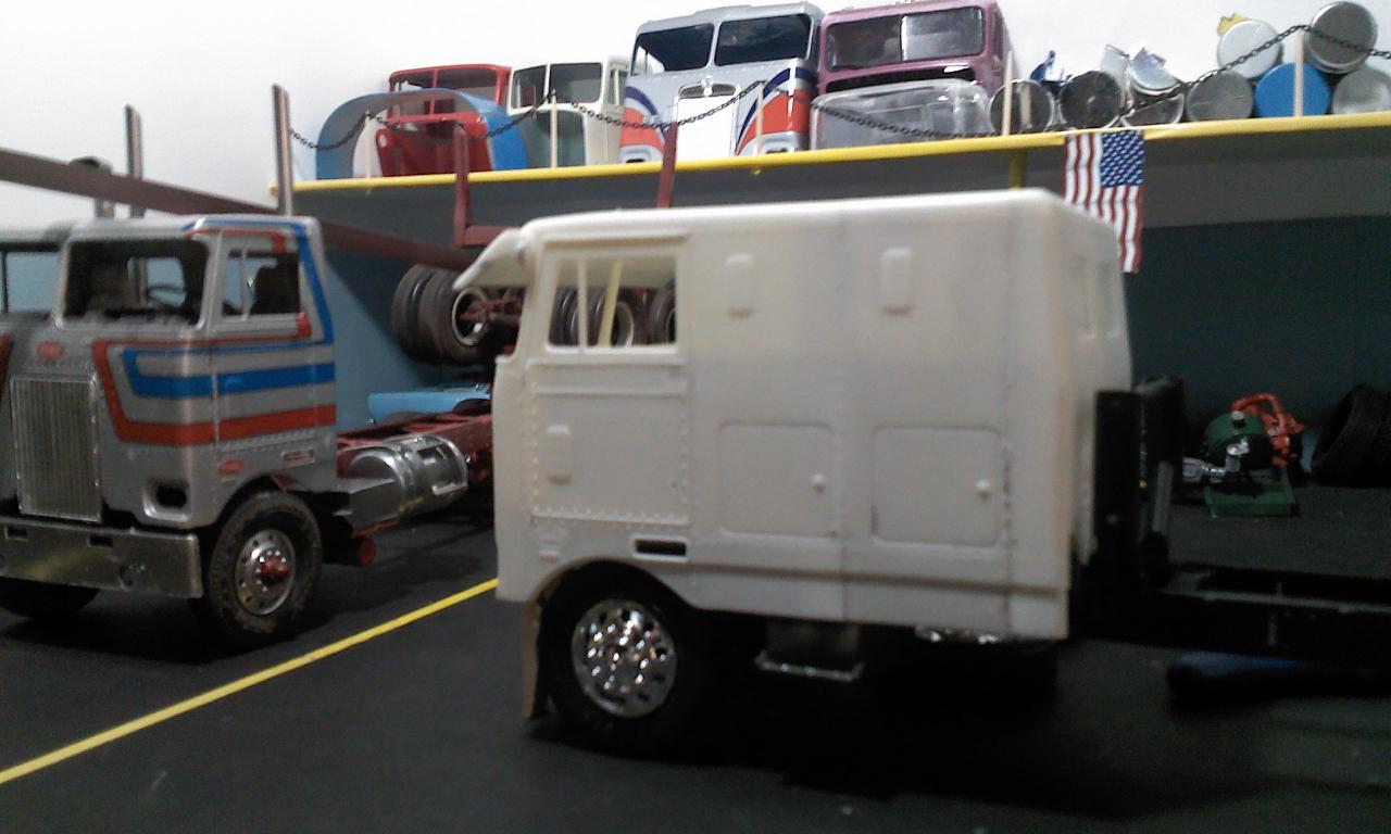

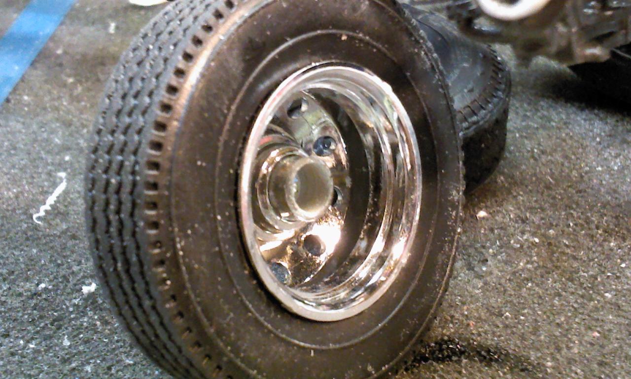

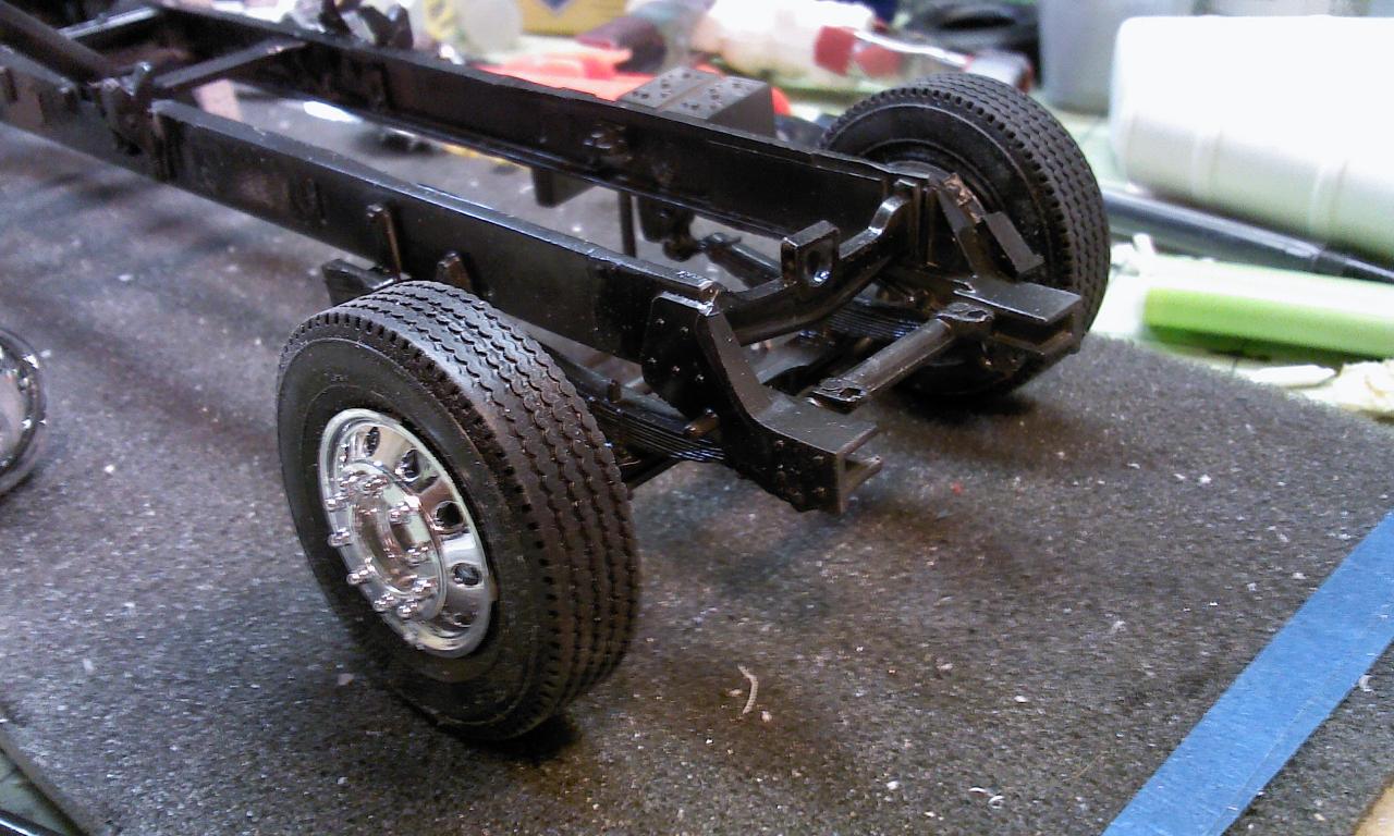

Now that i have the new set of moebius wheels and tires its time to figure out to mount them on amt kits and this is what I came up with. By using two gauges of tube I managed to built spindles and races.but first I had to open the wheel holes with a rat tail file. I will let the pics tell the story.
post-11315-0-34184200-1396111639_thumb.j
post-11315-0-23292000-1396111656_thumb.j
post-11315-0-90576600-1396111671_thumb.j
post-11315-0-94585300-1396111704_thumb.j
post-11315-0-28884600-1396111720_thumb.j
post-11315-0-01172100-1396111734_thumb.j
post-11315-0-75255400-1396111750_thumb.j
post-11315-0-55191600-1396111769_thumb.j
Link to comment

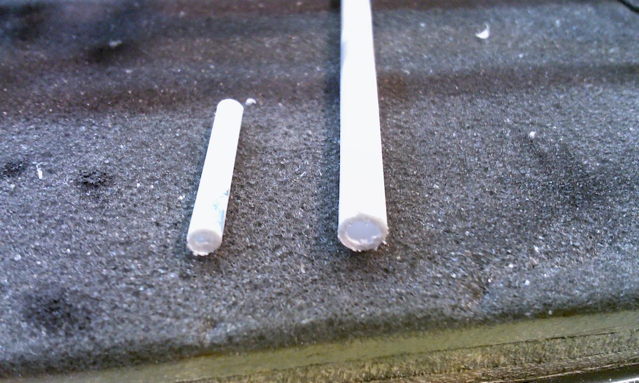

1/8 for the small tube and 3/16 for the big tube. on the wheels i enlarged the holes to receive the 3/16 tube, this size was a perfect fit for the stub on the steer axle. for the rear ends i drilled the axles to except the 1/8 tube and then followed suit with the 3/16 in the wheel. this method will give you a nice snug fit with really no alignment issues.

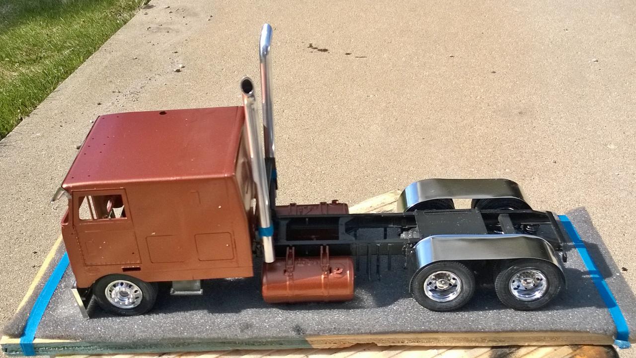

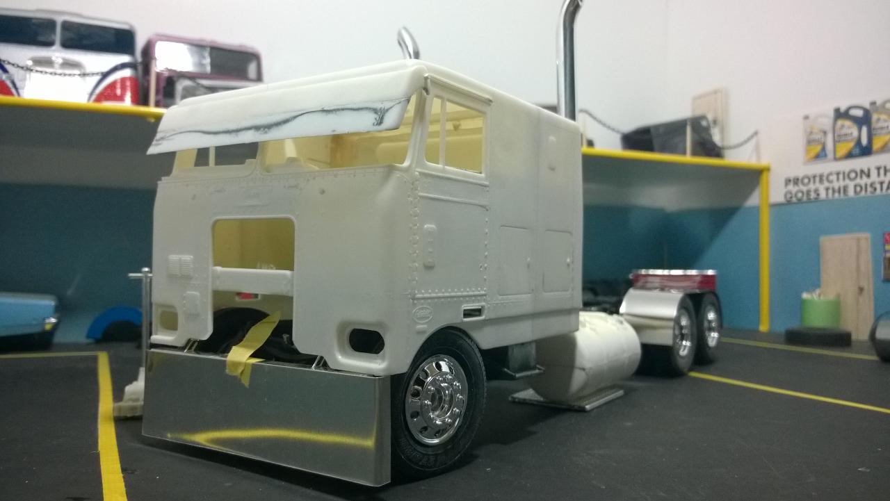

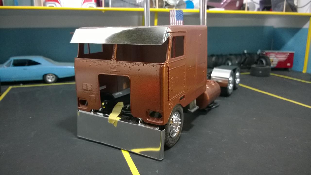

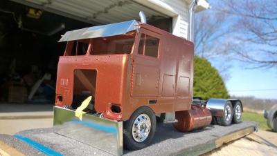

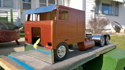

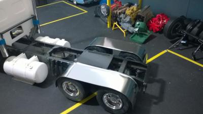

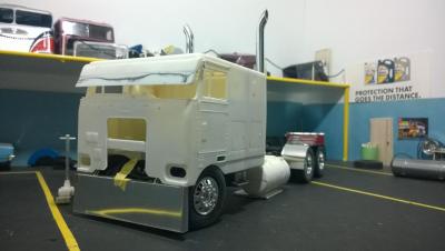

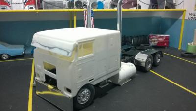

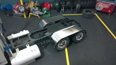

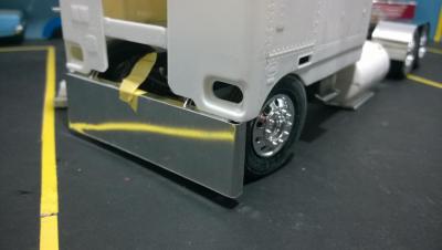

after taking a small break,i have started to do some "trial and error" scratch building with sheet aluminum. so far i have done a first run bumper and rear fenders. the stacks i ordered cause they fit the theme i'm after. comments always welcome........thanks john

thanks for the comments. i'm going to make a homemade bending jig to get the sharp bends. i just used a straight edge for the bumper corners. this stuff is thin enough you can score it with a blade , but its not practical let alone is a waste of a blade. but practice makes perfect. if i can stop getting side tracked i'll get some color flowing! john
Link to comment
Hey John, I think you might best your big sleeper 'shaker if your not careful. Very slick. If you don't mind a quick tip; Fiscars makes scissors and roller cutters, like this;
They are cheap, and any Walmart craft dept has them. They roll very well against a metal straight edge, and once a little dull, make great creases in thin sheet aluminum and stainless. Way easier than a #11 blade. I have 2, one to cut plastic and one for metal work.
