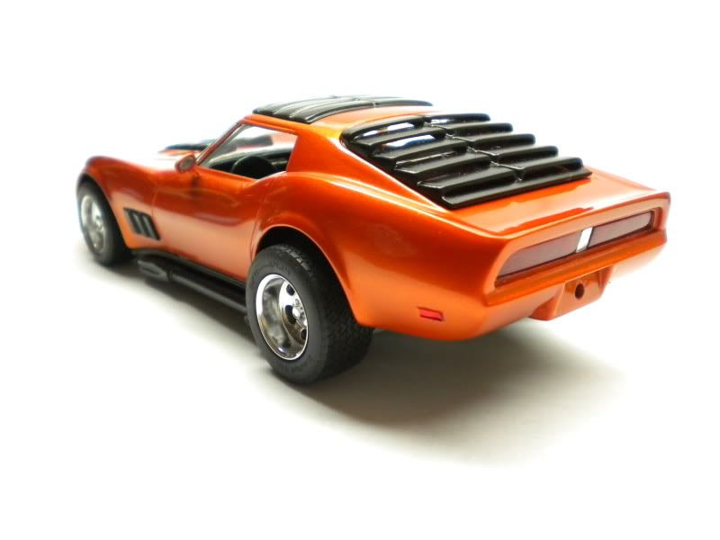

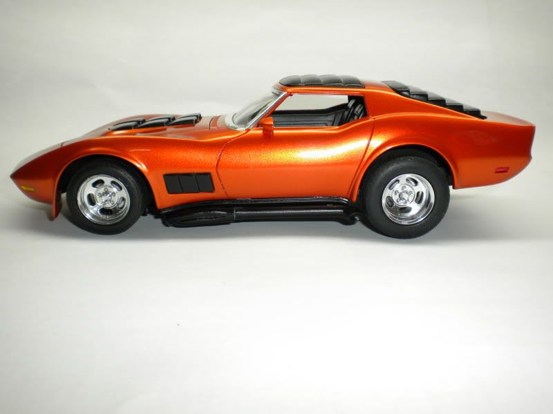

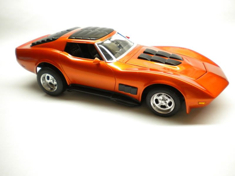

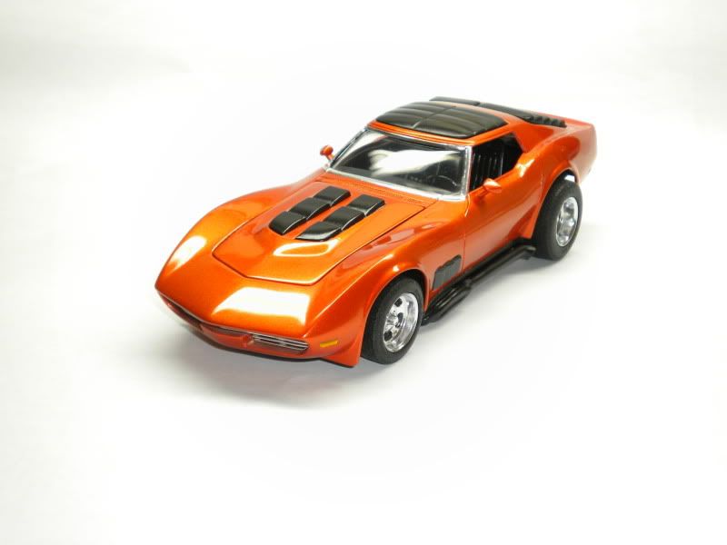

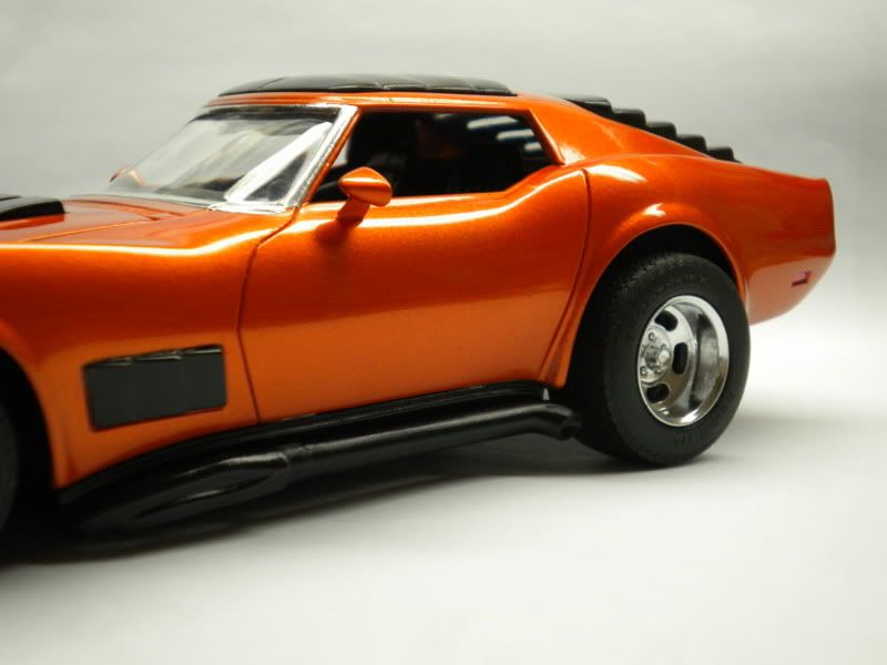

mcandela Posted April 23, 2011 Posted April 23, 2011 Finished this one. Worked it a little bit at a time. Hope You like. Working on the license plate, waiting for it to dry. Thanks for looking.

mcandela Posted April 23, 2011 Author Posted April 23, 2011 My favorite Vette kit! You did a great job on it. On the wheels, did you use the Dupli-Color chrome paint on them? They look nice! I need to finish mine, but the paint needs to be removed first. Good workmanship! Thanks for the comments. On the wheels I went with a nice shiny black coat of paint and alclad chrome. After 24 hours I simply polished them with a clean piece of rag. Wheels and tires are resin copies from Ma's Resin.

mcandela Posted April 23, 2011 Author Posted April 23, 2011 perfect paintjob, is that nail polish? Yes it is nailpolish. From Walgreens, $1.99. Check it out here --> http://www.modelcarsmag.com/forums/index.php?showtopic=40067 Hablamos.
seeker589 Posted April 23, 2011 Posted April 23, 2011 Great build! The finish is very nice. I liked the Dupli-color Chrome paint under the finger-nail polish. What did you use to thin the finger-nail polish? Normally it's lacquer. Is the Dupli-color Chrome lacquer? What did you prime the body with? Sorry for all the Questions - but inquiring minds want to know!
mcandela Posted April 23, 2011 Author Posted April 23, 2011 (edited) Great build! The finish is very nice. I liked the Dupli-color Chrome paint under the finger-nail polish. What did you use to thin the finger-nail polish? Normally it's lacquer. Is the Dupli-color Chrome lacquer? What did you prime the body with? Sorry for all the Questions - but inquiring minds want to know! Primer/Sealer is Duplicolors. Used their chrome spray paint as a base and the orange is Walgreens 1.99 nailpolish. (color = courtney orange from the sinfulcolors line @ walgreens) Told my wife I needed a orange and she picked this one out. Used regular hardware store laquer thinner to thin it out, 1:1. 2 coats of 2 part clear as final coats. The asking doesn't bother me at all, besides I believe that's what modeling should be about. Thanks. Edited April 23, 2011 by mcandela
Guest Posted April 23, 2011 Posted April 23, 2011 Looks real nice Mike! I really like the color you shot on it! I recently aquired and built this same kit. It's one of my all time favorites. Did you make the tail lights or are they from the SS?
mcandela Posted April 23, 2011 Author Posted April 23, 2011 Looks real nice Mike! I really like the color you shot on it! I recently aquired and built this same kit. It's one of my all time favorites. Did you make the tail lights or are they from the SS? Tail lights were from the parts box. Changed them 'cause I wanted something a bit more realistic. Have a couple of shots of the rear lights in the Workbench section. Thanks.

gunner Posted April 24, 2011 Posted April 24, 2011 Now that is one to be ###### proud of !!! One of the best Vettes I've seen on any of the forums. Is this basically a OOB? I'll have to try nail polish on my next build but since I don't have a better half I'll have to brave the nail polish section alone
mcandela Posted April 24, 2011 Author Posted April 24, 2011 Now that is one to be ###### proud of !!! One of the best Vettes I've seen on any of the forums. Is this basically a OOB? I'll have to try nail polish on my next build but since I don't have a better half I'll have to brave the nail polish section alone Yes, it's out of the box. Only mods are the rear taillight section and the selection of wheels and tires. Oh, I have been alone in the nail polish section before, I know what You mean. Beautifully done, Mike!!! Thanks Dan.
